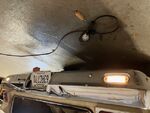

It was a battle, but the backup lights are now functional cool
It finally dawned on me that the voltage meter will show up with very little amperage compared to the bulb
Ran a jumper from the negative battery terminal to the bumper to confirm my concept and lights worked.
Since this is a "fixup" a budget friendly solution was utilized grounding, body to bumper bracket and its GTG
Not sure why the pictures got rotated, please use your imagination rolleyes
