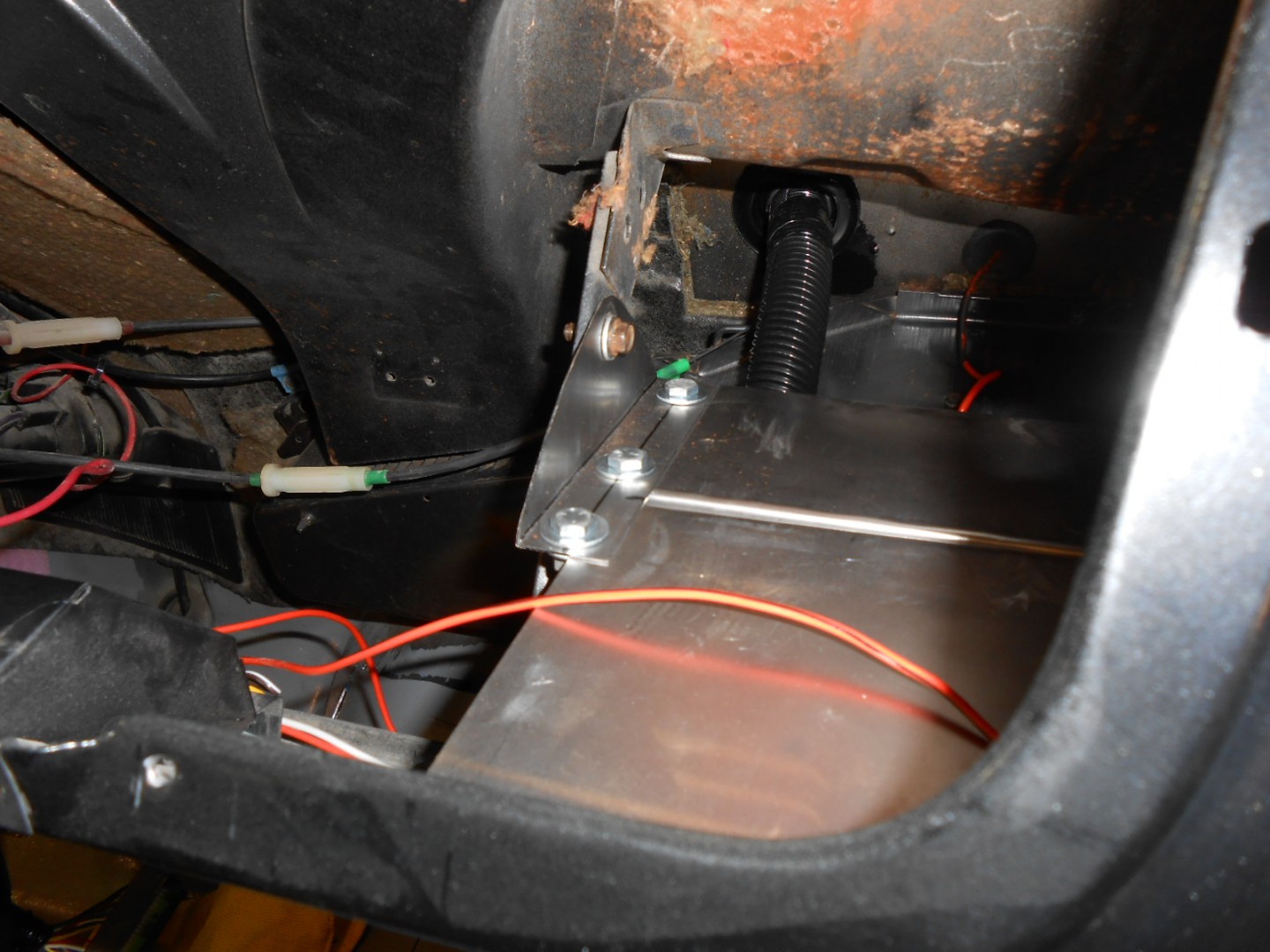

The new glove box is installed, we might pretty it up latter but for now it’s done. The computer is installed and wired to the engine; it encroaches into the glove box area but the compartment now extends farther to the right. The computer is held in place with a homemade strap, might not look pretty but it should withstand 30Gs.
I mounted the relay and fuse control box almost directly under the computer on the underside of the glove box so it is very accessible from below. I then placed a placard to identify circuit assignments just outboard of it.
What little bit of soundproofing was installed behind the work area makes a big difference, looking forward to seeing how much quieter the car is when it’s done.

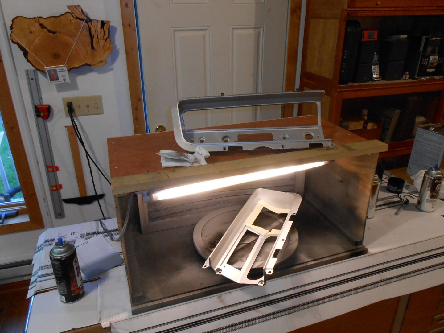

Waiting on parts again so it’s time to do some fun things.
Stopped by JD’s today and was able to gain clearance to the JD Skunk Works, his secret little workshop hidden away underground where he does his magic. I was in need of a place to install the Malfunction Indicator Light (MIL) in the dashboard. So once again JD did his magic. It is hardly even noticeable (see pix of tach on bench) but when it is eliminated there’s no doubt it’s on. Thanks again John.
The freshly rebuilt grill now sports an LS1 emblem. Got the paint booth back out and repainted the instrument panel and then installed some soundproofing.
And there’s always wiring to play with; hope the parts get here by Friday.

Ya baby we have a gas pedal. It may not look like much but it took a lot of time and work. Angles, dangles bends and twists to maintain the correct full pedal travel and feel for the ‘drive by wire’ pedal. One more milestone past, and a nice one to have in the rear view mirror.
Dash is slowly going back in, still chasing some electrical gremlins but there falling one at a time. Right now my TEMP light (steam Gauge) will not test but it will illuminate when tested to ground at the probe. A ground should be provided thru the cranking position of the ignition switch for testing but it’s not working.
Unable to load pictures tonight.
Unable to load pictures this morning.
