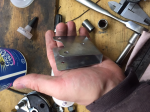

No work today so I got to play in the shop. Decided to upgrade the headlight circuit with relays.
I made a bracket to hide behind the washer fluid tank and hold the relays.
Bummer about projects like this is there is nothing to see when your done!
Sorry about the sideways pics, took them before I learned how to hold the phone...
Thanks to John D for the detailed How-To post, made it easy to find the parts I needed.

Nice job Chris, can't wait to see the end result. Original lights are sooooo poor.

Original lights yet, not sure what I'm putting in yet. Thought I'd upgrade the wiring first so I'm ready when I finally decide.

 Just upgrading to Halogen's with the direct power source will be a HUGE improvement with out the expense of fancy HID's.

I have been dealing with dim lights forever and this looks to be an awesome upgrade I will need to look in to. Thanks for posting!
