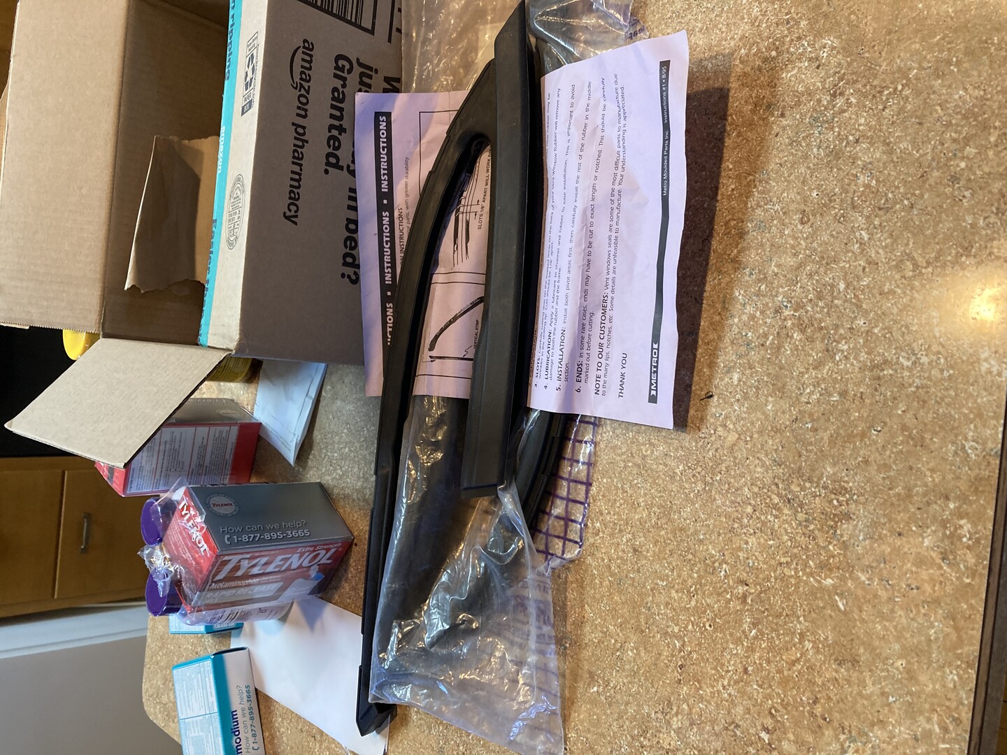

Well I decided to install new vent window weather stripping because I have the assembly out of the door. I bought Metro, their cost about $300, but I got it for less on eBay. I looked over it carefully and all seams good. This is in my 66 but should install in other years. I would appreciate any tips as some of you may have done this. Installation #6 seems to indicate there might be an issue. And the Note At the end has me wondering.

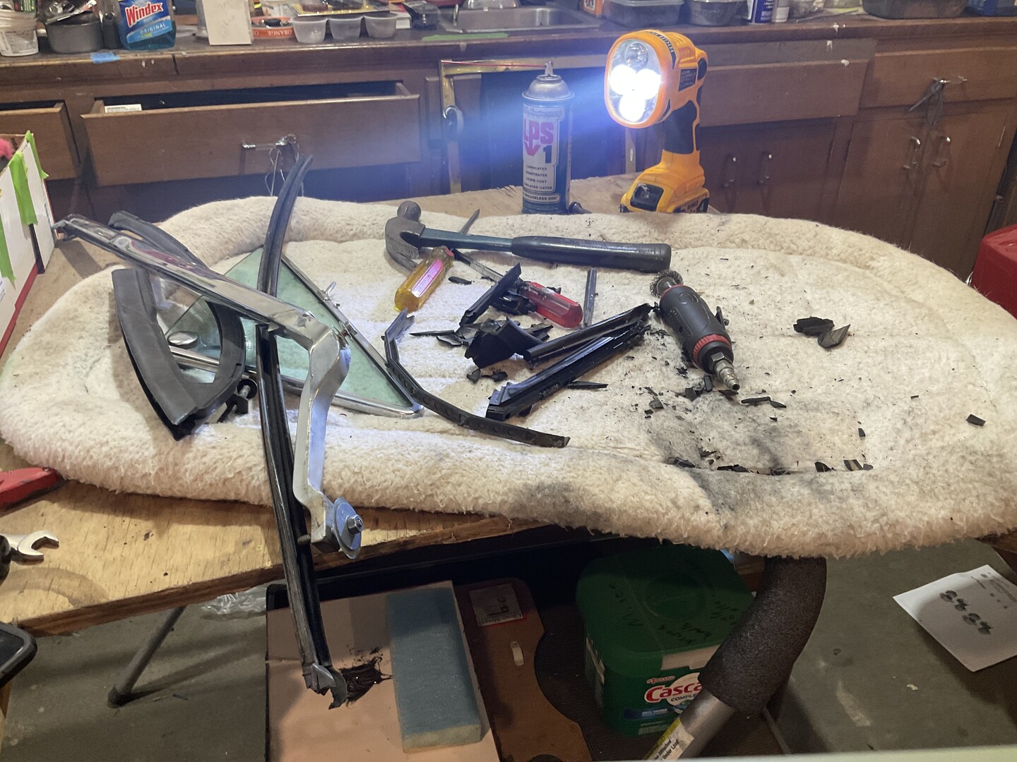

Well, everything is apart. Most difficult part was getting the old rubber out as it had turned into a hard plastic(screwdrivers, pliers, hammer, chisels, and cut off wheel). New metro weather striping does not have steel backing like original.j

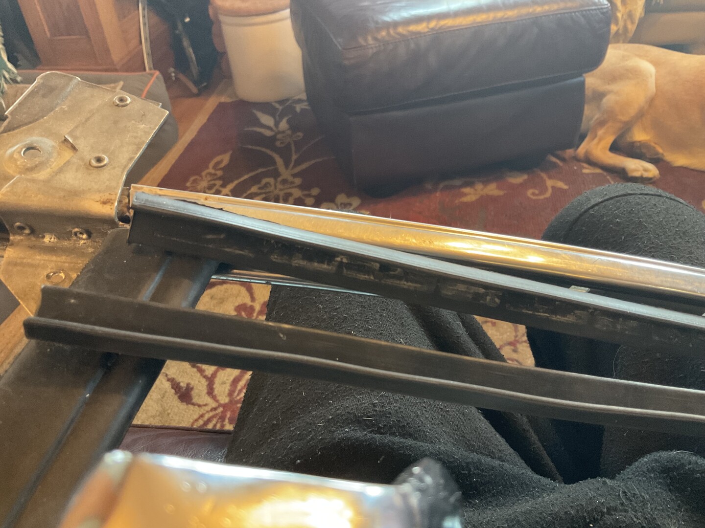

Not happy with metro vent seals. Poor install statements. No install clips. No metal rib like originals. They need to be trimmed to fit properly!! no mention of this in install instructions. No mention of what to use when installing the seals, like soapy water, windex, lithium lube , etc. photo shows area that NEEDS to be trimmed, this photo is from my other 66, probably the same for other years. I was able to reuse some old clips. The only way to bend them for use without breaking was to heat with a torch to bright red, them open them up.

I used 3m weather stripping glue to glue the seals to the angles pot metal piece. I was able t get 4 of the Old clips to hold the other side seal in place(hop it holds). Hope to make it to Randy’s on Saturday.

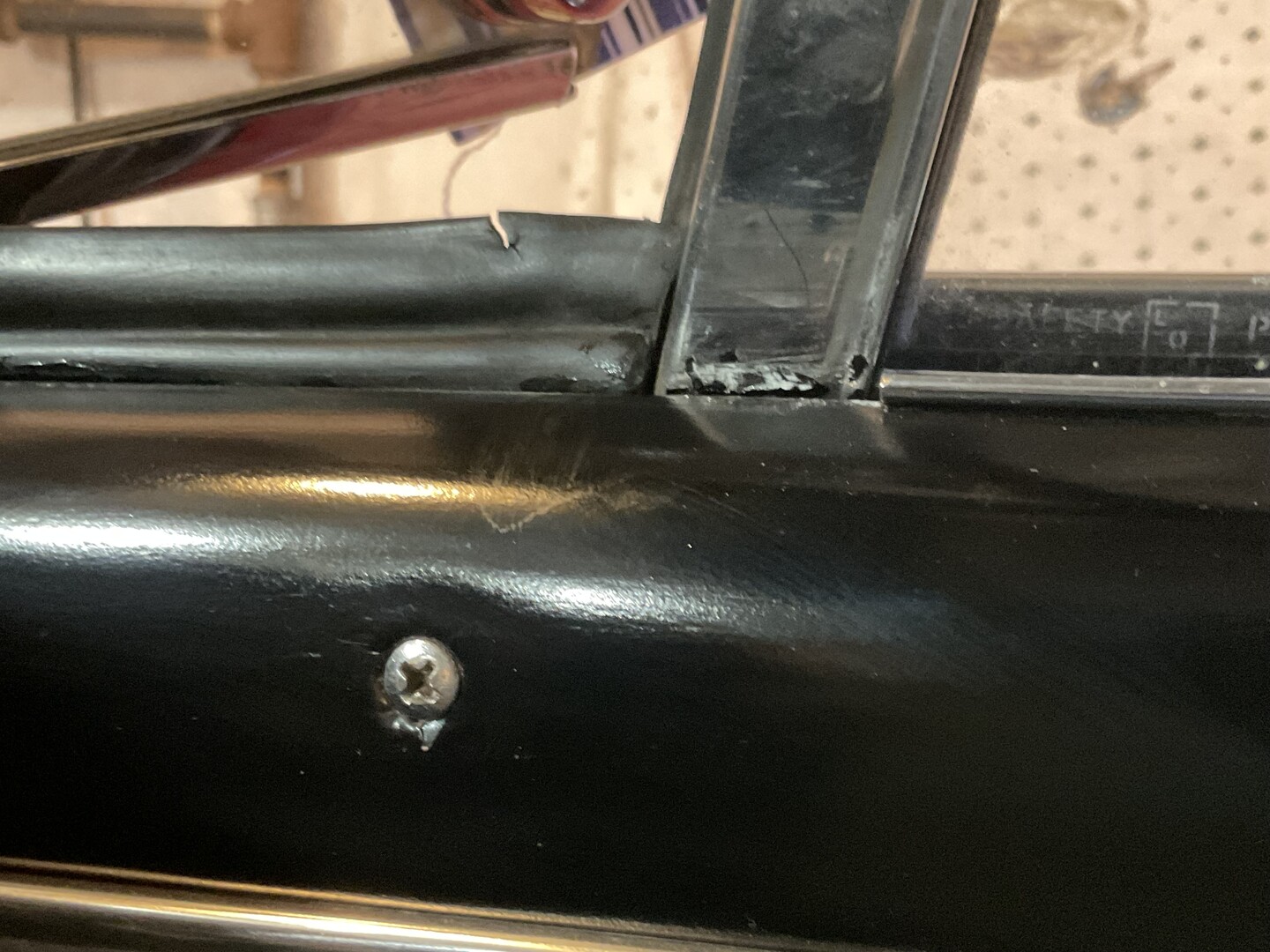

trying to put last piece in. Not exactly made the same as original. doe you know which way is correct? Thanks
Passenger side. I can never figure out what side is what. Looking from front of car or sitting in the can.

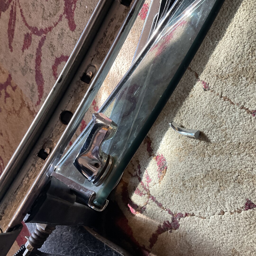

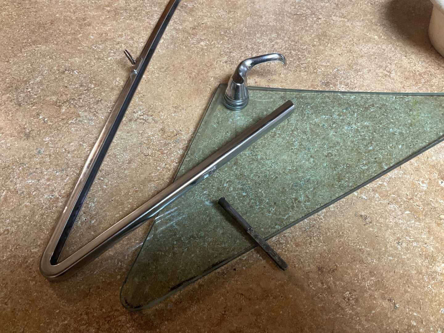

It’s in, bu t look at what happened. How do I get the roll pin out or is it an Allen key .
If there is a hole on the opposite side, it's a roll pin, which I think it is. If no hole then an Allen screw.

I also broke a vent window glass frame. Do you think it can be fixed??
