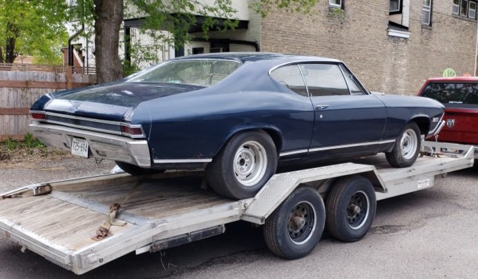

June of 2023 I bought this '68 SS396 Chevelle from the brother of the previous owner who had passed away. Previous owner was a friend of a friend, and I was asked to look at the car and figure out what it was so they could sell it. I looked at it, told them all the details of what was right or wrong, but didn't discuss price as I wasn't really in the market to buy...
The previous owner, Tommy bought the car in 1974 and quit driving it around 1985. Tommy was not mechanical, but was an artist. He hand-lettered a lot of racecars around the Twin Cities area, including all of John Hagen's Pro-Stock cars in the '70s.

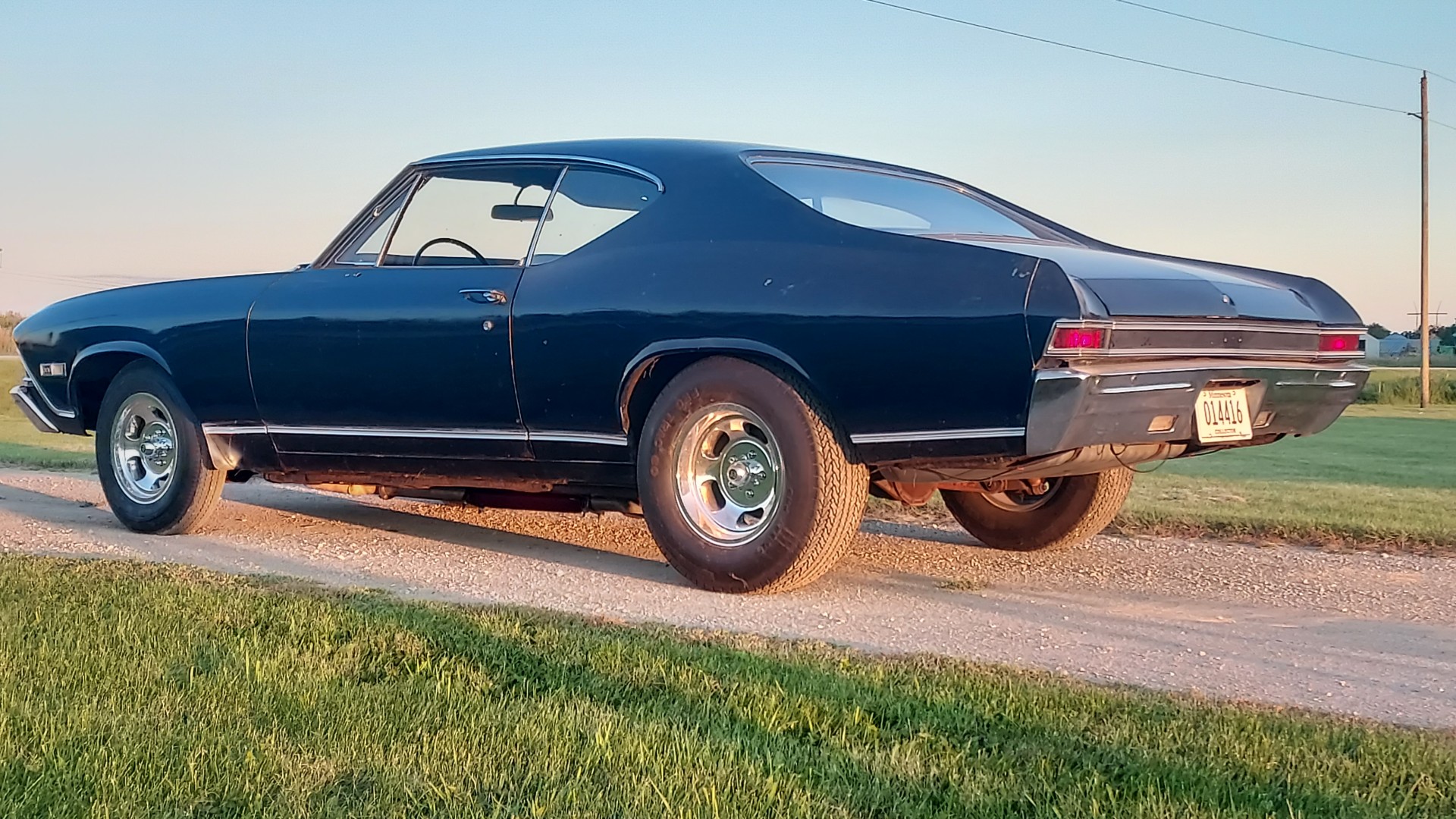

68 SS396 Fathom Blue/Medium Teal. Originally bench seat 4spd, now has buckets.
Pretty sure it was a 350hp L34 car originally.

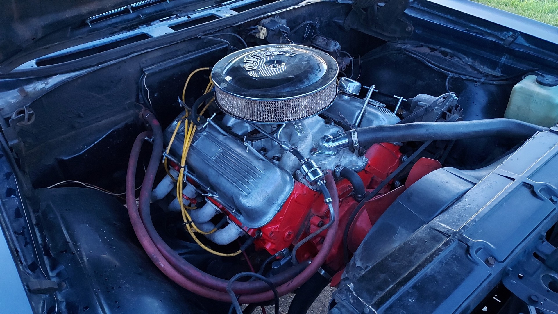

Engine in it was a JH suffix L78 375hp 396 from a '69 Nova
M20 and 12-bolt 3.55 posi both dated correct for the car. (later found VIN stamp on trans matches VIN on car)
It had some cool vintage speed equipment. Traction bars, Air Shocks, Mr.Gasket VertiGate shifter, Lakewood steel bellhousing, vintage headers, Hand a cool "fly eye" air cleaner.

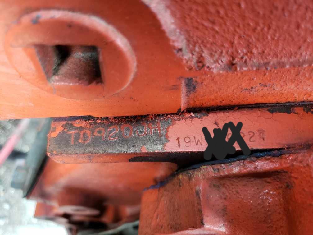

I sent the VIN from the L78 block to Wes at "Lost Muscle Cars" and he found the car is registered in Pennsylvania! I'm now in contact with the owner, and he had no idea was really an L78 car! (but was known to be an SS 4spd car). Unfortunately, he had just spent a lot of money mini-tubbing the car and taking it too far down a modern resto-mod path to turn back and go original.
The one oddity of the stamp is the last digit being double stamped with an 8 over the top of a 7.
7 is lined up in the gang, and the 8 off center assumed to be a factory "fix" from someone forgetting to change the last digit in the gang holder, and stamping the previous car's VIN on it. Knowing the history of the engine, I have no other explanation for the double stamped digit.

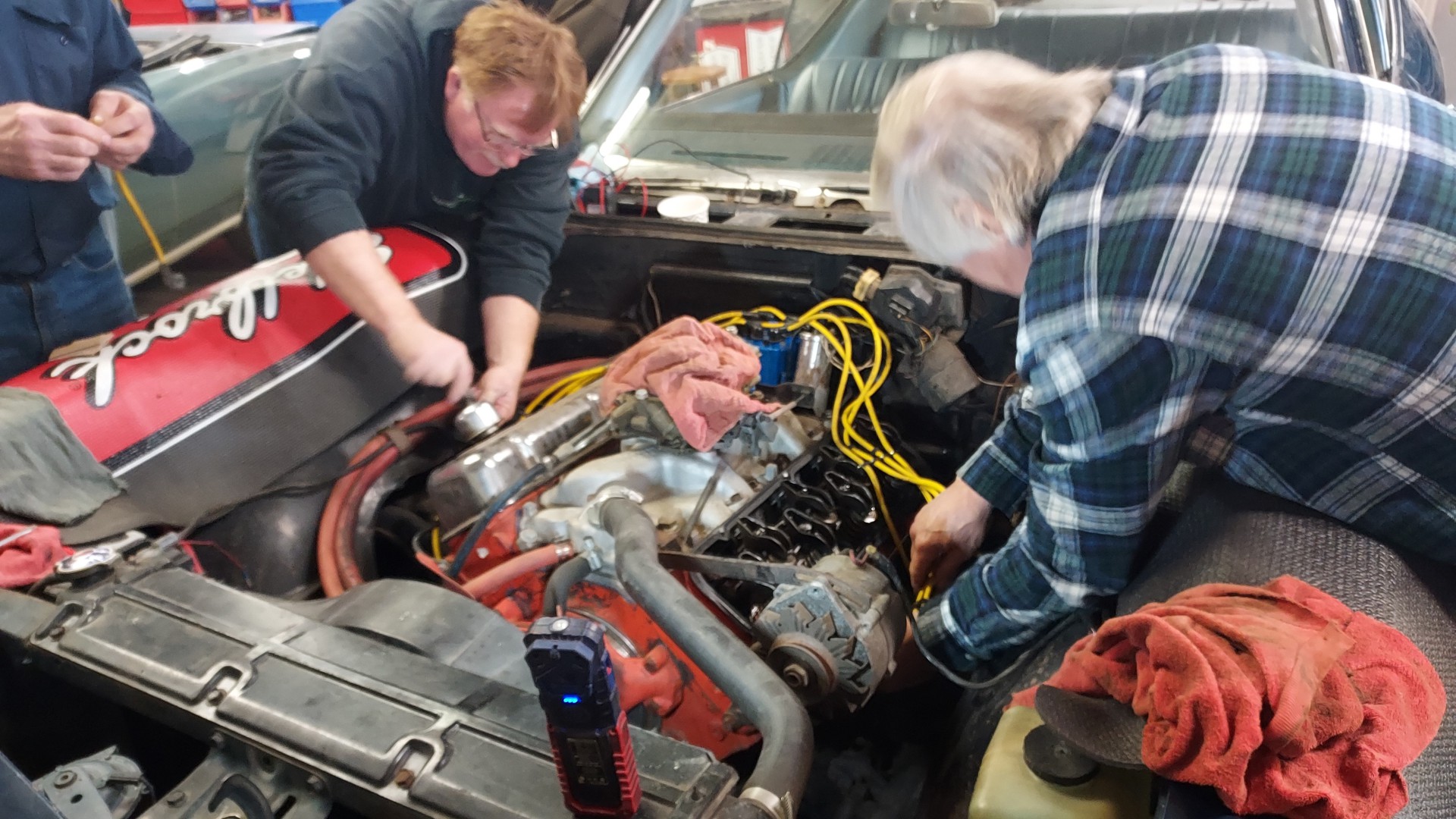

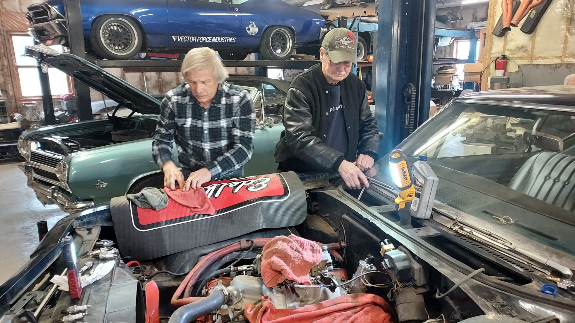

I cleaned the garage to host a Northstar Chevelle Club "work meeting" to have some help and motivation to try firing up the L78...Despite the problems, it was a fun day with a bunch of great people tinkering on a cool old project...

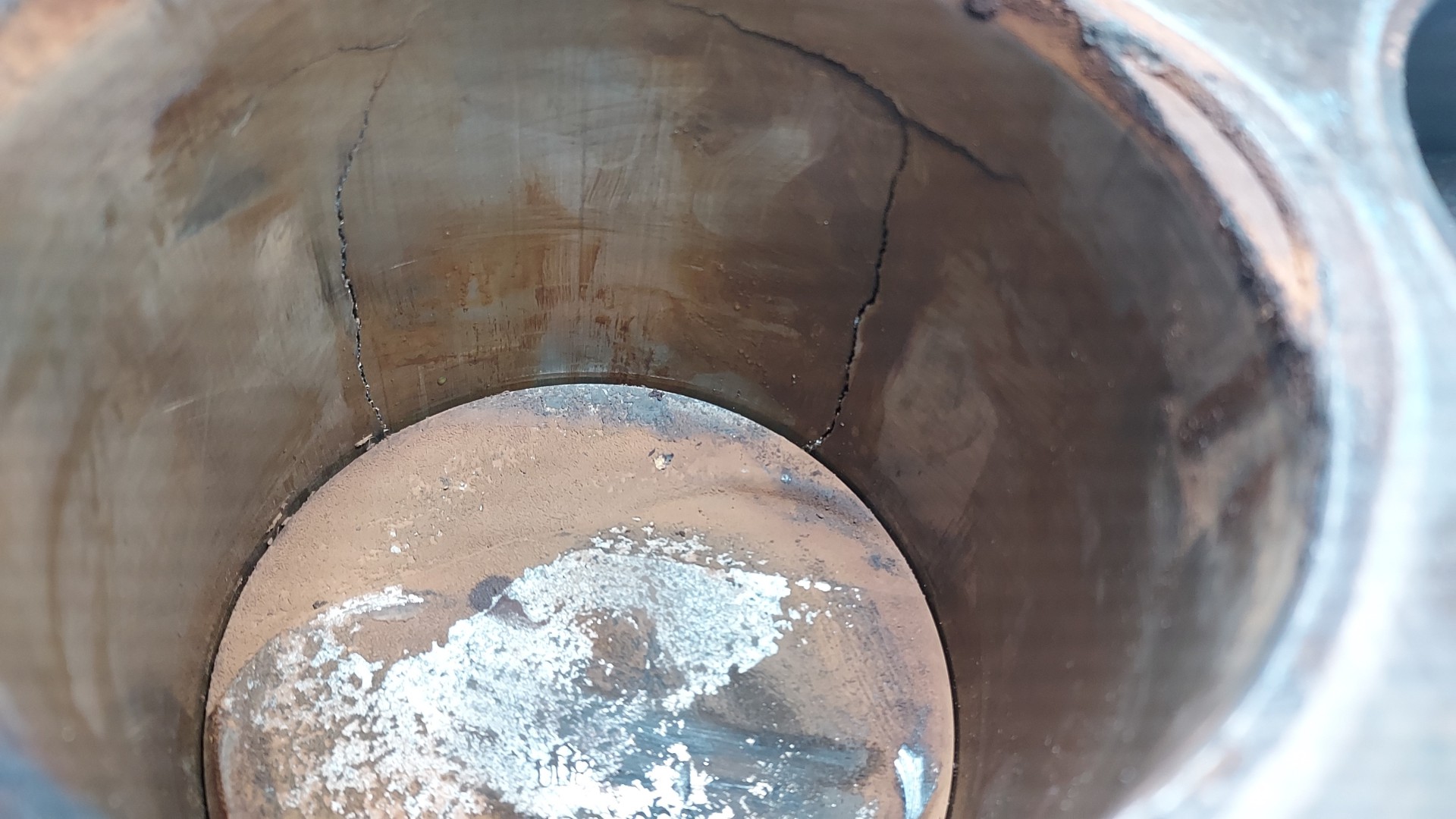

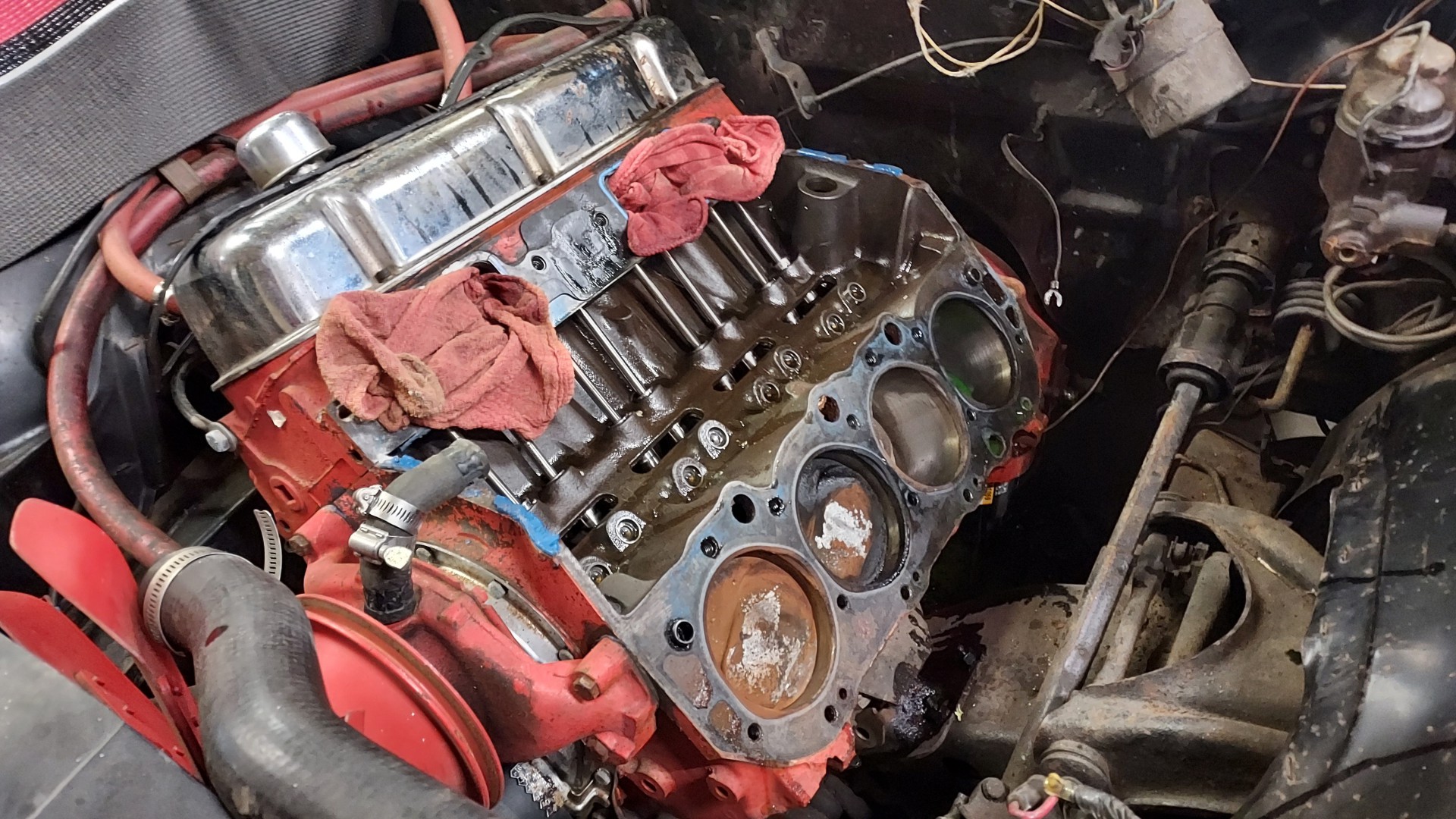

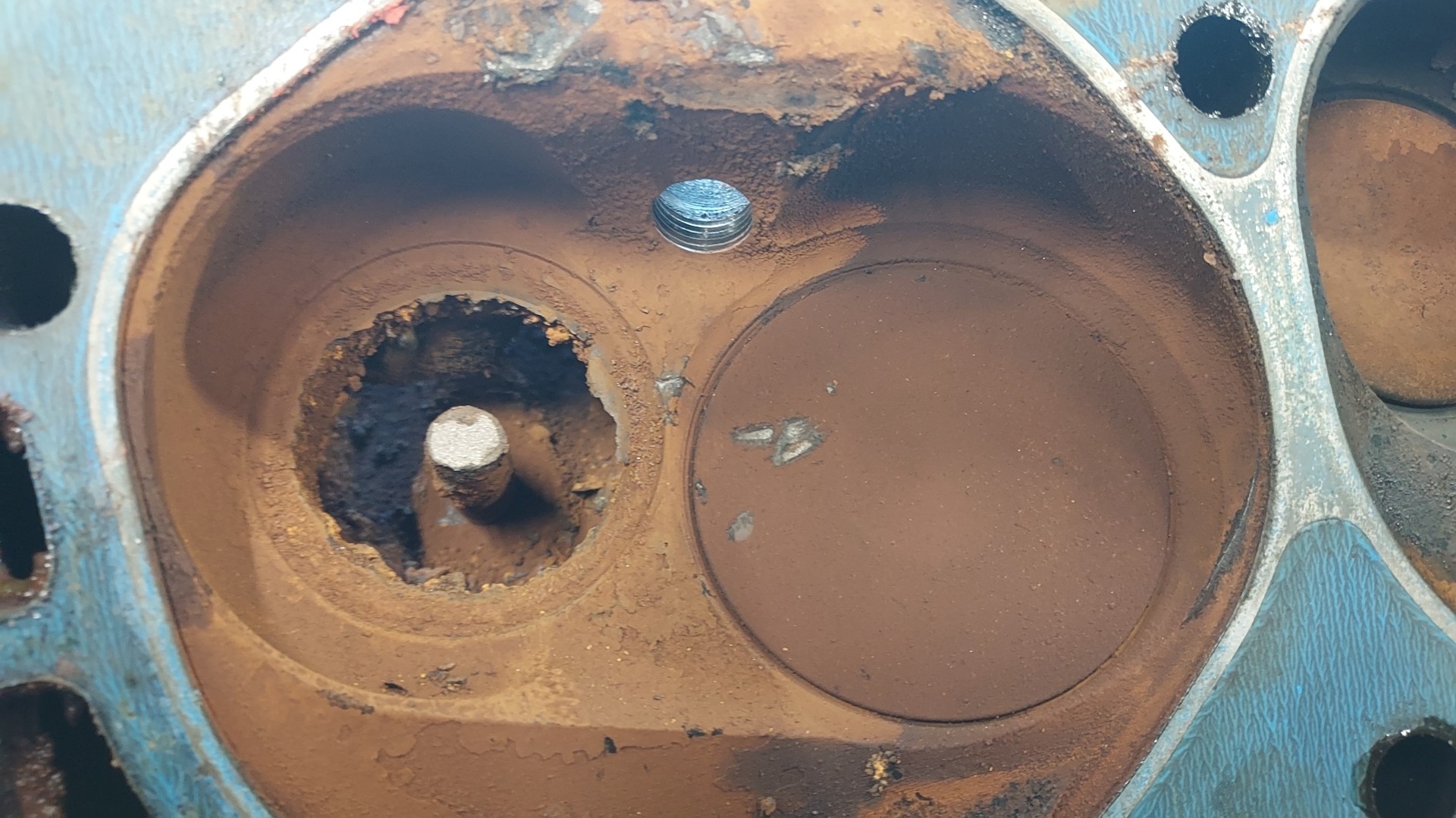

Unfortunately, there were issues with the #1 cylinder. There was a stuck exhaust valve, so we had to dig deeper.
Any hope of firing it up was gone when this HUGE crack in the #1 cylinder wall was found.

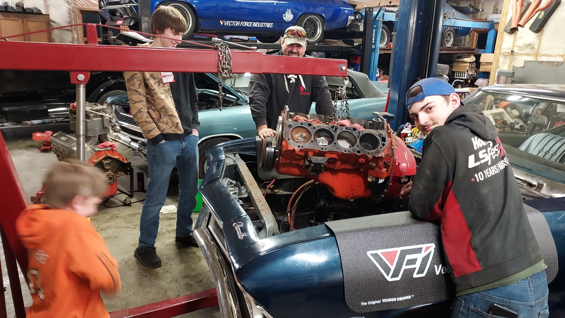

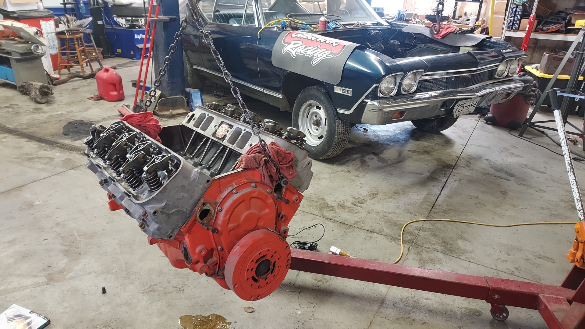

After everyone else went home, the kids and I got to work getting the L78 pulled out so we could drop this rat in its place.
The engine is an unknown, acquired when I bought out a barn full of parts from an estate. It's a 1989 Marine (9XA suffix) 454. Forged crank, 074 "L88" aluminum heads, but never looked too deep into it yet. Borescope through the spark plug and drain plug revealed a few things about it. Pistons are 13cc dome, part number came back as 1971 LS6, so it will only be about 9:1 with the 118cc heads. 4-bolt mains and 7/16" dimple rods, and cam measured out to .510/.525 lift, so a lot milder than I expected from an engine with these heads. Everything looks fresh, heads never been run, pistons clean, and still has assembly lube on the cam. It already had a Chevelle pan on it, so we just dropped it in as-is.

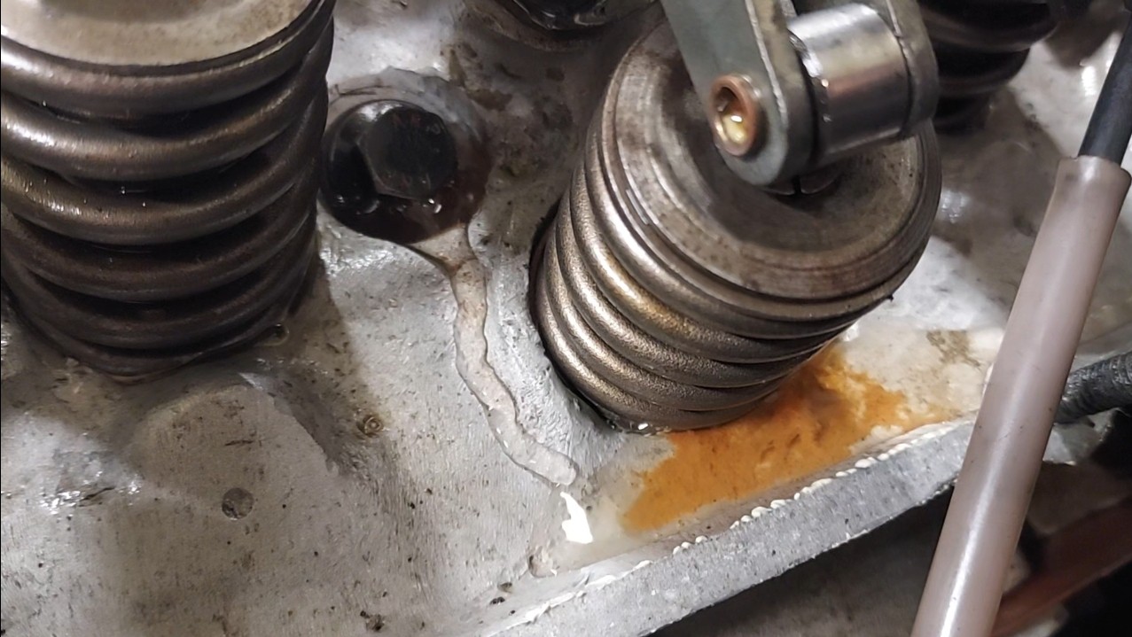

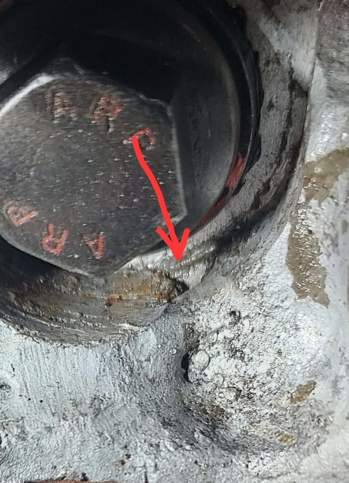

We finally got it running a couple weeks ago, but during cam break-in we noticed it was getting water in the oil. I figured intake gaskets, so re-sealed those, then tried again... after seeing water in it again, we noticed water weeping by a head bolt, so I pulled all the head bolts and sealed those. When it still leaked, I looked a little closer and found a hole in the casting.
Now, we've pulled the heads, and we're going to throw on a set of 840s that were on the 427 I got with that '64 2dr wagon project I had many years ago. They look to be in useable condition as-is, we'll just swap the springs. They won't look as cool as the 074 aluminum heads, but the 103cc chamber will bump the compression to about 9.8 so I would expect it to make a little more power with them.

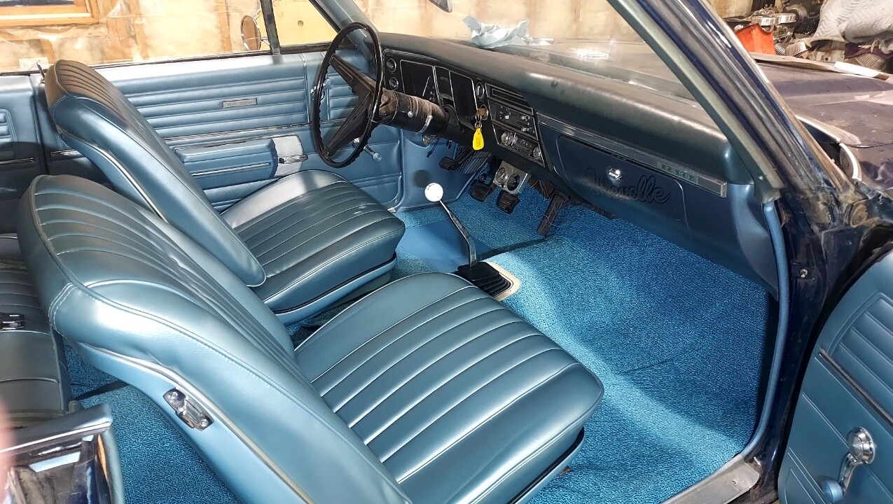

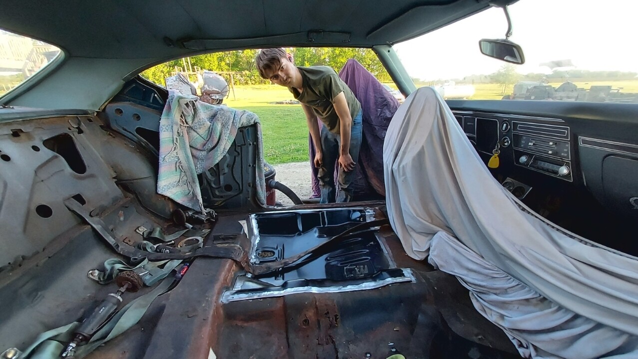

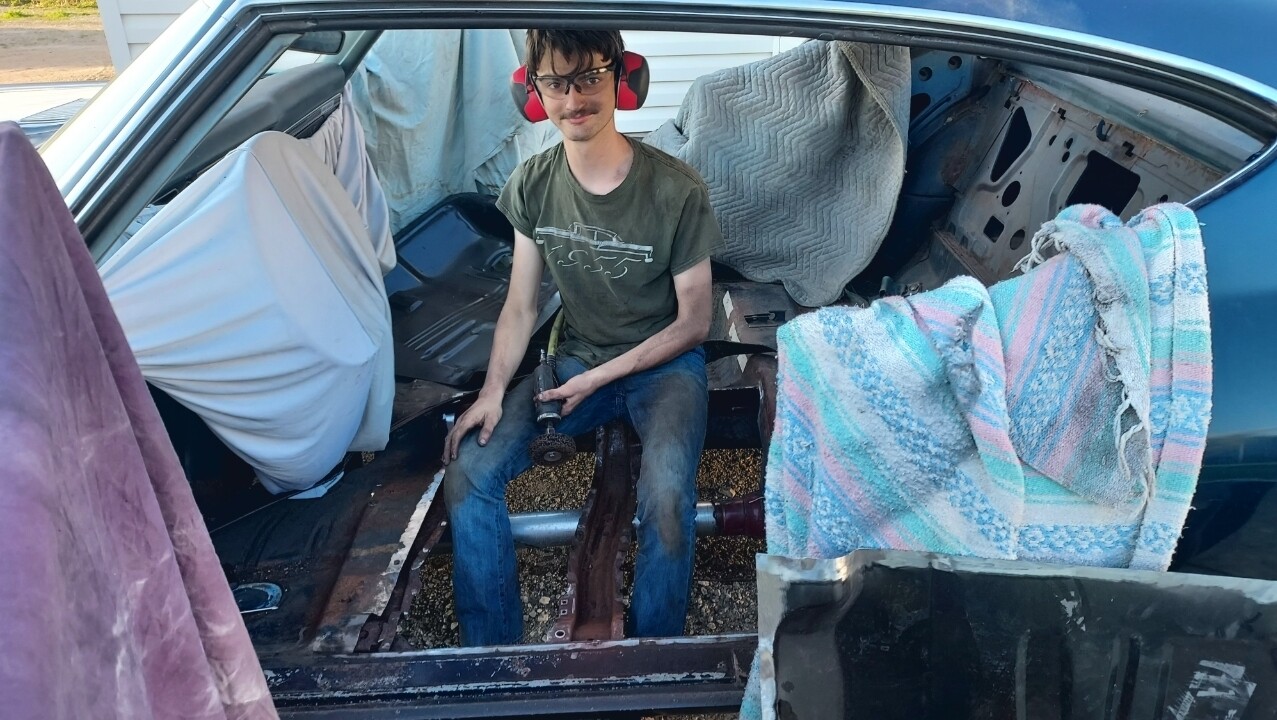

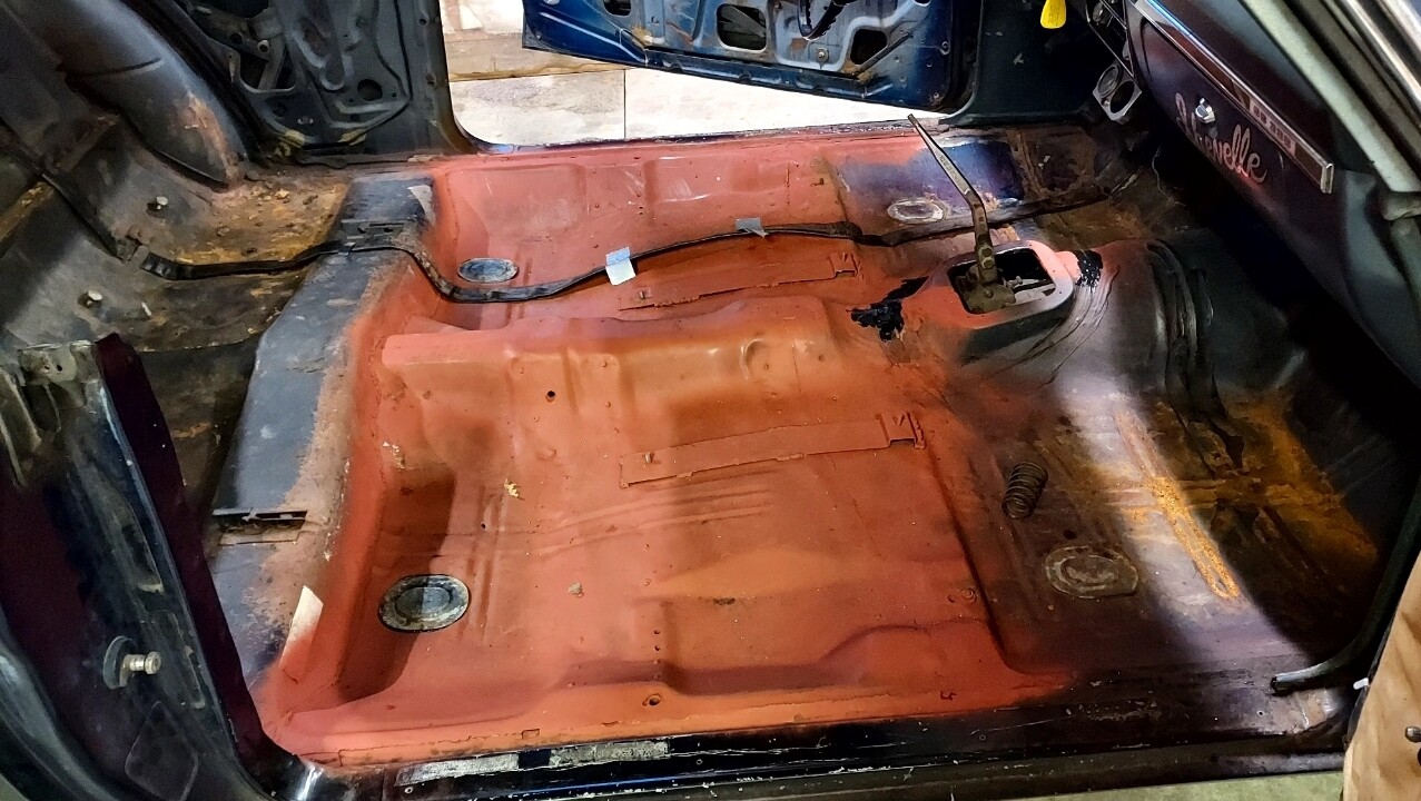

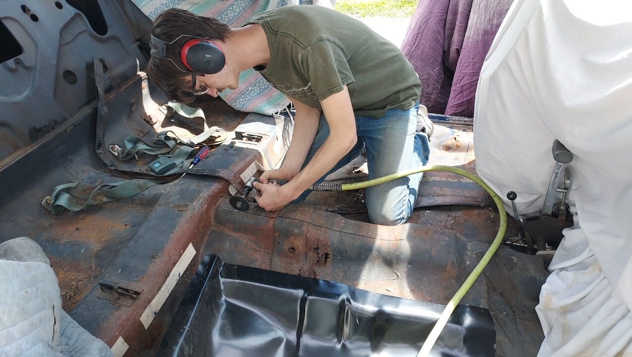

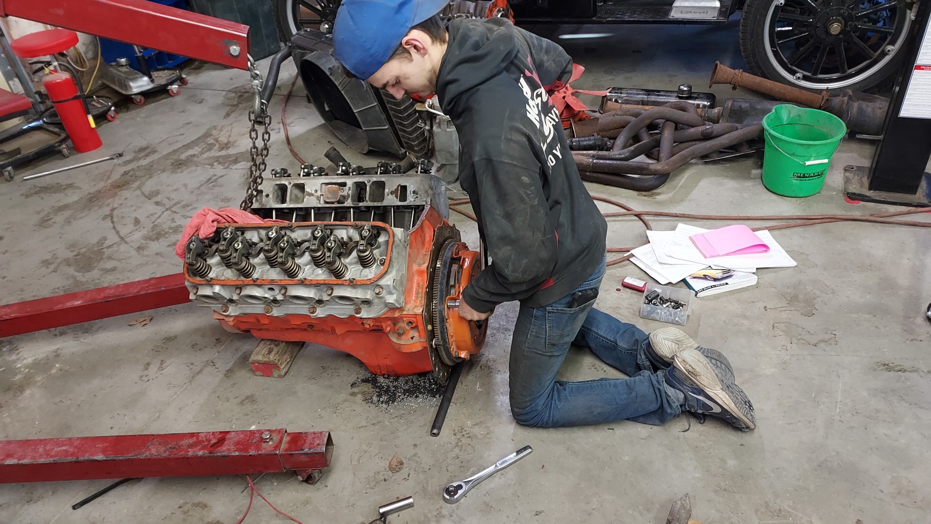

Before we could install a new interior, we needed to patch some rust in the floors. I turned Cale loose on this project while I continued to block sand on his '55. We also swapped out the V-Gate shifter for an H-pattern, and patched up the floor hump.
Last night we finished installing the new interior. The car came with the seats already redone, and new door panels, all from Legendary. I ordered carpet, floor mats, package tray, and a couple cans of SEM spray dye for the faded original plastics.
We still need to install a tach, temp gauge, and an N34 Walnut steering wheel that I picked up at a swap-meet last year.
Headliner and Dash are still all original. We didn't do anything with those. Cale did all the work, except trimming the carpet. I wanted to do that myself.
