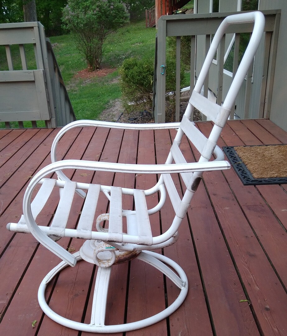

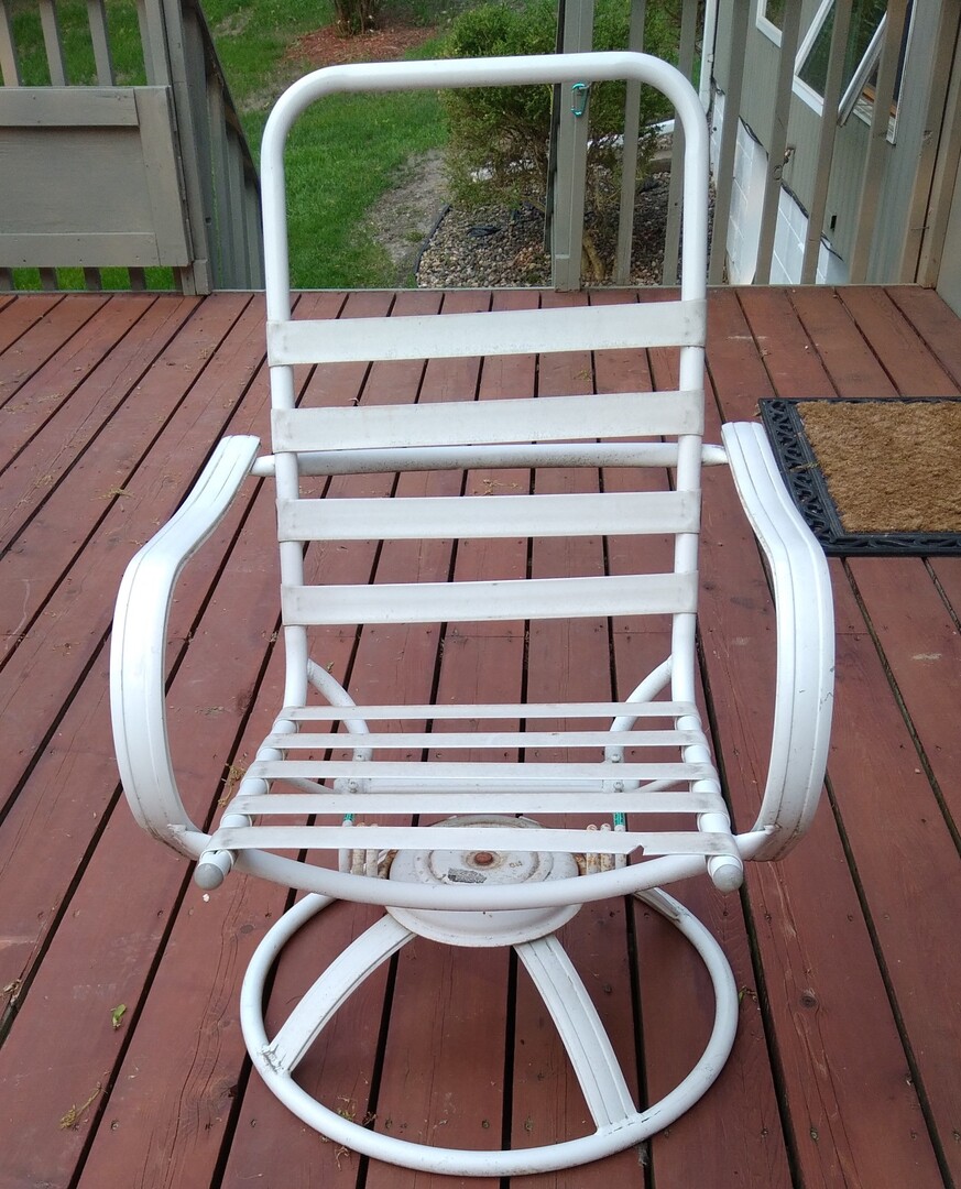

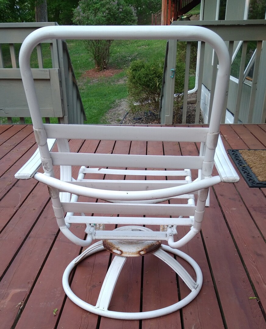

Before (this is the best of the six):

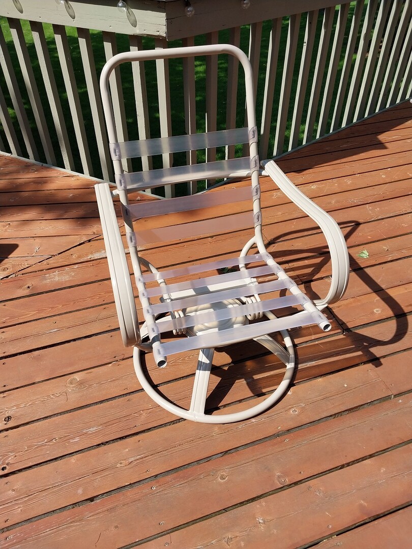

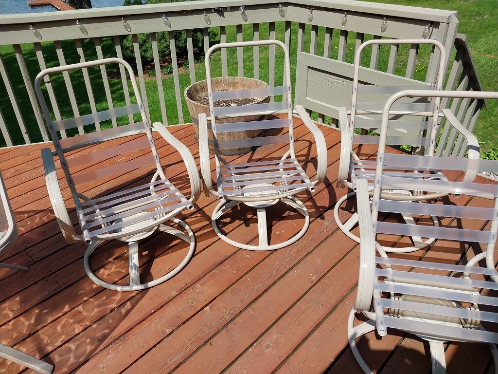

After:
