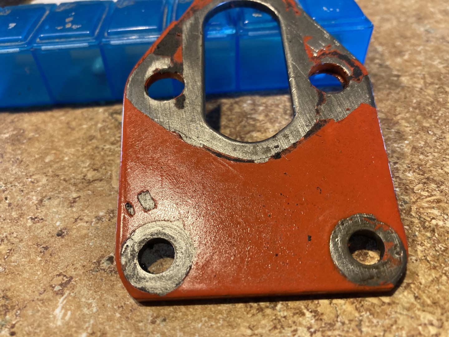

Well I took the fuel pump and plate off. It appears there may have been a leak at the bottom of the plate. Gasket looks like a cheap very thin gasket. Wounder where you can get the best? Maybe a very thin coat of RTV. Appears re-builder put the gasket on then the two lower bolts but did use anything to fasten the top 2 fuel pump bolts and then painted the plate/block, probably figuring the gasket would seal when installing the pump. He also did not put any sealant on the side bolt John mentioned.

The grey gasket material left on the plate appears to be Fel-Pro and is a good gasket. Should be able to get them at most any auto parts store. If you have a flat piece of metal laying around, hold a sheet of 220 grit wet or dry paper on it and sand both sides of the plate a little to see how flat it is. If it's close, sand more to get it better. Then clean it with alcohol or acetone before installing. The pic is the ONLY gasket sealer I use on anything with oil in it anymore. Again, available at most auto parts stores. I don't know if high temp is designed to withstand oil.
The surfaces of the block and plate need to be cleaned with alcohol or acetone and dry before you apply the sealer. My suggested method would be to have 4 short bolts for the plate ready and once you install the plate, snug those 4 bolts down and let it sit overnight. Make certain the pump flange is super clean with alcohol or acetone too and install that the next day. You only need a very thin film of the sealer to have it work properly. I would let that sit for a few hours too, to let the rtv set up well. You can switch out the rod holding bolt for a shorter one with a Little sealer on clean threads at this time... ;)

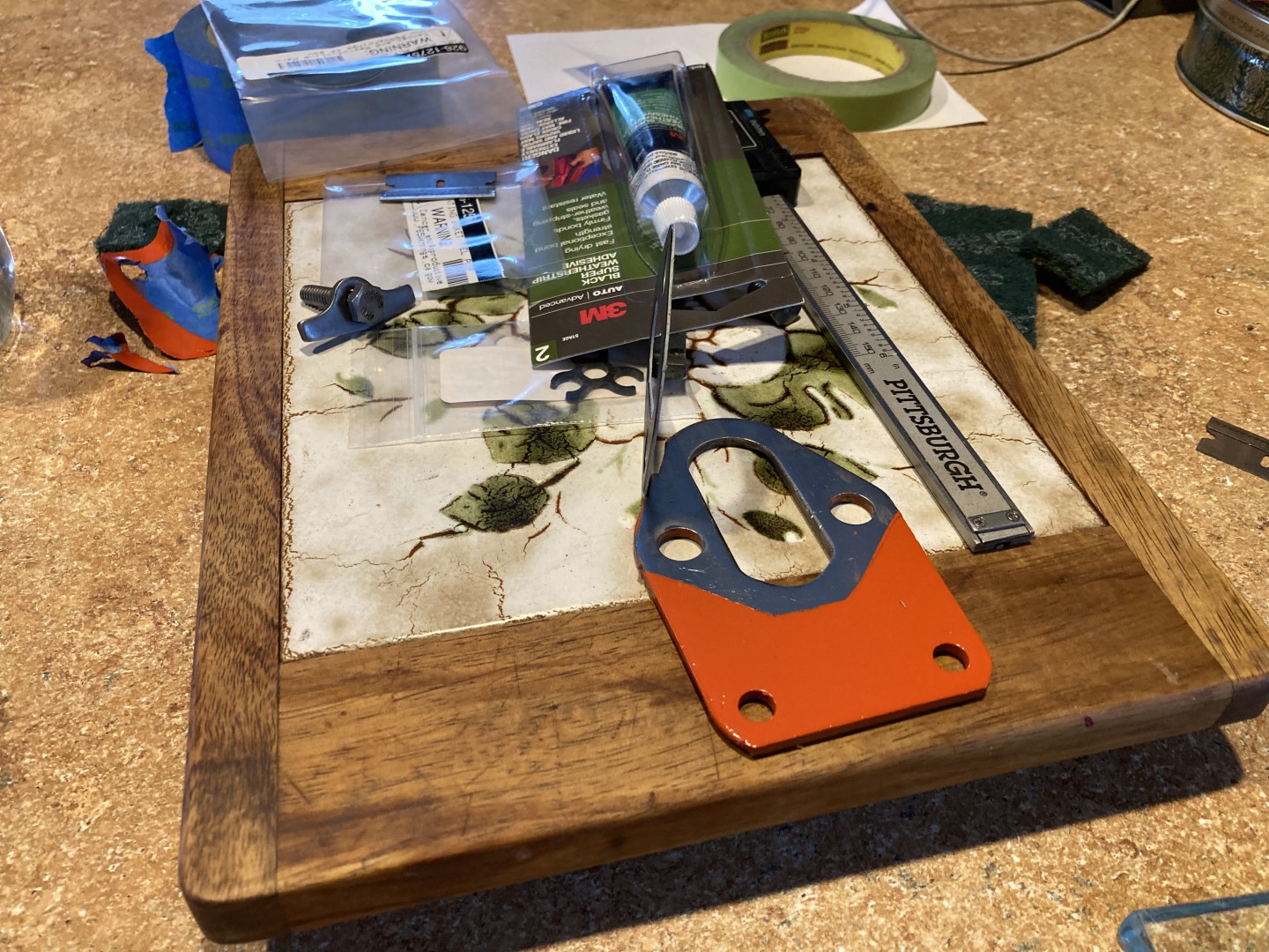

When I rebuilt my carb, I leave the throttle plate by using a 1/4” glass plate with wet sandpaper. I don’t think the plate is flat now. Ordered the gaskets from speedway today.

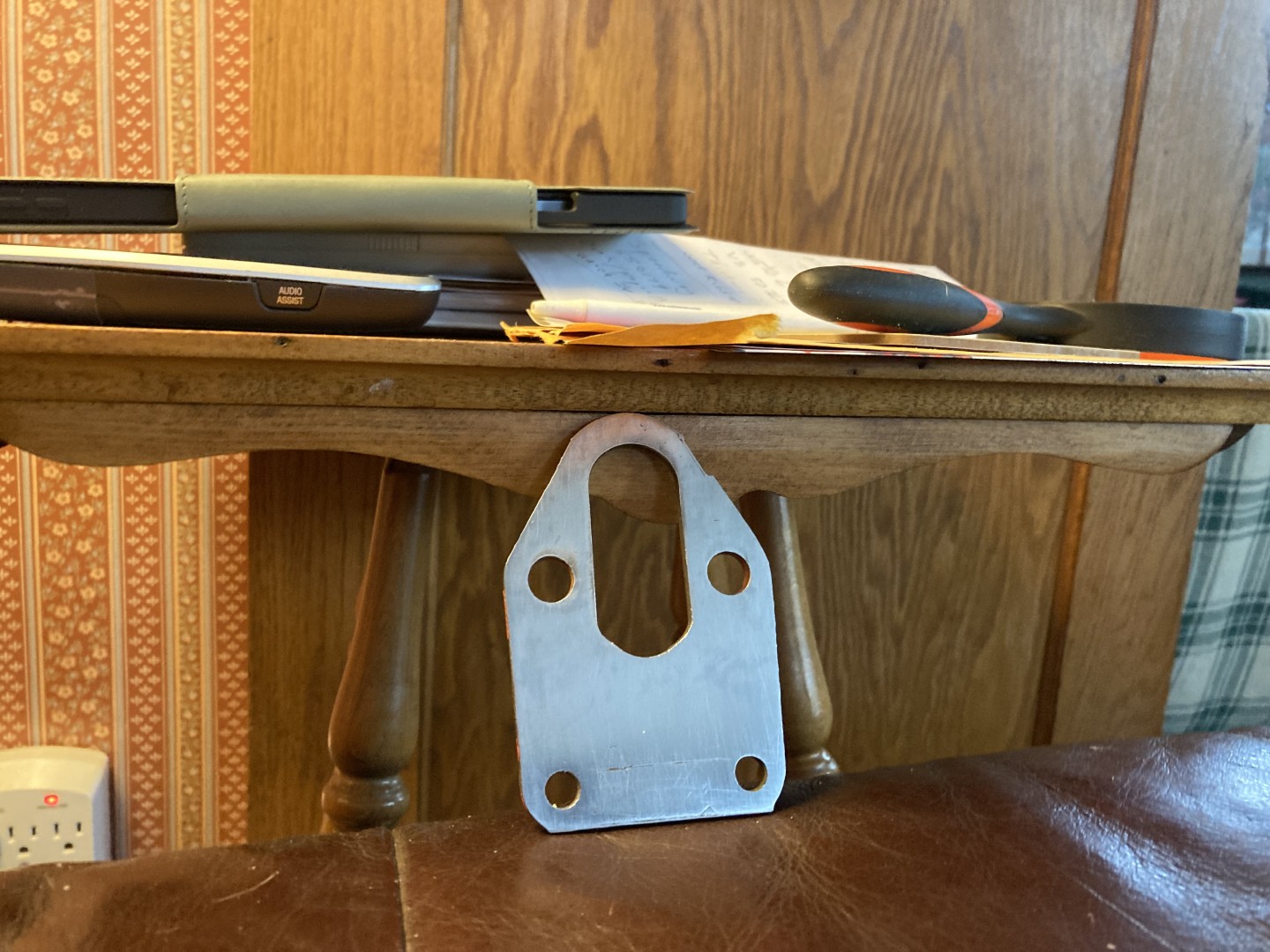

i just finished a little wet sanding. Does it loo OK? Looks like a few scratches, do these have to be sanded out? I can take all the paint off the front side, looks like they used a little etch primer. Installed the plate, the painted along with the test of the engine. I would like to paint the outside before installing. Would it be OK to paint the outside before putting on the fuel pump gasket?

Did you order the Ultra Black sealer too ? That "scratch" looks more like something struck it and bent the plate. I can see the sanding hasn't touched the plate across the entire bottom, inline with the holes. The other side supports that theory. I see sanding across the bottom and at the slot hole, but not much between on the paint. What grit paper are you using to sand ? Only sand lengthwise and don't use water. Use the paper dry. The slight texture the sand paper leaves will actually help the gasket seat and seal. It's easier to see where the high and low areas are on the metal too. If that plate is bent, it will need to be filed/sanded flat, tapped flat or replaced. We aren't ready to talk about paint yet. Yes, to positioning and holding the pump rod before you install the plate.

You did fine pushing the rod up, but it may be on the cam to push the arm on the fuel pump. How much did the pump push back on the bolts as you removed it ? It's entirely possible it's OK where it is, but it won't hurt to check it by turning the engine over and feeling the travel by hand.
220 dry is good. Put some pressure on the plate to get the grit to dig in, we want to see the pattern.
I don't trust paint under a gasket not to break down over time and leak. To paint the plate, I cover the area where the pump goes with blue masking tape, except the pump arm hole, lightly bolt the pump on the plate using short bolts/nuts and then cut the tape around the pump with a sharp razor blade. Remove the pump and excess tape and paint.
