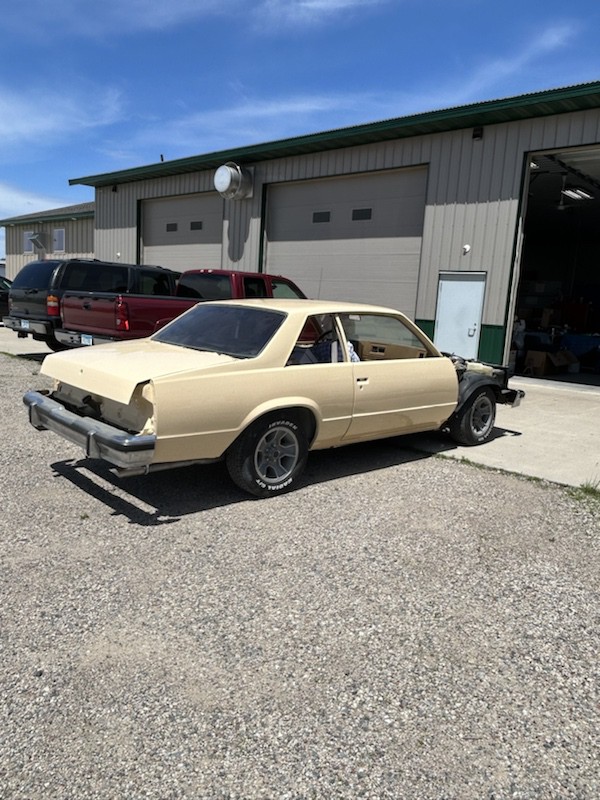

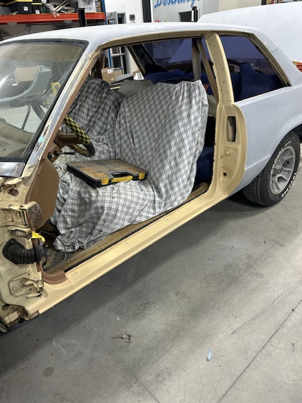

Scot was on Vacation this week too.
He is motivated on his 1978 Malibu.
Now that the differential in re-geared, he really got rolling on the Body and paint.
Had original Lacquer factory finish except for the passenger door.
Lacquer is not compatible with todays' products so it must go.

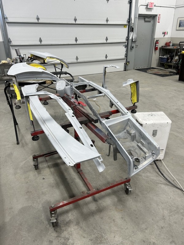

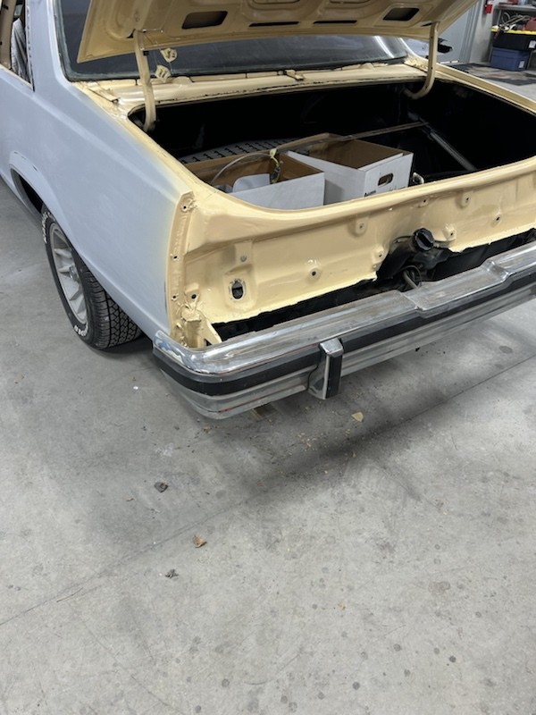

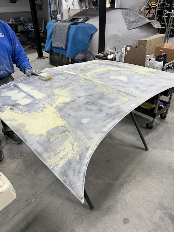

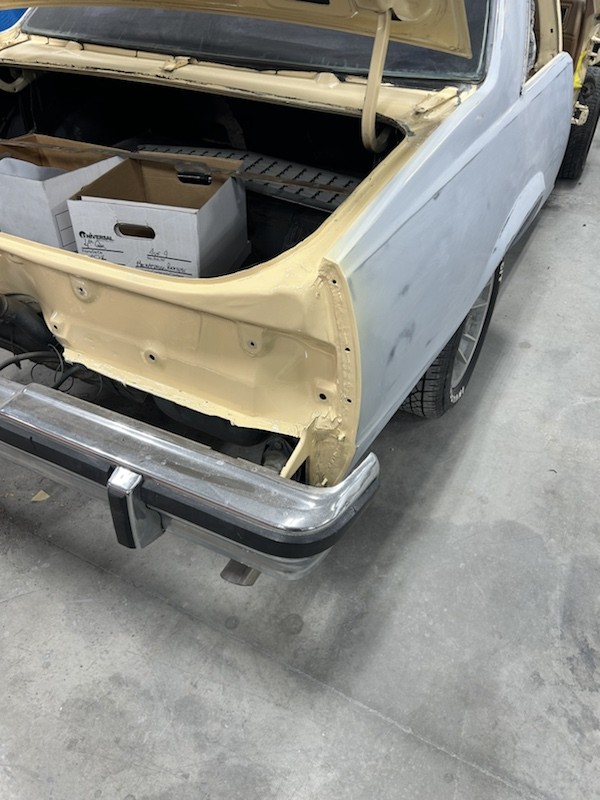

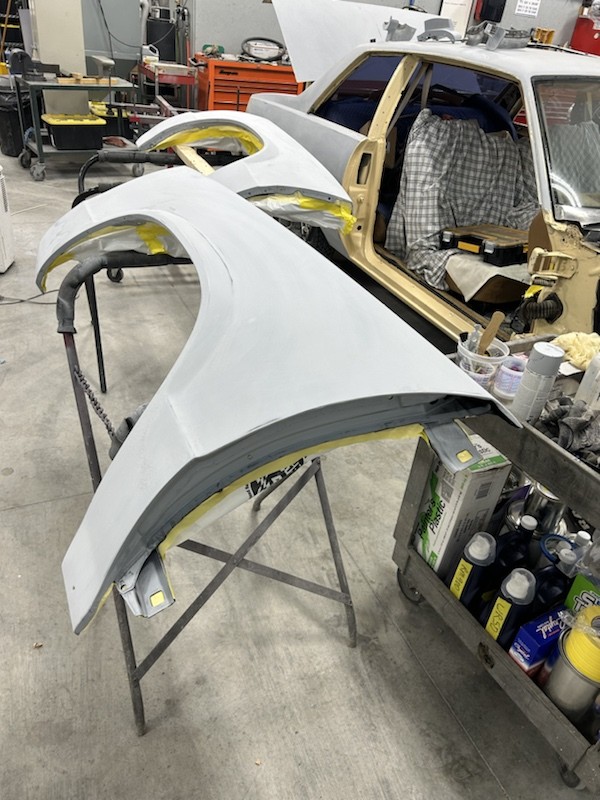

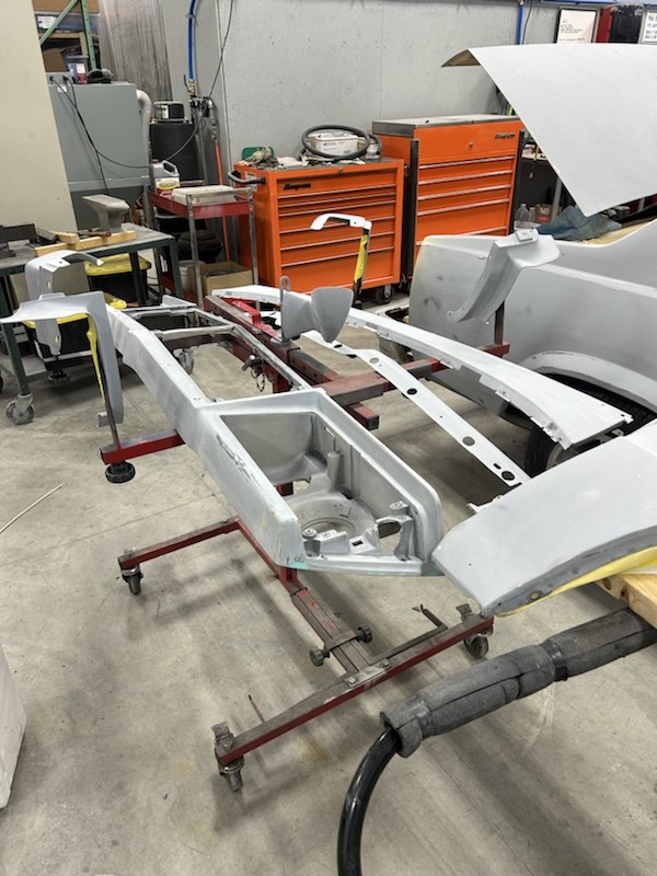

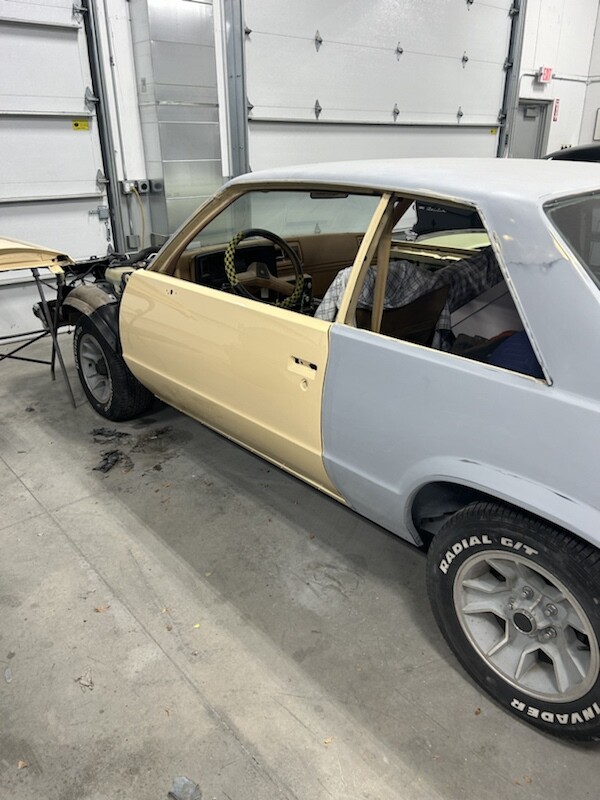

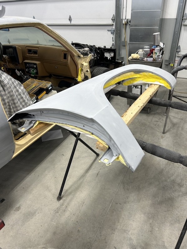

He Stripped Roof, Trunk, 1/4 panels, L/door and rocker panels, did some PDR and some Chemical filler work, primed.
We also had a spare pair of fenders and a hood that were dragged back from a trip to Williams/Flagstaff Arizona several years ago.
They too were stripped and repaired.
All priming with a high build primer surfacer.

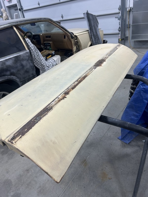

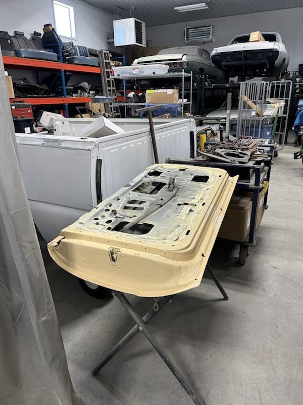

Passenger door has issues, we have a spare.
Going to strip and see what is really there.

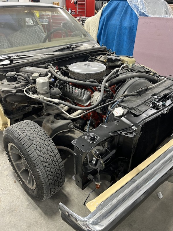

This car is a 68,000 mile unit from Pauls Valley Oklahoma, it has a fresh 355 200 4r OD tranny.
Rock solid, dry car, Miss Buela bought it new, one owner, only real damage was the Passenger door, poorly repaired cracked header panel.

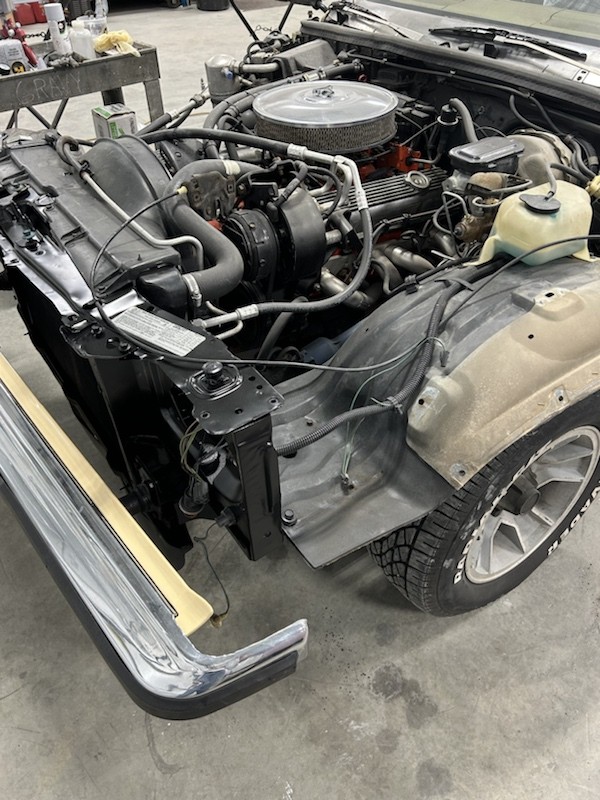

Progress pictures:

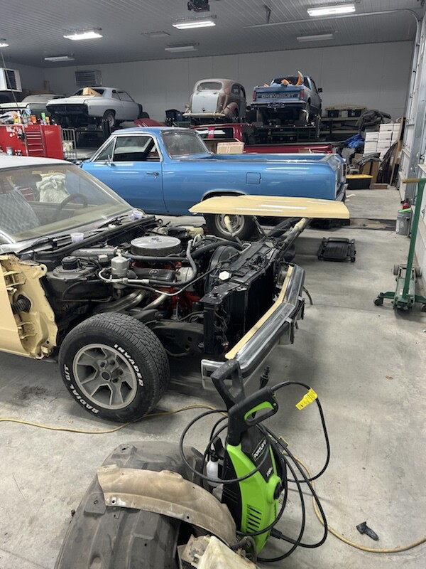

The current dirt/dust status of main building says "discs"
Glad I bagged the Camaro, much blowing and sweeping to be done.

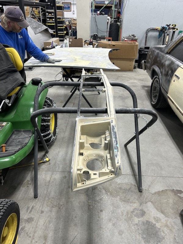

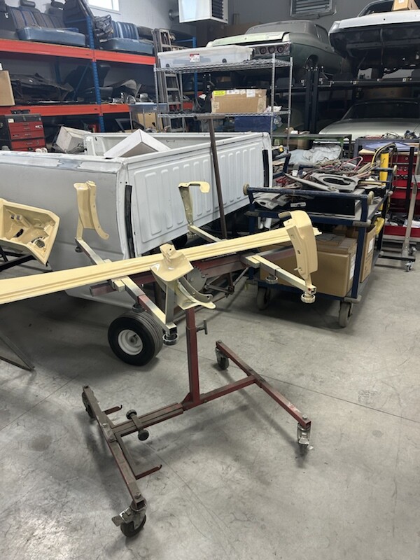

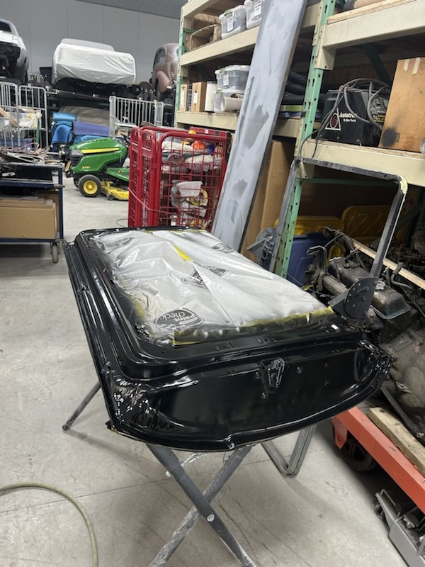

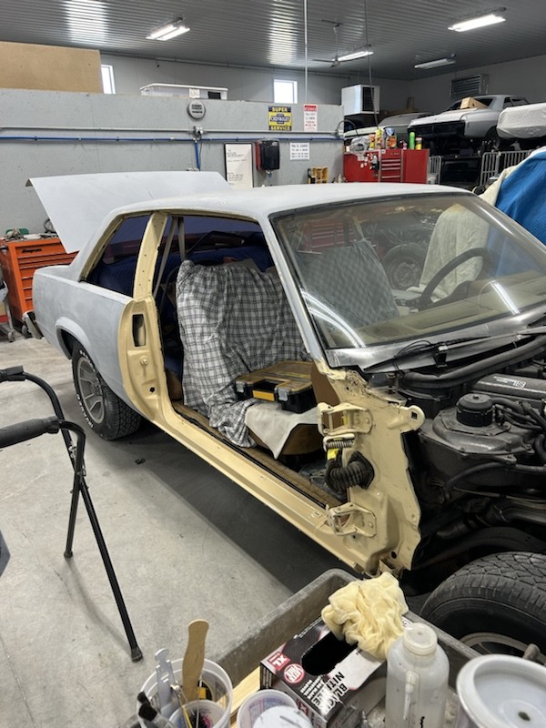

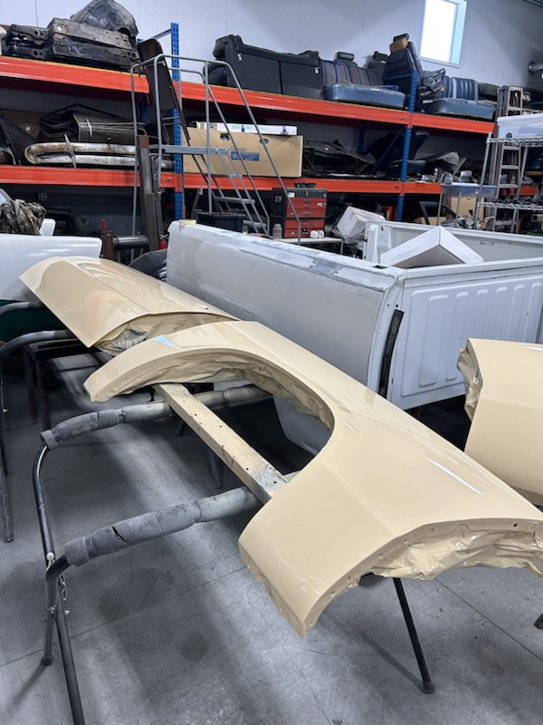

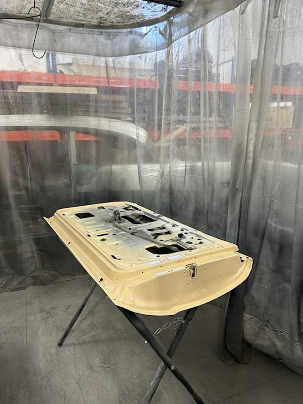

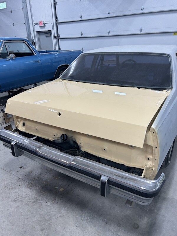

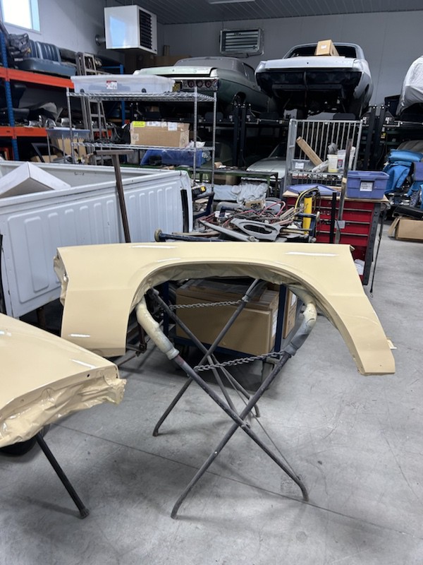

As it is a solid color, painting in pieces.
Parts prepped for color.

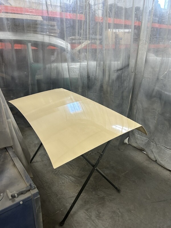

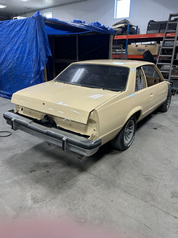

Some more color. Remember, he can only seal, rotate out, seal next etc.
Then same rotation for base coat, lastly clearcoat, one at a time.
Some dirt chunks, mosquitos, however, parts have color on them.
Spray area is designed for prep of small areas, light refinish product application.
Obviously, some creativity involved to do more than one part at a time.
Pieces next.

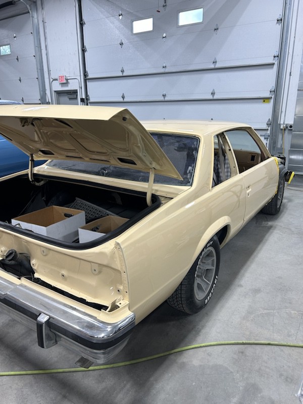

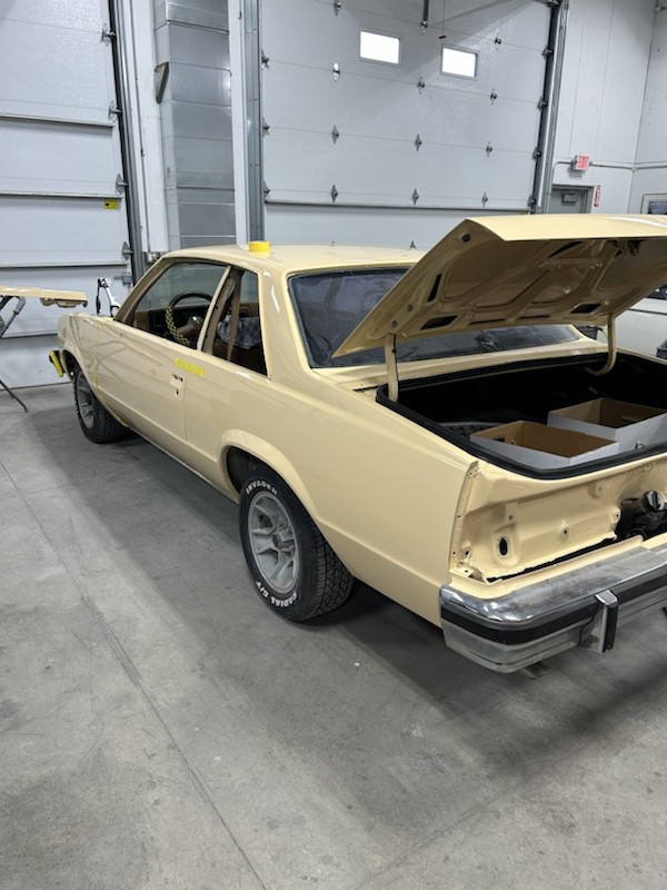

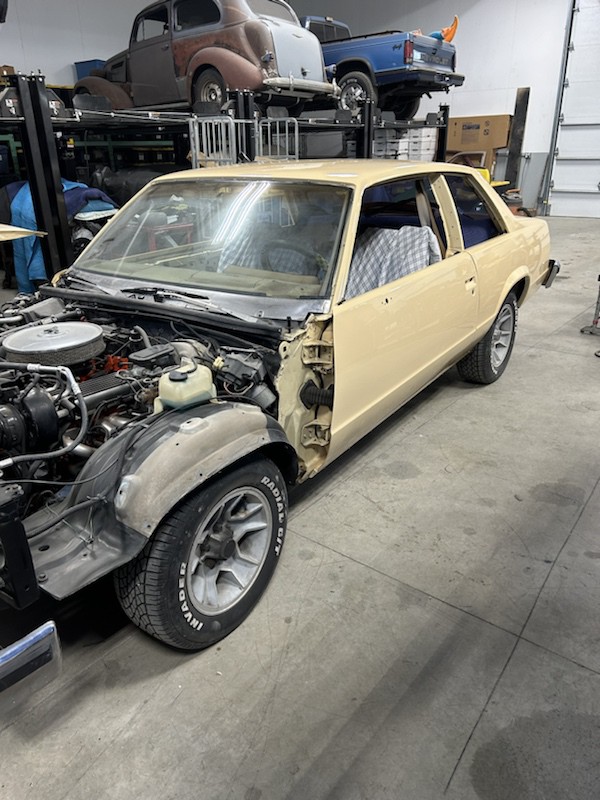

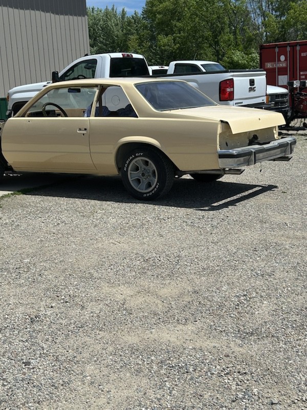

Some color sanding, buffing and a little detail.
Rough reset the doors.
Just ordered trunk, door and roof rail weatherstrip.
Roof rail weatherstrip on backorder, should have ordered sooner.

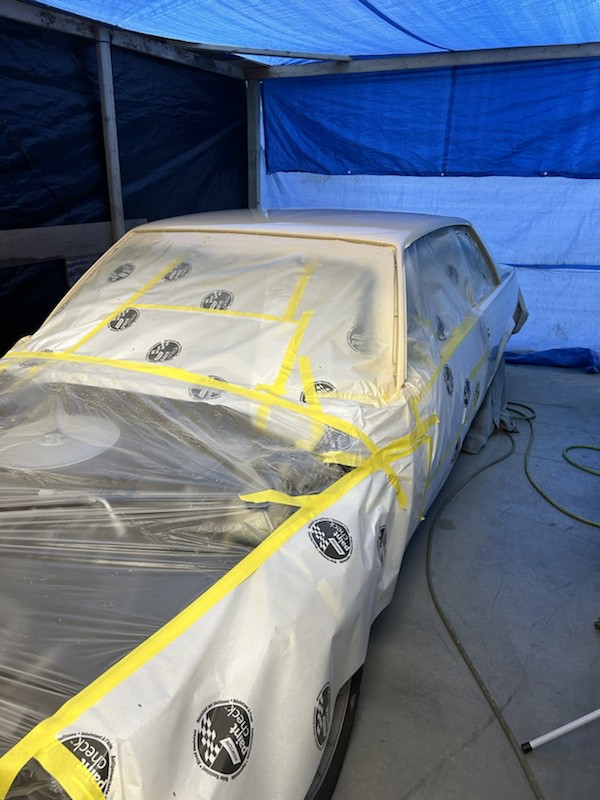

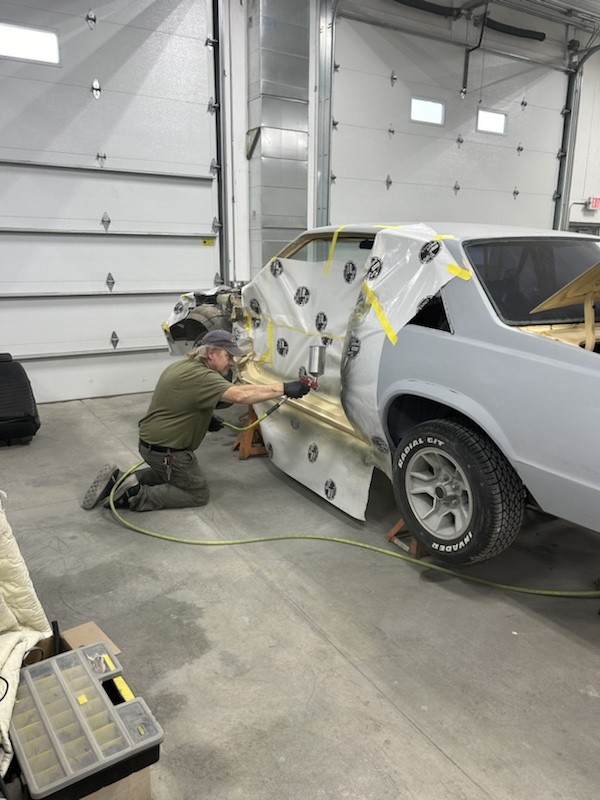

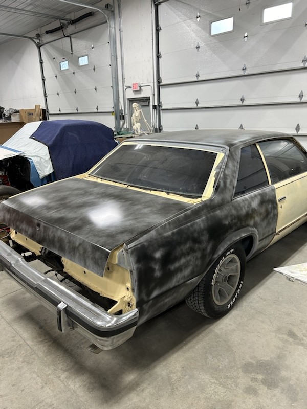

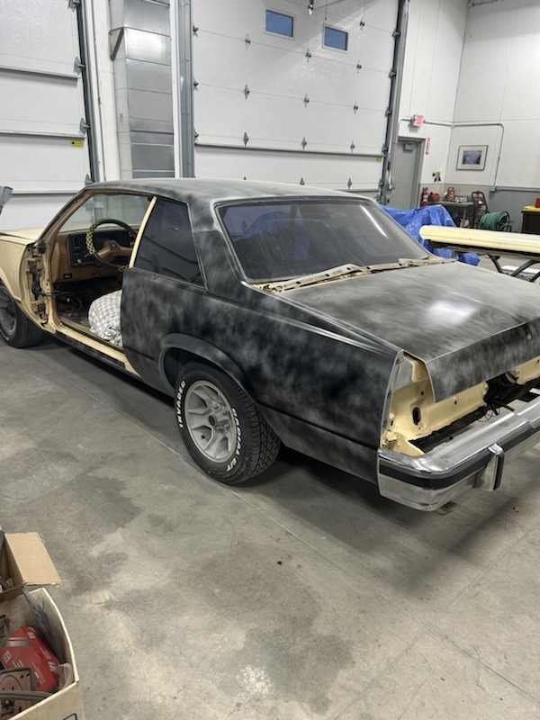

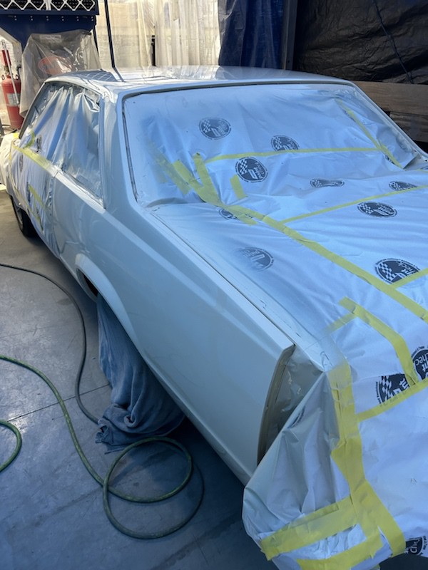

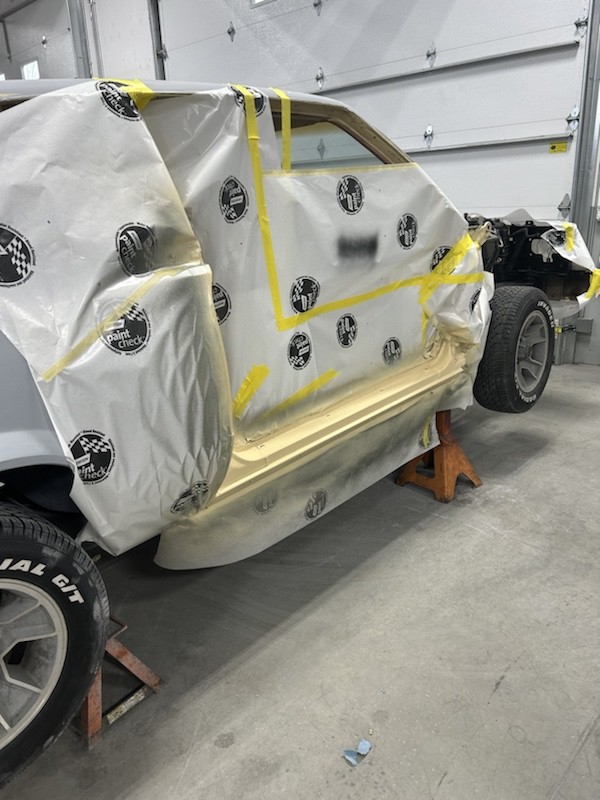

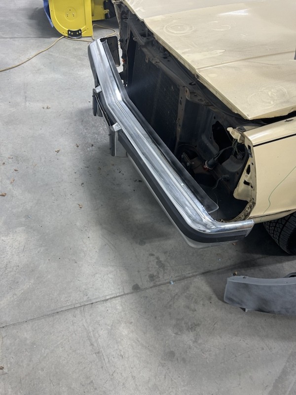

Scot continues his efforts. Built a spray area, using the prep station for ventilation.
Not remotely OSHA compliant, however, it worked really well for body.
No where near enough airflow to be legal.
Does minimize dirt in finish though.
Roof was almost dust free.
Lighting was not very good, and color picked up blue tint appearance from the tarps.
Like spraying with your eyes closed and hoping for the best.
Still, VERY pleased with outcome.
Had been several years since he sprayed anything major.
Masked up in the "Booth"
Looks really good !! Happy to see he has it in color and can start re-assembly.
Looks familiar, and it gets it done.

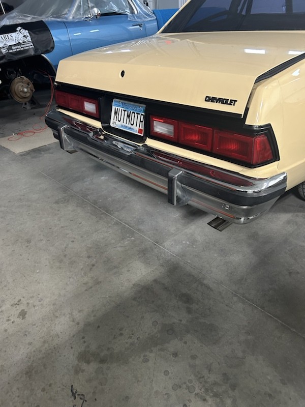

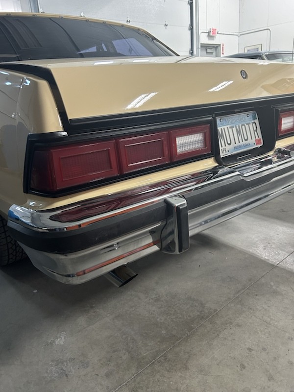

Rear assembly and detail.
I had the same color 79 back in the late 80's. It had buckets and a console which was a cool option. Not so cool option was the 267 V-8 with 2.56 rear end gears. Slowest vehicle I ever owned.

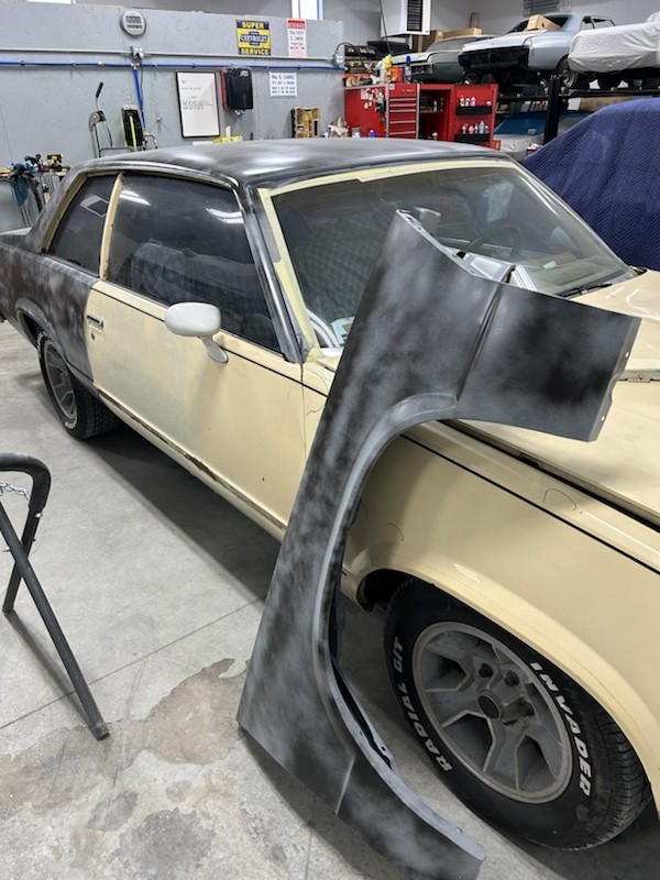

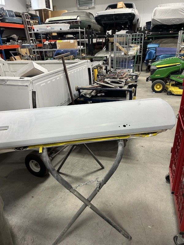

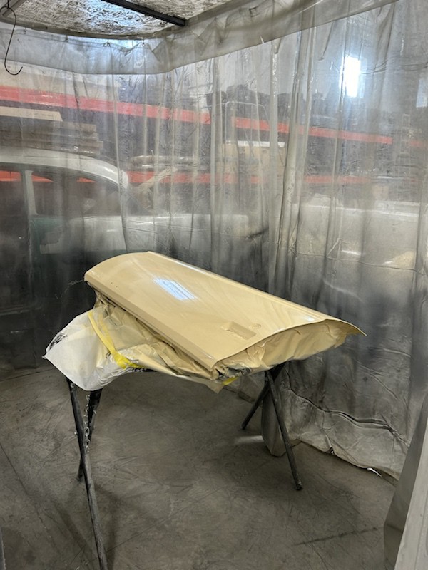

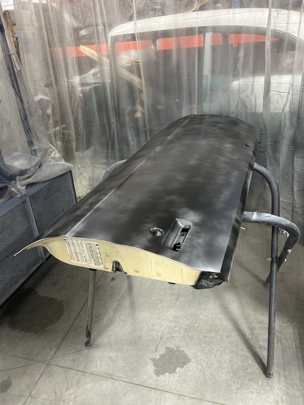

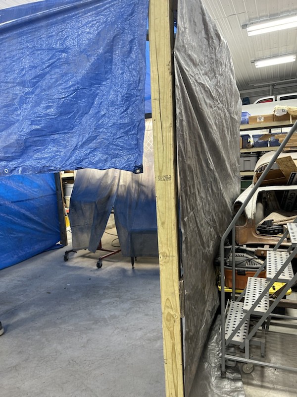

Looking good.
Pieces next.
