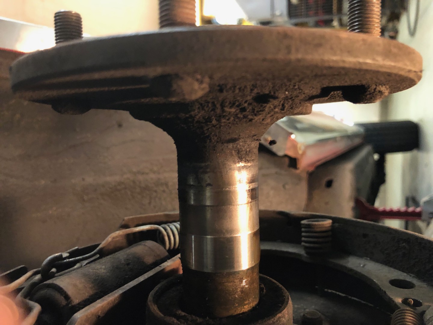

Well Mitch I would have to disagree, although very worn, I don't see anything on either axle that would cause that noise, also bearing typically will only make noise when loaded.
Bruce, the one axle also shows high wear, unlike Gavin's axles which were showing a fatigued failure, two different types of failures, both high miles. This could be caused by some type of contamination and a lube that has been run for 30 to 50 years, wear metals from spin out causing thrusts to burn is somewhat likely with these cars unless granny was behind the wheel. So I would check for parts of thrust washers/sludge in the bottom of the housing, next when you pull the pin for the spider gear and check for wear or galling. But don't forget to wiggle the diff case with a bar before you take things apart.

I can send a picture once I get back into it. the center gears look good and seem tight.
The drivers side seal was leaking oil, but the rear end was still pretty full, just a little below the fill hole.

Sounds as if you may have avoided the slippery slop, with the gears tight, that tells me the thrusts are in place and not burn/worn out, and assuming you have checked for loose pinion/carrier I see no reason to go dig deeper. Not to say things are prefect inside, should still get plenty more miles out of it.
Mitch's comment about axle being "consumables" is spot on, but, they are still axles not bearing, therefore axles used as a bearing will not live as long. Axles need to be able to handle the torsional loads and therefore would not live if there surface were as hard as a bearing surface.
When you get your axle end bearing out, look inside of them at the rollers for pitting/spalling also outer race if you can see it, chances are they will look good.
