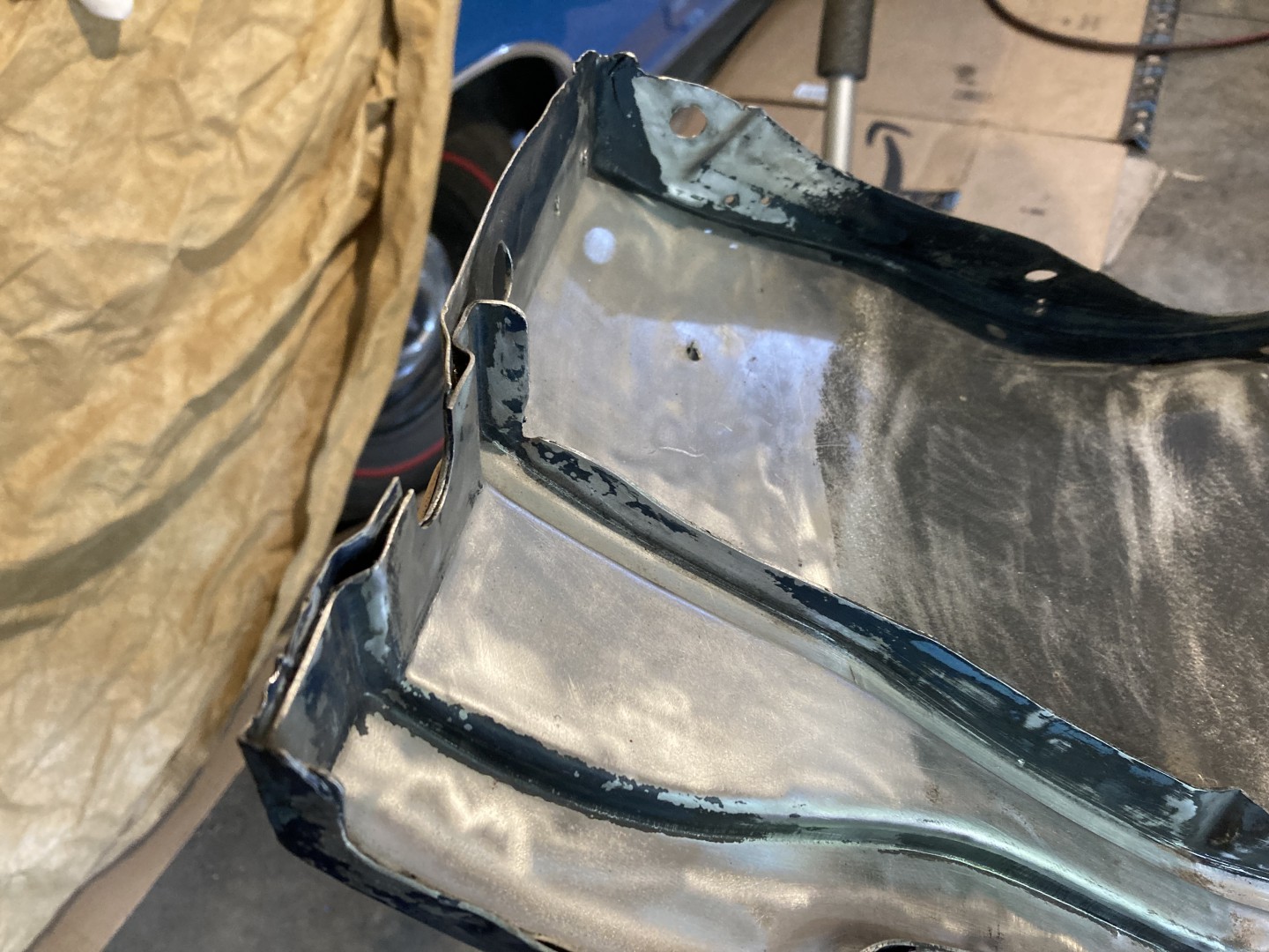

I found the brace and it's not as good as I remembered. It's quite rusty at the bottom where it folds to become the lower bolt flange. I'll hang onto it until you see how yours is. It would still be useful for above the rusted area.

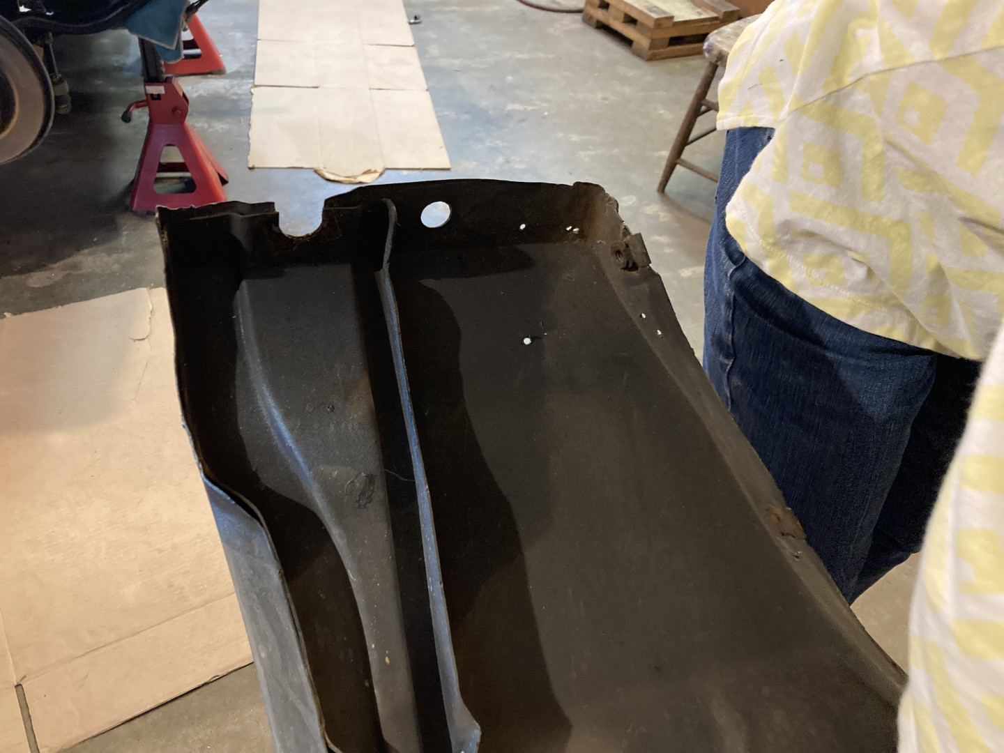

A friend is coming over tonight To help me lift the fender off. Only 3 loose bolts holding the fender on. I have another pair of fenders but the braces are toast. I think the brace is good to go. I hope the fender rote has not creeped too far. The filler panel moldings and clips look pretty good.

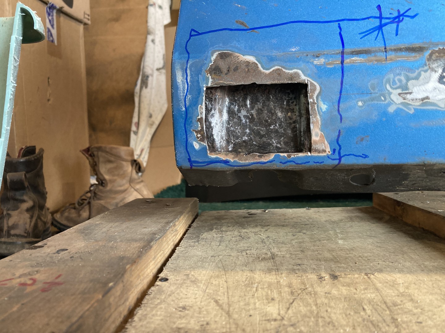

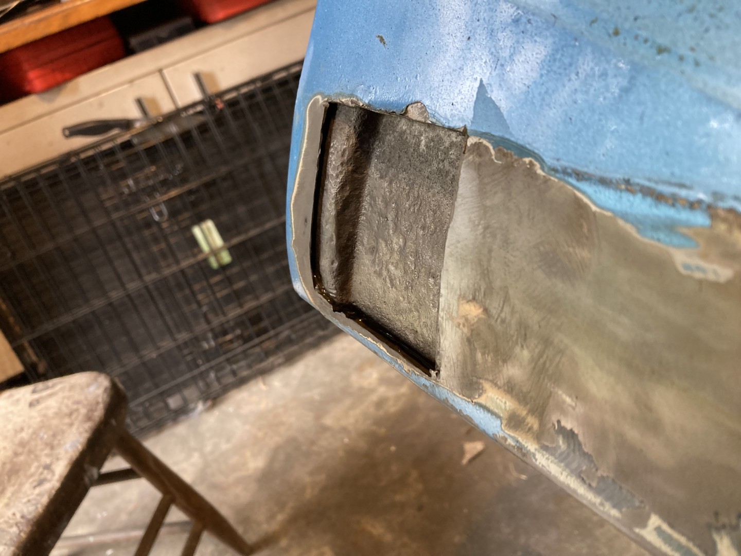

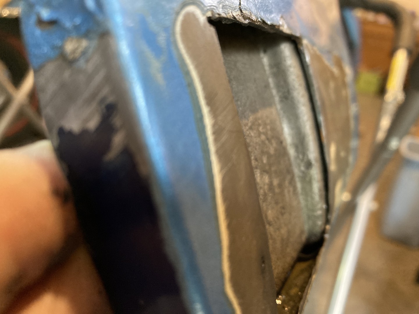

Today I cut out a little more of the hole to get to good material. And cleaned the brace a bit. Brace looks like it wI’ll clean up. I am soaking it in Evapo-rust. Screws and nut assemblies, shims also soaking. i think I may have to cut out more (to blue line) to get the brace cleaned . I don’t really want to replace to large an area. And then I can keep the shape as best as possible. I have decided I had better work on one side at a time. Now I will have to clean and paint the inner fender. It still has all of the original undercoating intact.
-- Edited by jim larson on Wednesday 13th of September 2023 12:50:43 PM
-- Edited by jim larson on Wednesday 13th of September 2023 01:06:42 PM
Let the evaporust work for a few days. If you can keep the cut 1/2" below the trim line, it will be easier to blend the weld.

There still appear to be pinholes at top of cutout.
Rust is a "Cancer" surgical removal of affected area is almost mandatory.
There is no "radiation", "Chemo" or other options except for fresh material.
Envirorust will not adequately neutralize the corrosion beyond the surface in my opinion.
On a positive note, we can cheat a little as many of our cars see seasonal use only, rarely get wet and we can load repaired area with a rustproof type material.
Keep the moisture and air away and it will dramatically slow the progression of any corrosion.
Do not forget to use weld through primer, unless Mitch has other ideas.

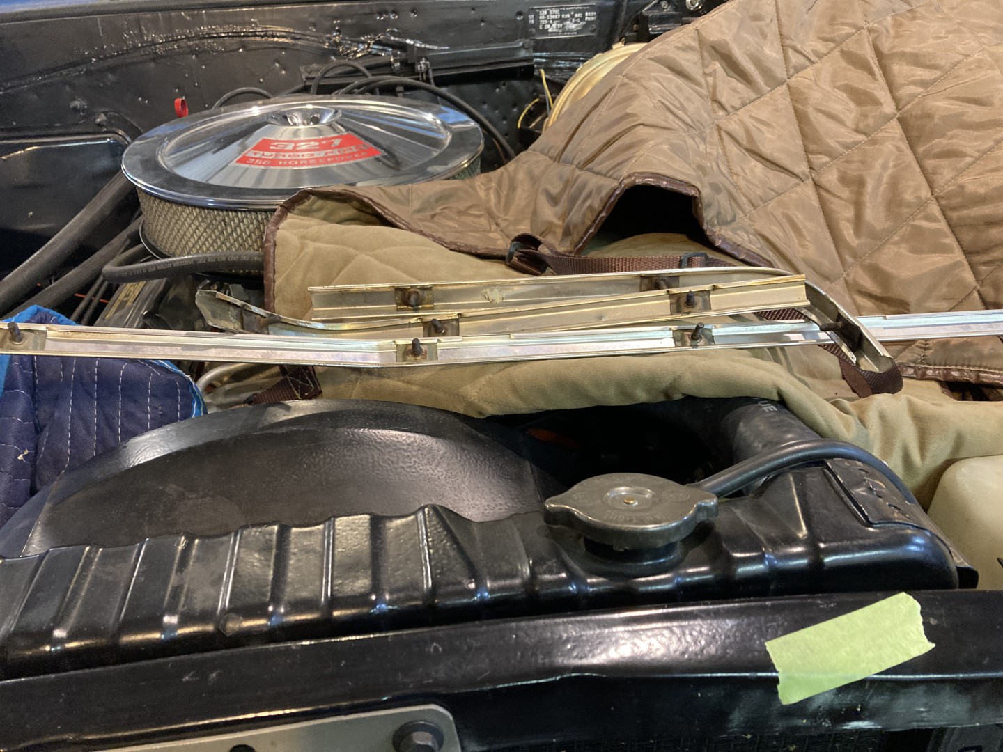

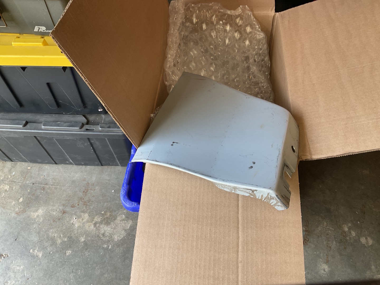

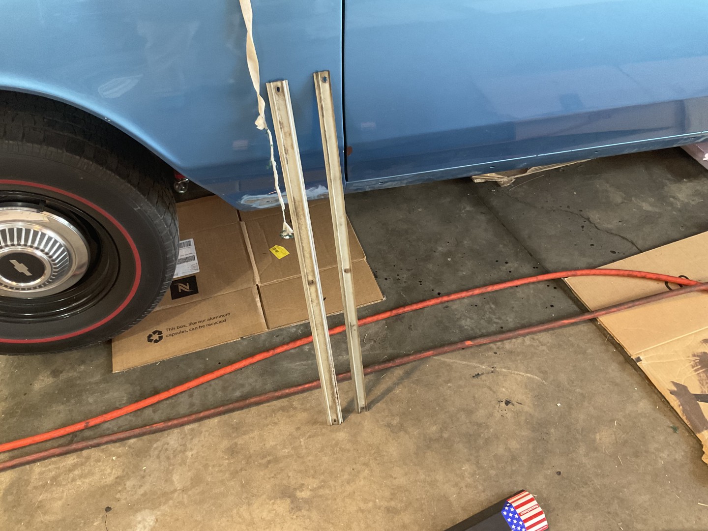

The guy who restored the car in 97 used some sort of bracket, 2 per side to hold the rocker molding on as opposed to the clips. Used screws to hold that to the rocker panel. So they drilled holes in the rocker panel/fender. Maybe I should put back the original style clips. That may be the pin hole you’re referring to. Working on getting the junk the restorer sprayed all over the underside and the factory undercoat or sound deadener off. Going slow but coming along.
Wondering how we could place the rusted area as all of it is hidden by the fender brace, unless you drill holes in the brace from the backside.
Have you considered doing a lap joint repair with your patch panel using a panel adhesive? You could avoided all the heat issues generated with welding and it would probably be much quicker.

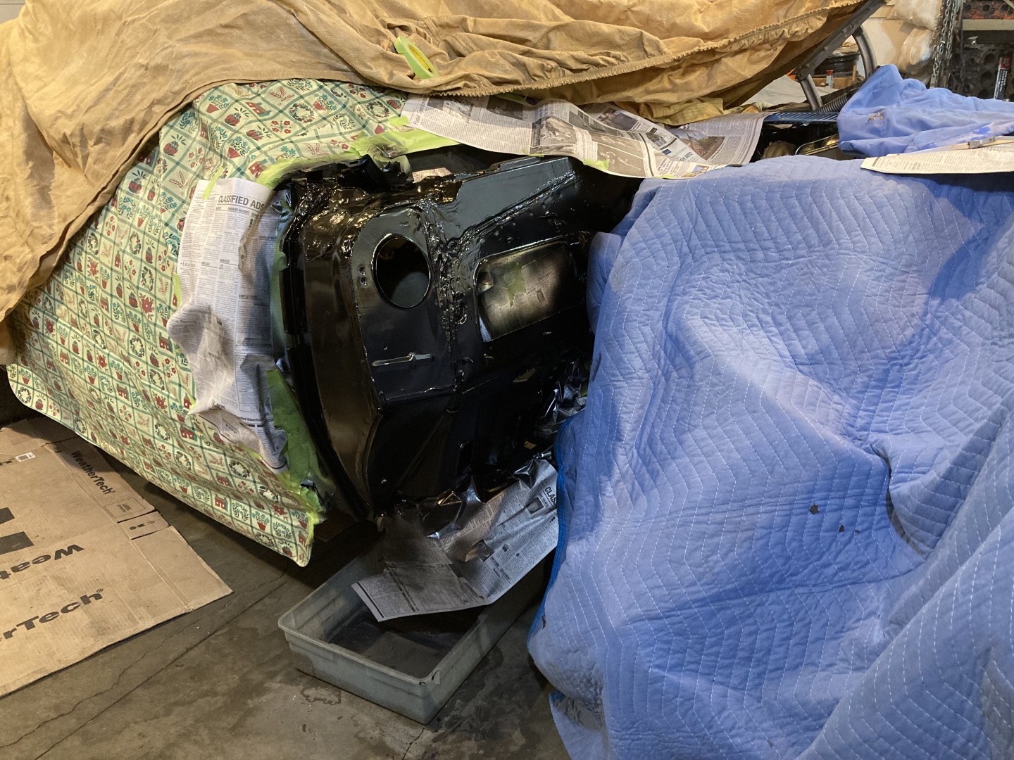

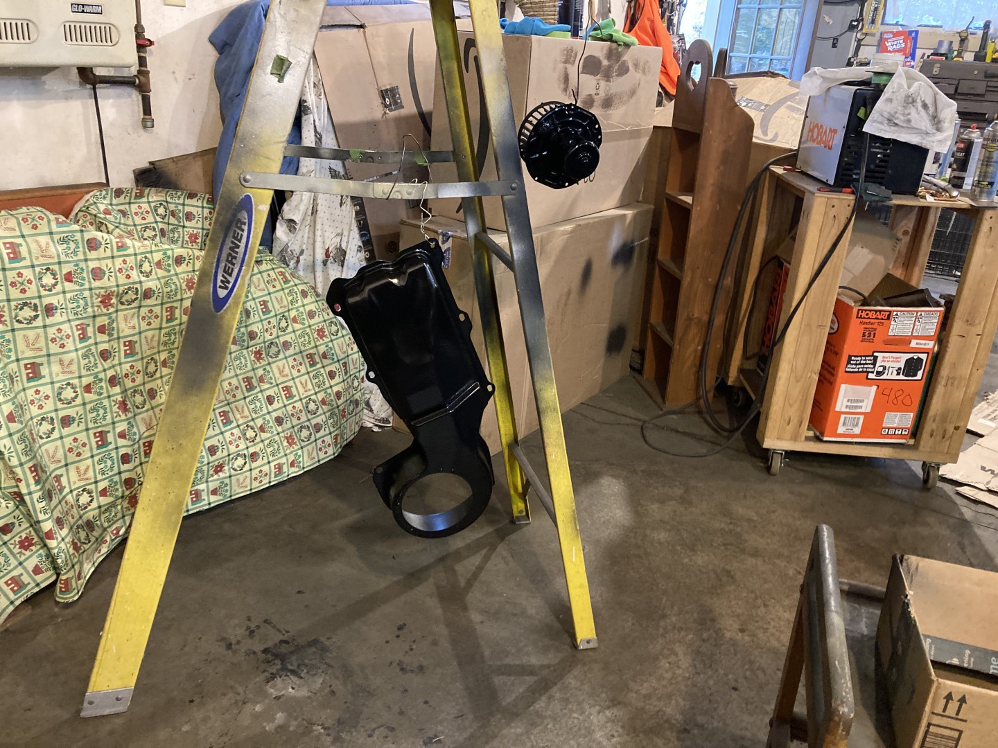

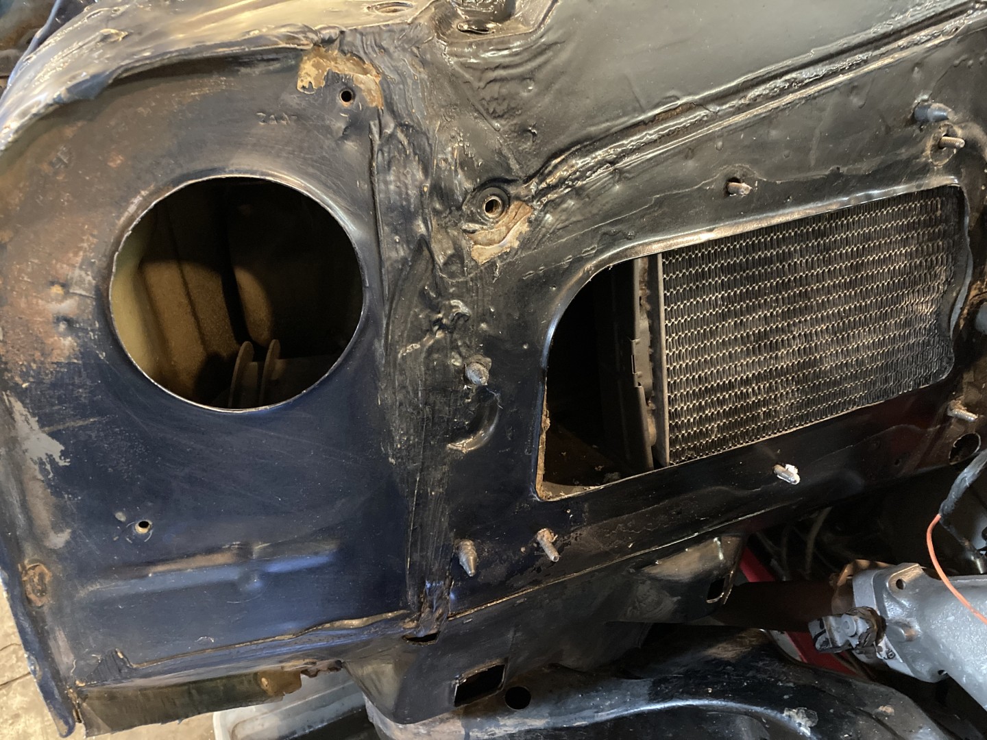

It was difficult getting the 58 yr old dirt and rust off the cowl area. And the fan/heater core. interesting that the area was pained the original Danube Blue Body color. I dropped the inner fender off at a body shop here in lake city to have any rust pits sandblasted and filled. Slow but steady progress.
Soft-Seal kit, what a good substance to hold the seal in place?
-- Edited by jim larson on Wednesday 20th of September 2023 05:56:35 PM

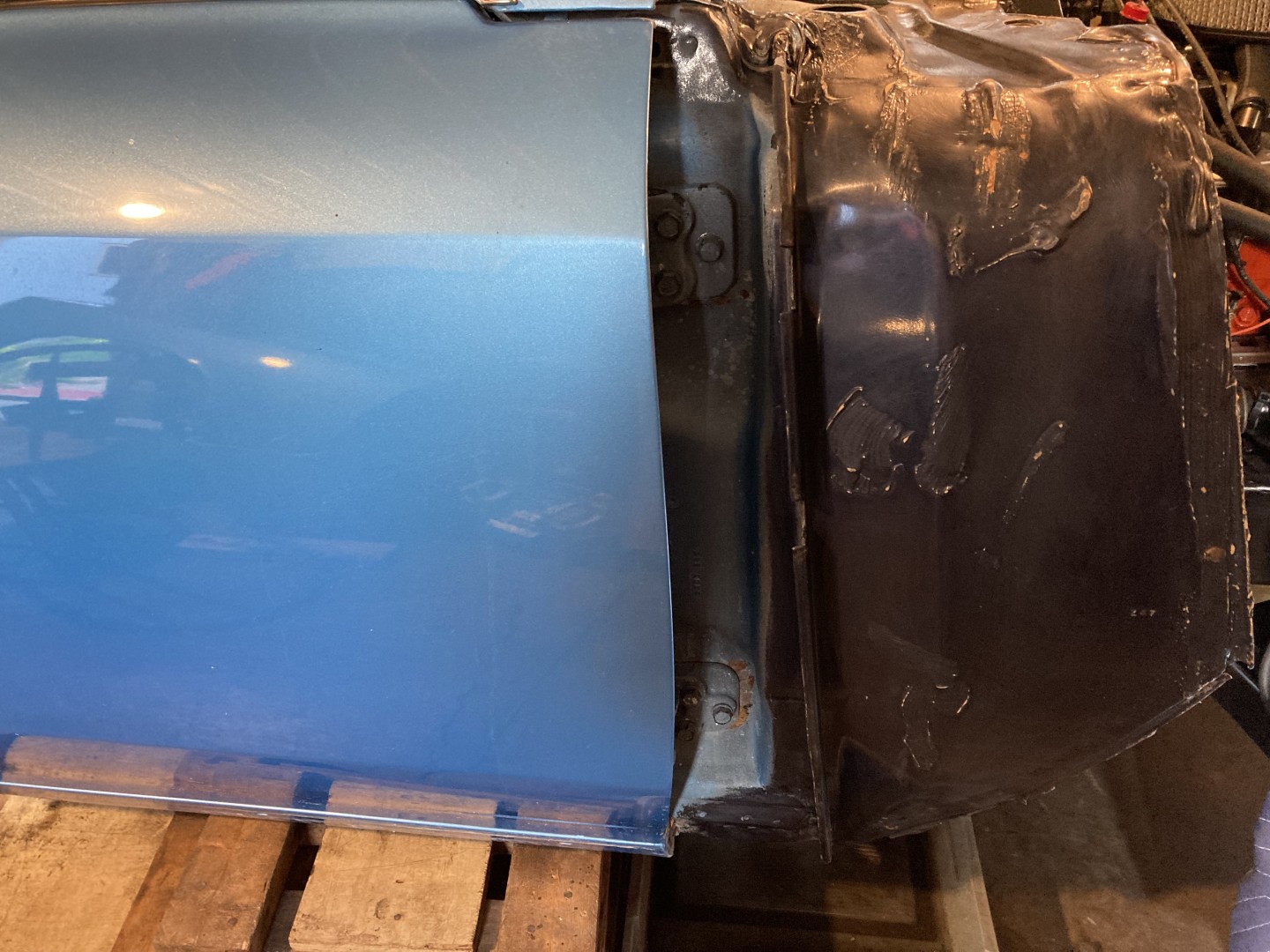

Fender looks really clean. I'm hoping I can slip the patch in between the fender and brace from the front. It looks like it should fit.
a couple of phitos

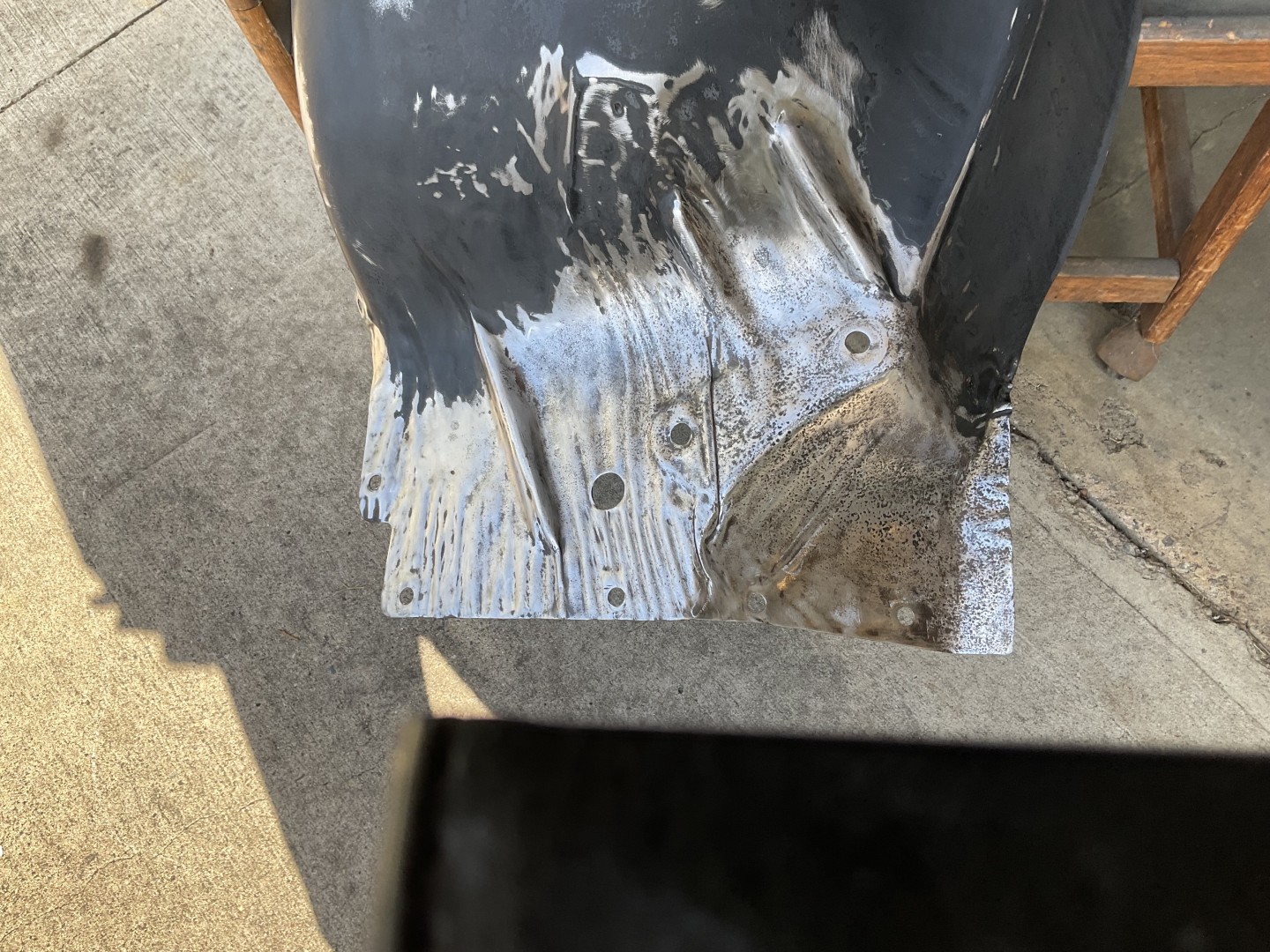

Moving slowly. Should get the inner fender back this week. After painting it, it’s time to get back to the fender.
