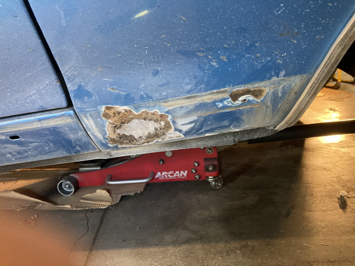

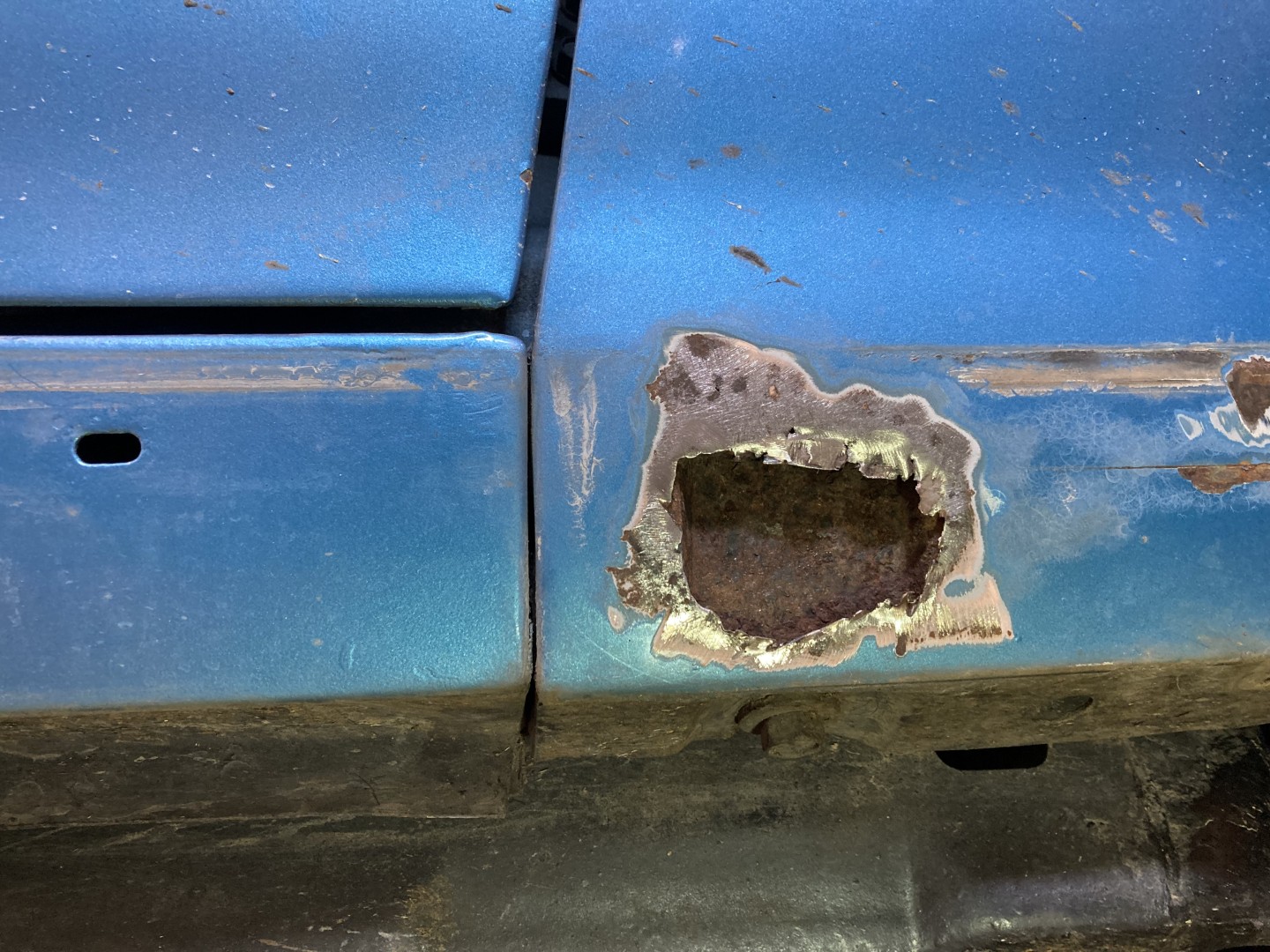

One screw assembly on front fender exposes a problem. I got the spinning screw out, saw a possible rust issue, Checked it out, all is good. But I thought I should check the pass side, so removed the rocker molding on that side. Need too take a step back and decide how to proceed. Hope that most of the back brace is still there.

Unfortunately, after 57 years these cars always have multiple surprises.
Are you going to drive this or keep trying to make it younger?

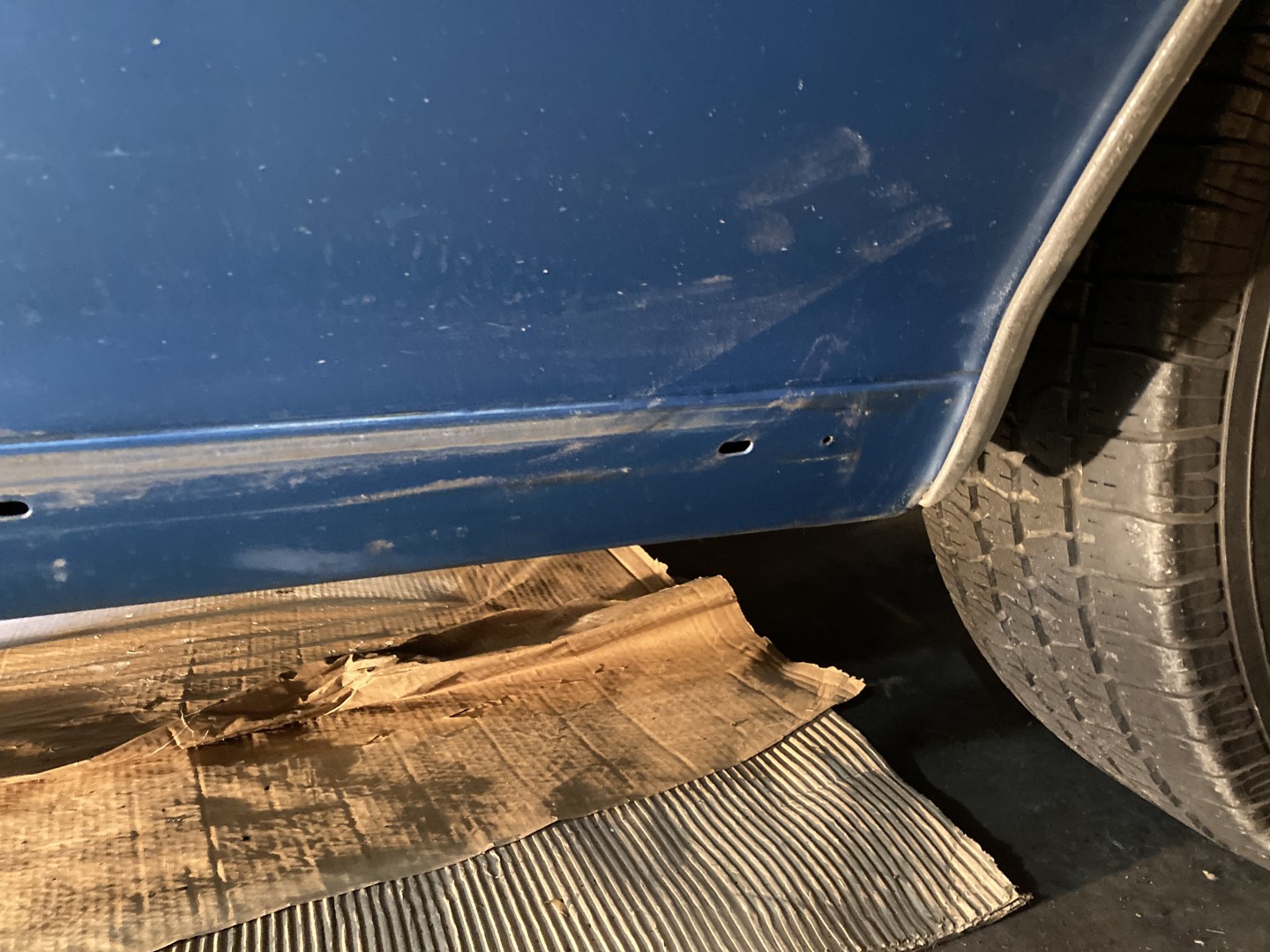

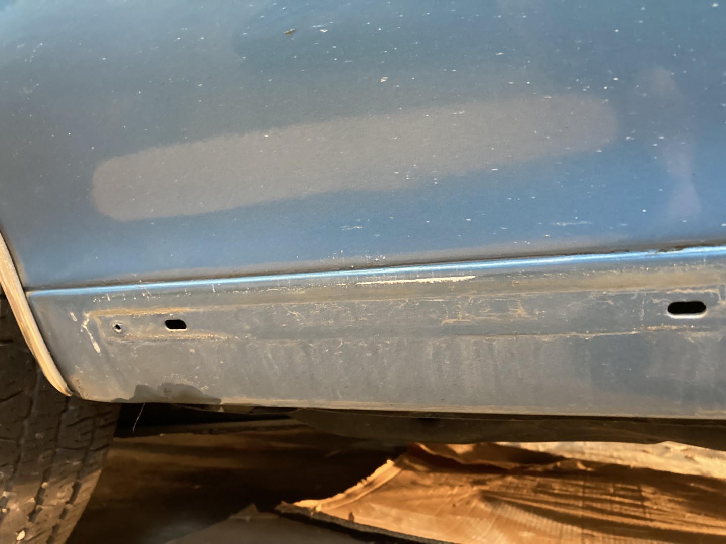

1/4 seams look really good to rocker.
Rockers look decent which is good.
Convertibles have a three-piece rocker there is a stiffener inside inner and outer rockers.
That leaves two lower fenders and failed paint on door.
Perhaps reassemble left side, brush door (even though it will show) move to r/front fender.
No question, to do it correctly, remove fender, cut out affected area, clean rust remaining as well as possible and patch hole.
Remember, Cut out all rusted metal on outer fender, pretty difficult to weld rust.
Finish with chemical filler and prime, keeping area as small as possible.
Blend refinish bottom of fender, keeping area as small as possible.
Worry less about perfect match and be happy hole is gone.
This is the lest intrusive approach and allows you to enjoy driving it.
ORRRRR, start trying to make it perfect all over and send it down the slippery slope of "Body Shop Jail"

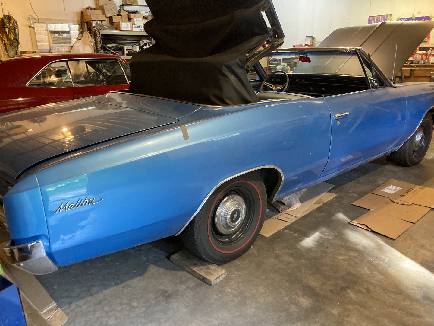

That well the top being just about down lead me to new discovery. With the convertible top down, you can see inside be tween the rear quarter panel from the door back to the wheel house. Happy to report no rust, but lots of dust and dirt. With the rear seat out and rear window glass removed, I think I will be able to suck most of that up. Cleanup to be done after re-paint. Nice cartoon character Mitch.
I could be mistaken however, i believe it is possible to remove fender and NOT pull wheelhouse.
Remove battery and tray for access.
Three bolts at cowl upper, one lower. lower has replaceable fold over nut.
Pull battery tray for EZ access to the last two or three wheelhouse fasteners.
I think ALL wheel house fasteners are fold over nuts.
Drop bumper, remove headlamp door and extension.
Only four or five left at core support upper grille bar and lower grille panel. There are welded nuts in fender for core support, upper and lower grille panels.
Might be easier to remove painted lower grille filler.
This is all based on hood and ultimately hood hinge is removed.
Wheelhouse left on fender just adds weight and makes things clumsier.
