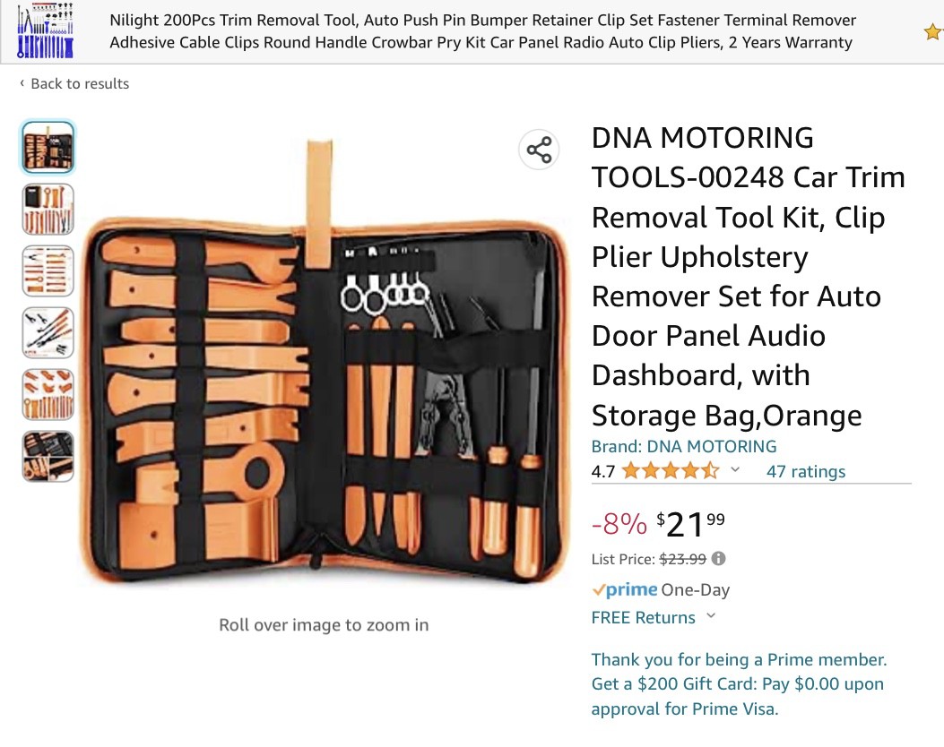

Most every clip remover you’ll ever need. Amazon $22
