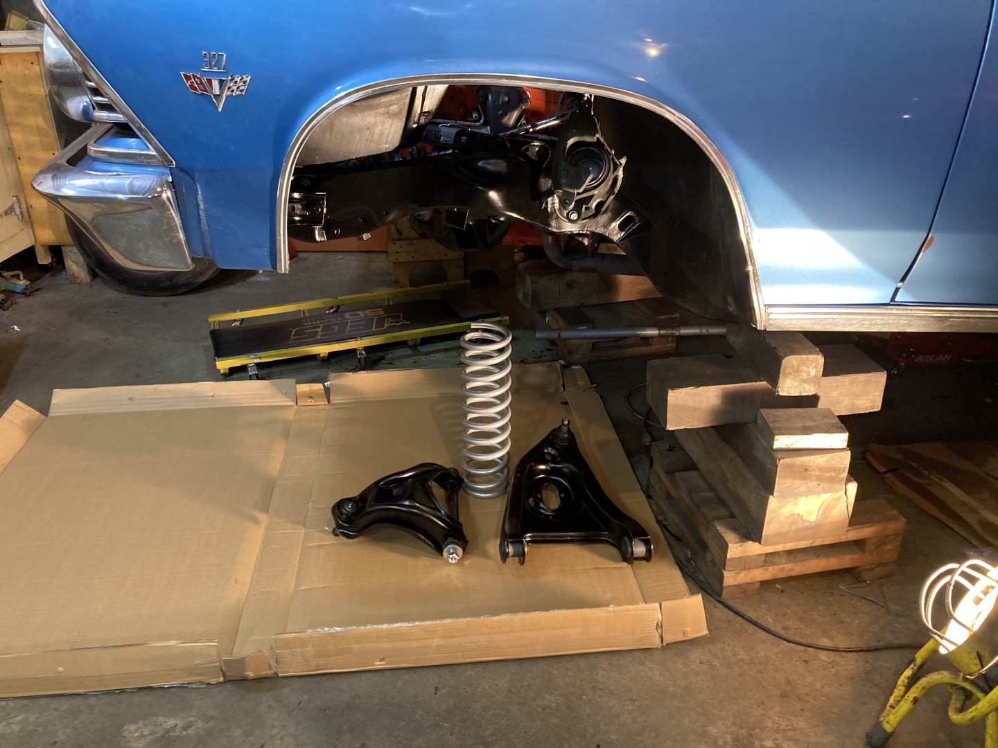

Starting my front end suspension today on the Convertiable
Nov 26, 2022
Only if ordering parts qualifies. I decided to go with the Global West upper control arm Off-Set shafts. Since this is a driver/cruiser and I am trying to avoid a harsh ride, I am using all new Moog rubber bushings. I also ordered new 1/2“ taller ball joints. Going with OE Spectrum shocks. Tear down to begin this coming Wednesday.
-- Edited by jim larson on Saturday 26th of November 2022 09:43:37 AM
Nov 26, 2022
Hope that works well for you Jim. I would not start until every component has arrived, been inspected and is on your work bench.
Dec 3, 2022
Everything is out. Now to remove the bushings and send the arms and springs to the powder coater. Hope to have them back by January 1. Going to start the unpleasant job of cleaning the undercarriage and steering components. Then I can paint and start to reassemble.

Hope it goes well, I'm still debating on doing the front end on my 71.
Dec 4, 2022
Knowing what I know from going through the disassembly, I could do it in 1/4 the time.

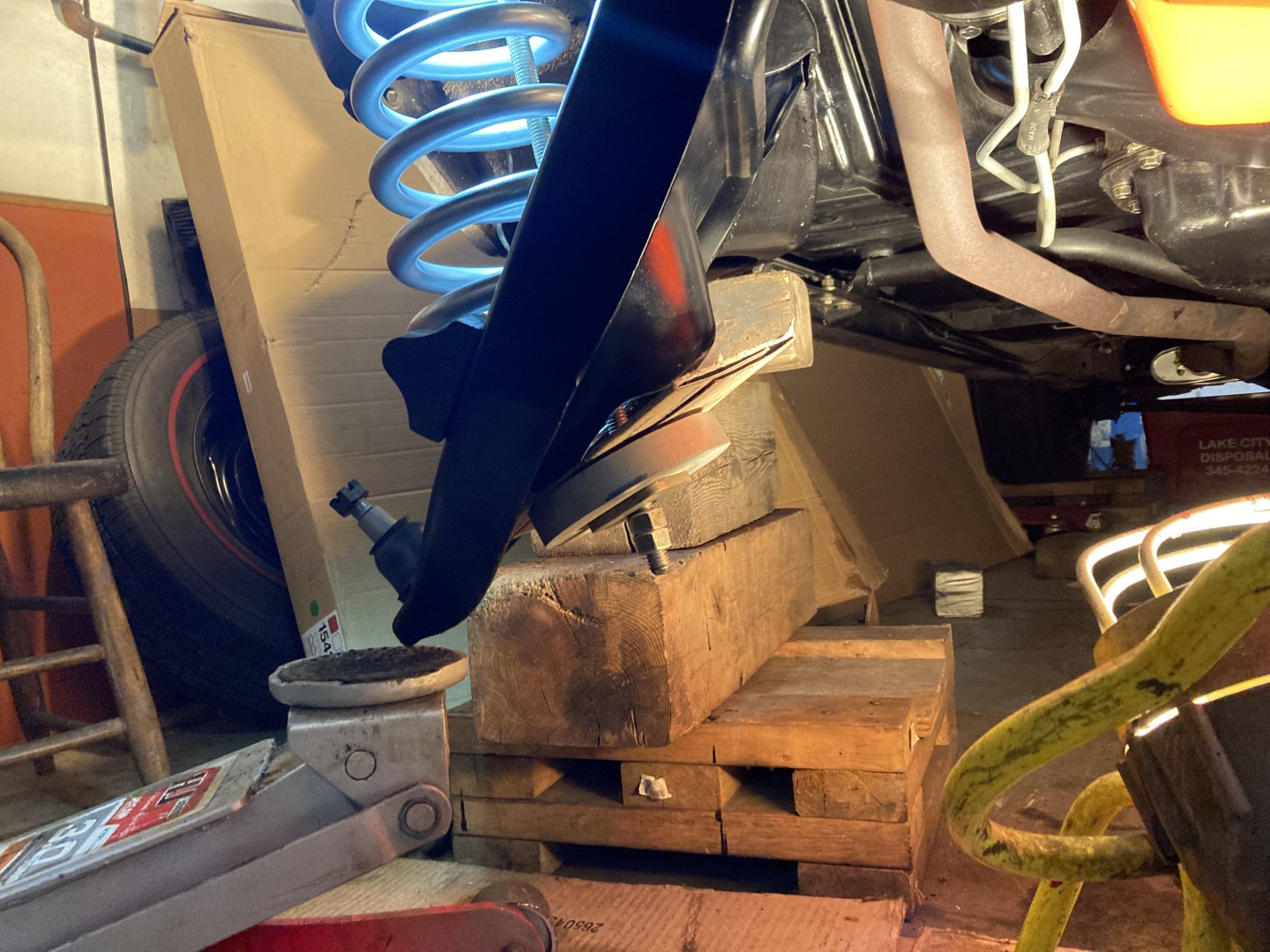

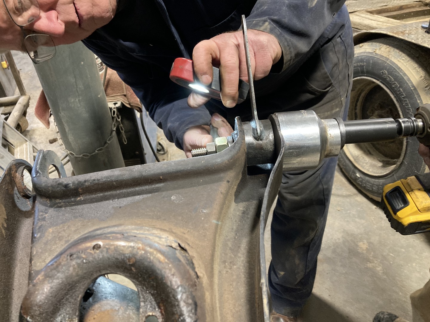

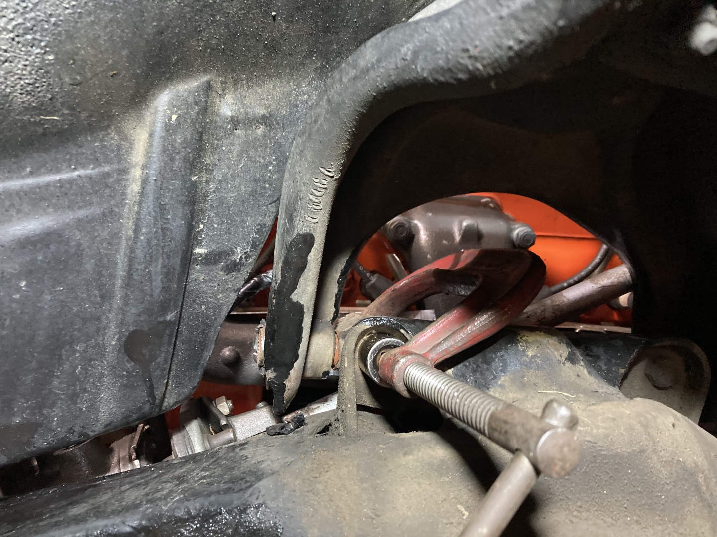

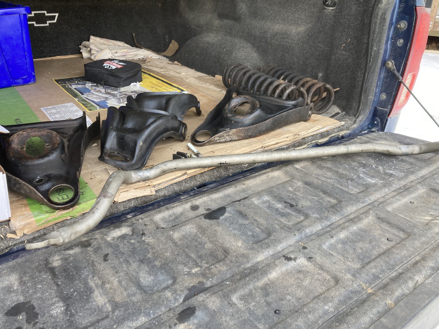

Bushings and ball joints out. With the help, garage, and tools from my friend Duane and a former student. I just had to use Duane's parts washer to get things a little clean for the powder coater.
-- Edited by jim larson on Monday 5th of December 2022 12:56:14 PM
Nice !! Great to have some tools and help to make this easy. I LIKE that tool he has to prevent the arms from collapsing. I use a piece of exhaust pipe and a similar pulling tool.

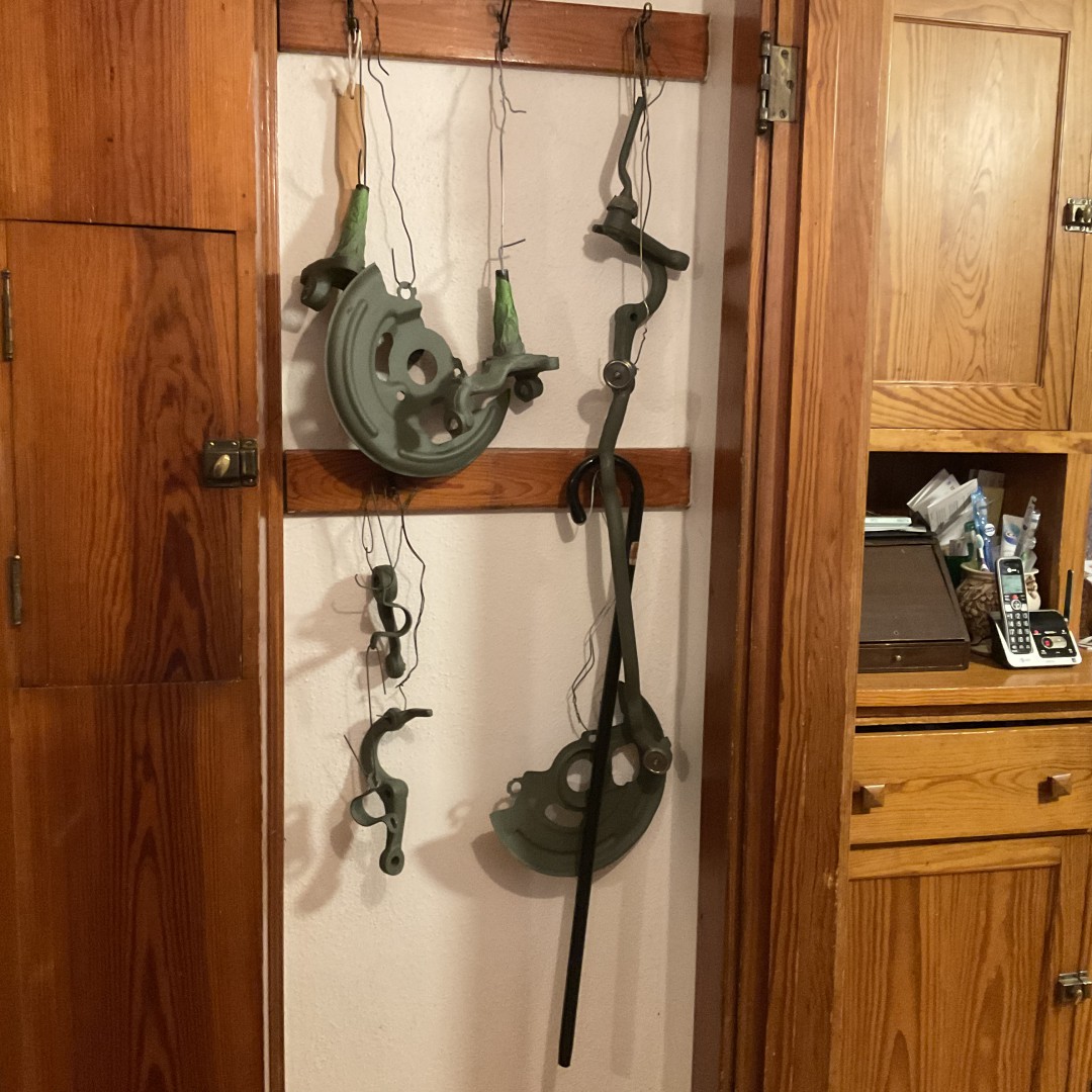

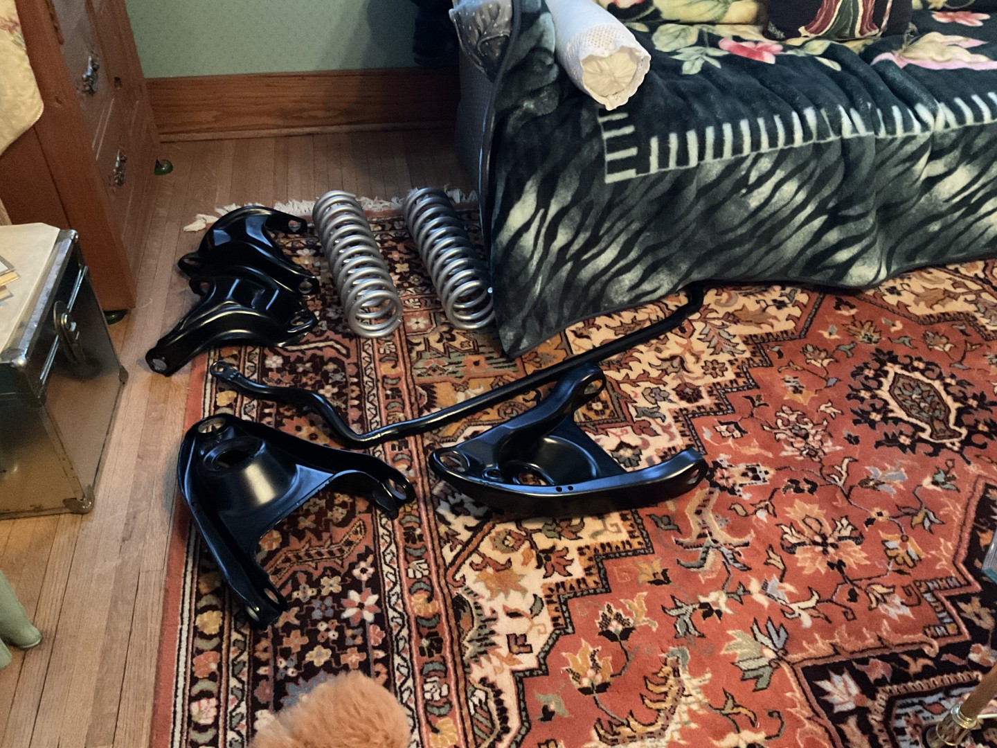

Just got more parts powder coated. P&L plating , wabasha, mn the owner is a former student. He just hand delivered them today. If your thinking of coating something you may want to check them out. Boy a lot easier than cleaning and painting myself.
WOW, they look great ! and NO powder in the bushing/ball joint holes...

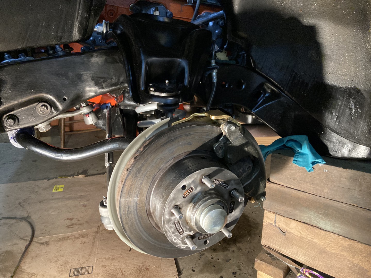

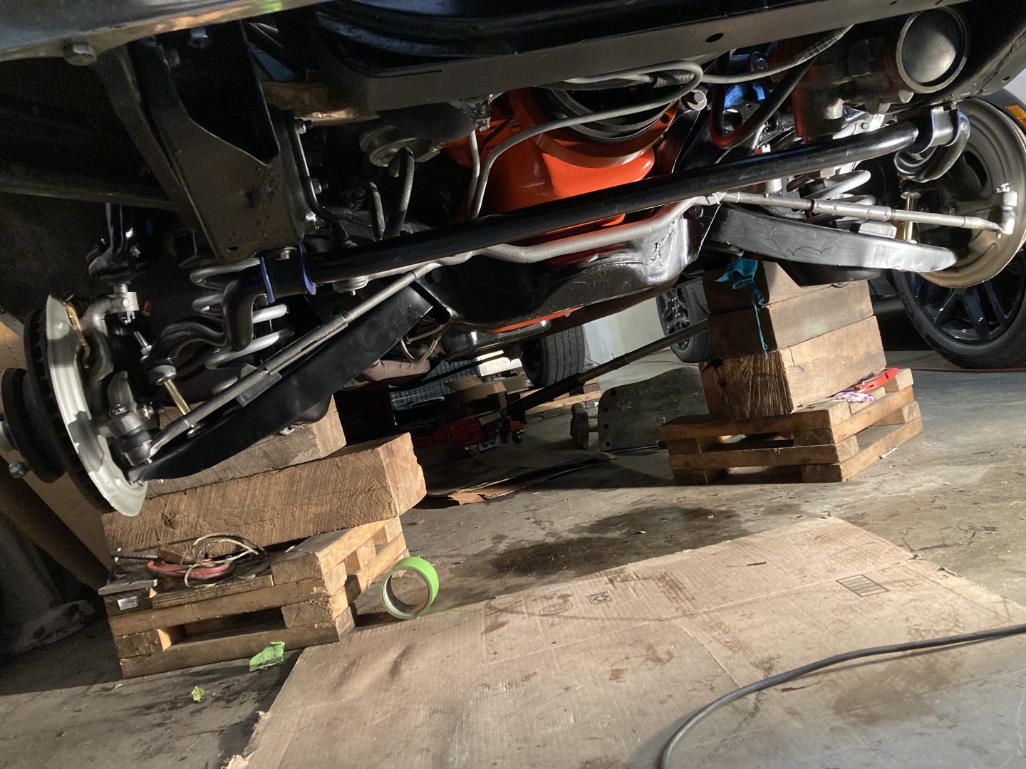

Jan 18, 2023
A special thanks to Mitch and Bob for bushing and ball joints install at the recent club meeting. Just finished the frame painting after hours of cleaning, scraping and painting. Finally done
I think you want that lower arm on the other side though ? Oval bushing on the rear ?
And the spring needs to be turned over before install. Open end to the bottom.
-- Edited by Lost in the 60s on Wednesday 18th of January 2023 05:55:59 PM

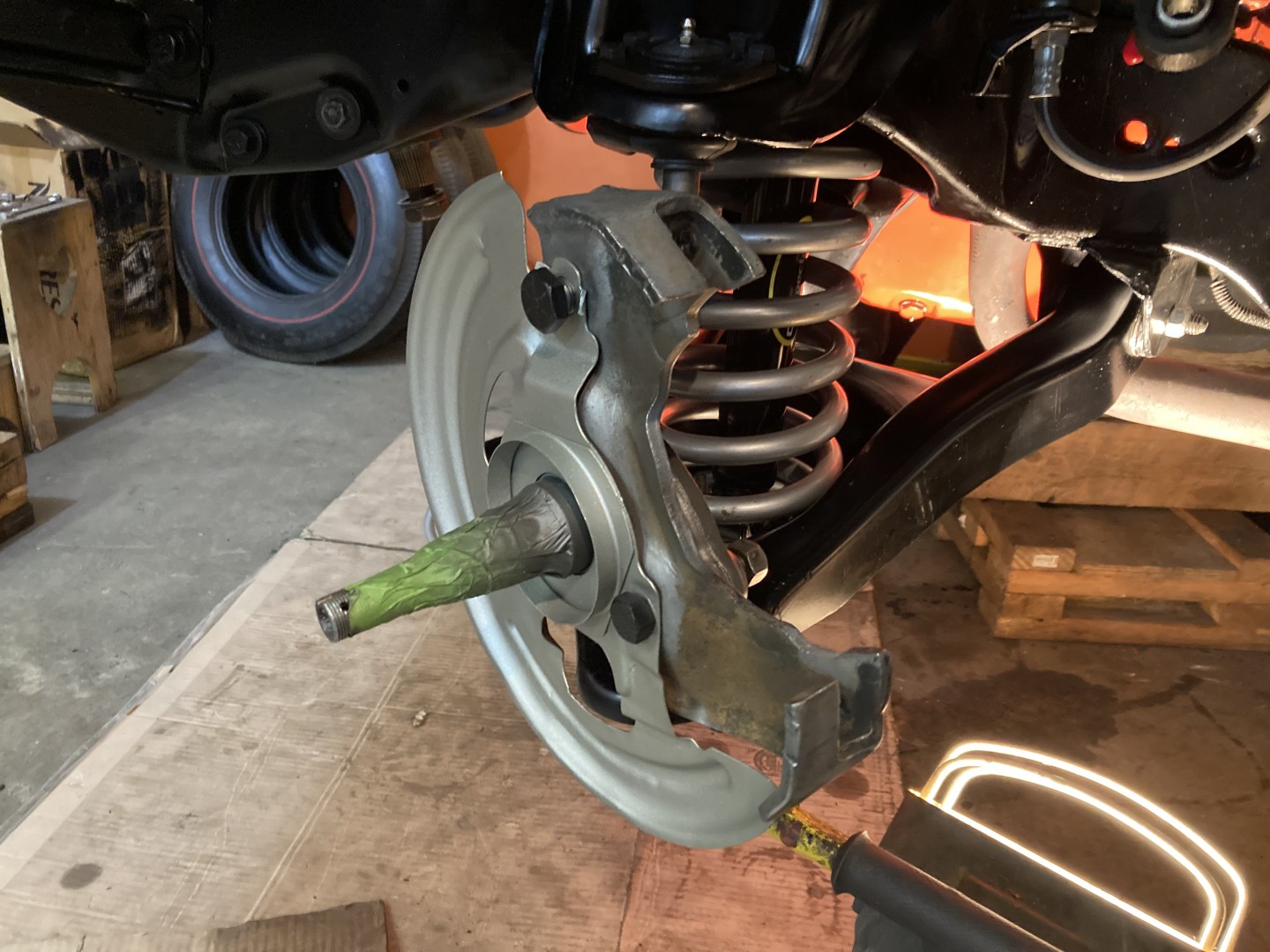

Making progress. Installing the springs fought me. Just need to blast and paint The caliper brackets, install the brakes, steering linkage ad sway bar. E
This mechanic work wouldn't be any fun if the job didn't fight back...
Good to see you "prevailed".

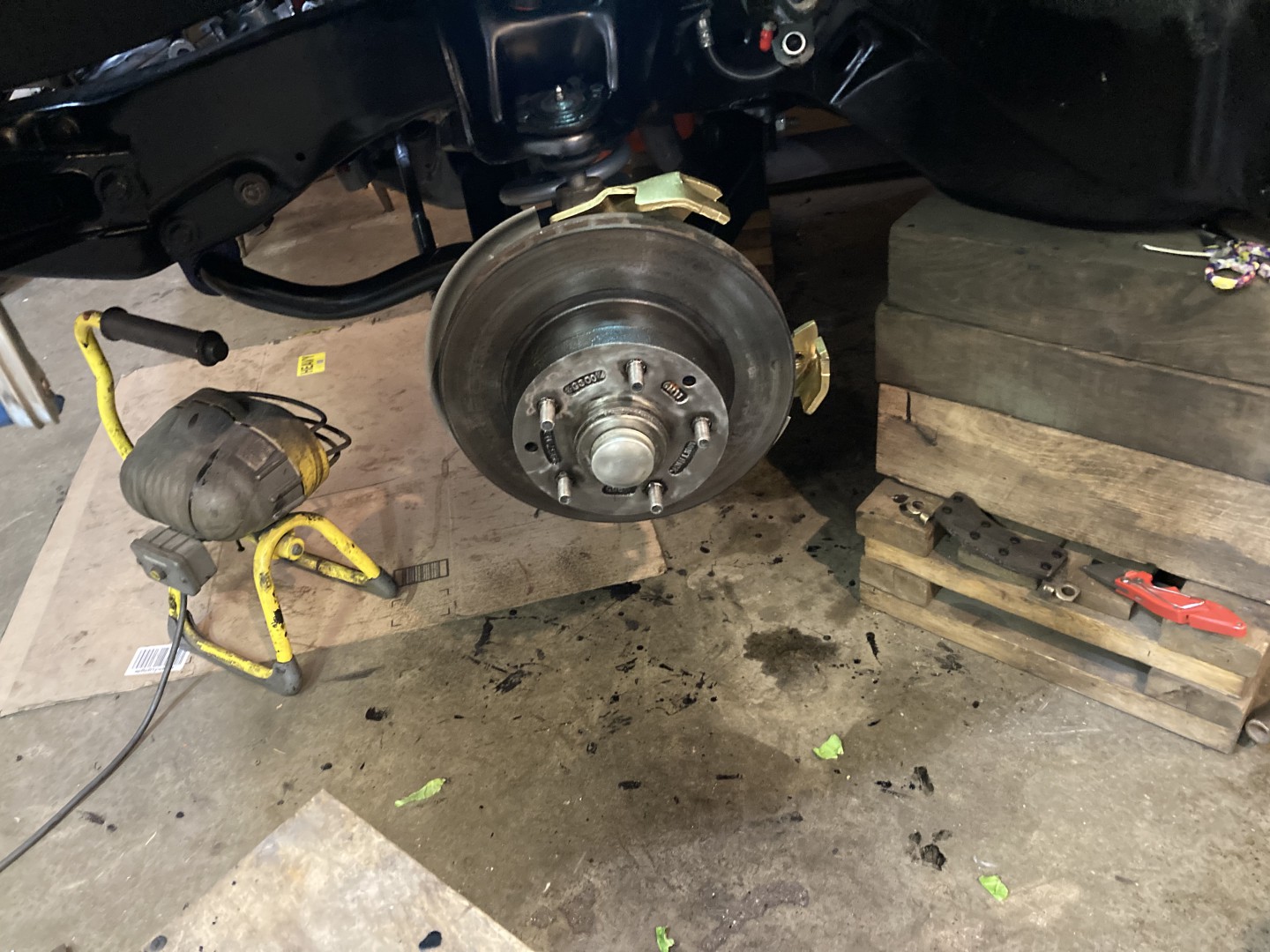

Made more progress, caliper brackets finished anx installed along with dust shields. Torque to specs along with steering arms. Also put in the sway bar, pitman arm, center link, and relay arm. Just have to finish cleaning and clear coating the tie-rods.
Then I have to clean and finished the hubs. I am wondering how to finish the front face of the hubs. Thinking I should treat them with some kind of product like Boeschield. And use a cast paint on the part extending beyond the face

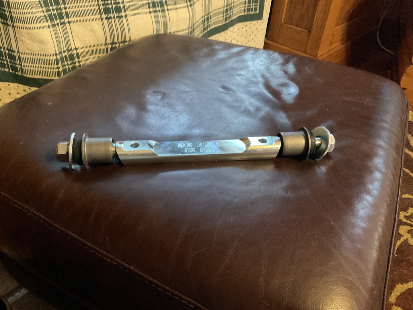

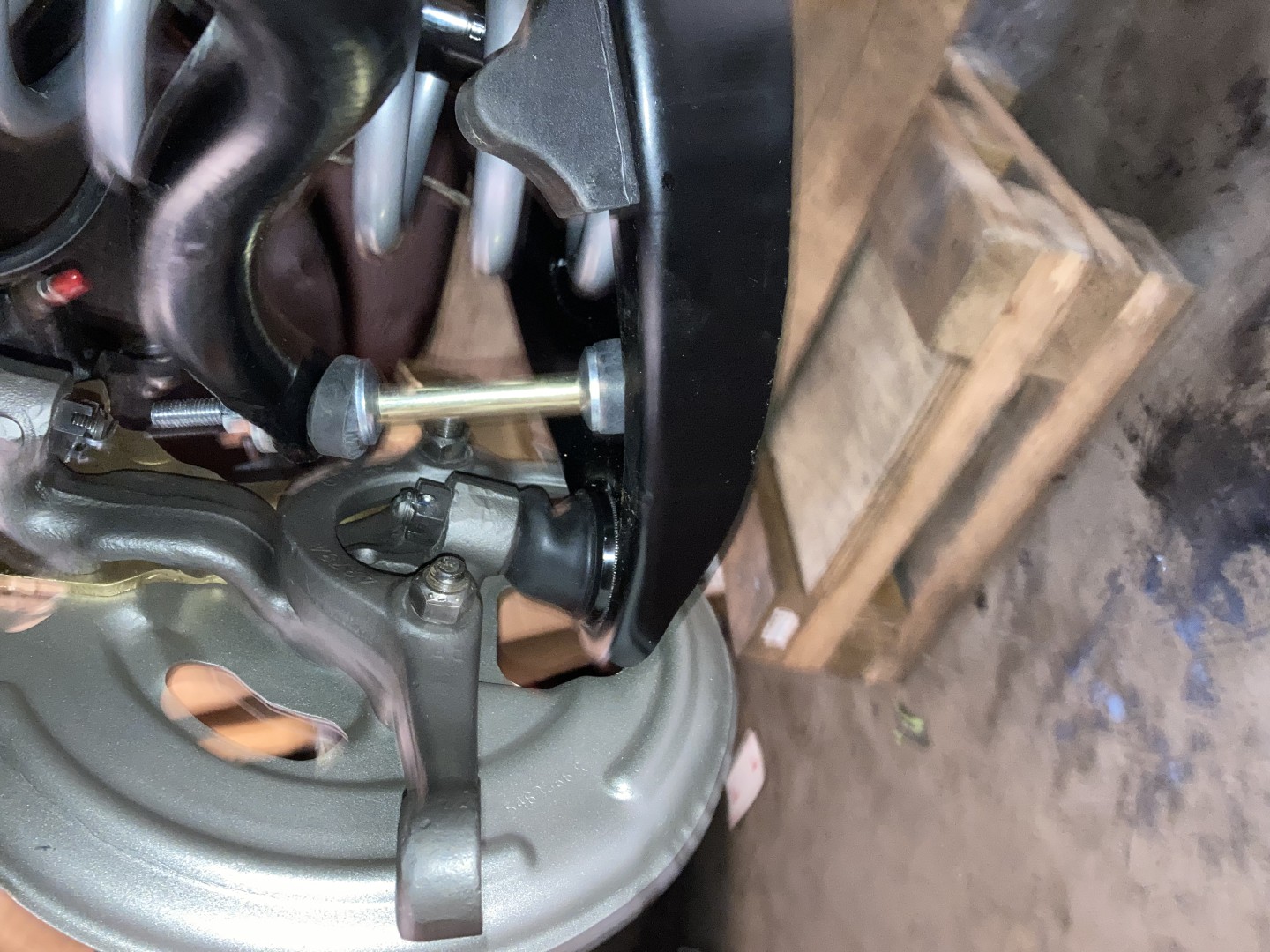

Went for alignment, bad results. You are only suspose to use the offset shafts if your frame has sunk in to bring you Camber up like from neg 2 to neg .5. A $110 lesson.
Thanks to Bob and Mitch for advice advice, I could just rotate them 180*.; took me a lot of effort on my part, but was able to do that. Still have to torque the rubber bushings/ shaft nuts. Again bad advice from global west, they said I should treat it like a wheel bearing, no. Not if you want the rubber bushings to function as they should?

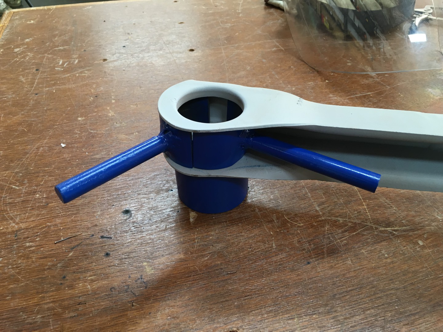

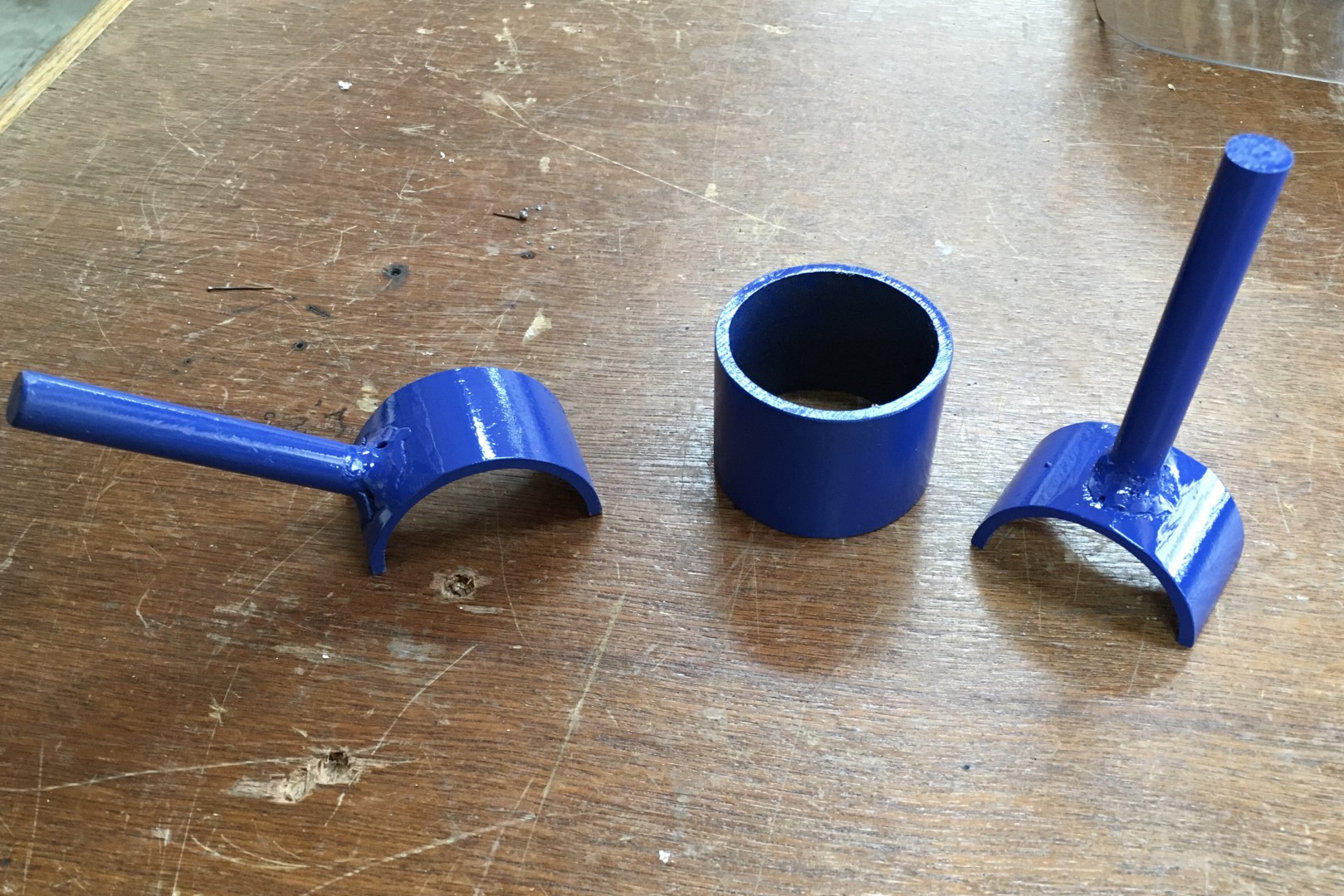

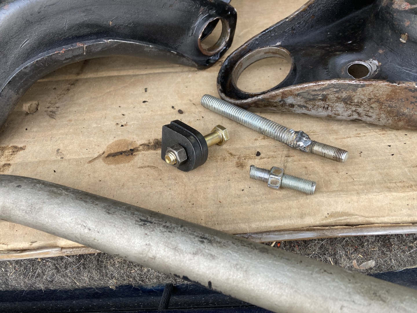

I welded this kit up from 3/16” pipe.
Nice job as ever Kevin. Well parts are off to the Powder Coater. Typical product from China. Cheap low grade bolt to go into the cross shaft. Former student cut off the section that was striped by the nut And welded on a bigger et threaded part and bigger nut to make it work better, though not pretty.
now to TQ and back the the alignment shop
