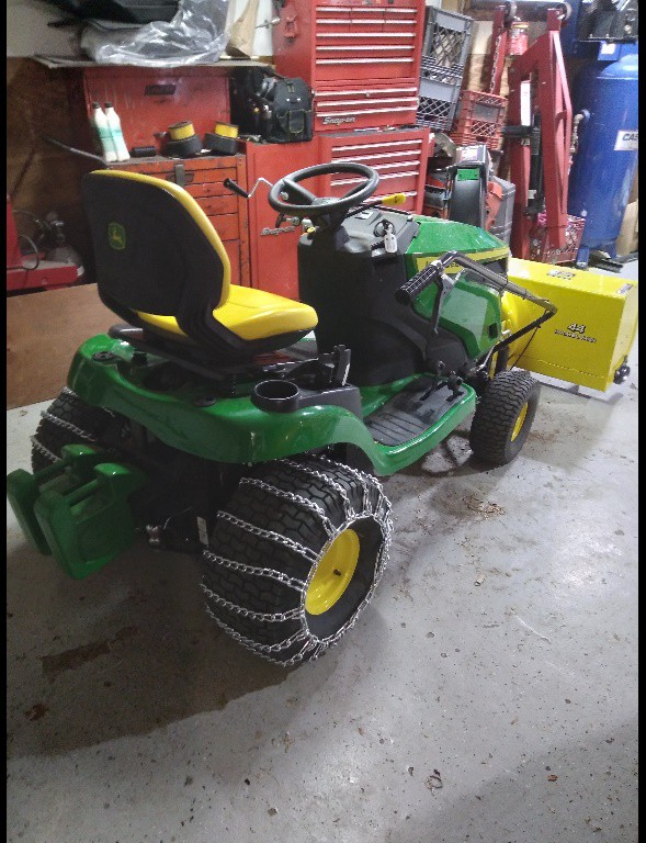

The new Deere lawn tractor has about 10 hours on it now. Recommended oil change interval is 50 hours / once a season. Not gonna let it go that long, being brand new, and basically you run it at 75% power (full throttle) all the time.
It has full pressurized oiling, and even an automotive style spin-on filter... and here's the note to Briggs & Stratton:
"Hand Tight" on the oil filter means just that - as snug as you can get it with your hand... NOT RUN DOWN WITH AN IMPACT GUN, THEN TORQUED WITH A WRENCH AND 4' CHEATER BAR!!
Jeezzzz. I nearly blew a (fill in blank) trying to crack this thing loose! The canister was just deforming when it popped, then it was still "tight" for another complete revolution! Idiots.
I also did the conversion from mower to blower.

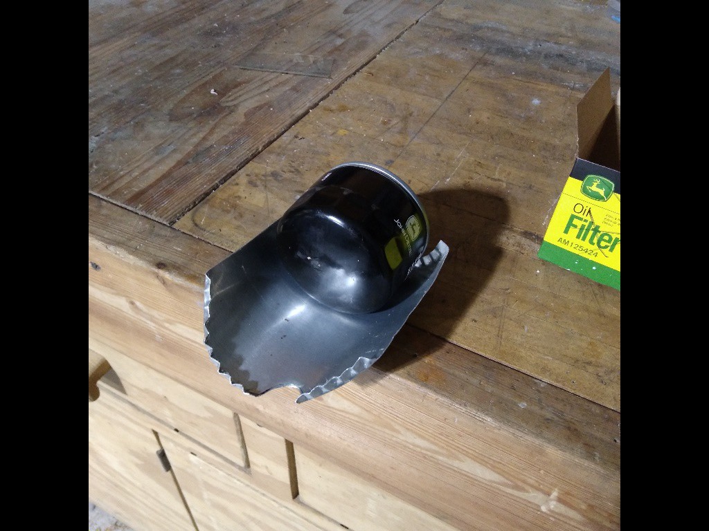

Now the filter is another thing all together. It sits horizontally on the left-rear of the block... over the frame rail. Unless you make a little mess-diverter/curved funnel/dirty-oil deflector our of some sheet aluminum, you would pull the filter and puke dirty oil on the frame, under the engine, and then it would find 37 different drip points off the framerail

My JD has a liquid cooled Kawasaki twin. Both the drain and filter are fairly non-messy to remove. Now the Harley...I have a drain diverter like yours for that, or the filter oil goes all over the frame and oil cooler...

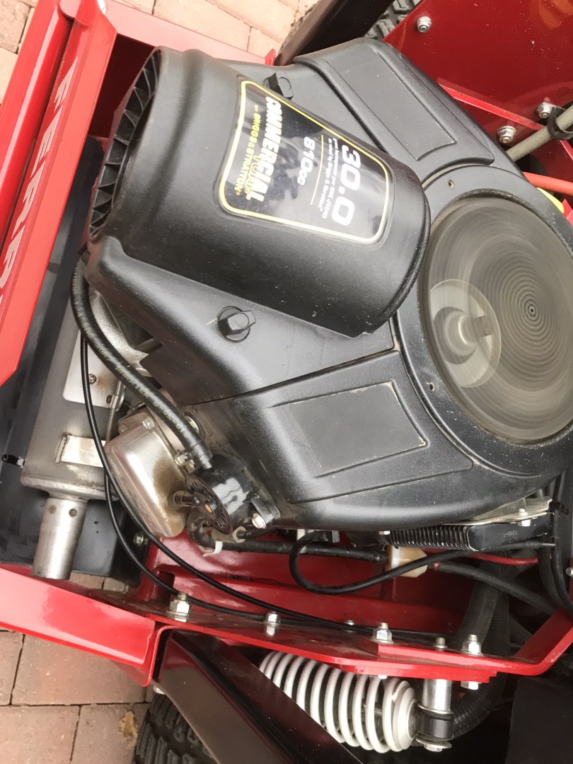

JD, I like your filter drain pan, very clever, I’m going to copy it and try to make it fit. My Farris zero turn has a Briggs engine. The oil filter is hidden below the engine and almost impossible to reach. I like to change the oil with the engine warm, when i jam my hand into the narrow space there’s opportunity to burn both hand and arm there’s also several very sharp items hidden in there, once you reach the filter the arm is already burned and bleeding, when I do reach the filter I can only get a thumb and two fingers on it. I’m going to weld up an offset channel locks to see if I can access it better.

I did try a strap wrench, just couldn’t get it in there. I was hoping I could use a ‘socket’ style filter wrench but the filter case is smooth. I seem to remember a filter wrench that has offset kogg’s that self tighten, just cant find one. Oils changed, so the mowers ready for next year. I am going to build an offset channel locks for the filter removal. My Craftsman snowblower tractor has a Briggs with a similar filter setup, it’s accessible but makes the same mess when removed. JDs setup will work just dandy there. The cab, blower, chains.heaters, field light and coffee cup holder are installed on the tractor and ready for snow. I remember someone here installed an elect servo on their discharge chute. Like to get some info on that.
Kevin, from the pic it looks like you'd just have to put a 90 on the design, and have it drain off the edge through the hole in the frame/engine pad.

John, I in-vision a scupper tray like you’ve crafted; I’ll just add a drain port with a hose to go through the hole. Should be able to connect the hose from the bottom.

On my scupper the engine block edge is bent up just enough to squeak between the filter housing & frame, and the "lip" catches on the backside of the oil filter boss.
I cracked the filter loose enough to turn by hand (hear that Briggs?!), then snuggled the diverter scupper in place, then spun the filter loose (not off) and let it drain a few minutes. Then spun it off all the way.
Didn't have nary a drop of oil on the frame while changing it out.

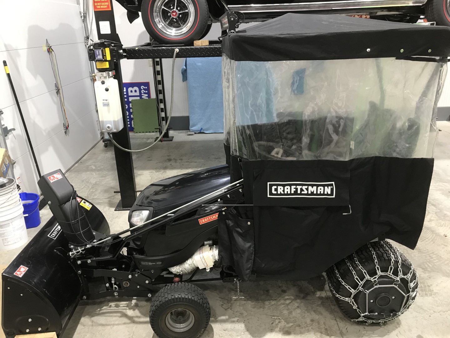

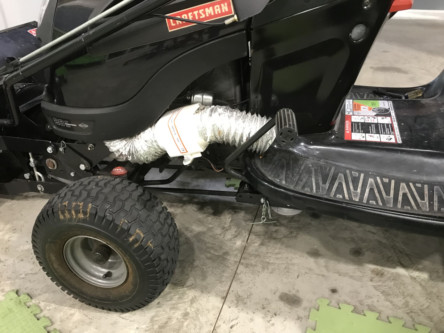

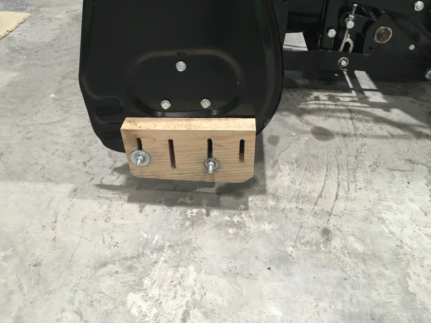

So, are you ducting hot engine (cooling) air into the cab, via a (something like) a bilge blower??
Nov 19, 2022
Yes, note picture three above. Two bilge blowers drawing hot air off of each of the engine cylinders. Lots of heated airflow into a cab thats not very air tight but still once warmed up I need to secure one of the blowers. Warmth causes blowing snow to melt on contact with the plastic windscreen reducing visibility, I use Rain-X and it works well. I replaced the steel blower skids with 2” wide oak skids to protect red pavers that are part of the paved driveway.
