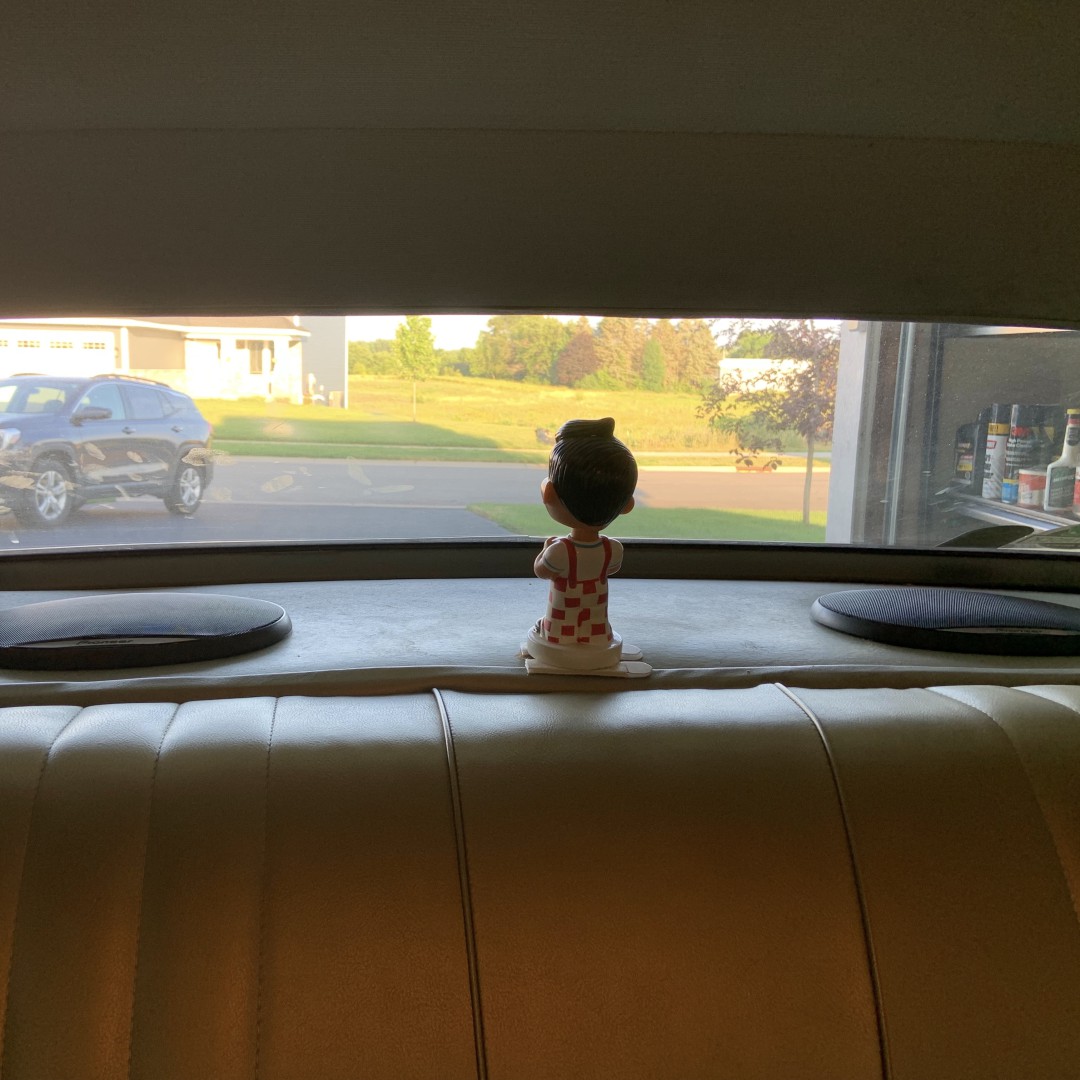

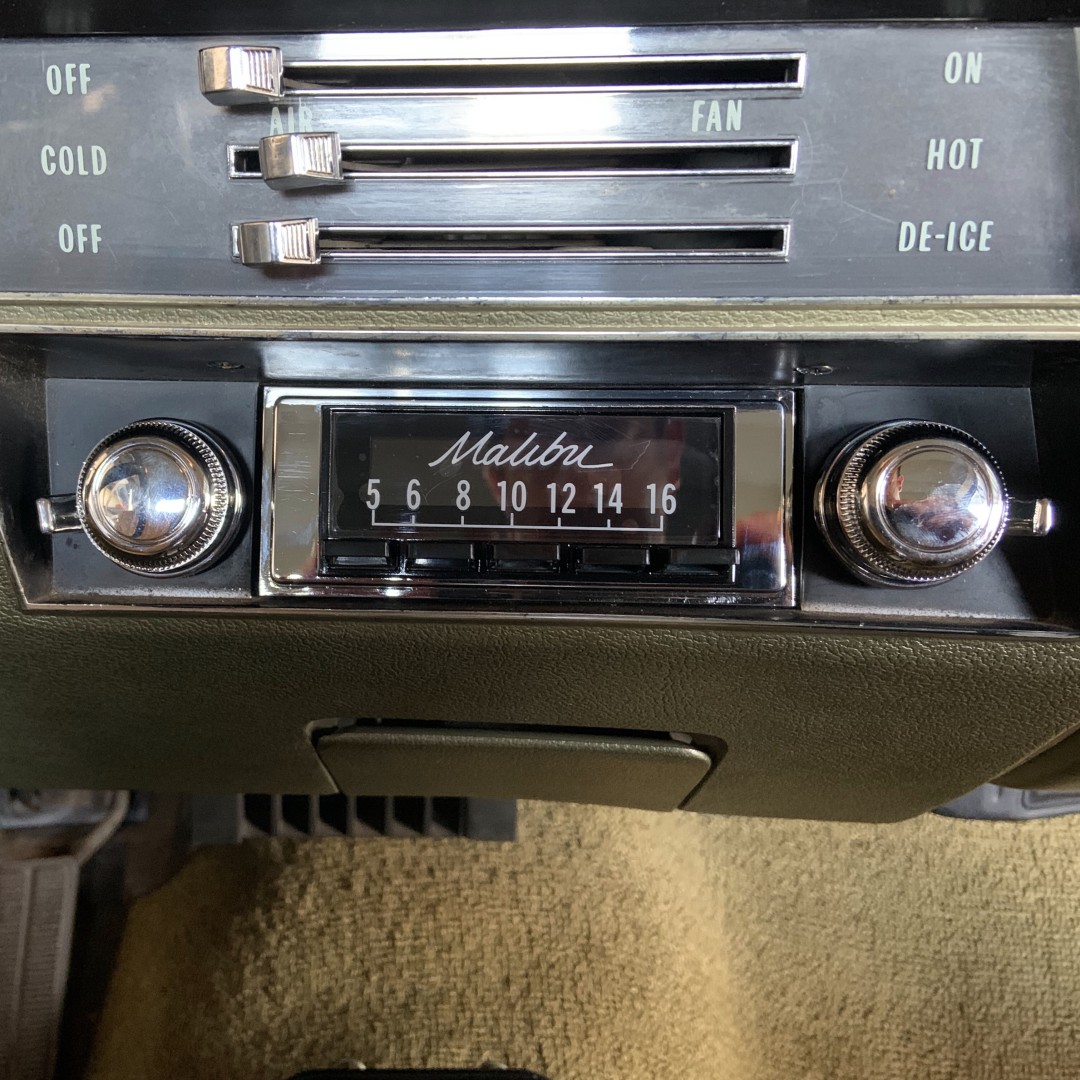

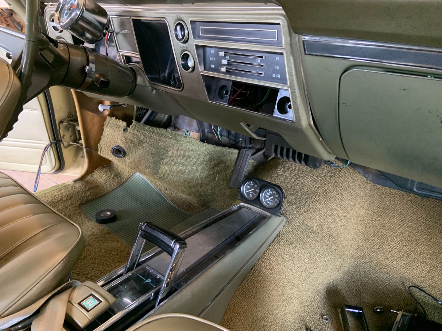

Chris S. And I started the radio replacement and speaker addition in the Chevelle last night. I only snapped one picture as it’s not quite complete. The new stereo is in place and working when Chris left last night. But, we both believe that we may have wired the new 6x9s backwards as they weren’t working last night. We tested the stereo with my garage speakers and that worked. The 6x9s are brand new, so reverse polarity must be the culprit for them not working. I also need to swap the temporary wood screws that Pioneer sends with the speaker kit for some 10-24 machine screws and nylock nuts. Just a few more punch list items and I’ll have a better sound setup than the Motorola AM radio and single dash speaker.
Reverse polarity on the speaker wires won't stop them from working. Are they ohm matched ? Factory speakers are 10 ohm, while aftermarket radios are different. If aftermarket speakers, are you sure you have the correct wires for a 2 speaker install ? Most aftermarket radios have wires for 4 speakers.

They should be ohm matched. The speakers are new Pioneer 6x9s, 4 ohm I believe (edit: speakers are 4 ohm and head unit is 4-8 ohm). The radio/head unit is a Retrosound Hermosa. We got sound when we jumpered to my garage speakers. Fader set all the way to the rear, speakers wired to the rear speaker wires on the back of the unit. All we could think of is perhaps reverse polarity. I’ve yet to check it out. I have a bit of time on Sunday. If they don’t work, I’ll just have to buy a new pair. I’m also going to test them with my garage stereo to see if it is in fact the speakers and not something else.

Yesterday I took the speakers down, powered up the head unit, and bingo, sound. Turns out the speakers want to be top mounted. When under mounted, the foam surround on the speaker gets compressed against the bottom support steel for the package tray. So, Chris S. and I will be doing some more trimming on Wednesday evening. It shouldn't take too long. Just need to measure twice and cut once. I started to cut with my 3" air cutoff tool, then I decided I should wait so I didn't burn the car to the ground. It'll be ready for SMN in a couple weeks.
Jul 5, 2022
Check if there are plastic spacers still available to set the speaker lower under the package tray before cutting. I made a set from some old speakers for my car.
