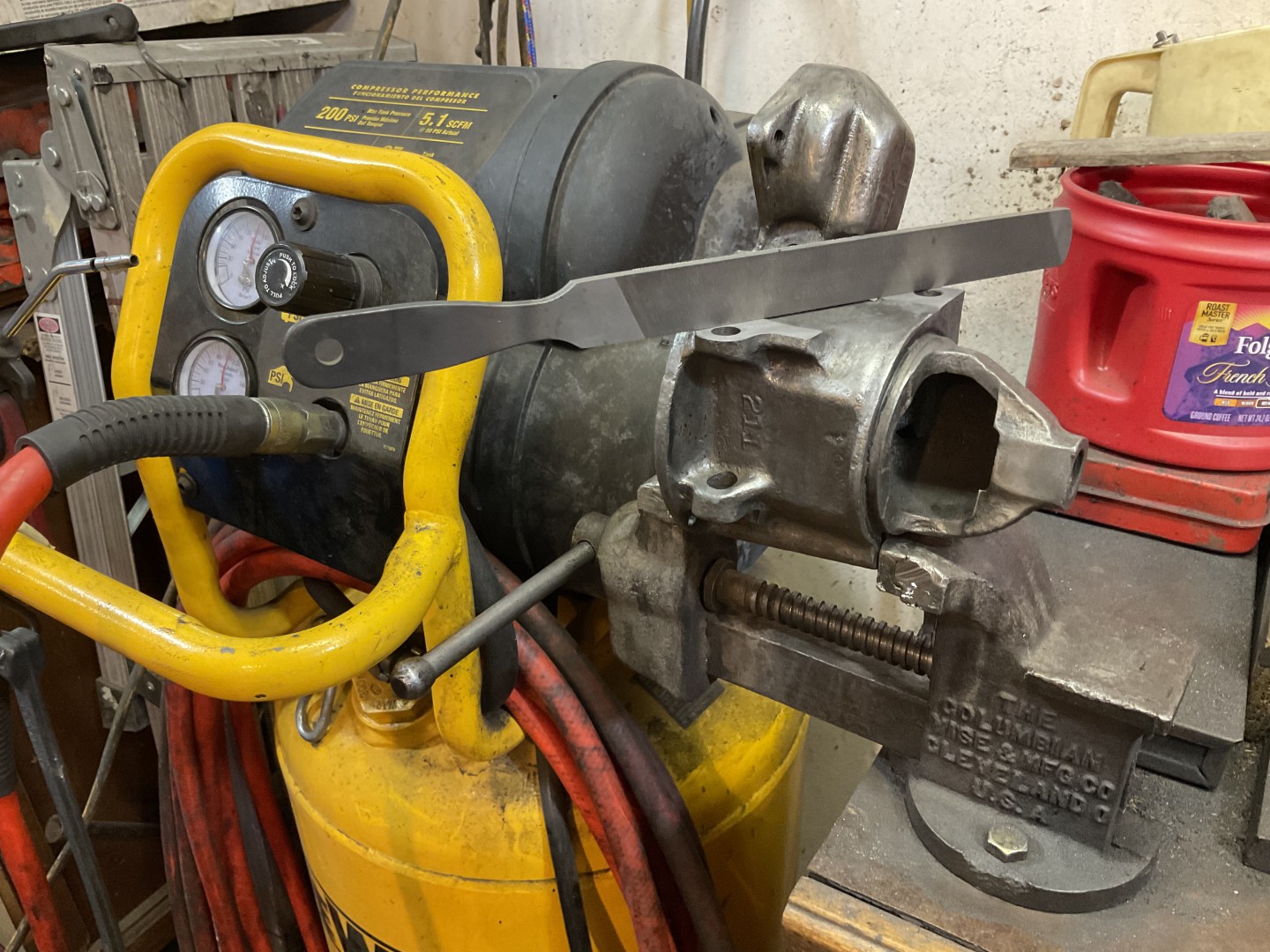

More than 1 issue with the starter. Nose is at the machine shop, he is taking .050 off the mounting pad of the nose, maybe we will remove a little more. We have to see how it fits. But I also need a new drive. it further reinforcements the phrase “if it is working don’t fix it”. Starter was working but I thought a rebuild would be better. New selonid, brushes, and paint a new drive. Drive has failed. Bob recommends a GM drive unless I want for replace it every year.

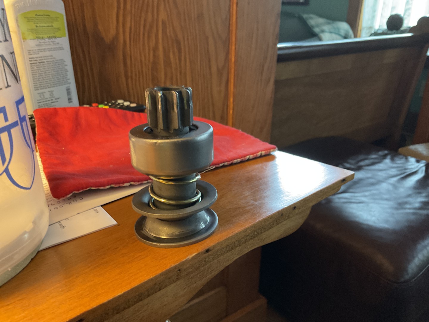

Machine shop could not mount the nose and hold in place, so only option is hand file. NOS starter drive arrived. I think I should quick buy another. Seems to fit the shaft much better, maybe that will correct some of the problems along with a front brace.
Thinking I should buy another NOS starter drive. Just to have a good drive on hand. You never know when you won‘t be able to find one an with two cars you never know. I wonder when you won’t be able to get one from a GM dealer and what there cost would be. Probably good insurance.
