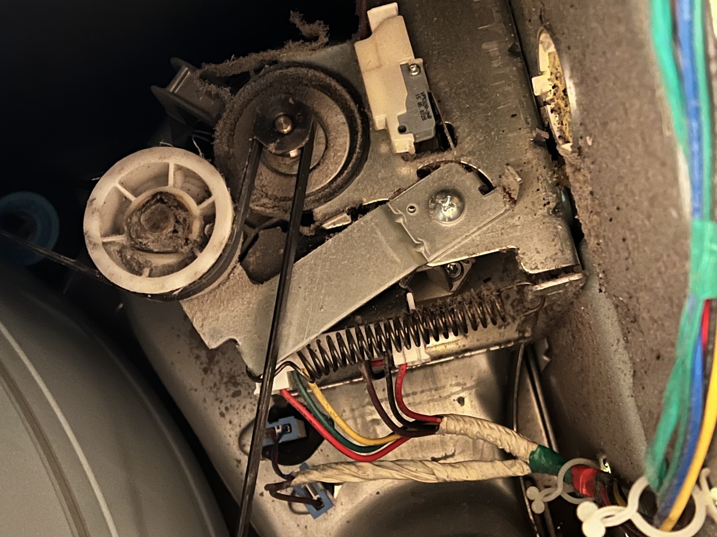

My wife messaged me today: dryer started squealing and sounds like it is thumping. had an occasional squeal before. She does a little searching, finds a "top 6 things" video.

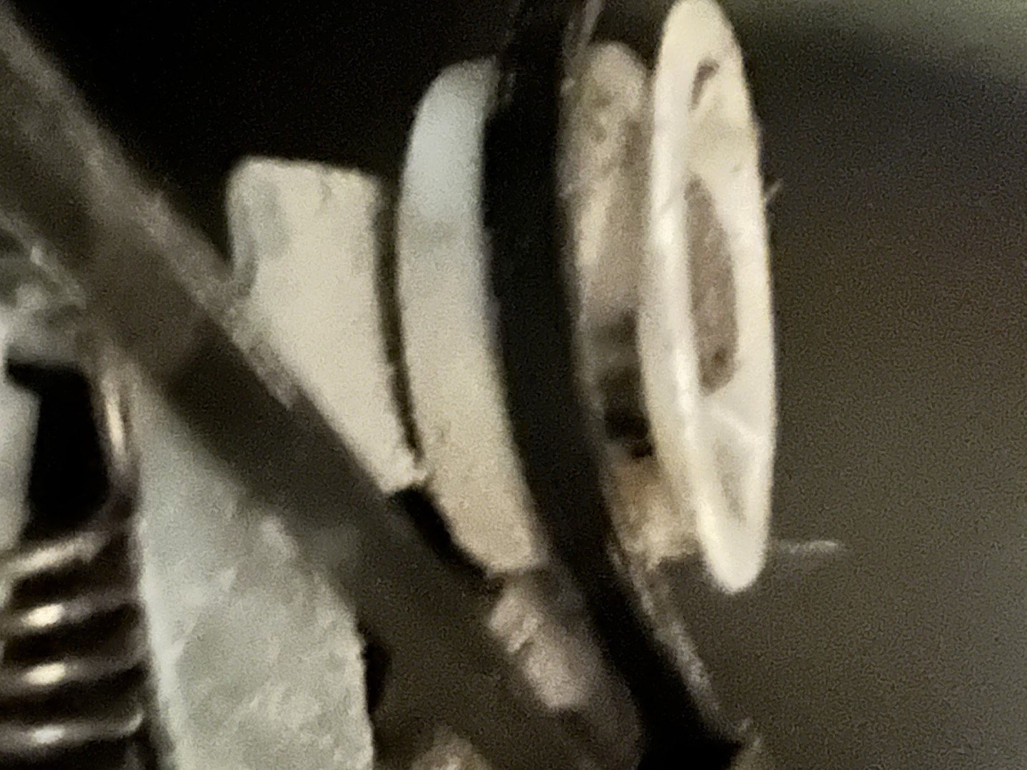

I come home, we pull it out, figure out how to crack it open, and look at the rollers. They look fine. then I see the belt. It's resting halfway THROUGH the tensioner pulley. Pretty neat.
Call Day appliance, they're closing, but they have a bunch and it's pretty cheap. Hit that after work tomorrow.
It's literally 1 screw holding it on, re-hook the spring at one end, and one screw to put the access cover back on.

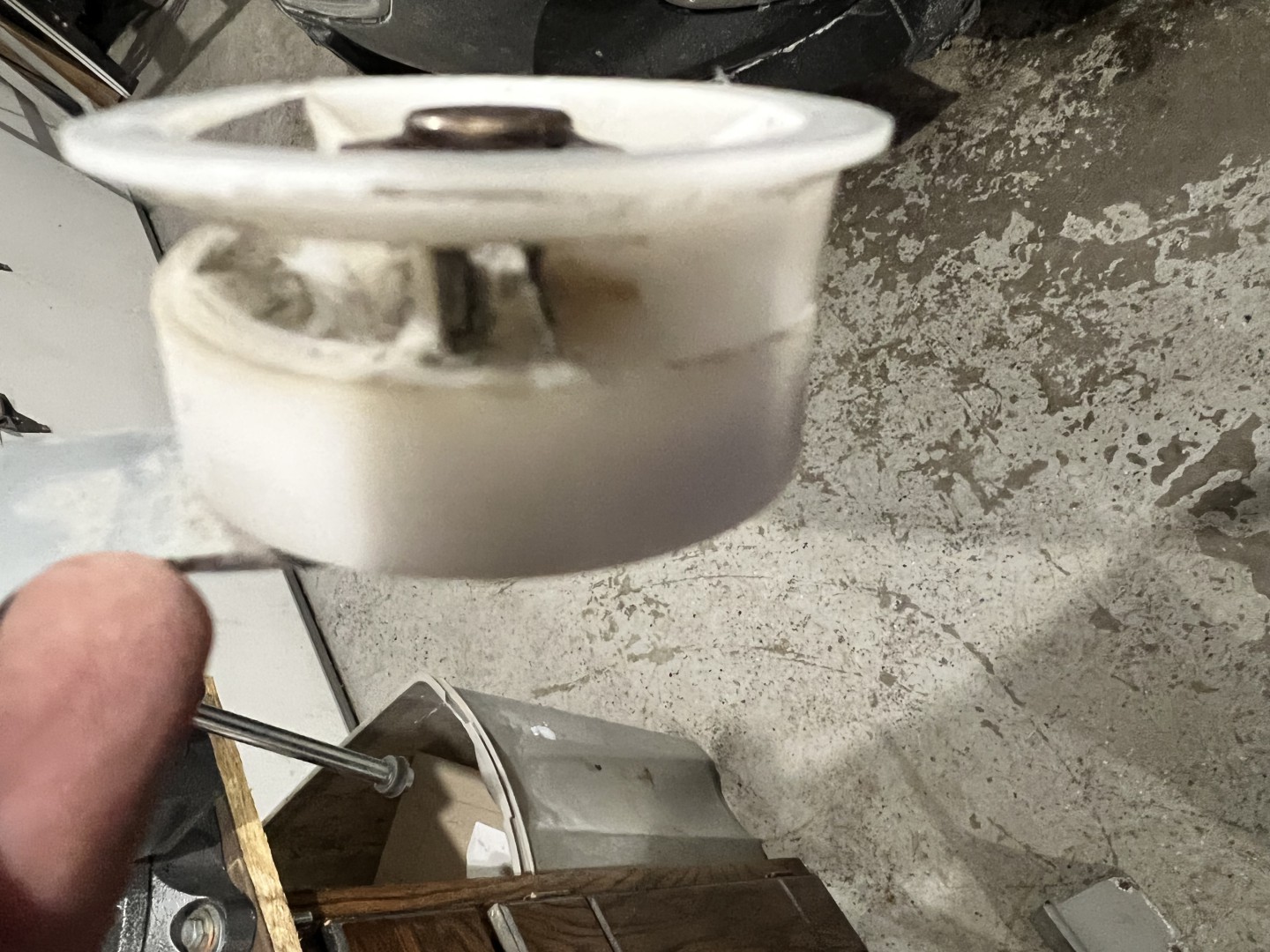

Yeah, there was a simple access cover. While replacing it, I quickly looked at the rollers. One had a flat spot, but the other 3 were fine. after the ONE screw to attach he tensioner and re-hook the spring (thanks to my drum brake spring experience of sliding the one down the screwdriver shaft to hook it), it was done. a quick test had 4 fast thumps then settled into a nice whir. The belt found it's spot on the drum again. all done for now.

Well, the tensioner job led to doing the drum rollers too. One of mine was flat spotted, which caused the thump. Not noticed until we had wet towels in, which we didn't on the test before. After some figuring, the front came off, took off more stuff and the front two were pretty easy to do. I could have Johnny 5'd (disassemble) the drum out to do the rears, but I bailed and only did one of those two.
