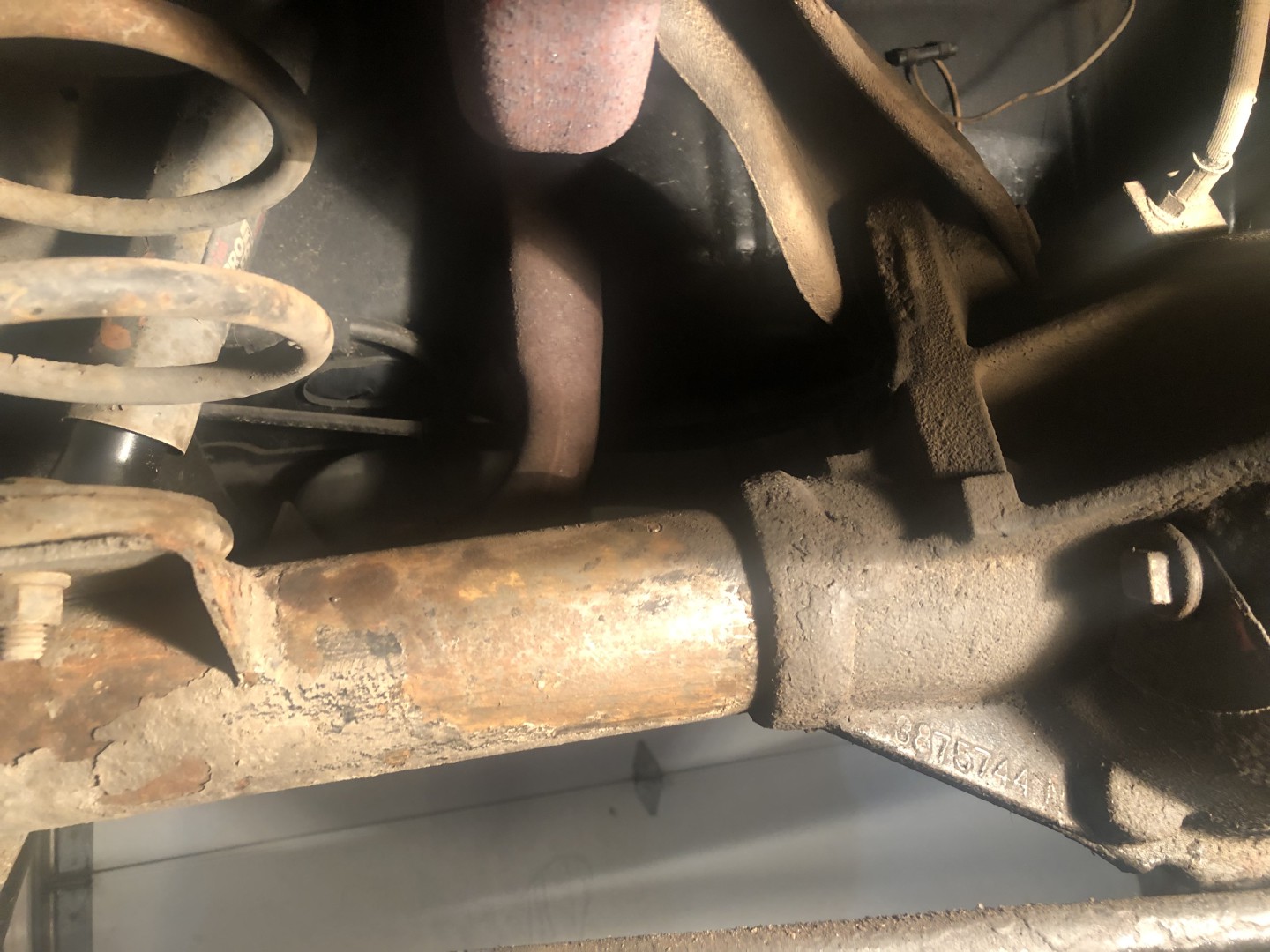

Just started to remove rear housing. Bob is helping with the posi. expecting it to be a long process. I thing Stan is much faster. I think I may have to remove the rear exhaust pipe to get the upper CA‘s out. May just have to cut the muffler exits off then deal with the muffler hangers.
Yes, lots of work to remove a 55 year old part. You probably know this, but remove the sway bar and shocks first and let the axle down on a floor jack as far as it will go. This will provide the most room to remove the upper ca nuts at the diff. You won't be able to remove the bolts in that position, as they are binding too much. Once you have the upper and lower nuts, at the axle, off, jack the axle back into ride height position and work the bolts out. Once the axle is out, you have much better access to the upper ca bolts in the frame to remove without cutting the exhaust.

Thanks Mitch. Nuts are all off at the axel CA bushings. Ready to remove bolts. Good tip to jack up to remove tension on bolts. I’ll be happy if I get everything out today. Acell assembly code indicates 3.08 posi Dana 11/26 one day later than posi date. Axel housing date Oct 30 65. Build date cowl tag 1st week of nov. Verifying the cowl tag was stamped before before the actual build started.

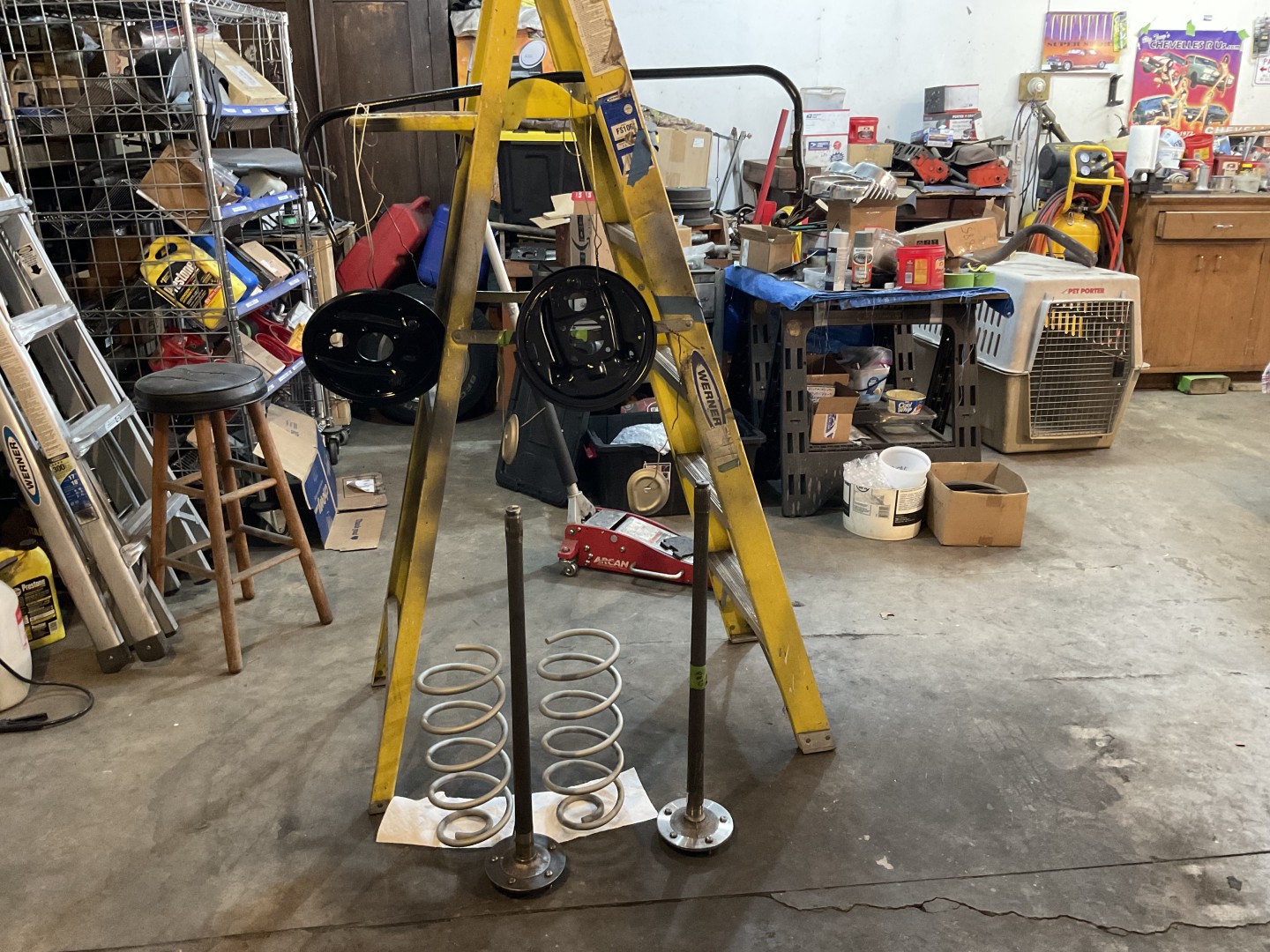

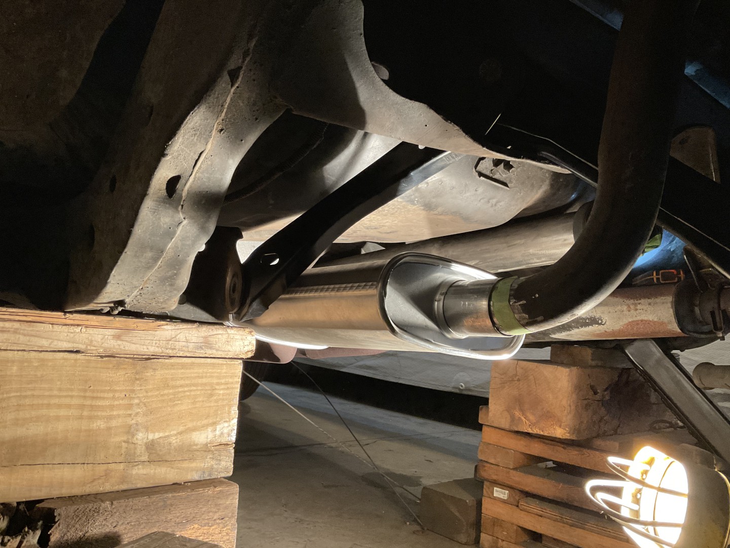

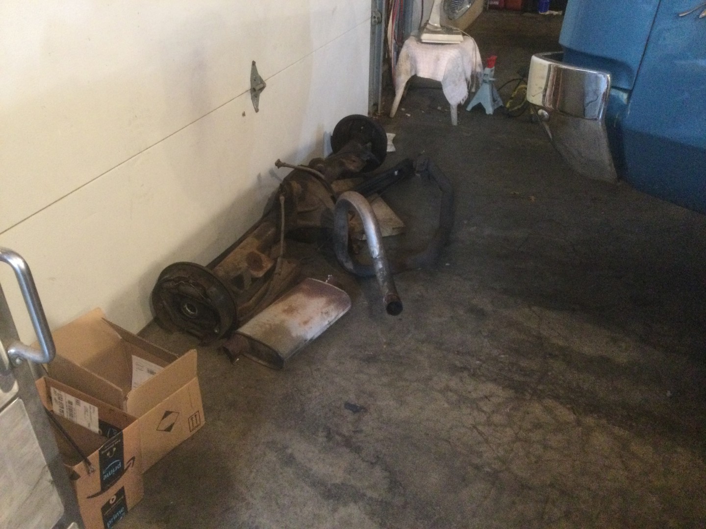

Well everything is out that I wanted? One Muffler was bad, so pulled that. exhaust was replaced and brake line changed , so all that had to be loosen to get at the control arm nuts off. Kind of a pain. Now a break until after the holidays and parts have arrived. First will be cleaning and some paint. Besides posi rebuild looks like one axel/bearing. No will have to insist a little help to get housing on a couple of saw horses. CA nuts look new, I would like to reuse them if advisable? Best to buy a bushing removal/install kit?

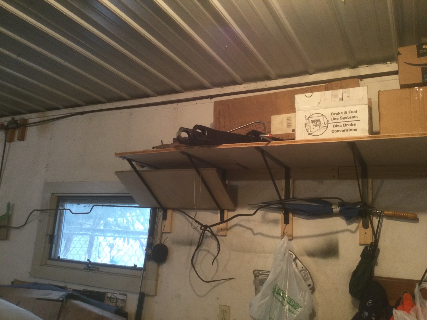

I’ve got a set of upper and lower CA boxed and painted, just need to install the new bushings. Need to remove bushings from housing, looks like I can do that with some washers, a large socket, a few washers, and a bolt and nuts. My friend Duane has a press and a heated garage. Wish there were some magical word I could use and everything would be clean and ready for paint. Or try the walk around drill method.

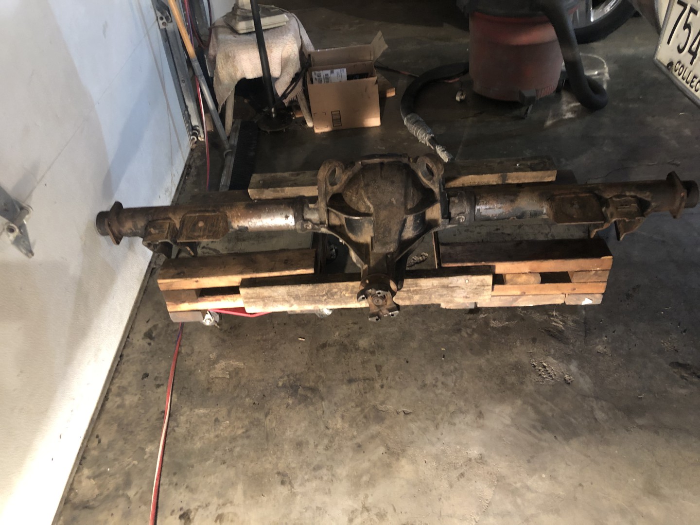

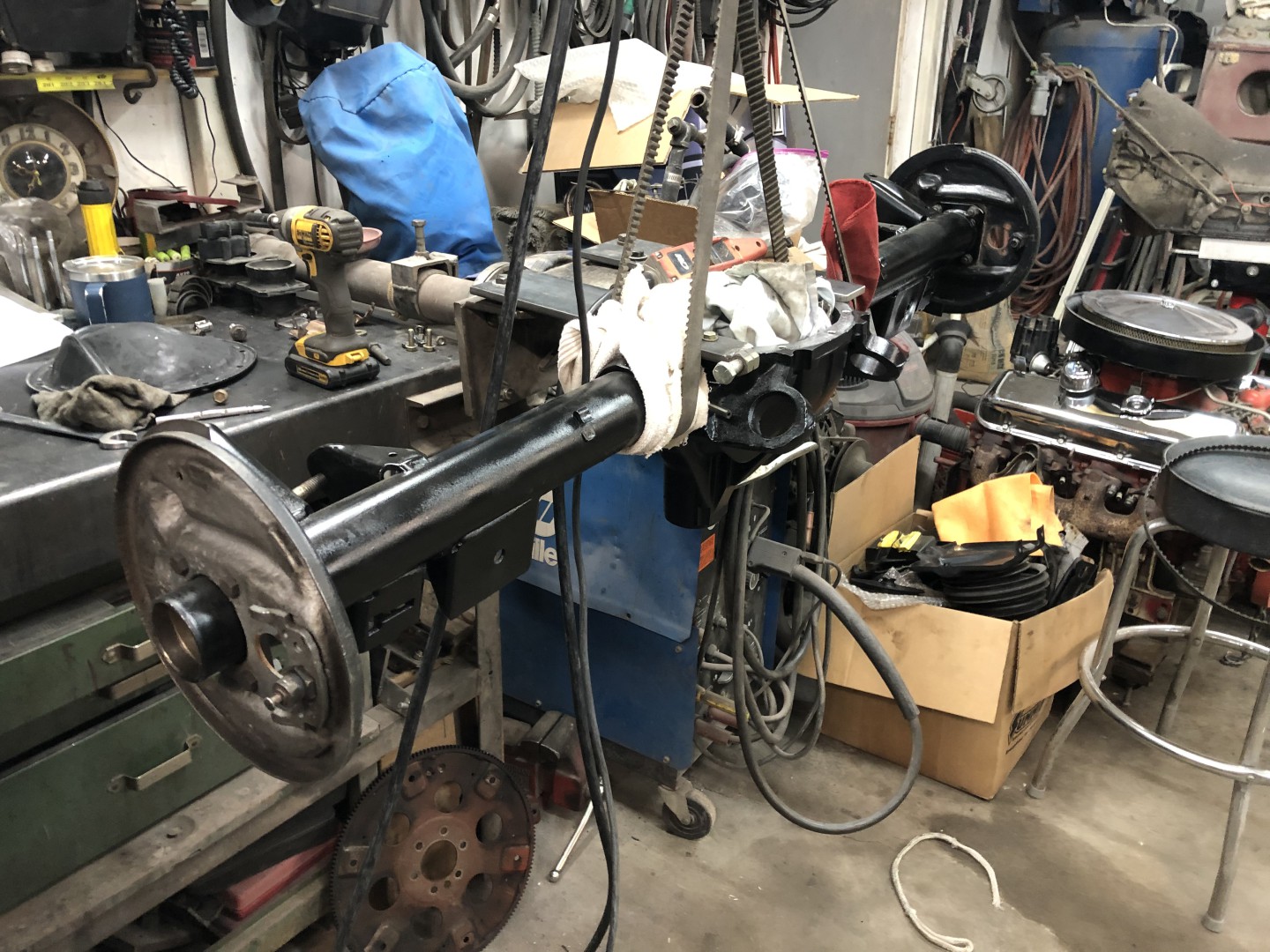

Progress is slow; but steady. I got all the grease and gunk off. Not the best job for the garage. If I had a trailer and help to load the housing I could have taken it to be pressure washed. Now to carped the remaining paint and thick rust off. I think I will use an Eastwood chassis paint. Backing plates also cleaned.
Having difficulty removing the axel bearings. The tool they sell and slide hammer is worthless. I wish you could make the tool into a puller. Going to try Bobs suggestion of making a puller to put pressure on the bearing and try to knock it loose from the back side with a long rod. If anyone has a subjection let me know or if they know of a puller.
Bearings are out, grease removed, now for removing surface rust and paint. A little embaracessed to explain the issue with removing the bearings. Just wanted to say it was not the tools, etc, so that leaves my brain. I will not make that mistake again.

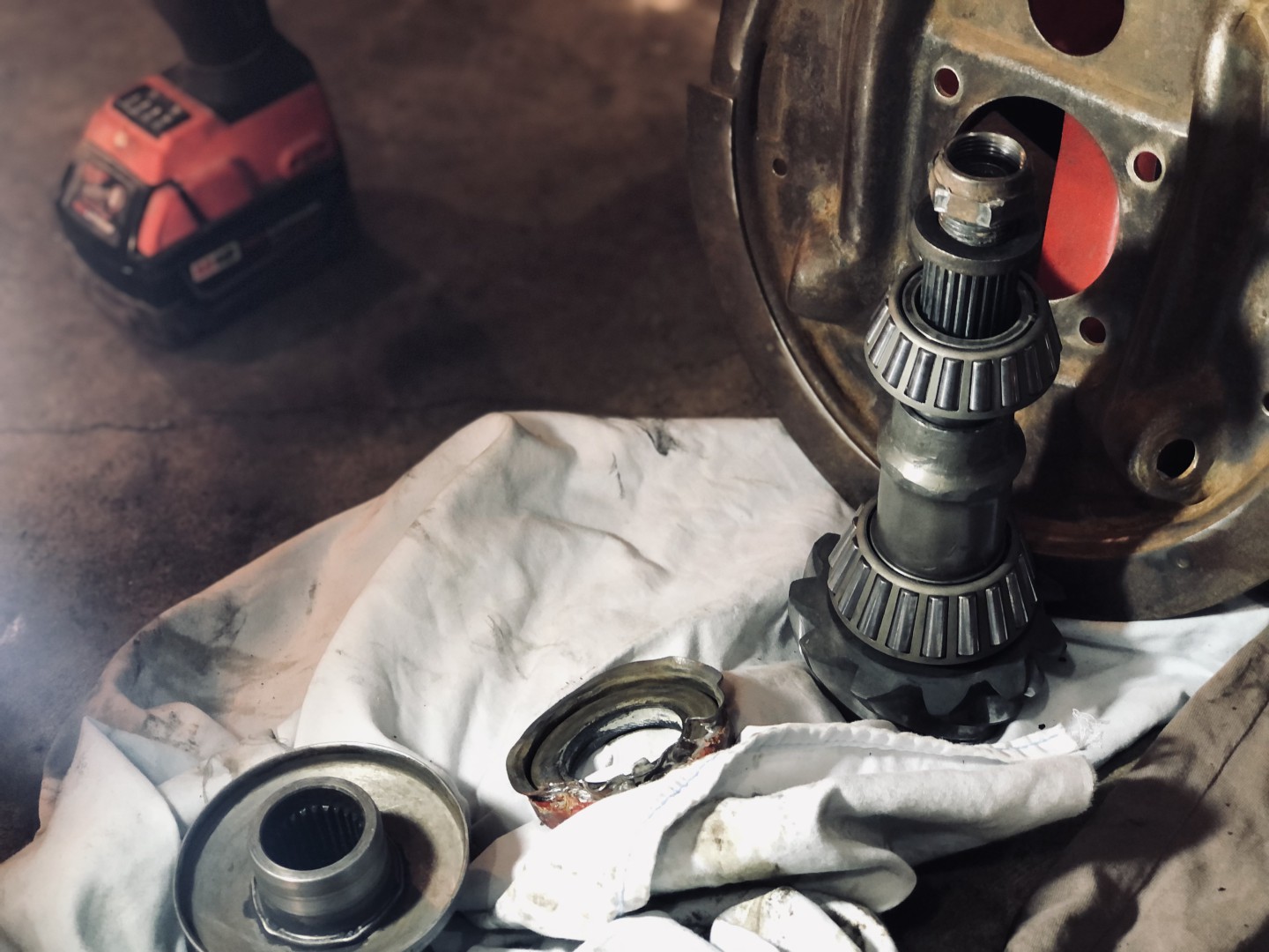

Well I decided to remove the pinion seal and possibly replace the front bearing. Everything looks good. Also considering a spacer instead of the old crush sleeve to set the pre-load. A little delayed on painting the housing. Would be nice to have a parts washer and a blast cabinet. Since I was as far as I was on cleaning the housing I decided not to have it powercoated. Actually pretty reasonable I thought. About $400 to have it cleaned at thermo, then acid dipped to remove rust, a light sand blasting, and then powercoated Including transportation. $250 to do the backing plates, springs, and spring plates.

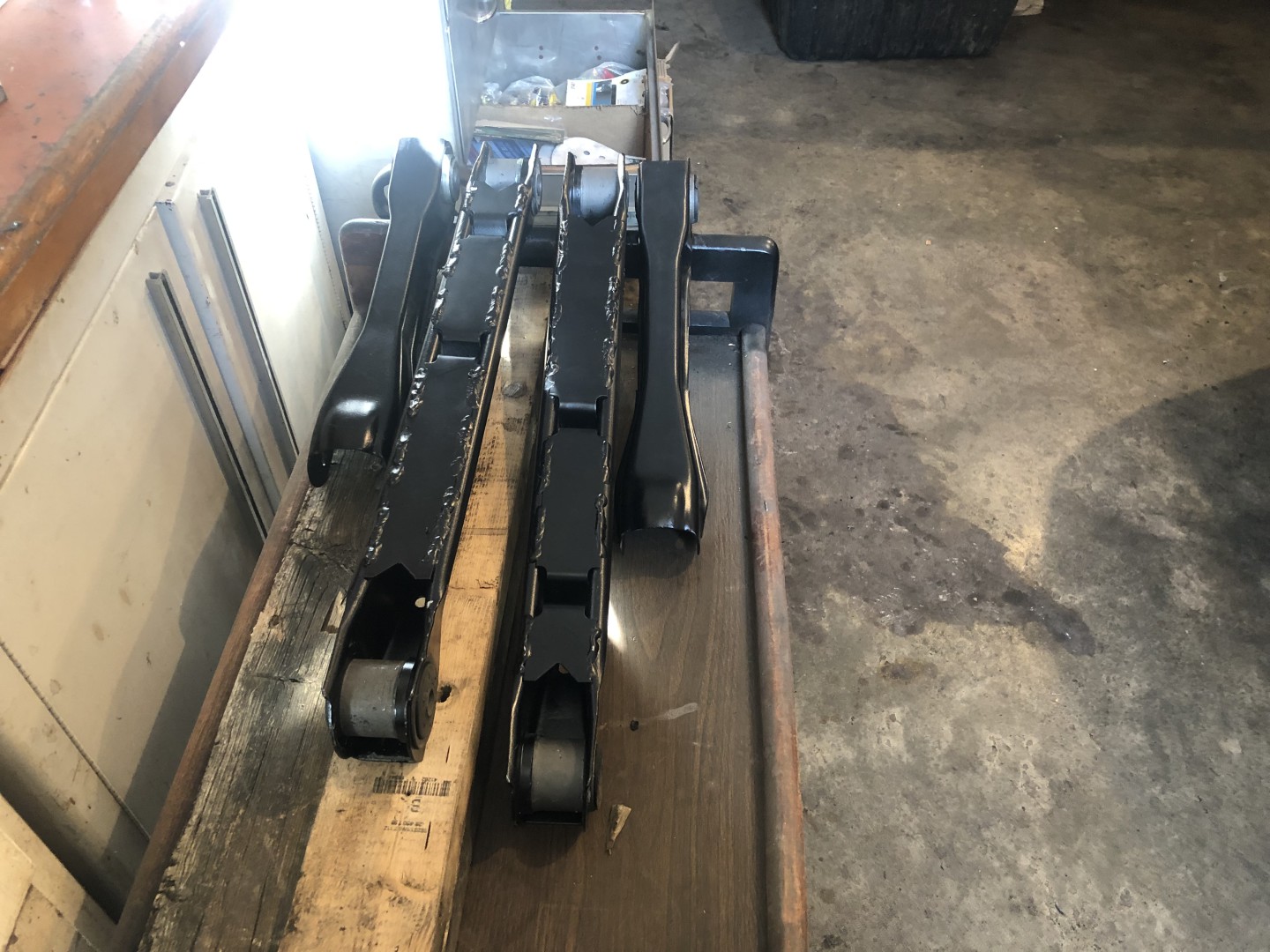

Got the CA finished. Bushings went in fine. No freezer needed,just left outside overnight. A little more sanding and cleaning needed on spring and backing plates and they will be ready for paint. Kind of odd, the top coil of the springs, the area that went under the insulator was dipped in black paint. The rest and the hold dow clamps were bare steel. The backing plates and axel tubes were bare steel the cast iron part of the housing was also bare. But sometimes they sprayed the axel housing black, along with the housing side of the backing plates, and the outside of the brake drums.

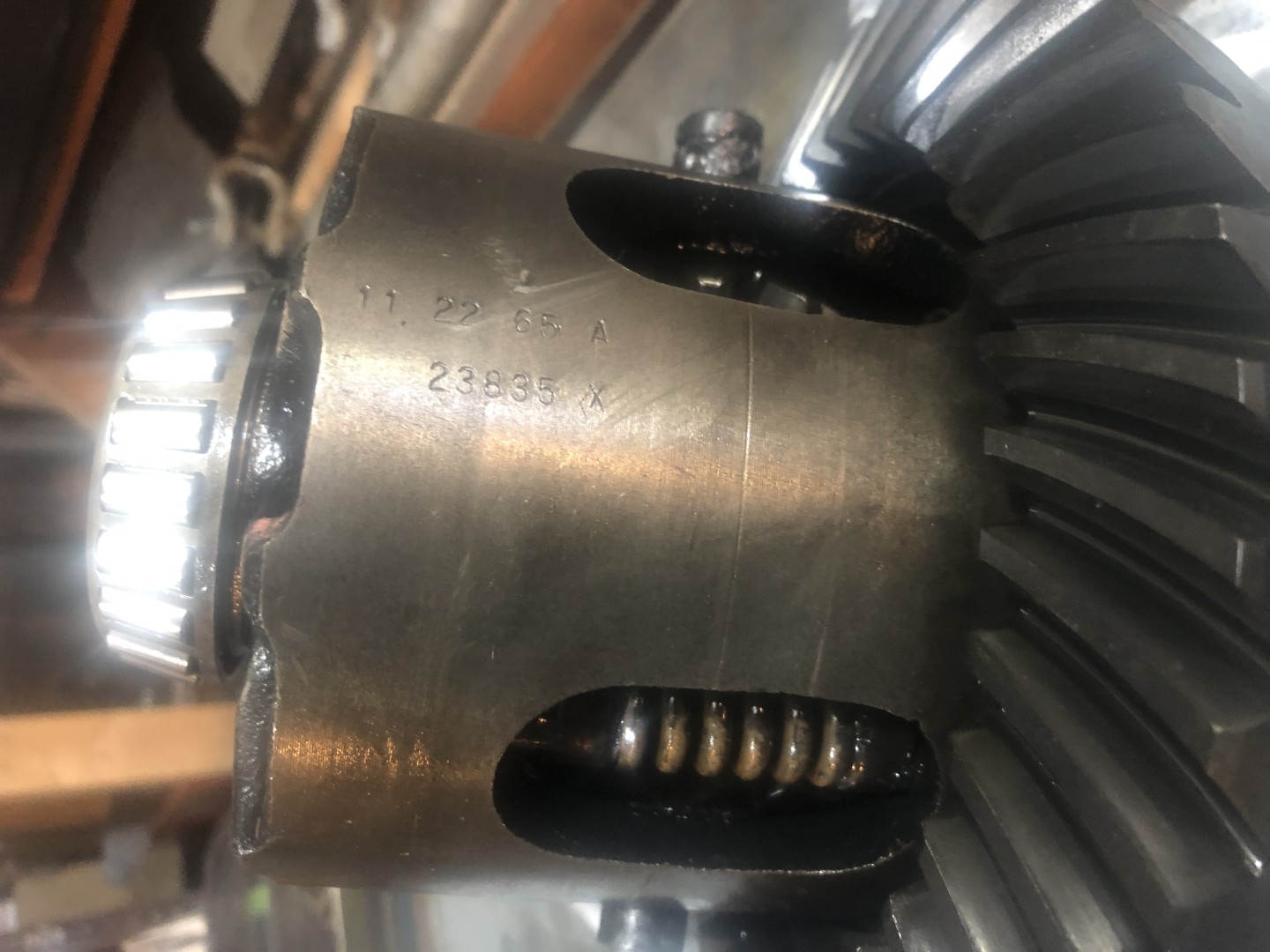

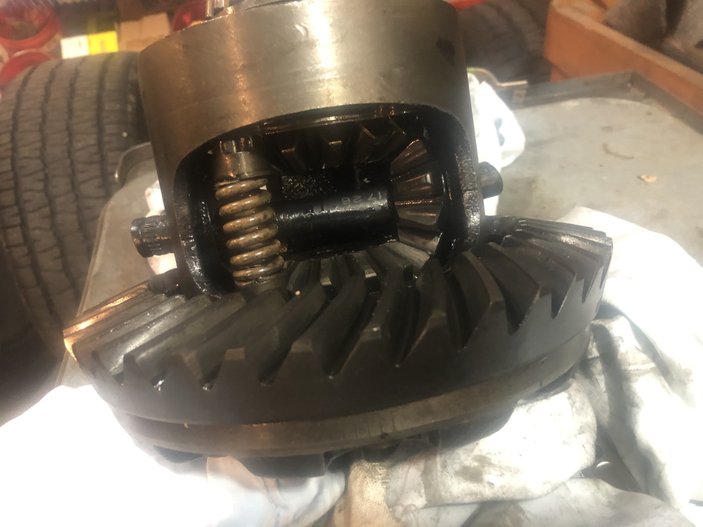

Thanks to Bob the posi is finished and installed. More things completed. Housing to be installed this week. Classic Muscle sent some wrong parts. I had to install both muffler, they has to be flipped and rotated 180 to get things lined up so I could installed frame reinforcements. And get the exhaust to exit close to factor so I could access the CA nuts. Universal doesn’t mean it will fit. Beginning to think I should have got a correct exhaust system. Painting and cleaning done.

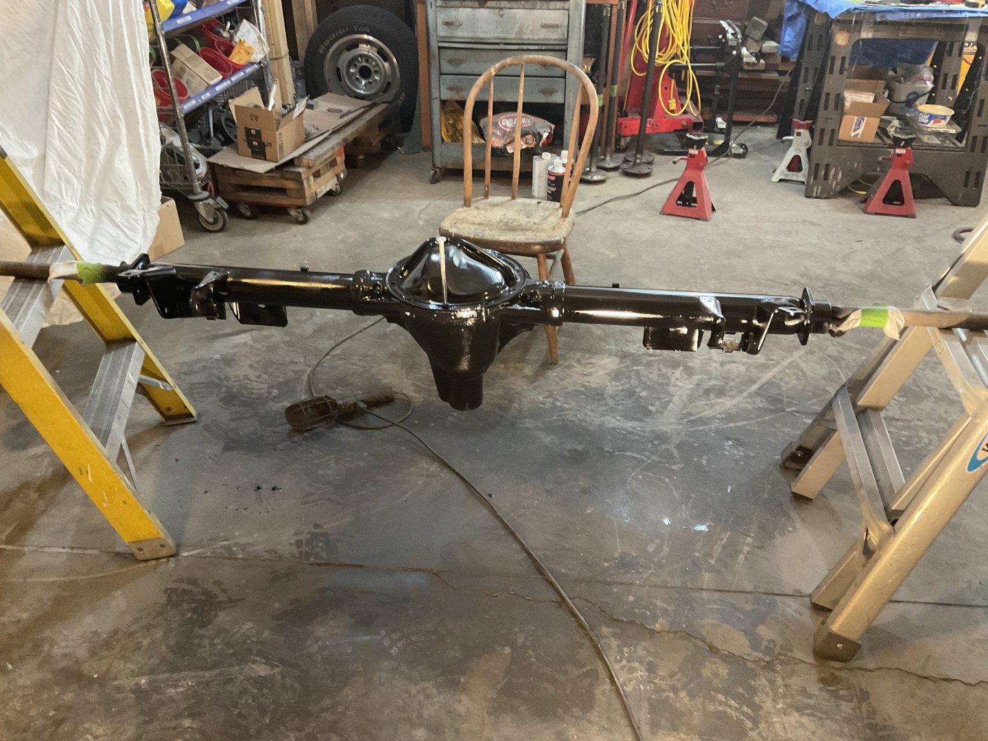

Feels good to be done with painting the housing. Kind of a makeshift painting booth
