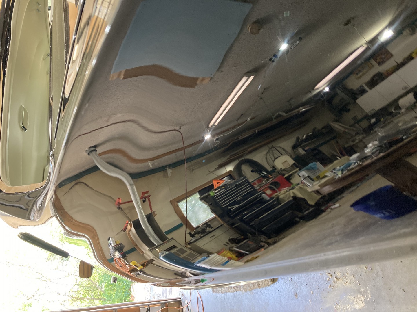

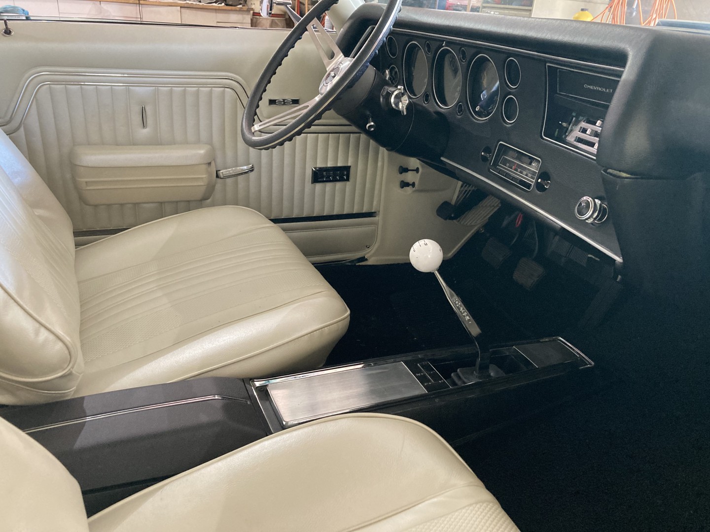

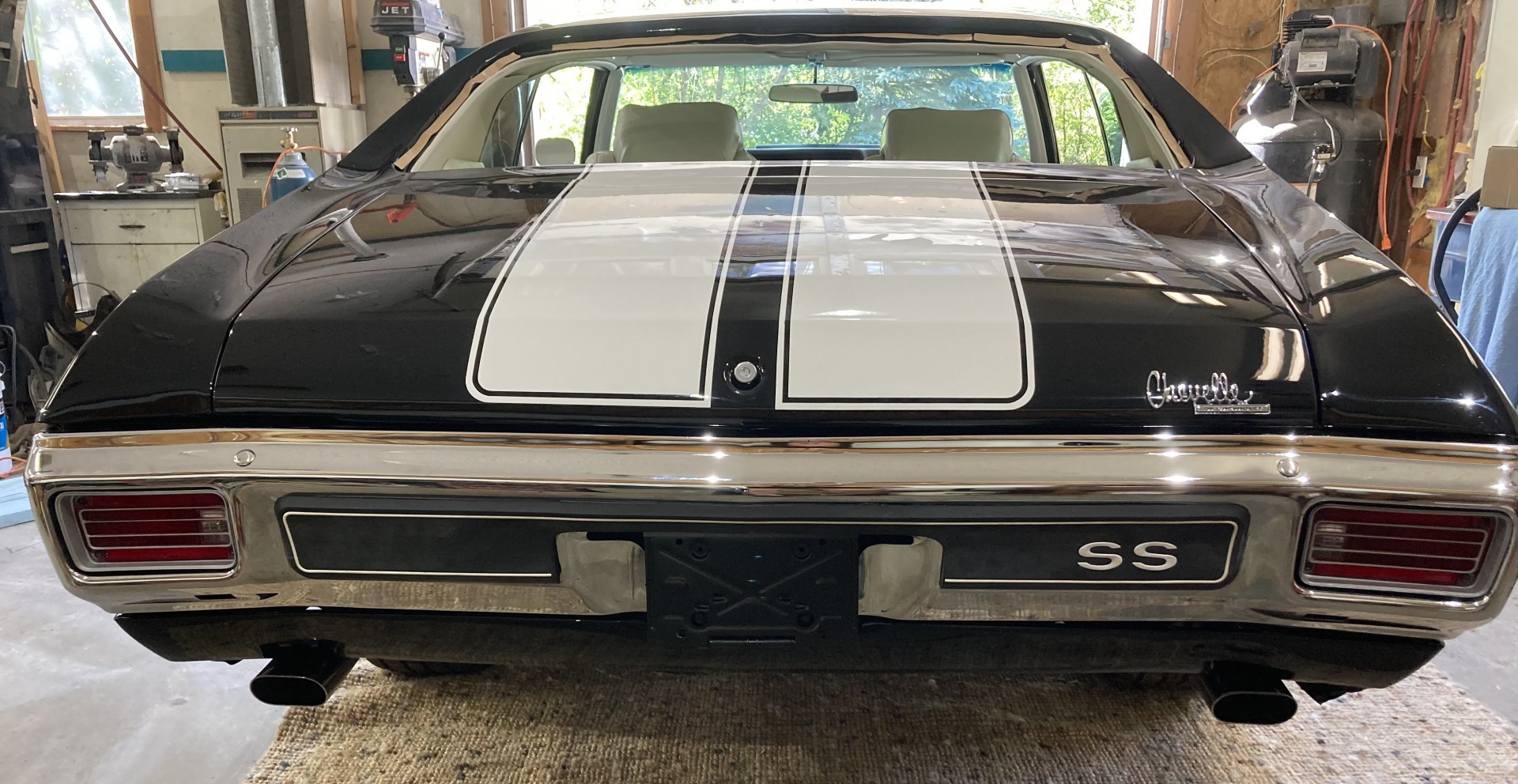

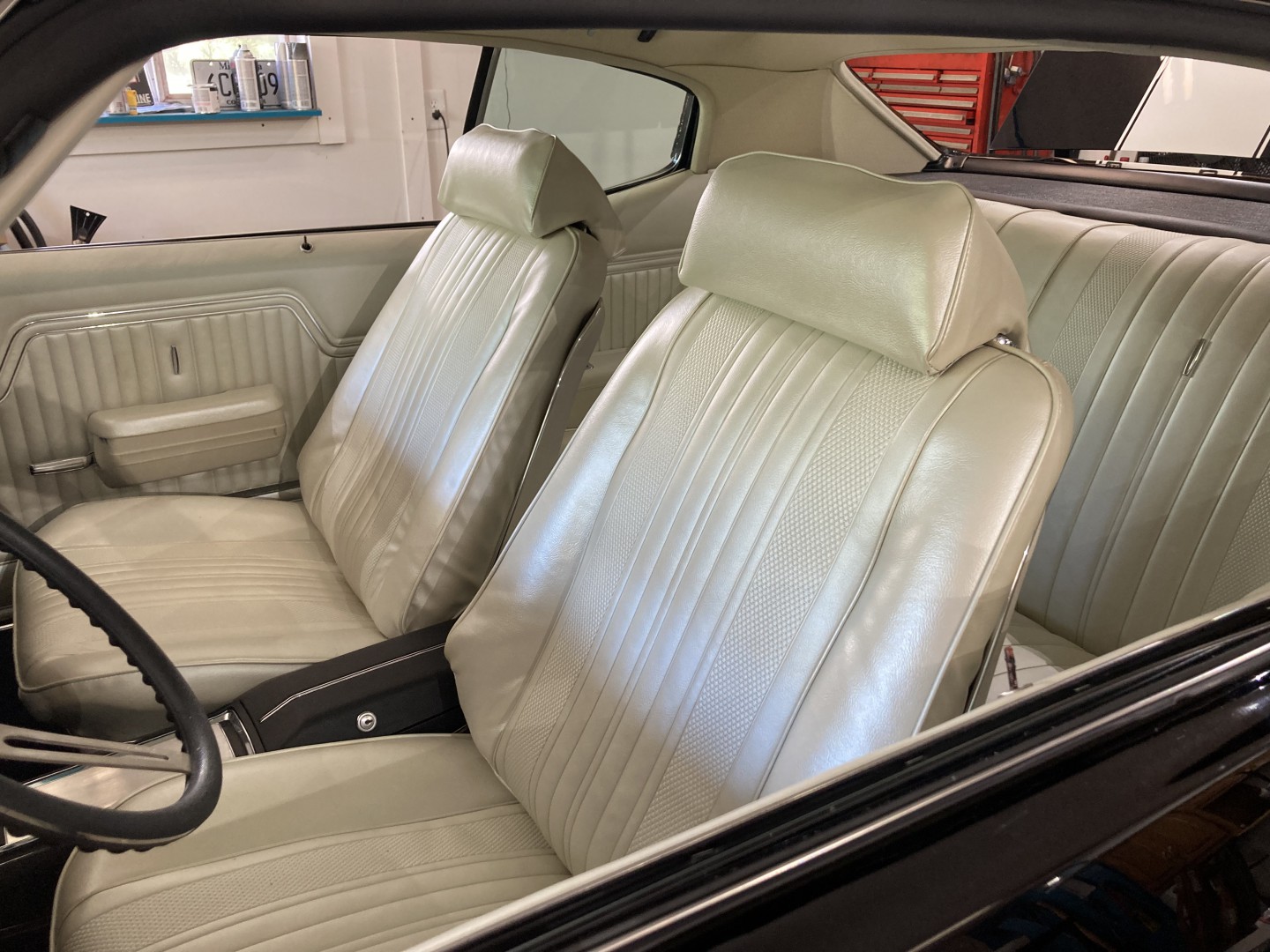

Thanks guys. How or where do the bolt into the roof? Here’s a few pictures
Interior
OMG, no kidding, absolutely stunning !!
There should be a bolt anchor in the roof structure for the original shoulder belt above the quarter window seal area.
I LOVE that ivory interior. IF I ever get my '70 restored, that is what it will have. My '70 SS LS5 car I bought in 1973 was all black with the white stripe.
Hard to find a pic of the shoulder belt mounting location on the web. This is a '69, but same basic roof structure.
There is a pad with 3 holes you should be able to feel thru the headliner. The 2 outer are threaded for the belt mount bracket. They are rearward from the front edge of the quarter window and 6-8 inches in front of the clothes hook.
