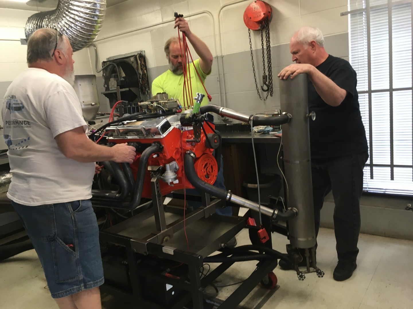

Finally had the opportunity to do the Dyno on the engine. The engine builder and EP of Egan did the work. They were really conscious. Kept increasing the jet size and timing until he was sasistied. Then did a cruise run, etc.
Do you have a tentative date for install ?
Do you have any dyno sheets you can post? Curious how that combination worked.
No, Dereck the engine builder was doing another Dyno and he would fit me in if I could make it.
He did 5 runs to get the fuel where he wanted it and the timing. This was the final run.
