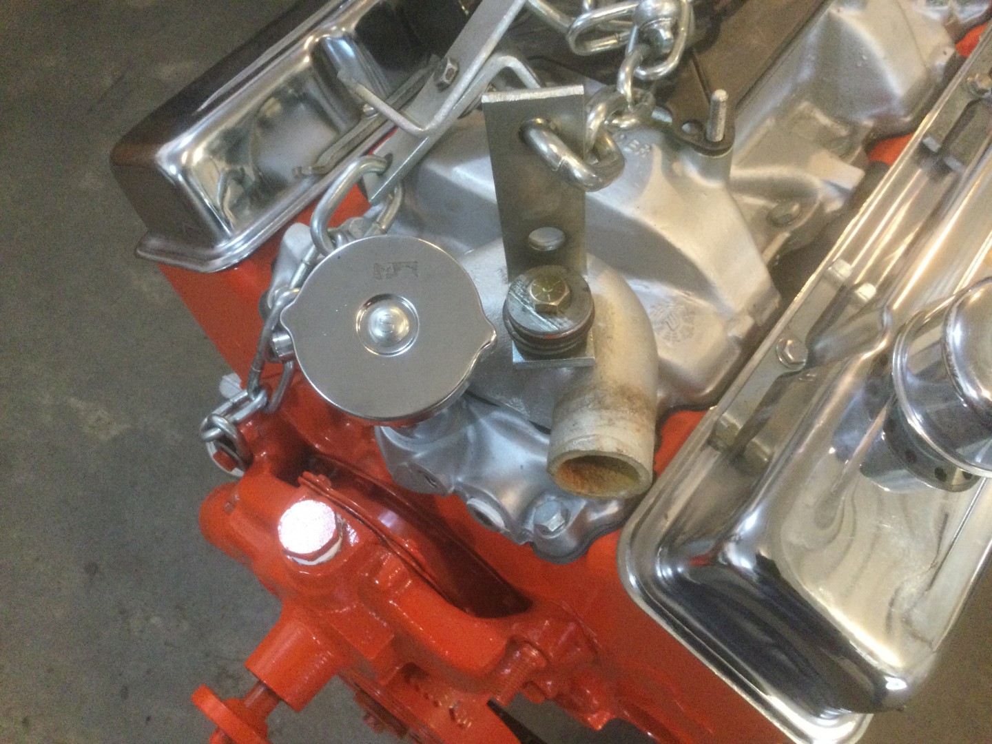

Thanks guys. I am having brackets made for the exhaust manifold head (did not work here as I needed a quick solution due to dyno tomorrow). So I used the two rear intake manifold heads and the two upper water pump bolt holes. This may or may not work with the trans installed. Here are a few photos.

I've used the intake manifold threads in the heads many times, and no issues.
I've also used the lifting plate on top of the intake manifold with the trans bolted to the engine and never had a problem.
Both methods with a BBC with the trans still installed so it's lifting 500-700 pounds.
I guess I've been lucky or there's a lot of urban myth's out there. Having said that, I ALWAYS keep hands and feet clear of the potential 'drop zone' if something goes bad.
