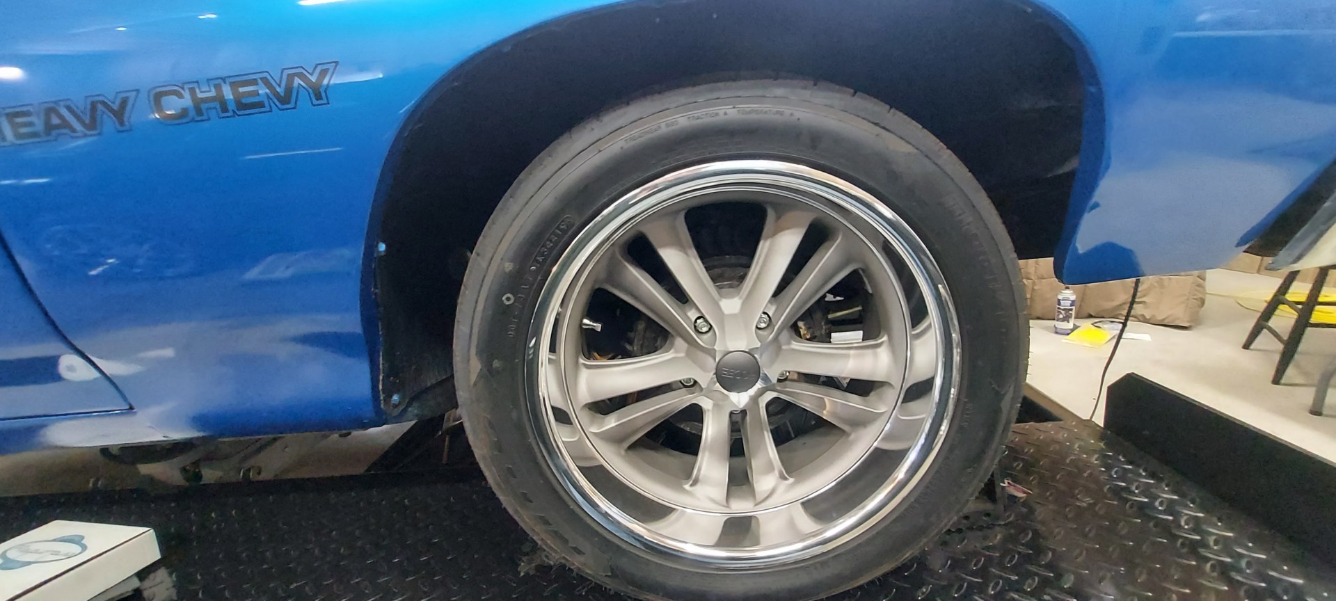

The Global West set is $1000-1200, so twice the budget.
For tires, I have the Nitto NT all season 60 series all the way around, which are a slightly softer version of the NT555 tire and rode really nice on the 69 last summer when I had them on that car. They are a softer compound/sticky, but not a harsh ride.
Yes, I'm waiting for Derek's comments as well.
