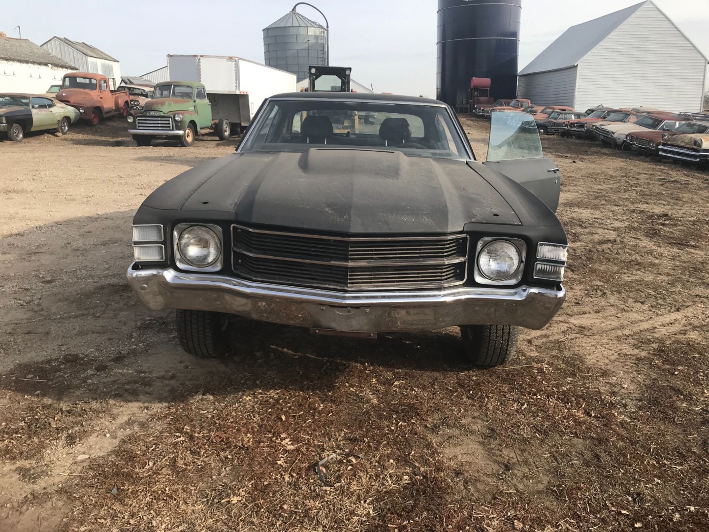

As y'all know me, I've been through my fair share of '69-72 Chevelles and know my way around them pretty good. But, I'm looking at this roller as a project car and what concerns me is that it's all in primer and appears to look fairly decent in the pics so there is probably some rust hiding, but one can never tell.
So, if you were going to look at this one, what would you look for other than the usual spots? Rear quarters, fender bottoms, under the back glass area, rockers, trunk pan etc?
It's had a new rear driver's quarter, one piece floor pan, and supposedly the cowl hood is new. The trunk pan looks mostly solid but does have pinholes, so probably needs to be replaced.
I've about got myself convinced to go down and look at it tomorrow and maybe drag it back. They're asking $6700 which doesn't seem too bad IF the metal work is decent.
The vision of the project would be to recreate the '71 Malibu I had in high school in the same Classic Coper, white vinyl top roof, and sandalwood interior but with some SS goodies like this one:
Looking at the work, and the stuff in the background, my first impression is that it was thrown together for resale... which means shortcuts and half-assing things.
Flat black can hide a lot of sins.
That said, where is it? That place looks familiar. I swear I've been there before.

That's my concern as well Derek. I spoke with my buddies at Burnsville Maaco about doing the scuff and shoot on it, and they also said the same thing. I guess the only way to know is to see it in person.
It's at a 'dealer' in SW Iowa. As you can see of the cars in the background, they are mostly 'project' level/field find cars.
He told me this Chevelle came from South Dakota, which I guess is a step or two from a Minnesota car since they don't use as much salt there. But, it's still a 49 year old car. Lol

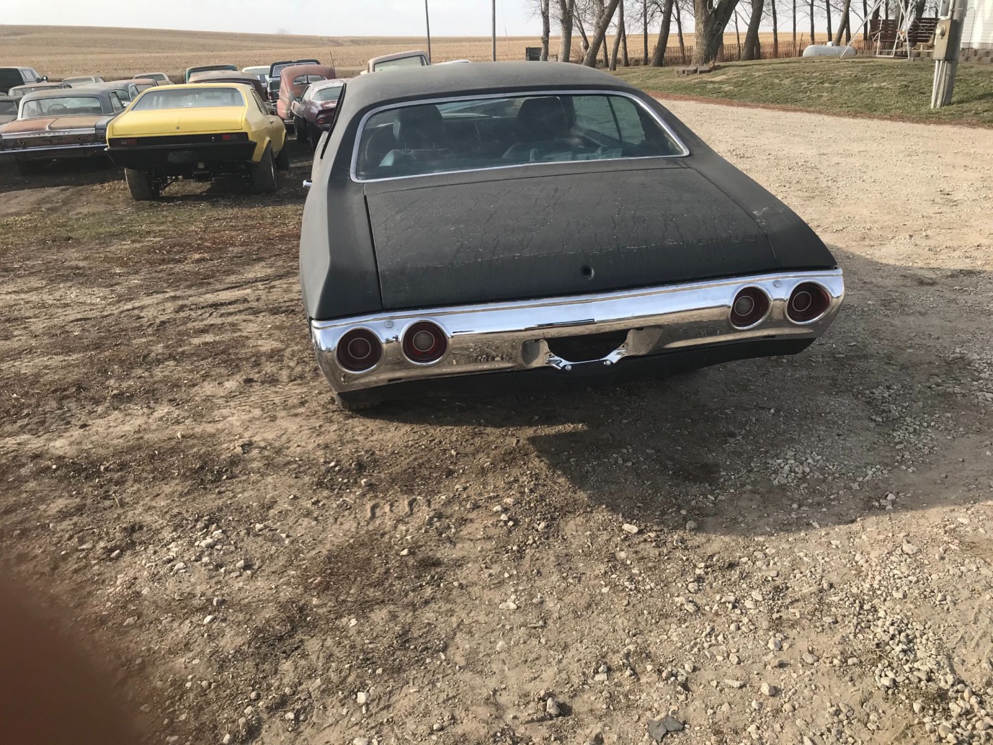

The driver's quarter panel gaps look pretty bad, especially to the trunk lid. (on the first car posted)

I noticed the same gaps as Derek. And that is not an easy fix. Leaving the car all dusty and dirty is another con-man trick. On the other hand, the end goal looks pretty nice, and you have to start somewhere.
Take a bunch of weak magnets and check it all over.
Good luck!

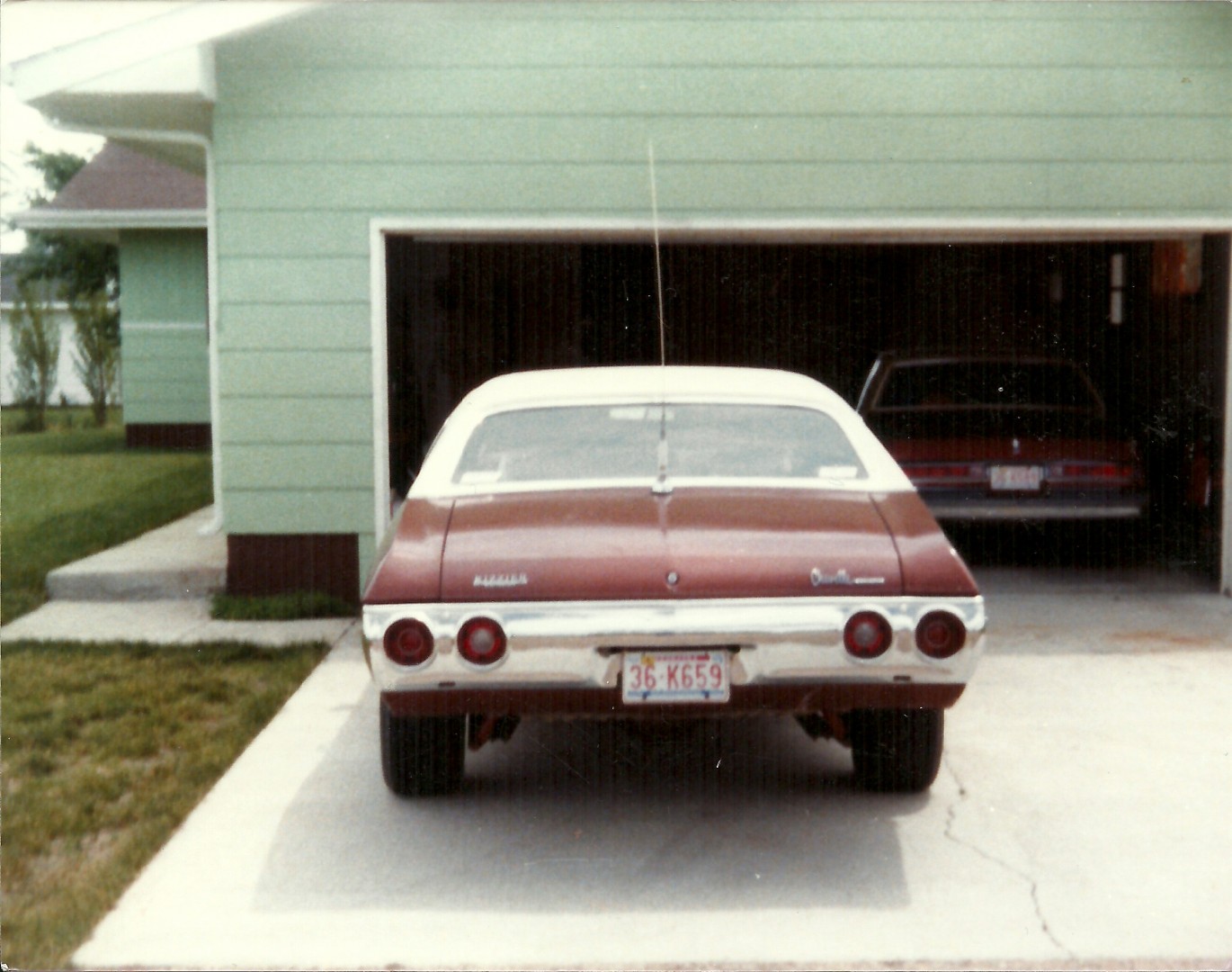

I dug out the few pics I have of my 307 c.i./TH350 '71 Malibu high school car to see if it looked as I remembered from 40+ years ago...and found these pics. I've posted a couple before, but this is what makes me so attracted to that copper/white color theme.
Some 'performance' upgrades I did to it as a 17 year old were:
-Installed well used Corvette SBC iron 4 barrel manifold with Rochester carb
-Installed headers with glass pack bolt on mufflers dumping into tailpipes in front of the rear wheels (loud, but I was 17 and thought it was cool!)
-2nd gen F body bucket seats reupholstered in tan pleather and crushed velvet ooooooh. lol
-B&M Quicksilver shifter
-B&M shift kit that even with a measly 307 c.i. SBC it would always get 2nd gear rubber
-Painted ET Street 5 spokes with rattle can gold and it had narrow white line tires on the front and the Firestone II's that were L60's if I remember right.
I guess it's these kind of memories that make us all have the same car disease.
P.s. The '64 Ford Fairlane in the background is the car I learned to shift a manual trans. It had a 3 speed on the tree with an electronic overdrive lever under the dash.
The CB Radio is impressive, 80s version of the smartphone.
Yeah, buddy. That antenna should be tall enough to bring in the trucker chatter on I80.
I'm wondering what a Road Runner air freshener scent smells like ???

Good catch Mitch! Maybe my CB handle was 'Looney Tunes'...????
I don't recall what the air freshener smelt like. It hid most of the exhaust and fuel smells from what I remember.

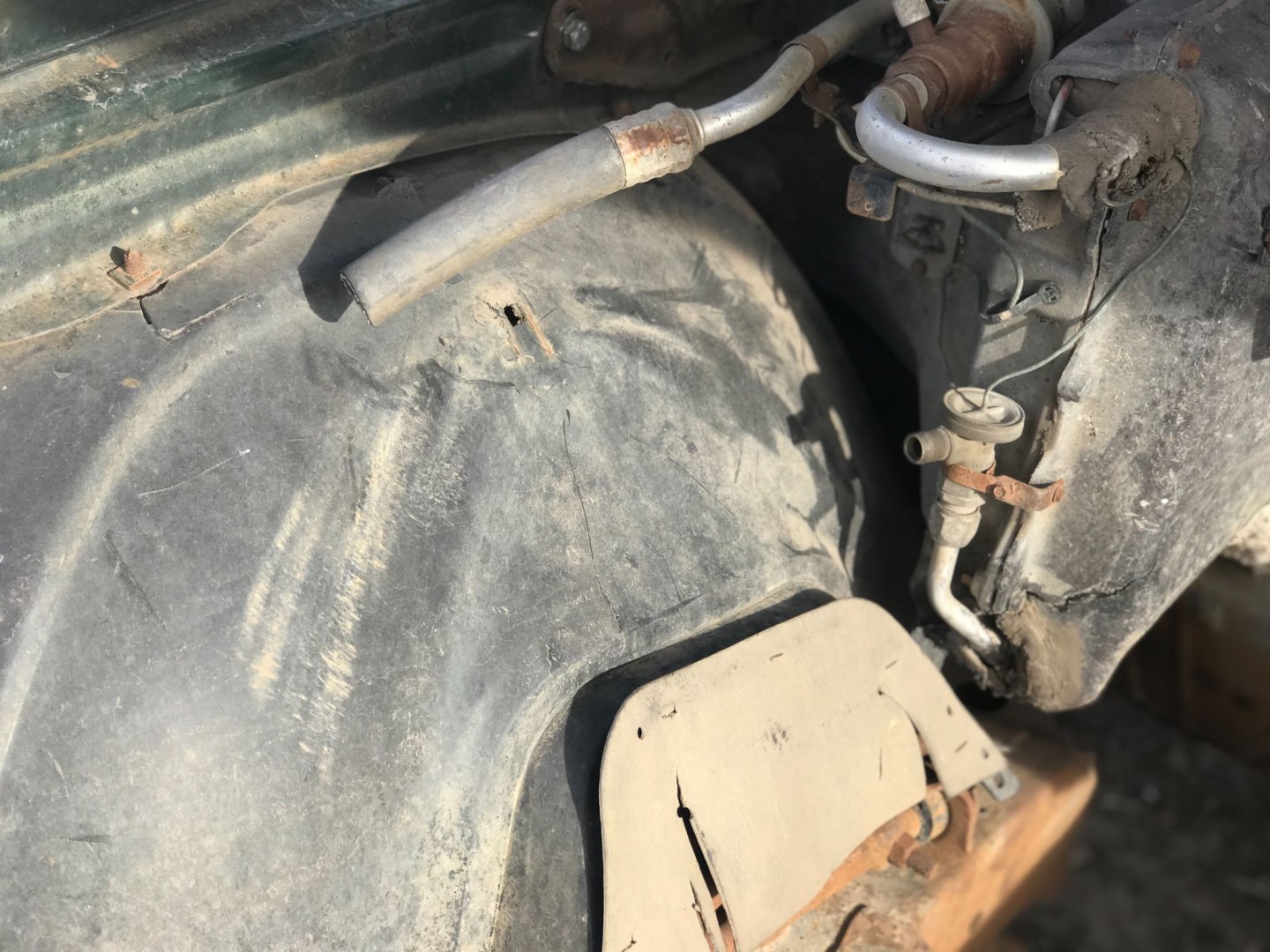

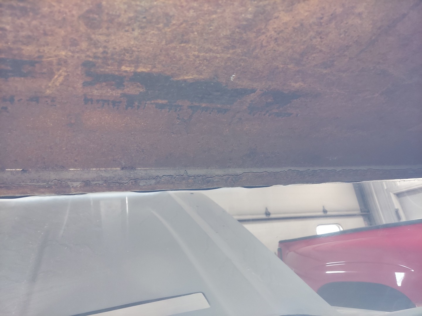

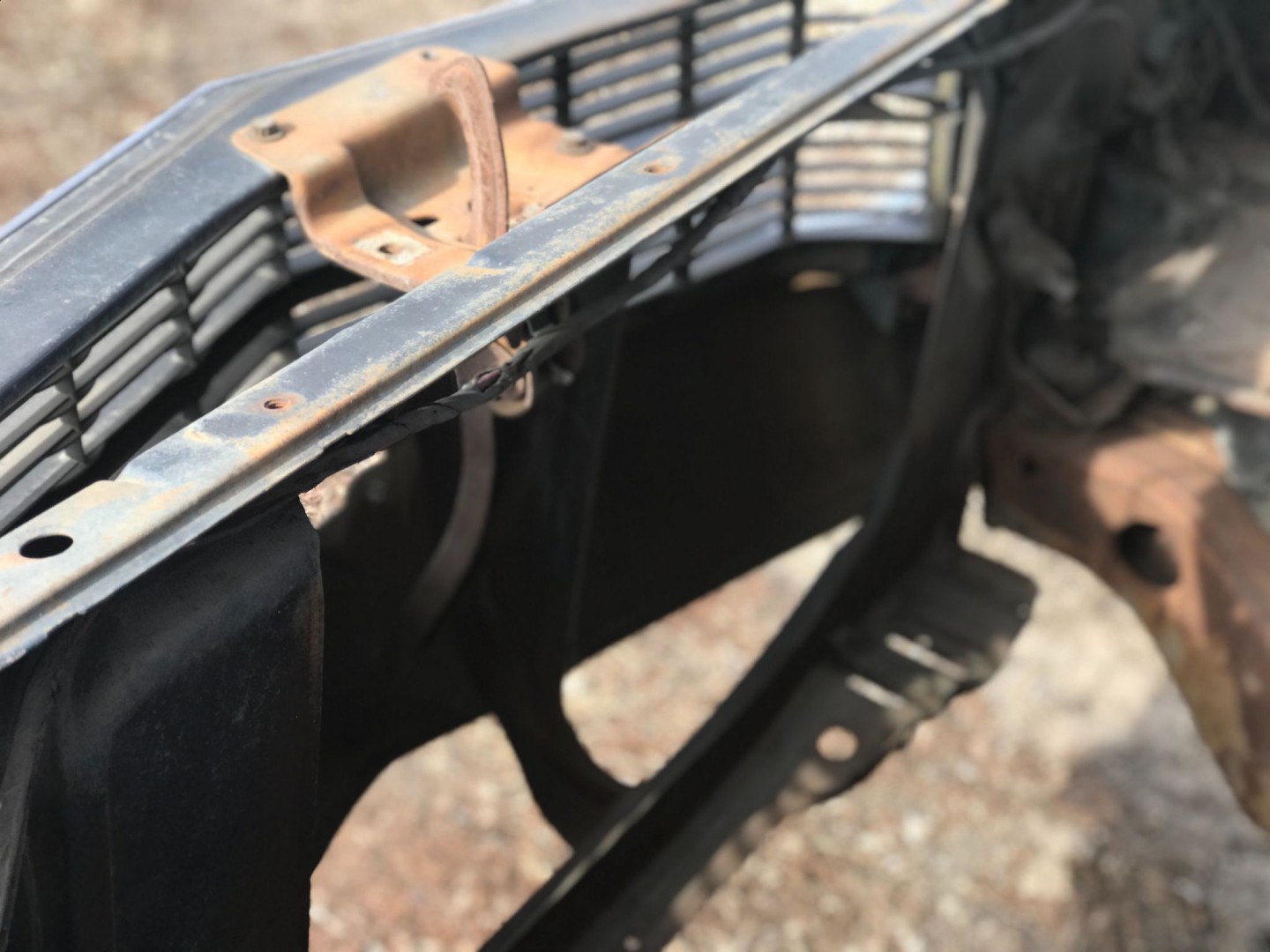

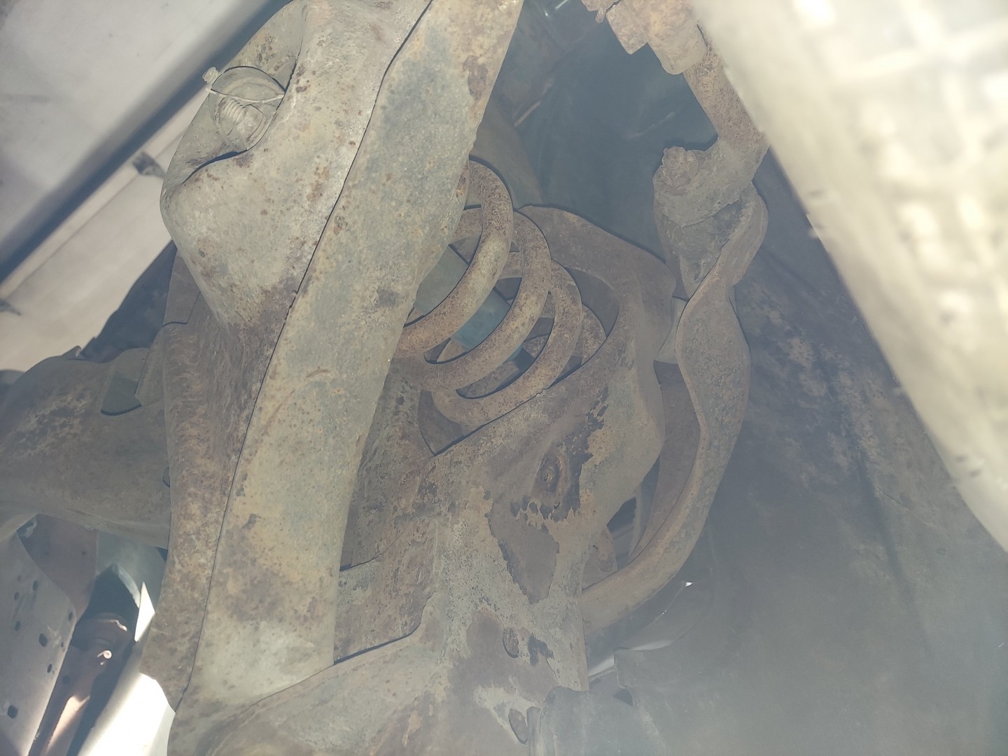

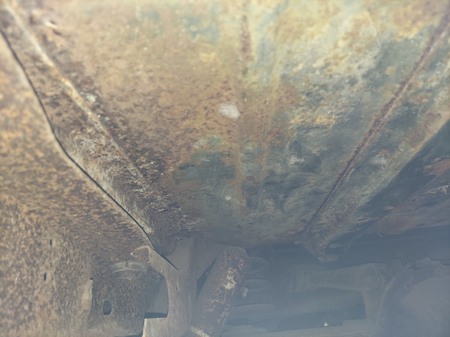

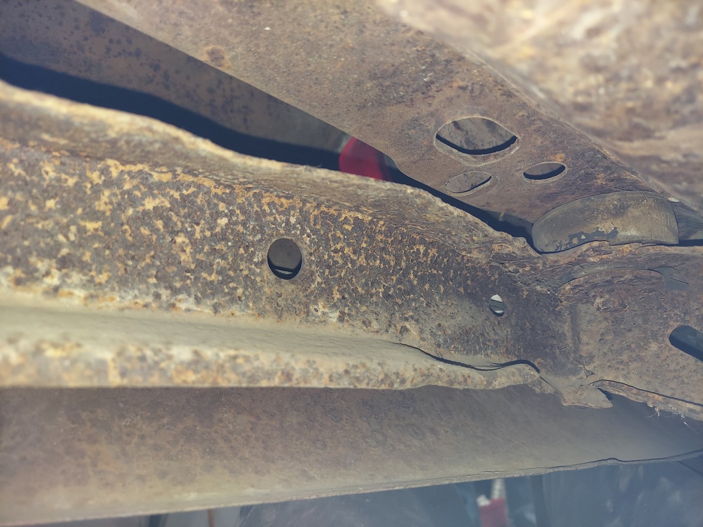

Took a nice Sunday drive down to NW Iowa today to get eyeballs on the black primered '71 to see firsthand how things looked.
The Good:
Original GM front fenders to the car and doors (drivers is an OEM replacement from another car, and passenger is original to the car) and both door bottoms are solid.
Frame has no cracks or signs of impact (looked at front horns, corners, and rear area)
The rear passenger quarter is original and in mostly good shape
All original glass is there
Complete dash assembly (more on that later)
Lots of surface rust underneath and original sound deadener. Majority is solid when doing the screwdriver punch test. The only 'soft' place I found was on the drivers side of the trunk pan, which is original.
The floor pan supports have heavy surface rust, but are solid
Front cowl beneath the windshield under the stainless trim is completely solid (unlike the '72 vert I restored that had a 1" hole all the way across)
The drivers side trunk gap is large, but the passenger side is too tight, so looks like some adjustment with the trunk panel would address that. It has original quarters at that height, so the theory that the drivers quarter was replaced incorrectly doesn't make sense now. I'm guessing the factory alignment wasn't all that great to begin with. The rest of the rear corner gaps and above the bumper are really good (better than the 72 vert I had)
Inside rockers are solid
I negotiated a $200 price drop to $6500 if I decide to buy it
The Bad:
Found bondo in the usual places; bottoms of front fenders, drivers side rear quarter that has had a lower quarter panel replacement in front of and behind the wheel opening
The center ceiling brace is bent inward about 3/8" and the adhesive in that area has a gap, so that would need to be addressed. The roof looks flat on the outside though, so not sure why it's bent. I looked at the rest of the roof skin on the inside, and it looks original so I don't think it was replaced.
Found quite a bit of rust on the inside top of the windshield opening that will likely need to be replaced. It's on the outer edge of the channel, not the part the windshield rests against.
Could get by not replacing the trunk pan, but should probably put in a 3 or 1 piece kit to do it right.
When the 1 piece floorpan was put in, it was put in on top of some of the original floor pan in the rear passenger footwells rather than remove the entire old floorpan. The original floor pan metal should probably be removed.
The pictures here aren't real good as the flash on my cell phone kept messing up on me, but you get most of the idea.
I'm going to talk to Maaco in the morning and get their thoughts on the additional work on the rear quarter panel, fender bottoms, and a couple of other small areas to see if I would be allowing enough in my budget IF I bought it.
Everyone talked about 'good bones', and what I found is the frame does look completely solid, the fenders other than the bottoms, doors, roof, trunk lid, new hood, are good.
Tina and I had a good talk on the drive back, and we both think if I do this it needs to be different than the 8 month frame off thrash that we did on the '72 vert, and give this one a 2 year goal. I'm older and slower now. Lol
I'm open to thoughts on my Good/Bad list above. Keep it coming.
First concern is...does it have a clear, transferable title ?
The steering appears to be MANUAL ? Is the vin for a 6 cylinder or 8 ? I see the engine frame mounts are missing, maybe to hide the fact that it came with a 6 ?
I don't see where the new floor pan is even touching, let alone welded to, 2 of the supports.
Sitting on the old floor pan is holding the new pan too high to sit on the supports and getting the old pan out, would either involve cutting up the new pan, or removing it. Either choice is going to involve a lot of work required because of a really lazy, crappy, install on a car that could be so much better.
The rest really does look like "good bones", but is a full on restoration, and you seem to realize that.
If the front fenders are as botched as it sounds, you would be better off finding clean originals down south, or waiting for a pair of NOS to pop up. The '71-72 fenders aren't as expensive as the, more popular, previous years.
Sorry, I mis read your fender patches as front and they are rear. Again, if the repair is crappy, you may want to consider a quarter skin.

Thanks Mitch.
It's titled in the Iowa dealers name, so clear there.

Here's the project car:
Here's another 4 speed roller in Iowa for $10,900 that seems a little better, but not $4K better!
-- Edited by Derek69SS on Thursday 17th of December 2020 02:44:22 PM
Good luck!
Are you sure you don't just want to fine one a lot closer to the first picture?!
Real trend-setters, weren't we?
That's right Larry!
I had to get creative with the budget when making $1.75/hour at the local grocery store!
The Good:
The Bad:

Thanks Mitch.
I figured having the new floor on top of the old was not good, but you confirmed it. I guess a guy could weld them together and add welds to the supports, but probably not the way to do it.
I'll have to sleep on it. Right now I'm thinking it's more work than I want to get into, but who knows.
I know it seems like an inexpensive route to get into a car, but starting with a bare shell is a LOT of work and you would be very busy to finish that in 2 years.
1. Incomplete, Basket case.
2. Underside really "crusty"
3. Work that has been done appears to be "patch and dump"
My definition of "Good Bones" again:
Most important, Not rusty or crusty, this car fails in that respect.
The rust pits all over everything do not go away with sandblasting, they will still be there and affect final appearance.
Has title, good.
Complete, not even close.
Unmolested, no.
I will add "affordable" Looks like a rolling parts car.
This car needs a complete Frame off, every nut and bolt restoration.
Don't see any opportunities for any other approach for you to be happy with end result.
You are not building a "Rat Rod" you want to restore some of your past, and fond memories.
If you were retired, had all the body skills needed to do all body repairs yourself, so you are in control, it could be fun.
The two year timeline might be realistic, for YOU!
If you have to find, and pay someone else for those services, I fear it will blow your "Budget" and timeline off the charts.
