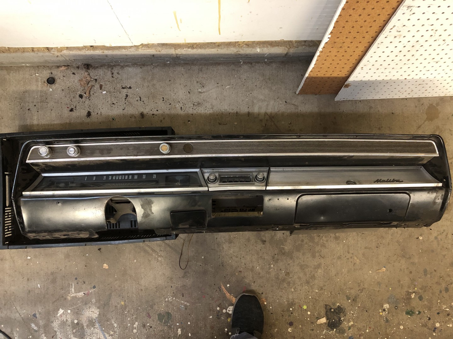

I missed the meeting on Saturday because I was making a deal on this thing...
Seller was very honest & up front & I was able to see all the issues. Floor pans are decent, not ideal, some patching in the typical spots but does not need floor pans or braces. Its definitely a 20 footer but none of the panels are rusted out. The right quarter will need some help but a magnet sticks to it. I can see varying filler lines along the panel though. Frame is very nice. The seller purchased the car in Arizona & brought it up here but cant say for sure if the car spent its entire life there for sure. Box is nice. Its a factory bucket seat car & the seats & console are both present plus the code & the trim tag verifies it too & the brackets are present on the floor pan.
The motor is a fresh rebuild with only dyno time to break in the cam. Its a 350 with a J eggs Vortec top end kit. The transmission is a TH350 that he says shifted just fine when he was driving it daily. The nice thing this car is farther along to getting back on the road then the other projects I have & it will be nice to have something to enjoy in 2021. Im planning a bunch of suspension changes for my 66 & ill just transfer all the rebuilt suspension & steering stuff onto this car. Ill probably start looking for a pre 66 10 bolt since I have a set of Hotchkiss springs that I would like to use on this car too. Ill probably swap the buckets from the 66 also since they are already covered, they are plastic back 1968 seats anyways & use these 67's in the Chevelle instead.
Sorry for the one photo being sideways. I tried uploading, removing, editing photo, re-upload, remove, rotate sideways to compensate (still posts sideways), removing, retaking photo, nothing worked. Oh well. 2 other photos posted sideways & I was able to correct it. This one wont change no matter what. Tip your monitor on its side I guess.
