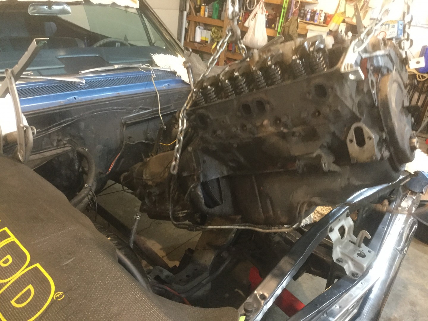

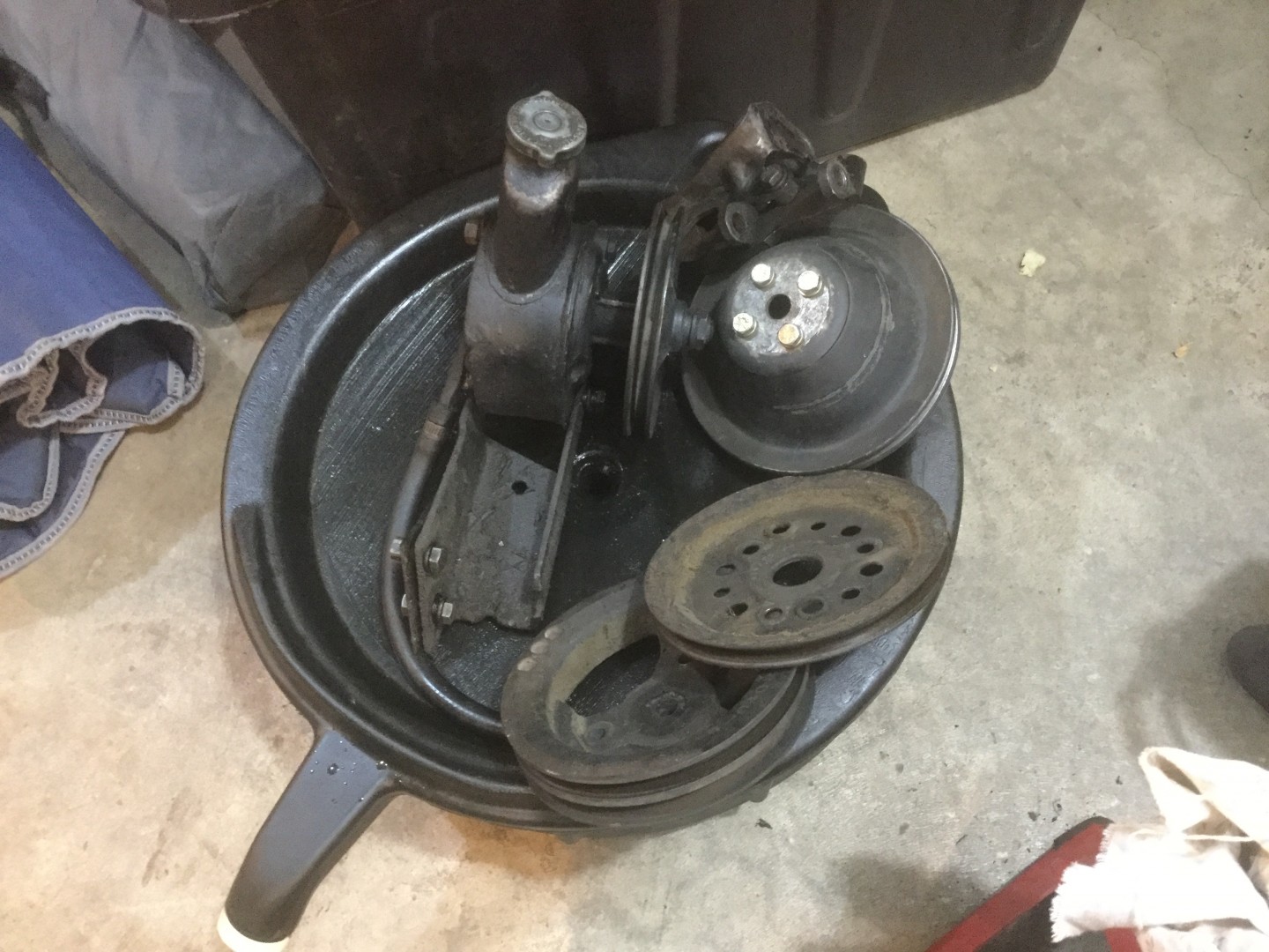

Well cold weather and snow has given me the push needed. Just finished preparing everything to pull the engine except hood and carb need to be removed. Just need to find or buy a lift. 2004r is at rebuilders. Will not finalize the plan until what is discovered when engine is disassembled. Much more to follow. Found two big sources of oil leaks. PS fitting loose, probably for years. Trans plug loose, funny it didn’t fall on the ground. Also appears a piece broken off the lower PS pump bracket or intentionally broken off due to larger SB balancer. And an odd PS crank pulley(appears balanced cast iron).
Well engine is out that’s to help from a guy who didn’t want to be photographed. Engine on to machine sop to be evaluated this week. Then a decision, 355 or 383 strokes.
-- Edited by jim larson on Sunday 1st of November 2020 05:50:39 PM
