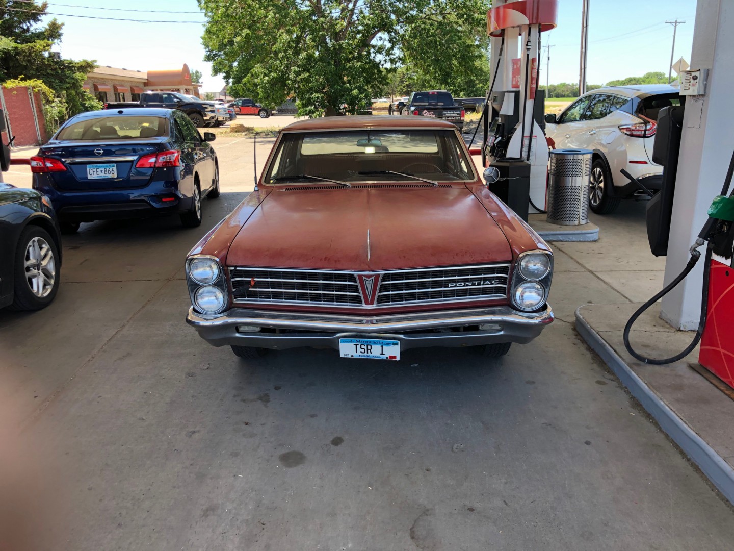

Saw it again on Dodd Blvd by Lakeville North a week or so ago.

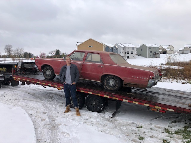

Today I went with my youngest son to reacquire his 1965 he sold almost 15 years ago.

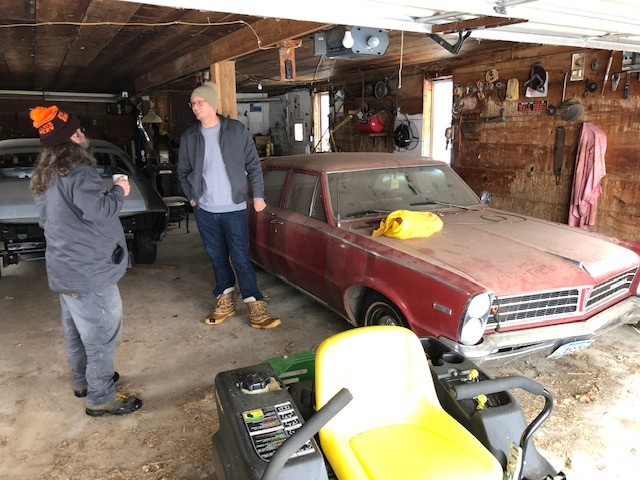

It has been in a barn in Otsego for ~13 years
There was also one they did not want to part with that may look slightly familiar to you all
