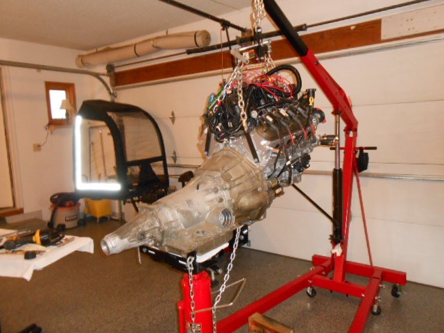

I know a lot of people use intake plates for engine r&r, but I would never recommend both engine and trans with that method. I always use 2 chains, 1 on the front of the heads and the other on the back and a load levelor, as seen below. With that, you can send all the weight to the trans for the steep incline you will need to get them out of the bay and once out, level it to flat to set down. I have an old yoke I put in the trans and zip tie to prevent it from coming out to retain the fluid. Place the yoke horizontal to eliminate it getting caught on the body.

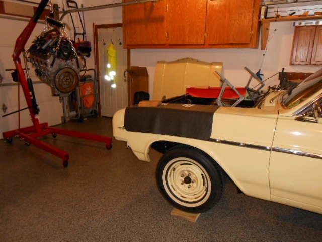

A nine foot ceiling will give you more than enough hight, see below.. Mitch is right, leave the front clip alone; why open pandora's box. But do use a leveler.
