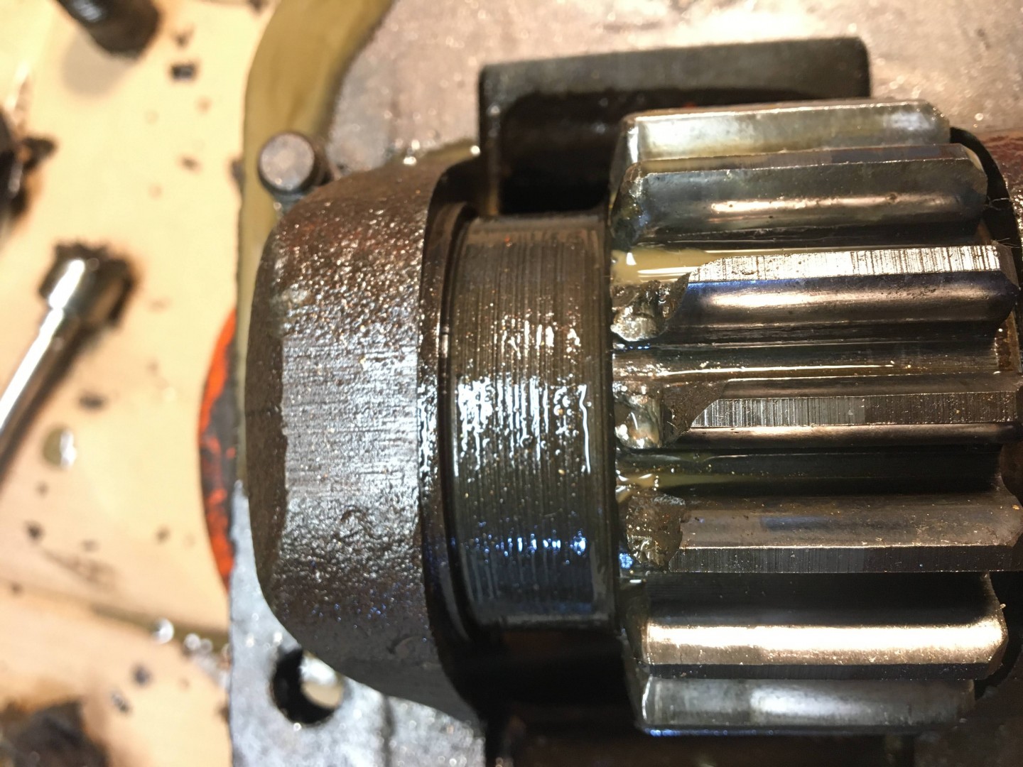

As some of you may of heard, I was recently given an Allis Chalmers WD from my father in law. The thing runs pretty well and does what we will need (mow the pastures, scoop poop and move round bales). I noticed some oil dripping out from the PTO seal when I first got it, and then after running the belly mower (PTO driven) it really leaks. I'm guessing the seal had just dried out and then when I went to engage the PTO, that was the end. Upon dropping the PTO housing, I noticed some broken teeth on the main gear. I'm guessing this came from someone trying to engage the PTO before everything had stopped spinning. I'm wondering if this is going to be detrimental and need to be replaced, or if I can file down the sharp edges on the gear, replace seals, and reassemble.
Is it available new, or do you need to get it from a tractor salvage yard? I think it would probably run for a long time as is, but as long as you have it out, it would be a good time to replace.
- They're out there for about $150-$200. I need to do some reading to know exactly, but it looks like the shaft that it rides on is a press fit into the housing. I agree that it may run and not have any problems, but I also don't want it to cause more issues if teeth continue to break off and now there's metal pieces floating around.

Like Derek said, if you can get a new gear, reasonably priced and in a short time, replace it. If not, no worries. You can see the wear pattern is much wide than the chipped teeth. I wouldn't worry about it. New seals and fresh lube will be all it wants.

In the exploded view, it's the idler gear that is chewed up.
