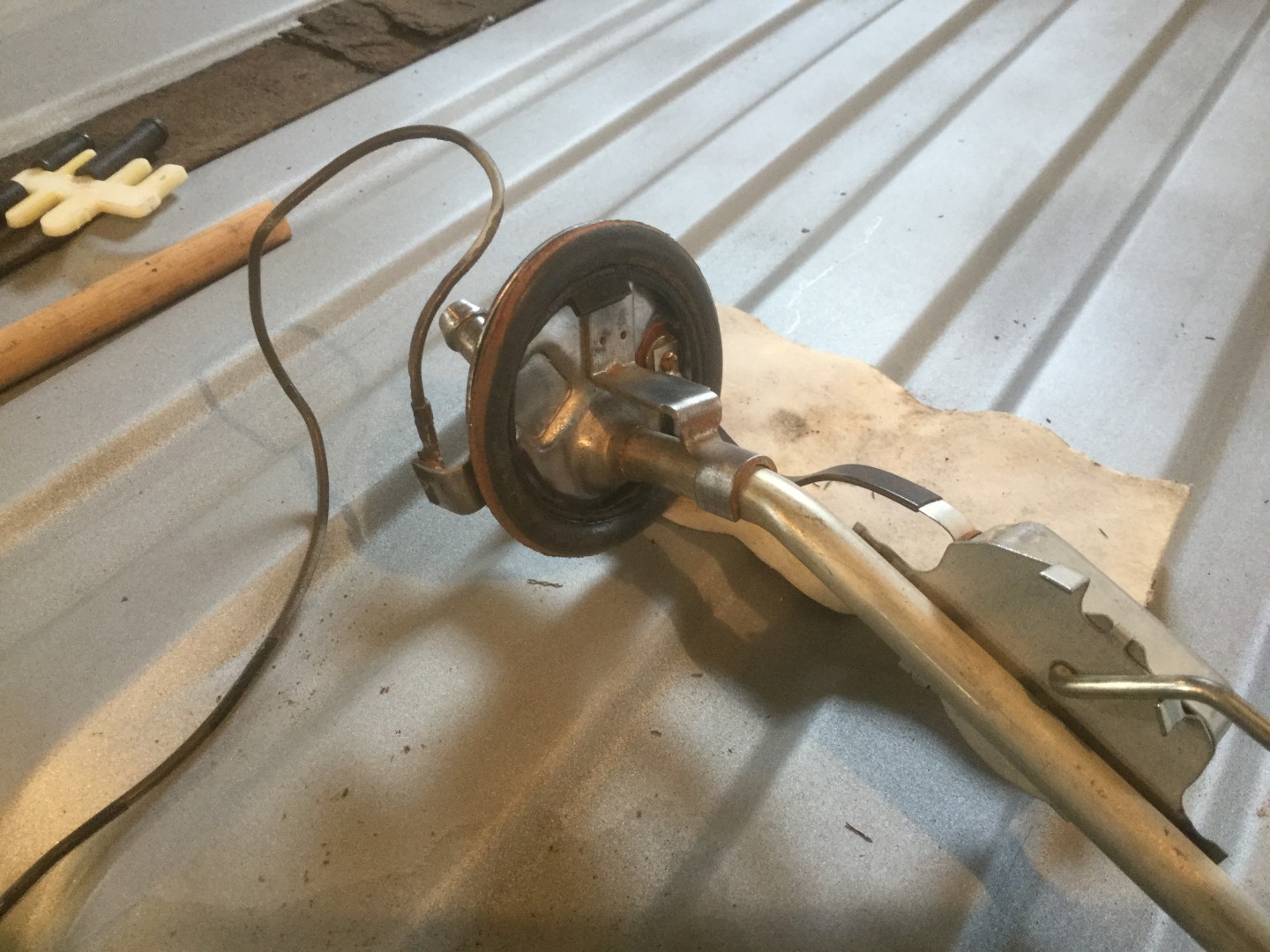

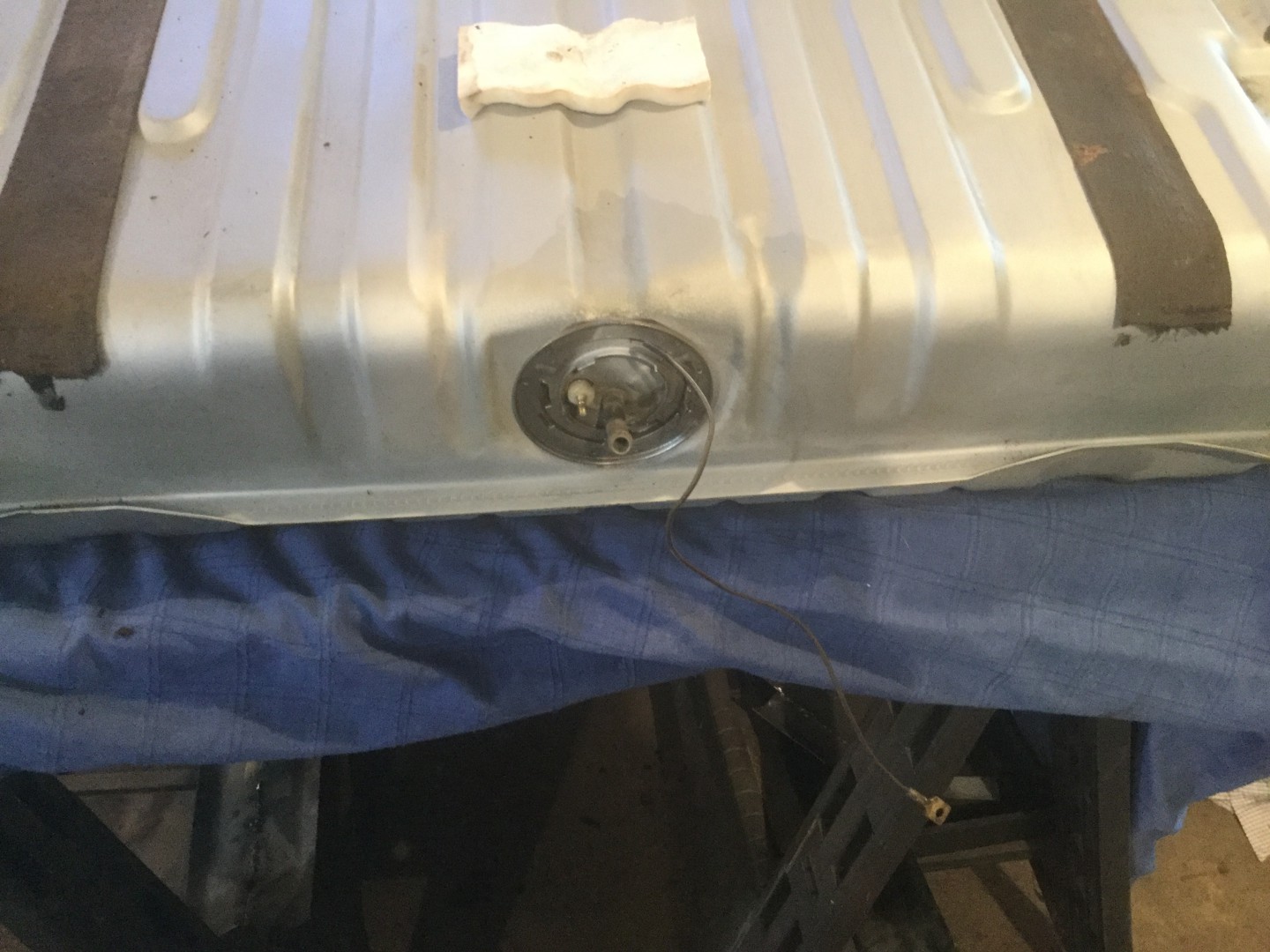

Well with no lift and wanting to make sure the sender weld was not leaking I pulled the tank today. I may be lucky, with a little gas left in the tank I tiled it up to get gas to the gasket area but not the sender tube. Appears to be leaking from gasket. Sending unit looks good. I plan to pull a vacuum just to make sure.
Almost 99% sure it was gasket. There is a tab on the gasket. Not sure where it goes, should have observed better. Her is a shot of where it appeared to be. Anyone know for sure?
Jim I have two questions.
Does your tank have a return line?
Is there a vent line?
Jun 18, 2020
There is a separate nipple on the right side of the tank that connects to the vent tube, located in the trunk, with a large grommet.
Jun 18, 2020
Thats were I’m going with my thought Mitch. I had one leak at the vent line connection because the hose clamp had come loose or I never got it tight. Difficult to troubleshoot because it will only leak when the tank is more than half full and or you tap the brakes. The fuel evaporates quickly leaving no evidence of a leak other than a small spot on the floor, but the fuel odor is very strong.
Did the A/C cars use fuel return line?
Did the vert have a different vent setup than the coupe?

2dr cp and convert are the same for a 66 chevelle as well as all the other 66 models except for the el Camino and station wagon I think.
