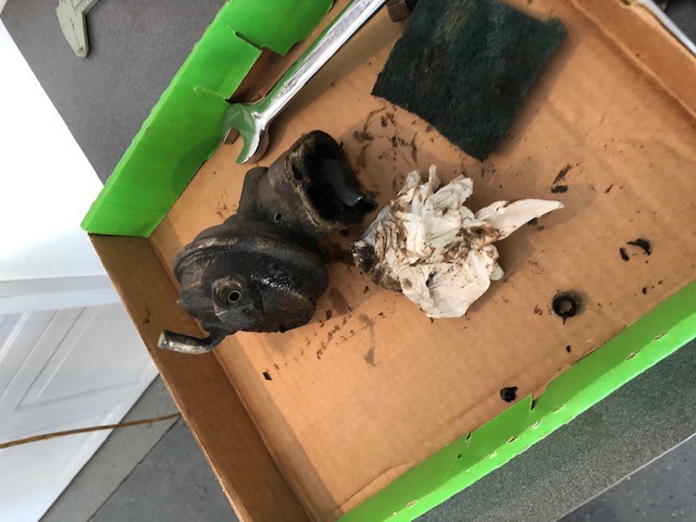

Yesterday the Fuel Pump went out, fortunately less than 2 miles from home.
After messing around with Roadside assistance... called a friend and we towed it back.
When working on the engine I noticed things on the pump were a bit odd looking.
Turns out the old pump was some sort of metric adapter on what is likely a newer unit.
It is now running fine and the adapter is gone.
