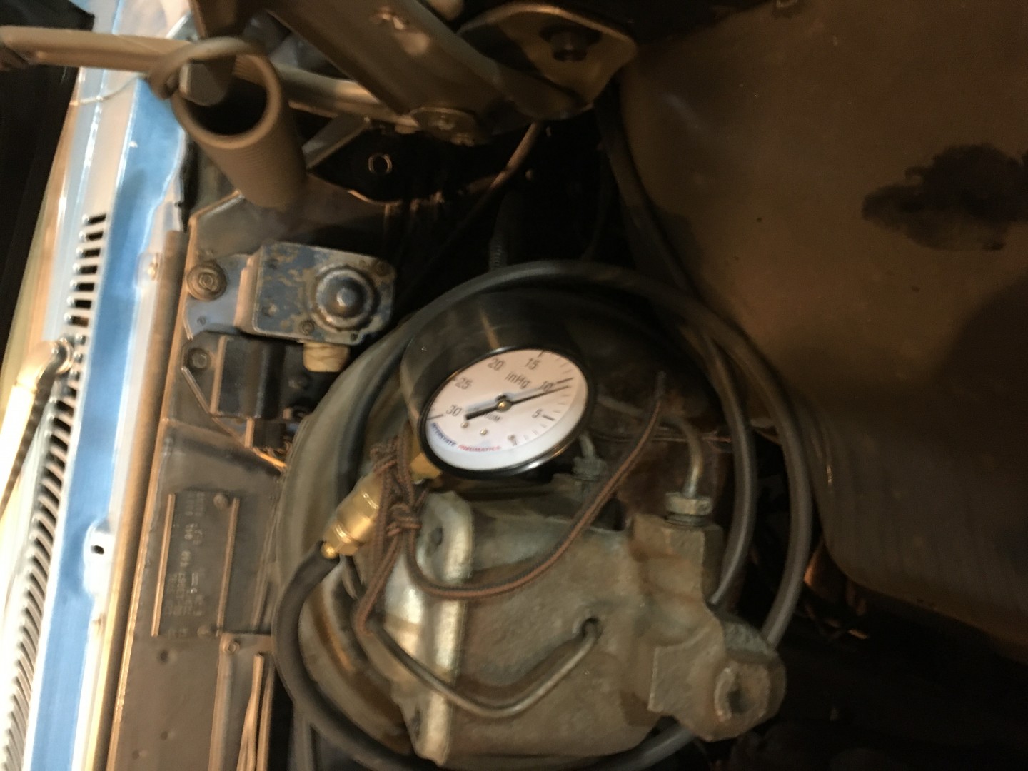

Well I got the fuel tank installed today. Everything seemed OK so I put in 10 gallons and let the car thoroughly warm up ; but just drove around the block on the way to the gas station. Seemed a little hesitant maybe missing a bit.
Back at the garage after it was warmed up I decided to recheck a few things for Bob and Mitch.
Base timing seemed to register 11 degrees at 600 rpm with VC Plugged and vacuum gauge read about 7"
When I hooked up the VC timing went to 33 degree and 950 rpm with timing light and 12" of vacuum. Inside tack reading 1000 rpm
When I had Rachael step on the brake and shift into Reverse Timing dropped to about 15 degrees and about 4" of vacuum. Car did not kill but just about did, likes idle set at about 1100 rpm by inside tack. Did not check what happens if I shifted into Drive.
Lights checked, brakes checked, along with oil, water, trans fluid. Forgot PS Fluid. Plan to drive it about 10 miles tomorrow and check the compression Per Bob's Instruction.
Photo is how I have vacuum gauge hooked up..
-- Edited by jim larson on Monday 18th of May 2020 02:27:48 PM
-- Edited by jim larson on Monday 18th of May 2020 02:35:35 PM
-- Edited by jim larson on Monday 18th of May 2020 03:22:20 PM
Your vacuum is seriously low, it should be AT LEAST 18 inches at idle.
Where are you pulling the vacuum reading from ? That can have a big influence on the reading.
If you are pulling vacuum from the intake manifold, it has to have a vacuum leak, or the engine is completely wore out, OR someone put a new cam in and missed the timing mark.

Your vacuum is seriously low, it should be AT LEAST 18 inches at idle. Where are you pulling the vacuum reading from ? That can have a big influence on the reading. If you are pulling vacuum from the intake manifold, it has to have a vacuum leak, or the engine is completely wore out, OR someone put a new cam in and missed the timing mark.
Vacuum is coming from intake, the line that feeds the PB booster. When car is a cruise speed, say steady at 50 mph vacuum sits steady at 17. My guess is that there is a different cam at least, since engine was a make up of different components. A 350 truck block, 305 heads, roller rockers, performer intake and edelbrock carb dated 1997. A previous owner said it had the original 327 and PG in it when he sold it. When the guy from MN bought it in Jan of 2000 it had the current engine.

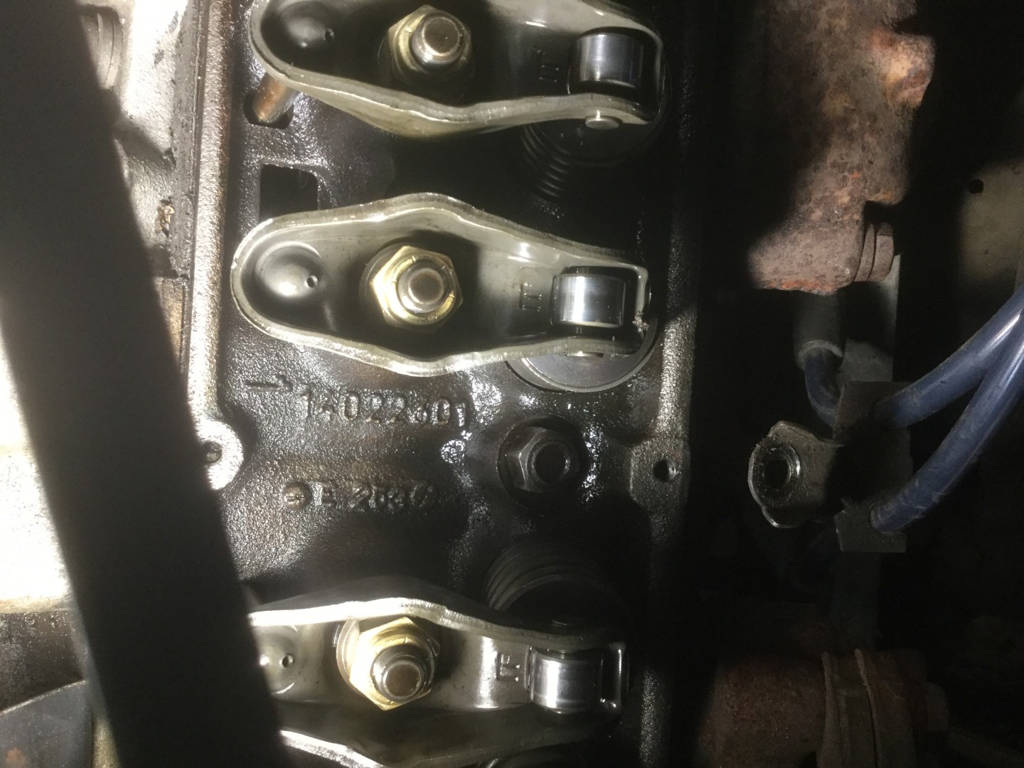

These are 305 cyl heads, not 302. cannot tell any thing from the pics.
If the covers are still off , look at the #7 & 8 valve springs and valve seals.
I had a dead miss at idle only on an engine, found a week intake valve spring, I could open the valve just by pushing on it with my thumb.
Sorry about the mistake, I think originally I had 305 (from 83) , somehow 302 must have creapt into my head. (1.72 OR 1.84 INTAKE &1.5 exhaust). Block is 350 from 76 or 79, 3970010, 2 or 4 bolt. This block was also used on a 69 Z28, thats where I must have got confused. I just put the covers back on and took it for a 20 mile drive. Mostly between 2000 to 4500, seemed to run fine when with these numbers. Not so well when dropping below 1500. I did look at the spring; but just a quick glance. I was thinking of pulling plugs 7 & 8 tomorrow to see if they looked any different.

I thought you had said 305 before, when I saw the 140 casting No. 302? no way.
I think the 010 block is one of the better 350 blocks, I have 3 of them, all mid 70 4 bolt main, 2 Corvette, 1 truck, I would think your block being it's from a truck it is a 4 bolt.
The 305 heads get you 58 cc, more compression than the 302 65cc heads but smaller valves. The 305 heads have a thin deck, so not as tolerant to overheats.
Or a performance cam
