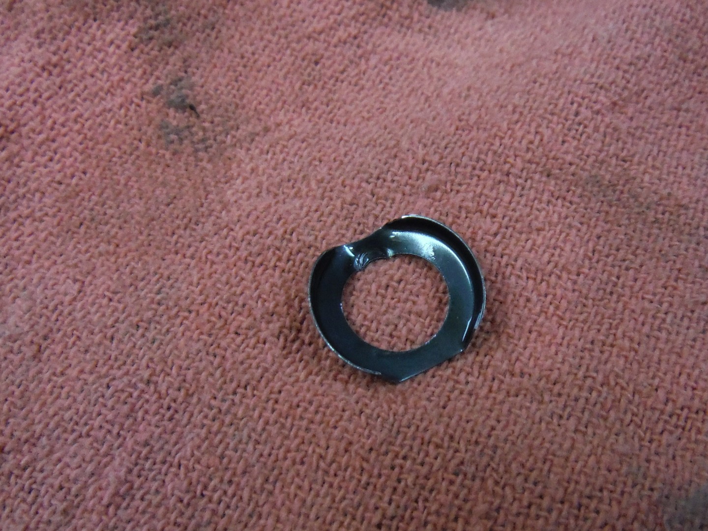

I check the valve train geometry back when I first installed the roller rockers by checking the pattern on the valve stem tip. Since then I found a much more accurate way to get good geometry, "at 1/2 valve lift the rocker should be 90* to the valve stem". I found the intakes could use an additional .250 and exhaust .200".
There is also the lifter plunger setting that could be up to .080 with one full turn of the adjuster, well I find that these lifters are short travel lifters and should be set to .010-.015" at the lifter, however this engine has always had a lot of lifter noise and is quieter with the lifters set tighter.
So I decided to rest all the lifters to .010" and check each lifter as I go. Found #5 & 7 exhaust were stuck down and found the #8 intake lifter is coming apart, the upper snap ring is out of place and the internal spring just keep pushing the push rod up as I loosen the adjuster. So need to get the manifold off and remove and insect the parts.

After getting the manifold off I pulled the lifters one at a time. I found that the retainer, the part that holds the lifter together, was damaged by the push rod. These lifters have a small center to locate the push rod, so the push rod could set just inside the outer body of the lifter. So when I removed and installed the checking push rod, or when reinstalling the original push rod I damaged the retainer. YES I created this problem . I have just not ever seen a lifter that would not center the push rod each time you drop it in . On one lifter the retainer came out so the internals were being held in by the push rod , with the other two the retainer was deformed just enough to holding the plungers down. The good news is I was able to straighten the retainers clean and reassemble the lifters. I inspected all the other lifters for damage, I also inspected the face of each, all looked good.

You're lucky the internal piston didn't come out of the lifter body at rpm. I had that happen on my LS5 and the piston fell into the center galley and when a lobe came around, it snapped the cam in 3 pieces. That led, of course, to a godawful replacement cam with 304 duration at .520 lift. Not very streetable anymore, but it sure was fun hammering the pedal at 3,000 and having the L60's go up in smoke at 30 mph..

Did you look into replacing those retainers with snap rings? Those don’t seem very sturdy.
Apr 18, 2020
No I did not.
These retainers put the P/R cup deeper into the lifter than a snap ring would maybe .050-.100". It took a lot of force to snap the retainers in place, and the seemed to fit good.
I am running slightly higher then spec on spring pressure and going from 7/16 to a lighter 3/8 .080 push rods so the valve train should be stable at speed.
I am not to optimist that I will quiet down the lifter noise with the .010' setting so I will likely need a much deeper setting. That puts the push rod cups farther down and away from the retainers. Once adjusted, the push rod cup and retainer should not come in contact. Could the higher valve spring pressure be contributing to the valve train noise?
I have the lifter part no.( XJ-817-R) but cannot find an info on them except that they appear to be in the short travel category based on my measurements. Are they "Anti Pumpups"?
I forgot about the hip replacement. Good you are being sensible about giving it time to heal.
No I did not.
