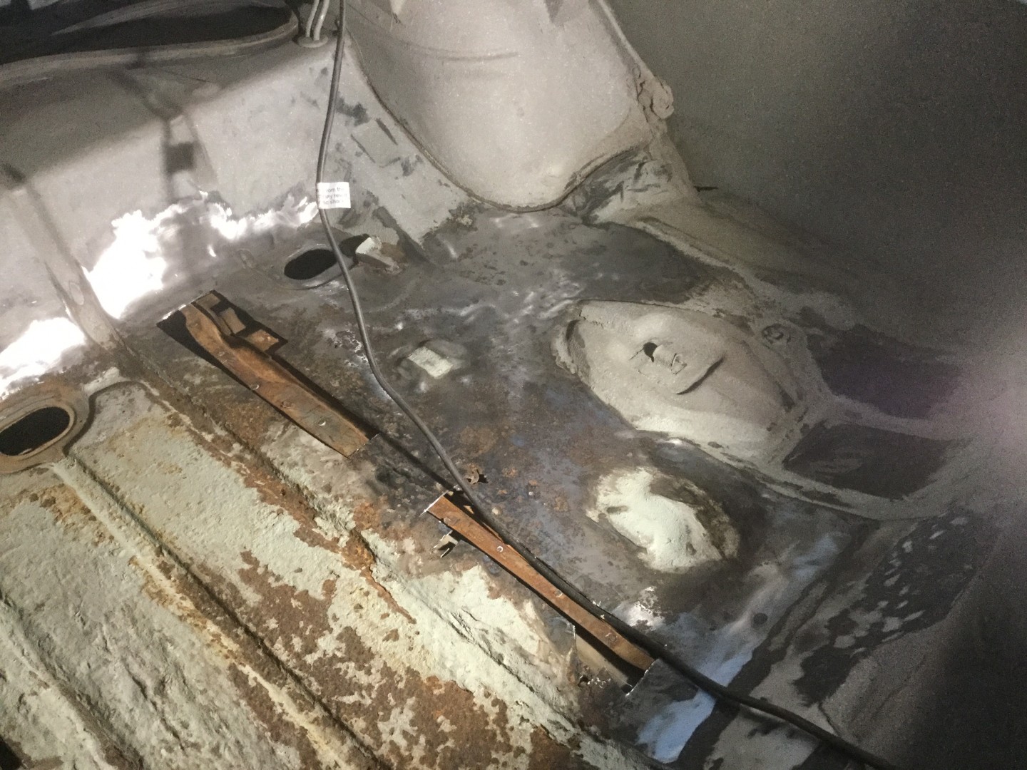

Pretty much done with the exploration step. Now time to evaluate and make a plan. I would like to keep the car on the road as much as possible. Done think I should put more than 10 gallons of fuel in the tank as close to 1/2 of spotwelds for the floor/braces are gone.
it looks like I can retain all the trunk floor braces. Thinking of running the rear part of the floor pan up above were the trunk floor is spot-welded to the lower part of the tail panel area. That way I can re-spot-weld the trunk section and flange the joint between the new part and the remaining part of the trunkfloor, probably about an inch below the 3 rear braces. The underside of the flange joint will be hidden and I will grind down the weld on the inside of the trunk.
i will be replacing most of the floor sections in the center and the driver-side. But undecided if I want to retain the big drain holes. Up in the air on how much of the right floor section to replace. I think I will try to butt-weld the seam across the front of the trunk. And grind down the welds below an inside the trunk.
the plan is to replace the center section first, then move on to the left and right sections first. That way I can keep driving the car. Anyone with thoughts , let me know.

Yes, I should have done that before cutting with the dremel. It will be done before any more cutting and or welding. Hope to do the pan in three step, so maybe will have to go through the process of tank removal around five time.
I think I will follow something similar to this guys repair. Trying to retain the left and right drain holes, maybe the center one. Hope to expose the 4 rear cage/nuts and remove the 4 bolts.

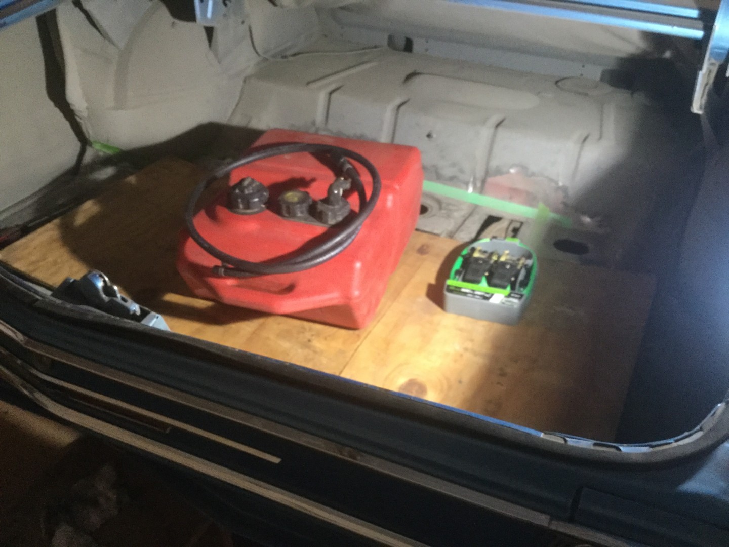

My plan if reasonable isn’t to hook up an outboard boat fuel tank to the fuel line. That way I can just disconnect the hose at the tank and lift it out of the trunk. I have used a little platform on a floor jack to remove and install the tank in the past on my SS. I wish I were as fast as you in getting things done.

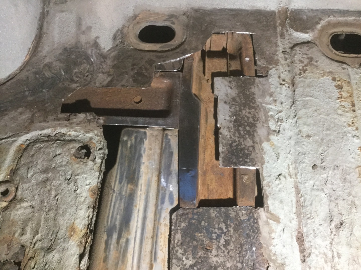

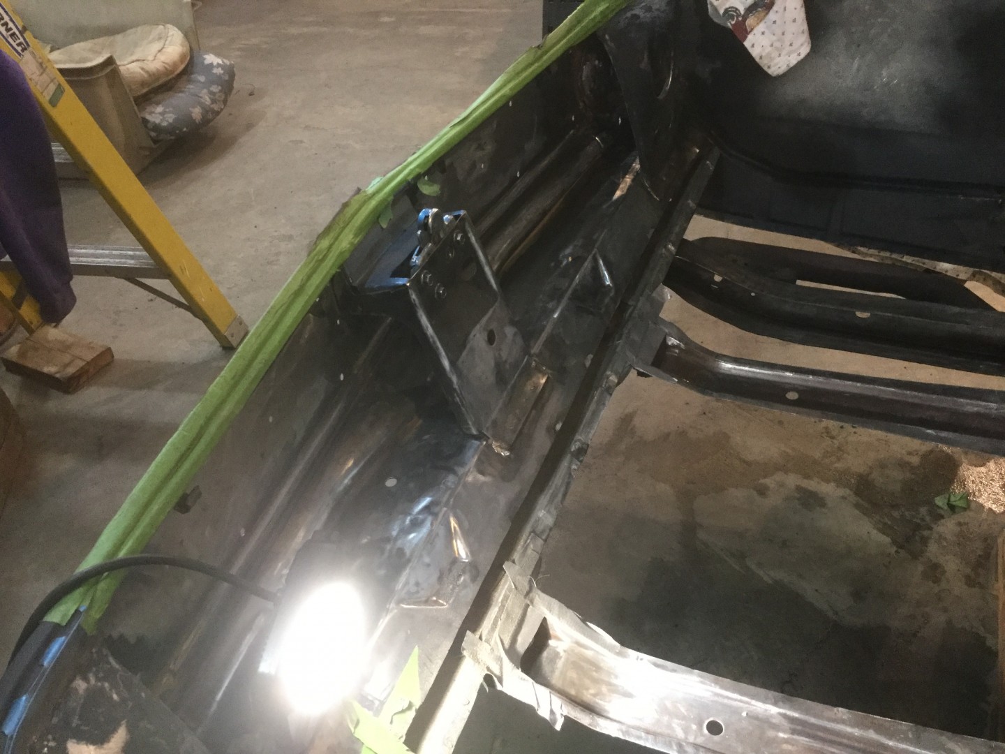

Investigated that bracket a little more today. It seems the flange that slips down behind the wheel-house is about 1" long where the new one is only about 1/2" long. Just did a little estimate of the difference between welding in the panel replacing my 1st option and only saves me about 10" of a butt or flange weld. But I would have to drill out the spot-welds. I will have to grind and most likely bondo and or seam seal the weld either way.
Right now I got into exploring removing all that old crap someone spray on the quarters, wheel-houses, the upper trunk, and tail panel. I think I should do that first since it will be a lot easier standing thenow open hole. What else can someone do during these times. Its coming pretty good except in the bottom of the trunk and the inner wheelhouses where someone sprayed some gunky stuff over the original finish and then spayed a gray coating over that. Upper trunk pan is coming off relatively ease if one can ever say that painful job is easy. I wish I could hire some kid that is laying around and playing video games.

Jim
I usually don't like to chime in on body repair issues like this as this is not my expertise and, I think with the skills between Karl and Mitch and probably some others in the club we have some real talent hear.
Now for what its worth, picture #2, unless I'm missing something, rather than trying to but weld the long diagonal at the left foreword corner, you are so close to the wheel house pinch weld, so follow the tap line to the inner wheel house and replace right up and around to the drop. Plug welds at the pinch weld are so much easier to do then but welding. You can hide a lot at with seam sealer at the floor to wheel house joint if you need to. If the pinch weld is fat, then drilling the spot welds and removing that part of the floor and allows you to clean up the rust from that part of the seam.
Mar 23, 2020
Yes Bob I am also considering a butt weld about 7/16” following the wheelhouses and then straight across.

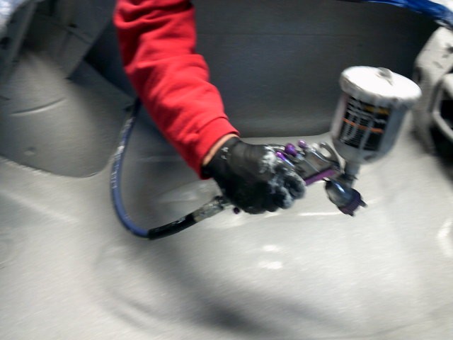

There is light at the end of the tunnel, I sprayed my trunk repair that I started over two years ago today with Zolatone 20. Yep, that's me with the two week overdue haircut
Hey Kevin thanks, your success give me encouragement. Your trunk looks good, what Zolatone color did use?. Hopfully 2-3 more days of final sanding and cleaning. I am taking the frame down to bare steel. Then I want to paint that with 2k epoxy. Then the same for trunk side of wthe tail panel, the inside of the quarters, and the outer wheelhouses in the trunk, then a finish coat on the frame.

Jim, The Zolatone I used was Silver Gray. Not sure if that's your color but there are several other colors available.

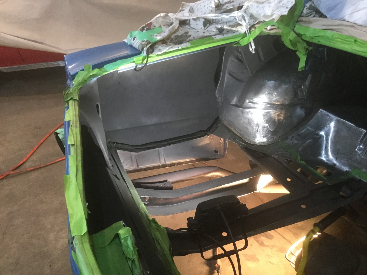

A little more progress. Frame has finish coats of Rust-Oleum on. 2k epoxy primer on certain areas. I think it need a bit more primer for good coverage or maybe just go over it with a black black Rust-Oleum finish coat. Then I can put the extension light housing back on along with the bumper. So car will be drivable with Mercury Outboard gas tank. Then back to fitting sections an welding.

If you are going to spray the quarter and tail panels with Zolatone, they are probably good. If not and they will remain black, the paint looks thin in the pics.

I not sure I understand the outboard motor fuel tank, unless you want to us the car for fishing. Your very close to being done once the pan is in.

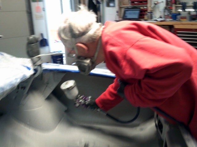

I’ve pasted a link below for Zoltone application Ztone recommends specific colors for the base coat depending on top coat.
I used 1/2 gal of Ztone (three coats) for a heavy application to the trunk pan, inner quarters and inner wheel wells and rear bulkhead where the taillights are mounted; I think the trunk in the 65 Buick is longer than the Chevelle.

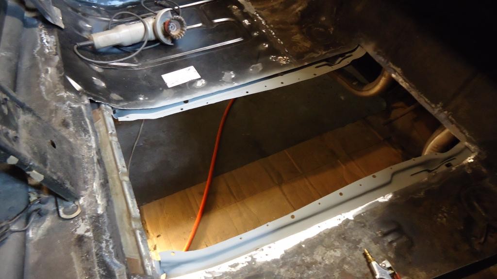

Specter section welded in. Went pretty well except front seam that I cut a little short. More grinding to do tomorrow and then I can start on the other sections.

Use a drill and drill thru the spot welds for the mount bracket. You can then remove the old floor flange and slip the new one between. This will help you "fit" the new pan radius to the wheel house anyway. It may take some re-shaping and pie cutting to get the radius to match. Plug weld the holes shut after the pan is welded in up top. The brace holes will require welding under the car, but only for ~ 3 plugs. You'll be a pro welder by the time you need to do those...
When that is all done then back to fitting and welding in the trunk floor panels. Finally finish the 2k epoxy primer and completer the trunk with zolatone.
Might as well do it all now, being house bound. You can't go running off somewhere fishing for weeks now...
How do the quarter panels and tail panels look Mitch? Wish I ha d known about the spray at any angle spay cap earlier.

yes the plan is for zolatone; however I just ordered some more paint and plan to spray the quarters and the tail panel again, yes kind of thin.
Jim, your so lucky your drop down panels where in good shape, I had to hand make mine. Zolatone covers very well, from what I can see it looks like your ready to spray what you have prepared. Is there a reason you’re not welding the pan in place now? The frame looks good. Did you spray it with a gun? Frame may need touch up after welding so make sure you sequence correctly..

Depending upon how my welding skills progress I may just tack weld and screw down. The get the body guy in town to finish welding when he has freed up time. So I have a outboard motor gas tank with the hose hooked up to the gas line. Just a quick disconnect like is the fishing boat. I just throw in a piece of plywood and strap thins down.
if things go as planned no welding from under the car.
Just applied epoxy primer this morning. Still some filler to apply, then another coat of the 2k epoxy primer. Probably will wait until fall for the spatter paint or Zolatone. I have to buy a spray gun. Now if. The body shop gets to the hood I should be good for the summer.

Jim, I have a spray gun you/we can use for the Zolatone, don't go buy one just for that.
What size tip do they recommend ? I have 3 to chose from.
I have a little work underneath. All original undercoating remains. Except where the driver side section was replaced. I plan to apply some in that area so it matches the right side and the wheel wells. Then the fuel tank goes in. It has been completely stripped, primed with 2k epoxy, and sprayed with a tank tone. Tank straps are also done, so hope to be done with all that by Monday or Tuesday. Then drive with the spare hood until the one at the body shop gets mine painted.
