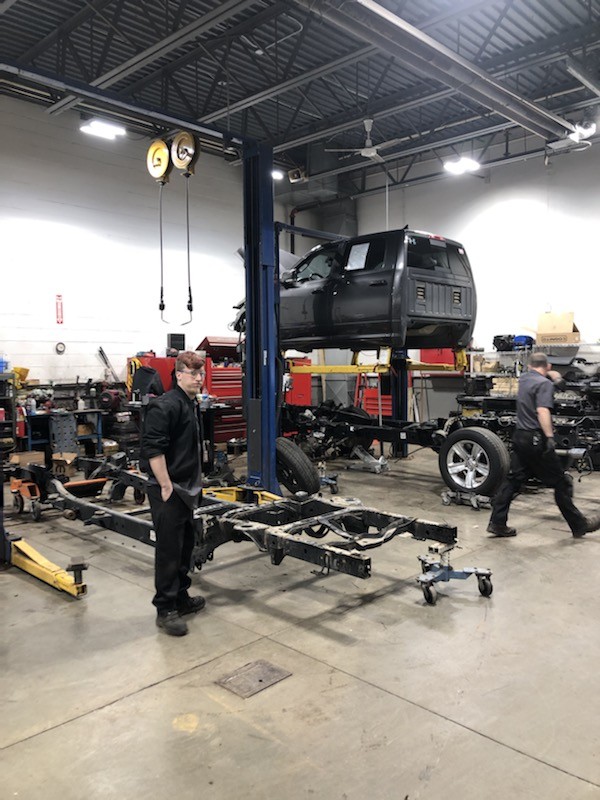

Mitch had a thread showing his artistry on a Jeep.
On a retail Insurance repair we usually end up replacing the entire frame, or if there is a factory supplied repair section we have done that.
This is the typical approach, note specialized, custom fabricated engine lift frame.
P.S. the angle iron used was re-purposed from an A-frame cart we made for the blue Elky when it was being sandblasted and moved around shop, 20+ years ago.
Mitch is a great fabricator, and can pretty much do anything he puts his mind to.
Centerline is fortunate he is available, there are not many left that have the skills and are willing to perform that operation.

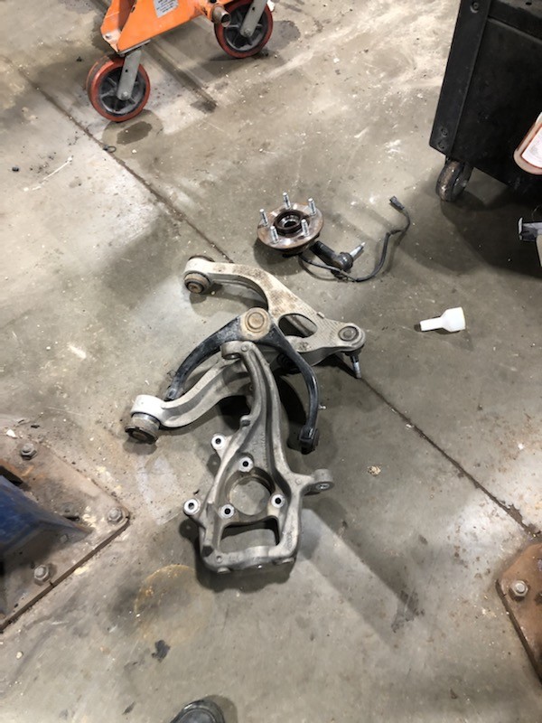

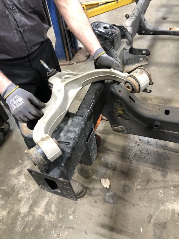

Hammered so hard on suspension (note bushings pushed out of control arm) suspension mounts were damaged.
Todays standards do not allow repair.
Technician would rather do Fords and Chev frames, Dodge is not rational in some of their assembly decisions.
