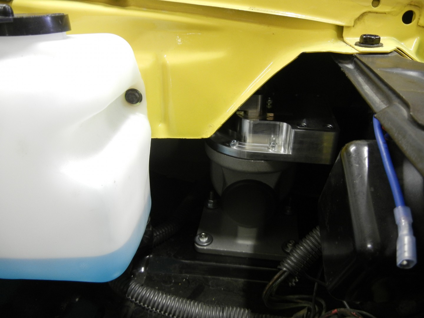

I would still recommend the vacuum pump over manual. The pump I installed might weigh 5 lbs. I fabricated a mounting bracket and hid it behind the left headlights. The hose runs behind the inner fender well and comes out at the firewall. It is barely noticeable.
The really great thing about it is, you can turn the key to on and let the pump run for a few seconds and have 22" of vacuum before the engine is even started. It, also, provides vacuum if the engine stalls, as it is independent of the engine. The only way it would stop running, in an emergency situation, is if it lost the 12v power supply.
You could install a smaller booster too...9", maybe even a single diaphragm 7" and still have plenty of vacuum to assist the pedal pressure.
