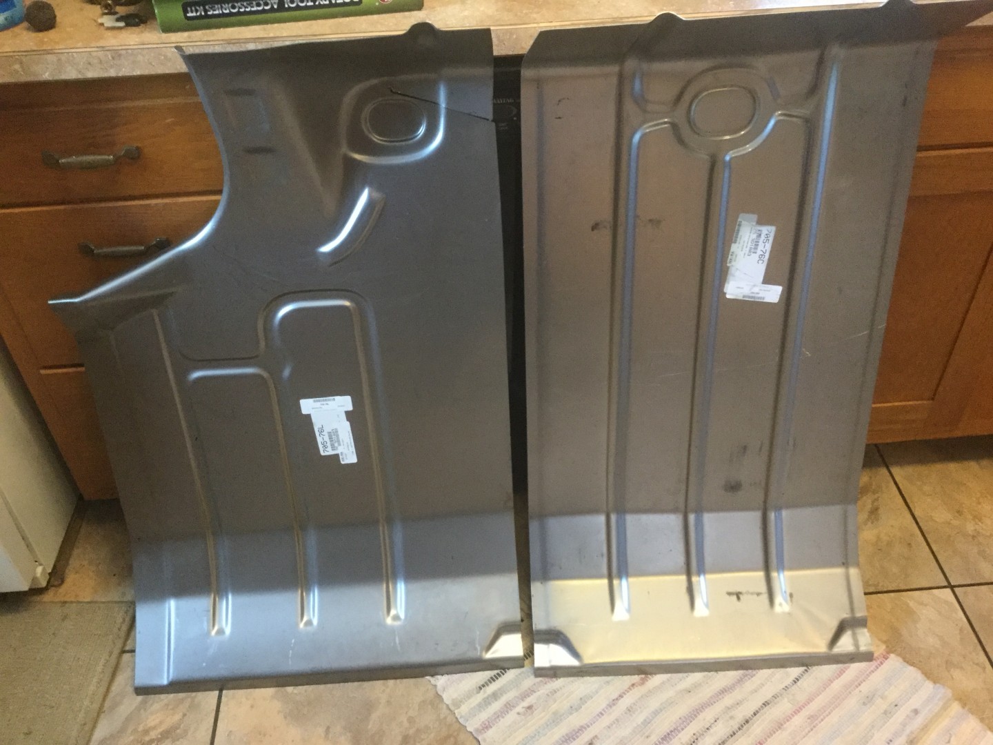

Well I got the Sherman trunk panels. Not sure what all will have to be used, made in us, guage 19. Appear to be match except for a little 3/4 circular hole with a rubber grommet on R & L side panels and a 5” raised area that gives the panel add Ed strength. Maybe GM had mor e than one supplier and some had the raised area and some didn’t. Looks like L & R panels made to over lap center panel, when this is done an exact match to width. Out of all the companies I looked a t these are exactly like the CarsInc products except Cars is cheaper by about $15 a panel and they said there’s was 22 gauge.
Now to acquire a mig welder and learn how to weld the panels. Would it be advisable to paint the whole panels and then grind off the paint before the welding?

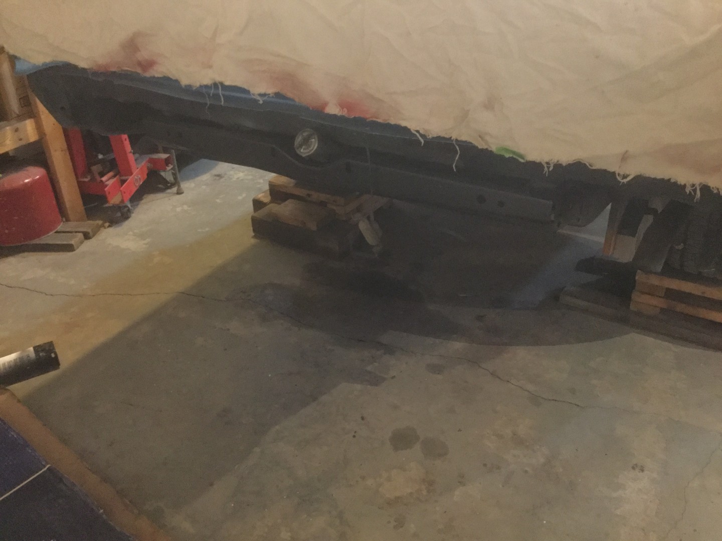

Iremoved the rear bumper as the frame Crossmember was bent in at some time and not bent back into it proper position, so rear bumper fit poorly. What would be the best way to pull it back into position?

3, 1/2" eye bolts in the holes will provide a place to pull with a come-along. Attach the come-along to a sturdy post and pull on each position and move them a little at a time until the bracket is where you want it. If you have a 3-4 ft straight edge, you should be able to get it quite straight. You can leave it a little short and shim the bumper bracket with a washer too.
Dec 11, 2019
C-clamps, Screw style, block each cornerwith 2x4 , vice grip blocks to heavy angle iron, use c-clamps to pull x-member in to correct location. Whether you use Mitch's method or this one it won't take a lot to move member. Could also use another vehicle for anchor (tow hooks on truck, trailer hitch).
Not brain surgery, patience and leverage.
-- Edited by more ambition than brains on Wednesday 11th of December 2019 05:05:58 AM
Dec 11, 2019
C-clamps, Screw style, block each corner with 2x4 , vice grip blocks to heavy angle iron, use c-clamps to pull x-member in to correct location. Whether you use Mitch's method or this one it won't take a lot to move member. Could also use another vehicle for anchor (tow hooks on truck, trailer hitch).

Thanks for the suggestions guys, maybe we will have a warm wave sometime this winter. I like the bow-tie lunch suggestion; but car is going to the body shop sometime this winter when they have a slow week for a little work on the hood.. I think I have Karls method figured out. Use a strong piece of angle iron about 5' long blocked at the corners by a 2x4 and use 2 or 3 C clamps from the crossmember to the angle iron to pull the crossmember slowly. I was thinking about the come-a-long option; but thought I might kink the crossmember.

The cast clamp may work for this use, but I always buy forged for future use that requires more force. The clamping force may be about the same between the 2, but a forged will bend when over tightened and the cast will snap suddenly. The forged provides a safety factor.

If you don't have the C-clamps, try Mitch's suggestion. A couple of eyebolts, washers and nuts are way cheaper and simpler.
Add 2 cable pullers anchor to truck, tension and pull equally first. If you drag the car, then come and borrow mine.

If you're pulling at the two holes by the tank filler why not use some 1/2" threaded rod with appropriate hardware?
Dec 16, 2019
I also have threaded rod that could work as Bob says, free!
Same angle, blocks, washers and nuts.
Liberal lube on threads.
Holes in angle, thick washer, back side of crossmember, rod through angle, nut on rod, well lubed, tighten side to side.
Will probably need to go a little over center.

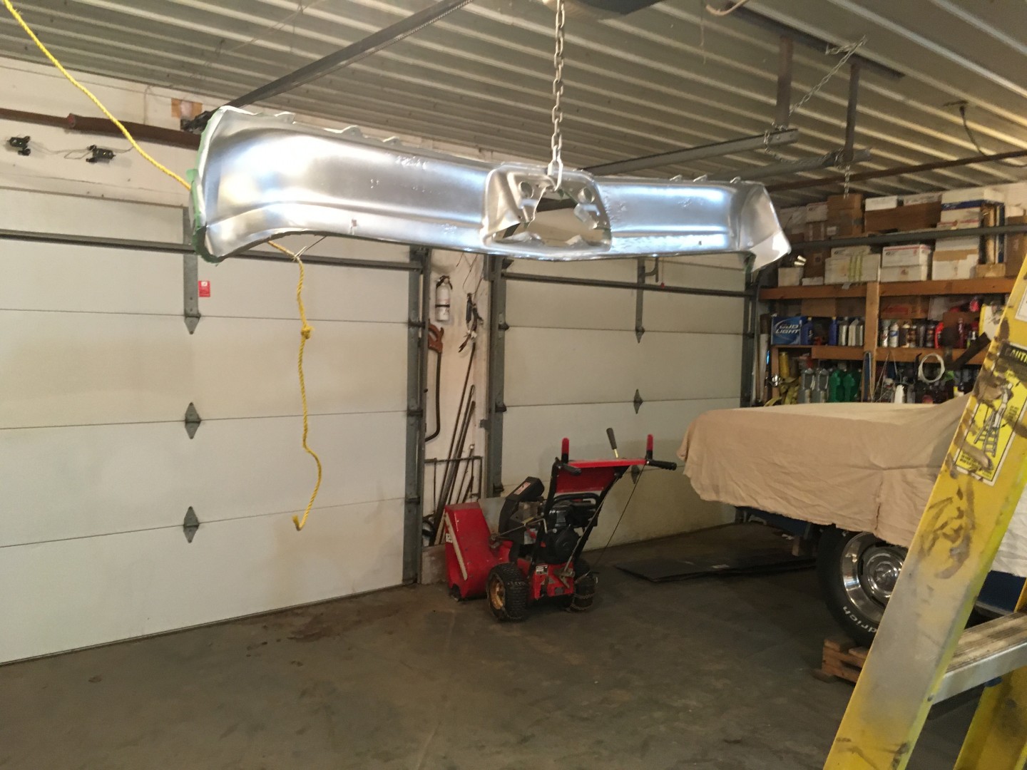

Bumper brackets, basted, primed with 2K epoxy, and finished in satin black. Removed all sign of rust from back side of Rear bumper, skufffed, primed with 2K epoxy, and finished with a chrome enamel. Need to drop gas tank to finish back side of frame, then install bumper and re- install gas tank. Cleaning and refinishing bolts, special washers, and nuts, except new SS capped bumper bolts.

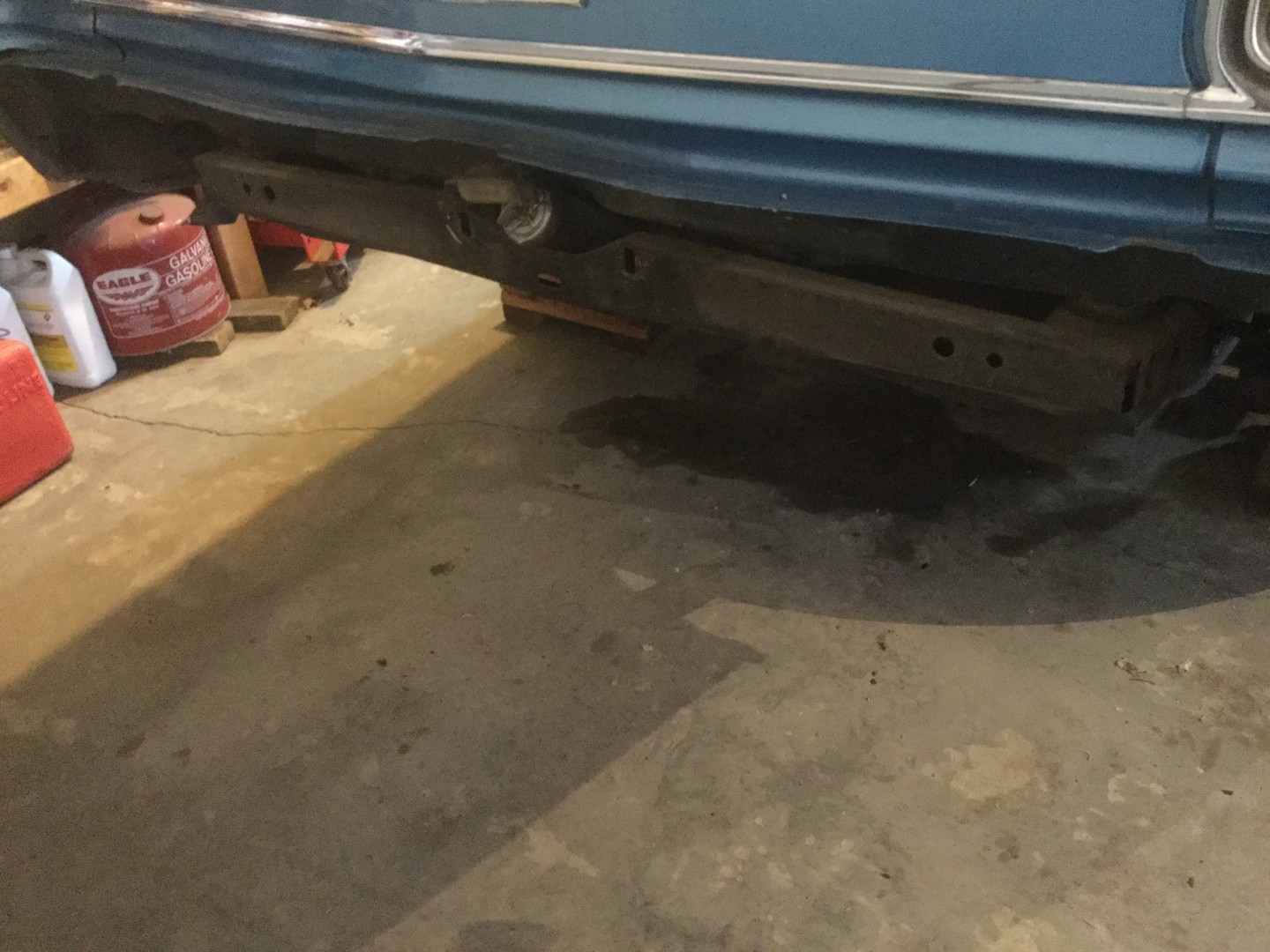

Finished with Crossmember.
There you go!
Good Job
