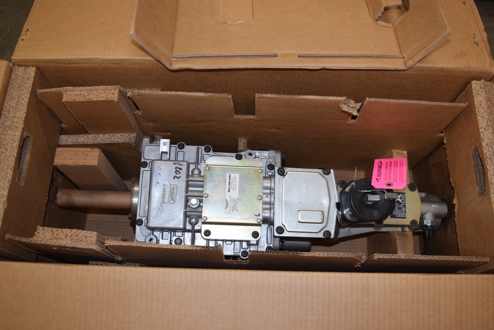

This past summer, I was starting to have some issues with M20 in the Chevelle.One issue that became pretty regular was when you put the car in reverse, reverse was spinning.To get the car into reverse, I would have to shut it off, put it in reverse and then start it back up.Another issue was the tranny would get locked up and the car wouldn’t move.Because of this I did some research and purchased a Silver Sport PerfectFit TKO 600, with a .64 OD (Found out I have 3.90 gears).The tranny will be arriving next week and I will be doing the install over the next couple of weeks.I am hoping that I will just have to dimple the tunnel to get it to fit.An item that is in my favor is, I have changed the body mounts in the Chevelle when I restored it.I plan on keeping people posted on progress.

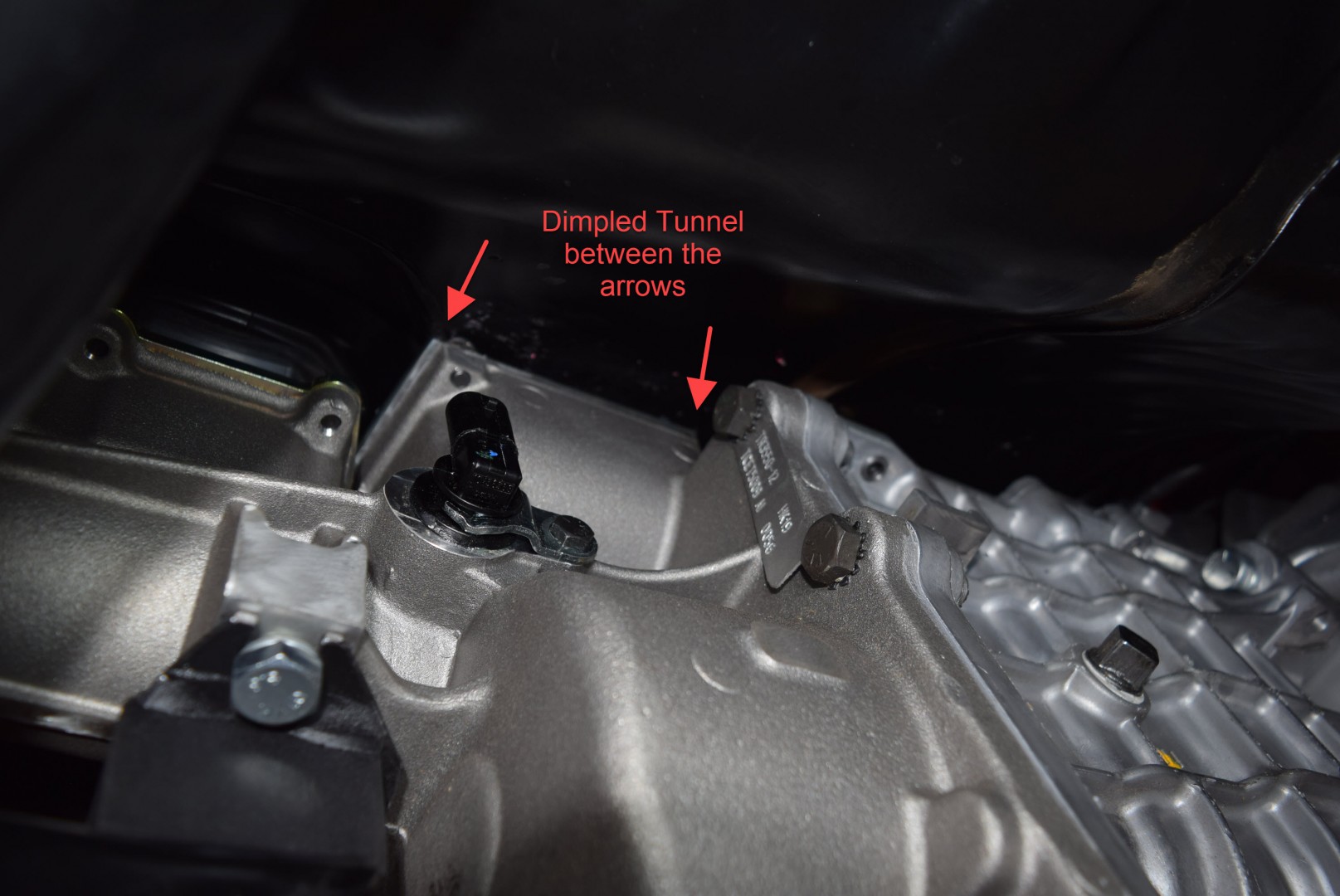

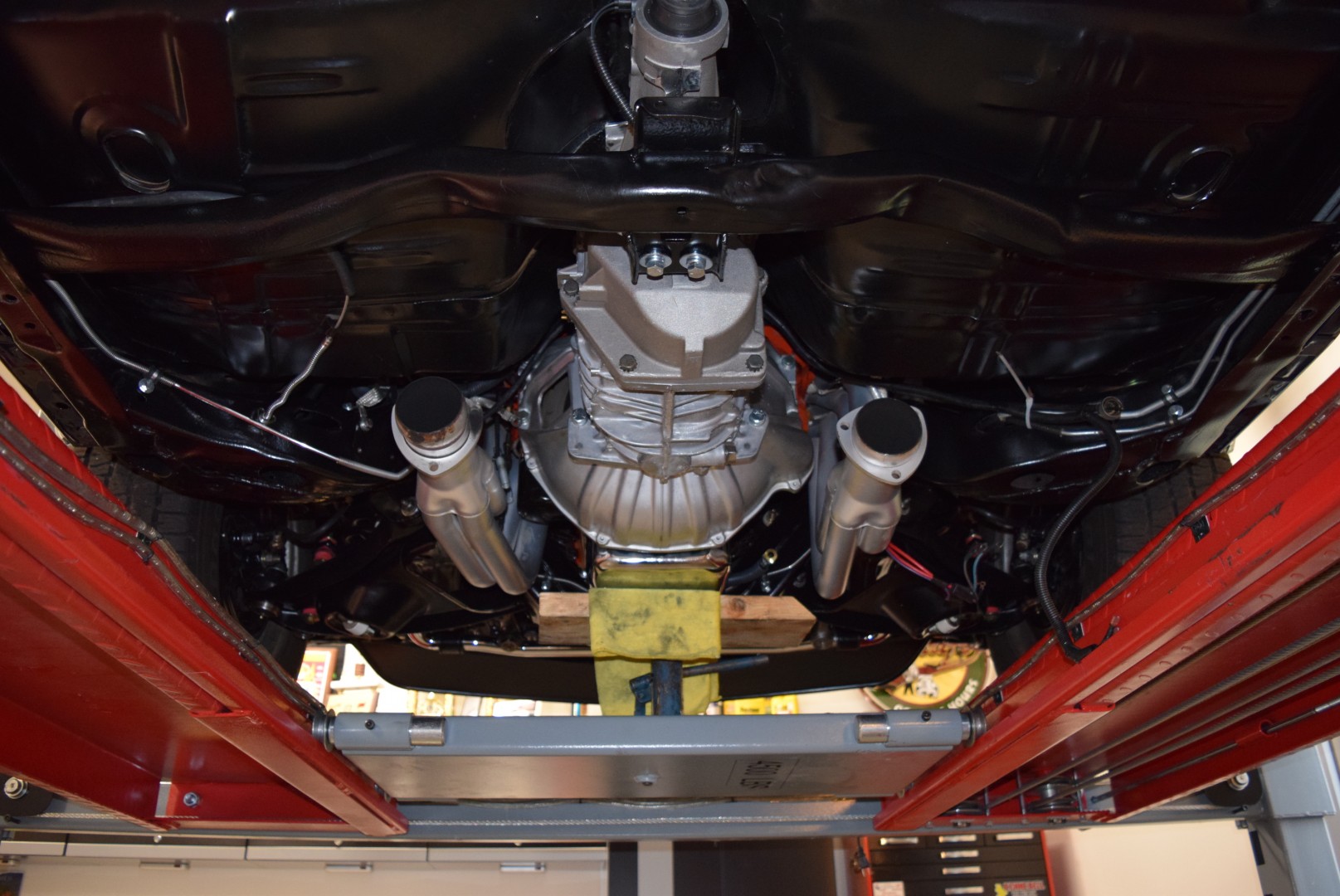

During the week, I tore down the Chevelle. Everything came apart fine, expect for the pilot bushing. That required some Dremel grinding and a 5 lb slide hammer. Today, I fitted the tranny. Tremec wants 1/4" clearance around the tranny. I had that and more, for the majority of it. I only needed to dimple the tunnel where the first shifter mount is on the top of the tranny, just in front of the shifter opening in the tunnel. I did take measurements for the new drive shaft. that will be ordered this week. Next up, aligning the flywheel and bell housing.

With the help of Chris S, Chris P and Stan the flywheel and bell housing have been aligned and the Tremec is in. With the help from FedEx, the new drive shaft was delivered today, so we finished the car and took it for a ride. We had to re-adjust the clutch, by then it ran great. The speedometer is just about right on and the back-up light work. Can wait until next year to get it out on the road.

This past summer, I was starting to have some issues with M20 in the Chevelle. One issue that became pretty regular was when you put the car in reverse, reverse was spinning. To get the car into reverse, I would have to shut it off, put it in reverse and then start it back up. Another issue was the tranny would get locked up and the car wouldn’t move. Because of this I did some research and purchased a Silver Sport PerfectFit TKO 600, with a .64 OD (Found out I have 3.90 gears). The tranny will be arriving next week and I will be doing the install over the next couple of weeks. I am hoping that I will just have to dimple the tunnel to get it to fit. An item that is in my favor is, I have changed the body mounts in the Chevelle when I restored it. I plan on keeping people posted on progress.

Santa, in the form of a FedEx man, dropped off the tranny today
