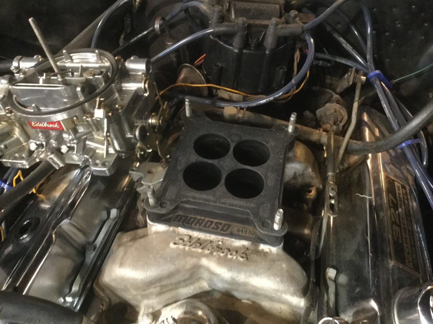

So what kind of spacer do I need, or gasket set? Here is a photo of the intake side of the gasket between the intake and the spacer. To me looks like it might have multiple leaks. What do you think?

I was wondering what was going on, because your pic of the intake indicates it is definitely a spread bore. No confusion on OUR part...

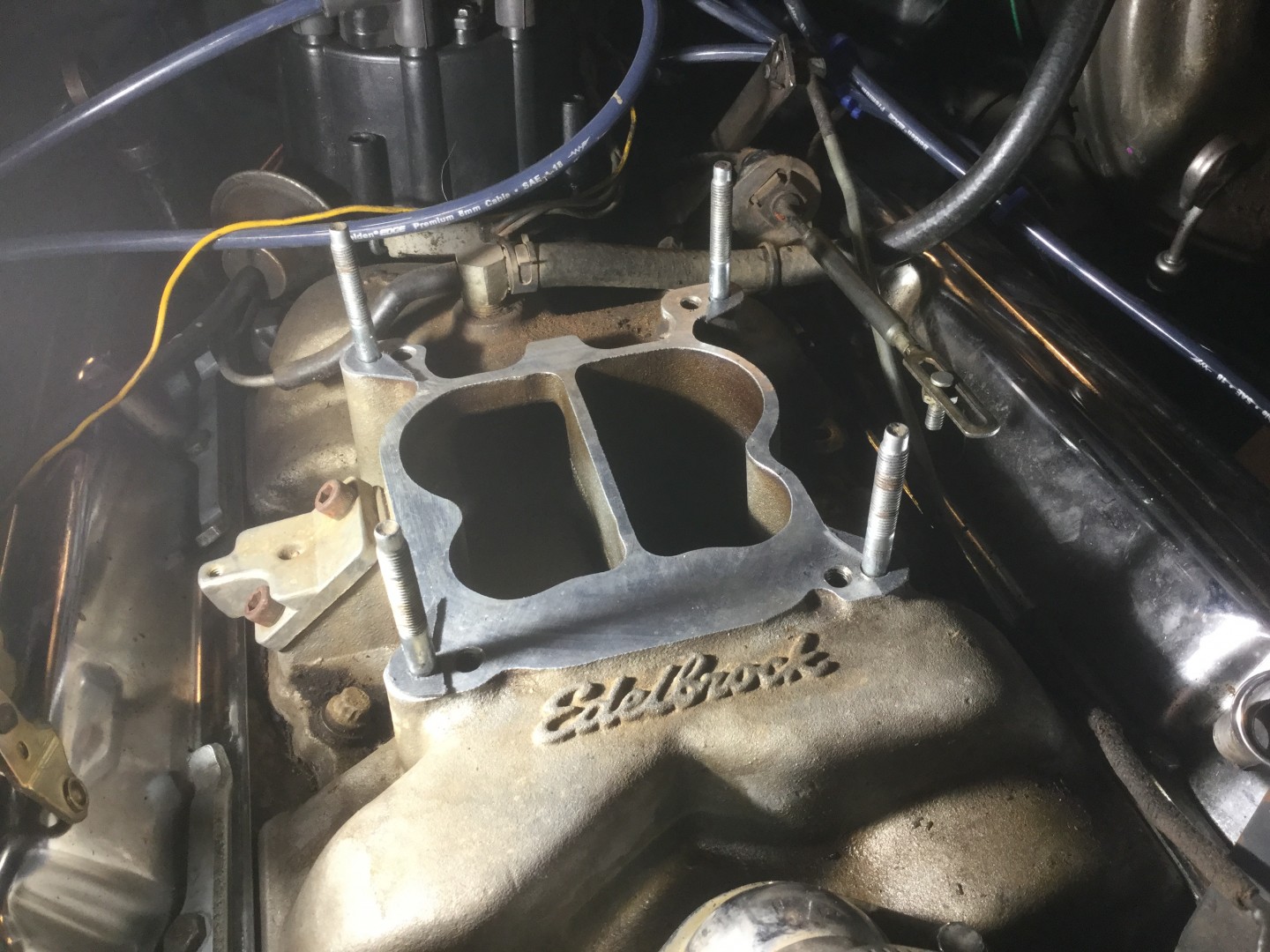

Well the Heat insulator arrive tomorrow. I think it should look like this; but trying to research for the best type. Heat Does anyone know the best one to fit between the carb and the adapter? Thanks. What about this for an Insulator?

This should cover the spread bore manifold and fit the carb, you can the also use the heat spacer. Use the above or below the g1420 which ever looks to flow better. Shouldn't cause any more turbulence than a carb sitting on a opened plenum as long as the openings of the plate and the heat spacer get progressively bigger towards the manifold.
I use that same style heat insulator with no gasket at the carb to insulator and have removed and reinstalled the carb many many times with no leaks.
Look like the two aluminum adapters are directional, one adapts a spread manifold to square bore carb the other adapts square bore manifold to spread bore carb

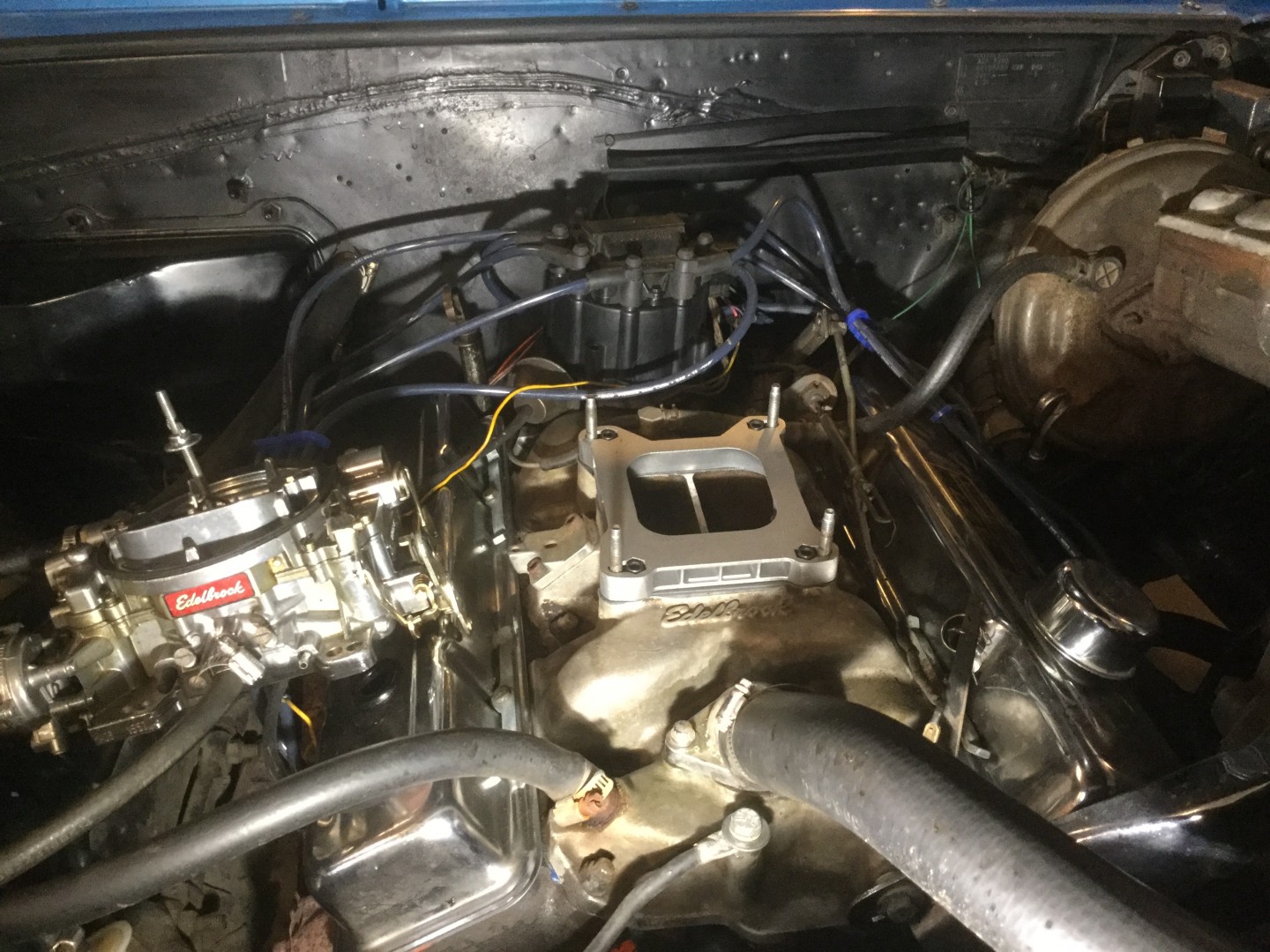

This is what I Did and it sounds like what you are suggesting Mitch. I trimmed the spread bore gasket, then trimmed another gasket to make up for the gap between the intake and adapter. After setting made up gasket on intake I dropped on adapter, used the 4 set screw studs to secure adapter. The put on the heat insulator, then set on the carb. I wasn’t implying I need both adaptors, one just looked like it might work better than the other.
SoI use a gasket between adapter & heat insulator; but may or may not use one between insulator & carb?
i wish the studs were a little longer, I may have to replace them later. But this should be enough for a good test.

The engine on my new car is a 350 with 305 heads, a performer intake, and a Edelbrock carb (1460). It has a 1” Moroso spacer (64930). Can the spacer cause me to have a higher rpm at idle? Are these prone to cause vacuum leaks? If I spray a lot of carb cleaner in the area of the spacer on the pass side the engine wants to kill.
I don't think your going to lose any performance by getting rid of the spacer. 305 heads don't flow that much anyways.
I have seen square-bore & spread-bore combination mixed incorrectly causing a vacuum leak.
Yep, on that issue. The carb is square bore and the intake could well be spread-bore. The spacer number is a square bore riser, NOT an adapter from spread to square, which is what you may need.
What is the number on the intake ? That should tell you what model it is and whether is is a spread bore design.
Intake is. A Edelbrock performer, I think spread bore. carb is Edelbrock 1460, I think square bore. Here are some photos. I can’t find a number on the intake.
-- Edited by jim larson on Thursday 31st of October 2019 03:15:30 PM
-- Edited by jim larson on Thursday 31st of October 2019 09:13:04 PM
Yep, typically the back corners, but you have one in the center too. What you need is an adapter, not a spacer.

Adapter didn't work. Called edelbrock and they said this is what I need 9266.
-- Edited by jim larson on Monday 4th of November 2019 01:18:04 PM
Didn't work as in didn't fix the problem or was it the wrong part?
Wrong product. My manifold was a not a speed bore ( think its just called a dual plane square bore), carb is square bore 1406 Edelbrock. Main issue Edelbrock said was that the morso spacer bottom side design cause the vacuum leak problem.
Boy am I having a bad day!! It is the right product, I had a gasket on the intake and I didn't think the adapter was correct; but it is. Sorry for all the confusion.
Git er together and take a ride, before the snow gets too deep.
OK confused again. The adapter I got is for a 4- bbl manifold to a Quadrajet Carb which I do not have. Or for a Quadrajet manifold to a 4 bbl carb, which I think is correct for my situation which is a Edlebrock Preformer Intake (Quadrajet type) to a 4 bbl carb (Edelbrock 1406. The instructions I found online don't show that application; but I think I have figured it out.
Should I use the gasket with the big square hole on the bottom between the adapter and the intake. But should I modify the gasket so it fits the inside configuration of the intake and adapter? The gasket supplied with the kit doesn't fit the intake.
Then I will need a similar gasket to go between the Heat Sink and the adapter and between the Heat Sink and the Carb or does the heat sink act as the gasket between the adapter and the carb? I think it acts as a gasket? But the Moroso spacer I had need gaskets and I have never done this before.
-- Edited by jim larson on Monday 4th of November 2019 04:06:37 PM
-- Edited by jim larson on Monday 4th of November 2019 04:09:22 PM
I got the 1932. The gasket for the Quadraet carb the Quadrajet intake sides does not fit the spacing of the studs in the Edelbrock intake. It looks like the other one would work.
-- Edited by jim larson on Monday 4th of November 2019 06:25:39 PM
I don’t understand either, I thought it was suppose to speed up. But it definitely wanted to kill. Other then on idle carb seemed to work fine. Especially cruising at 30 mph or more or on WOT.
Ether you sprayed enough at the leak to cause a very rich mixture or some of the fumes were sucked in the intake of the carb, or maybe both. Check it with a closed air cleaner that has a snorkel off to the side and a way from the carb cleaner fumes.
Your carb base is drilled for both bolt patterns. You may need to use the Q-jet pattern to get this work.
I thought about that Mitch. To use the spread bore gasket I would have to mount adaptor to intake with 4 inside Allen wrench studs provided in the kit. then put on adaptor on the outside 4 studs then the heat insulator, then the carb mounted on the 4 outside studs With nuts.
i didn’t like the appearance or fit that way as I would have to save the ends of the spread bore gasket (unless I don’t use the heat insulator and remove the 4 outside studs). It looks like the summit kit might have a little different spread bore gasket that would work.
what would be wrong with saving the big square gasket on the inside to match the spread bore opening on the intake or just leaving it as it is?
Try this
https://www.summitracing.com/parts/sum-g1420/applications
Will the adapter you have slide on the 4 existing studs ? yes, ? the issue is the base gasket doesn't fit over or between the existing studs ? Carefully trim off enough of the base gasket with a scissors to clear the studs, but retain the bolt holes, use a very thin smear of Black Ultra sealant and attach the adapter with the 4 Allen screws.
From there, proceed with the square, open gasket, the insulator and carb, with or without another gasket, as Bob does.

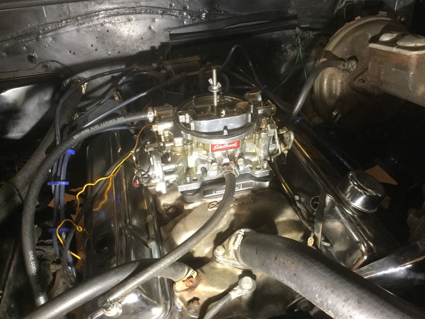

Well I started the engine up today, well I guess the show blower engine as we had about 4". Hope it melts over the next few days with no salt being spread on the roads.
Thanks for the snow and snow blower update.
Did the idle drop or not after reassembly? Inquiring minds want to know.
I may not have explained myself correctly. I could get the car to idle down to 700 rpm without any issues just sitting in Park in the driveway. The issue was when shifting into Reverse or Drive the car would Die or want to Die especially when trying to move backward or forward.
So until I can actually drive the car I will not know if the problem is solve. Looks like there might be a 40-50 degree day next week. But Wed, Thu, and Fri I am sure I will not feel like driving the car after hernia surgery next Wed.
Sounds like you've made progress Jim on the idle in neutral.
Maybe the next step is to adjust the idle mixture screws?
I had a similar issue that it idled fine in park, but not in gear and we adjusted the idle mixture screws and the idle quality in gear improved a lot.
You should be able to see if you've made improvements just by going from Park to Reverse or Drive in the garage and not need to drive the car if the roads are sloppy.
I already went though the idle mixture screw check and set up. I worked as shown on the Edelbrock video. I feel that that part is OK.
Well the issue is not solved. I started and ran the car some as the streets were clear and no salt dumped after recent snow. Car runs the same as before, fine at 700 rpm while in park or neutral. When you **** into reverse or drive with foot on brake the car will kill or if your coming up to a stop sign and you brake to stop the car, it will kill when idle drops below 1000 rpm. With idle set to 1050 rpm car acts fine when shifting into reverse or drive and foot on brake. Or when braking at a stop sign car does not kill. I will have to check for a leak at the Power brakes and all around the intake again. I believe the carb was installed in 1997, would it likely need a rebuild?
Did you check base timing with vacuum advance disconnected? Try bumping it up a couple degrees and see if it helps.
When I got the car Base timing was at 4 degrees with VC plugged. I have since bumped it up to 14 degrees with VC Plugged. VC add about 20-22 degrees approximately according to my timing light. Car seems to run fine at WOT. Even when gaining up an incline I don't hear any pinging. But that was before I messed with the whole gasket/adapter thing. Maybe I should go a little richer on the air mixture screws? But I followed the edelbrock guide line. Adjust right to highest rpm, reset throttle according to rpm, adjust left to highest rpm, then reset throttle, then repeat, and repeat.
With the engine at idle (1050 or so) check timing and note, than back out the curb idle screw and watch the timing, if you see the timing retard disconnect the vacuum advance and rerun the test. The timing should not move at or below and not start to move until about 200 or so above the curb Idle.
Also check while checking for vacuum leaks check the secondaries to be sure they are closing properly.

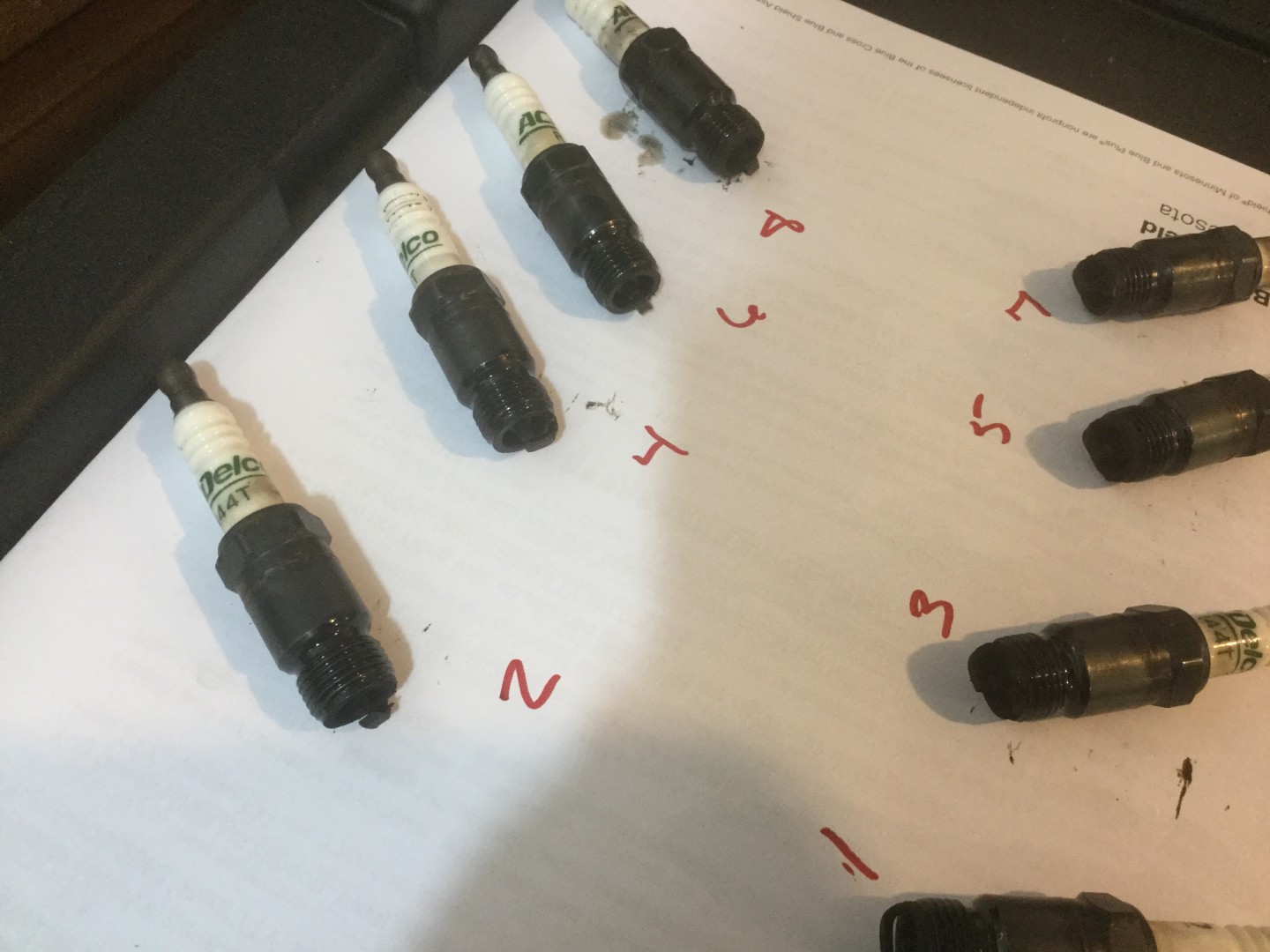

Checked compression today. All plugs were kind wet. Number 7 was quite low 125. Maybe I can put some gas through it before the hernia surgery puts me on the couch for a few days. Does the compression reading tell me. The booster is an original 67- Delco.
I forgot to warm the engine up, so would it be higher on all cylinders?
-- Edited by jim larson on Saturday 9th of November 2019 05:45:41 PM
Jim
Was the engine fully warmed up the last time the engine was run before the plugs were pulled, if not that would explain the wet plugs.
The low cylinder is not what we would like, but with the choke on and a cold engine, that doesn't help the compression numbers ether.
And I do not think the low cylinder is causing the idle problems.
