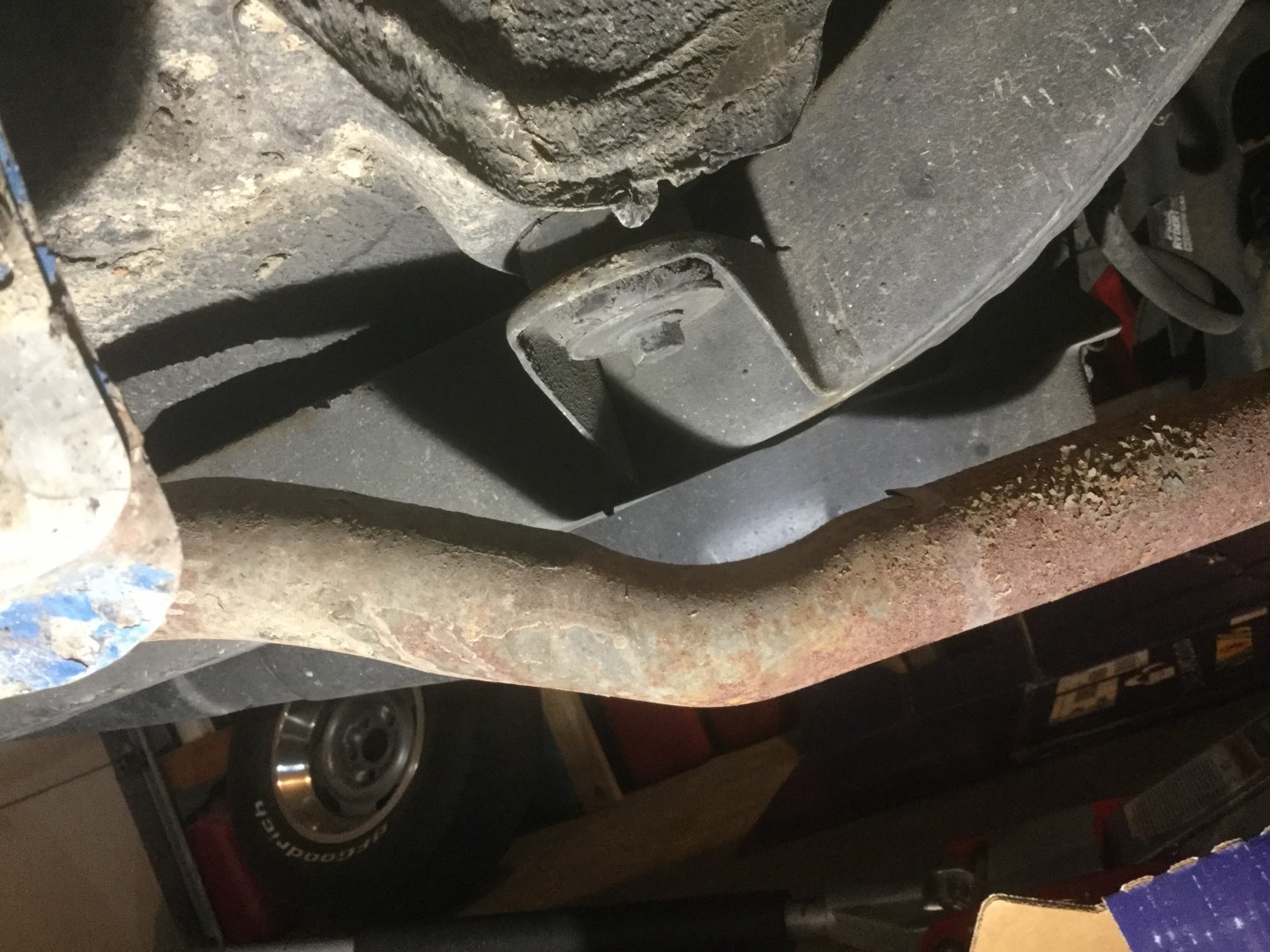

Well it’s in the garage for inspection and evaluation. Plan is to drive it for a year. Then decide on its future. Looks pretty good underneath. Trying to figure out the engine as it doesen’t want to idle below 1100.

3 speed automatic, how do I identify that? Here are some photos. All body bushings appear original with part #’s as well as bolts. I think one repaint on the frame.
