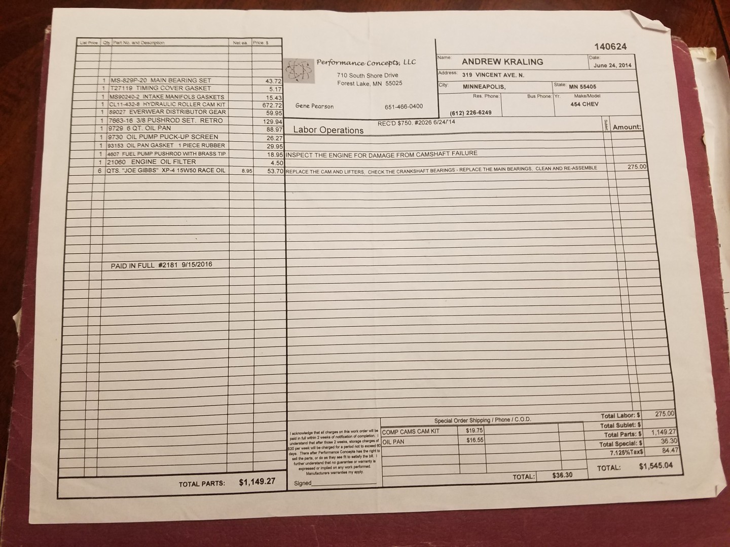

Yes indeed the cam went flat after about 15,000 miles after rebuilding in 2006 I didn't know zinc was needed for hydraulic lifters.
had a rebuilt in 2014 with roller cam no warranty it was at performance Concepts. gene pearson has a shop out of his house in Forest Lake - was recommended by my former mechanic growing up.
I can try to find the build sheet that should reference to cam part number.
I,m not sure if the distributor was replaced after that rebuild ... the gear might not be right perhaps that's a culprit.
AK said
Oct 25, 2019
Correct that. It appears the gear was replaced ...
Although this is the same engine that had the incorrect oil pan size 🐂🐂
cam part number is attached
i,ll to have to look it up shortly

After talking to AK about when the cam was replace and seeing the parts list we cam to the conclusion that the timing chain and sprockets were not the issue, next the dist gear, I looked on line and found that the correct gear was used.
