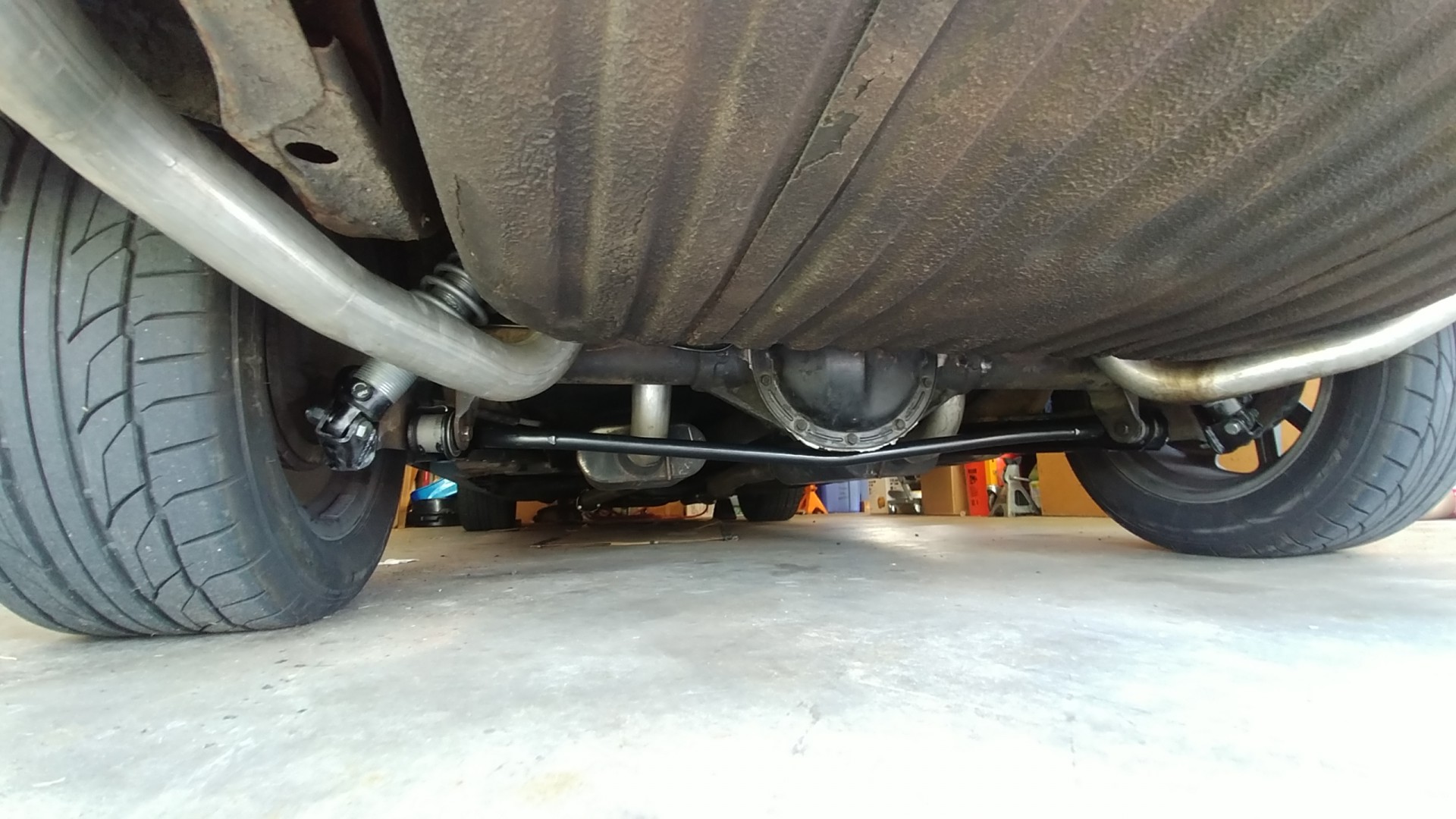

Finally got motivated and I seem to like punishing myself by tearing into the car the weekend before SMN's...and replaced the upper control arms with the ones I had boxed and the lower boxed ones I had bought, new bushings for the diff, along with a set of QA1 single adjustable coil overs and an anti-sway bar from Auto City Classics.

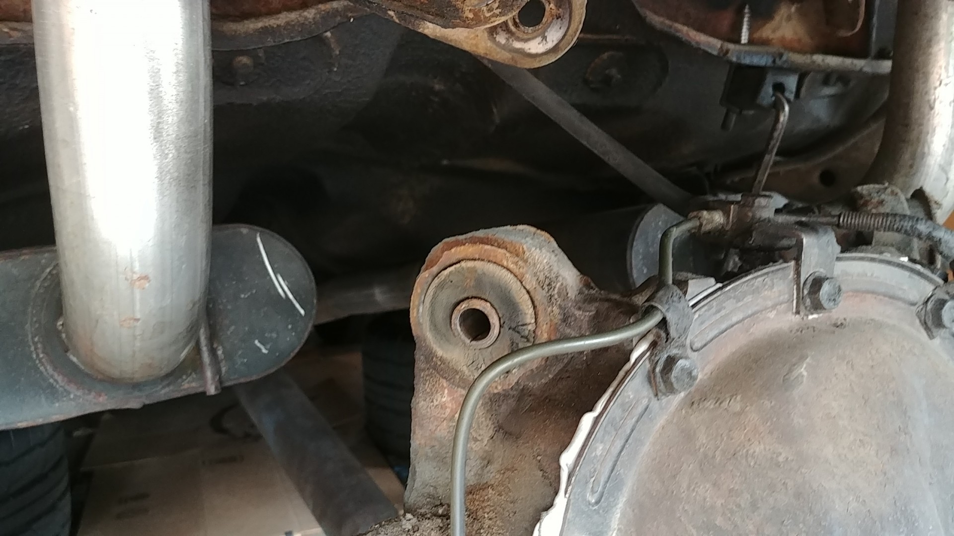

Of course I picked the hottest weekend and week to work on it, but got it out of CAC last night, and it rides like a totally different car. Not near as harsh and now the rear doesn't scoot to the right when turning right and getting on it due to the completely shot bushing in the diff.
