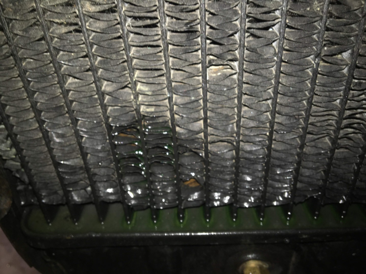

Well I finally got the Elky into the garage to do some annual maintenance on it and I screwed up. I set a quart of oil on top of the radiator as a reminder that the oil was draining and the engine was dry. Well somehow, that quart of oil fell off over night and knocked into my radiator at the bottom and tonight when I got home from work, Tami told me that there was green stuff under the car. Once I got out there, I saw that the oil had fallen off, where the cap had hit it, and how the quart of oil was being held up by the radiator. Remove the oil and sure enough, that's where it is leaking from.
What are my options going forward? Should I try and have this one fixed? Am I better off going new? The only time I've ever had a problem with overheating is while waiting in line for Street Machine's.

You should be able to take the radiator out and clean up the spot and solder it with a propane torch to seal up the hole. Google search will show you how to do it. Otherwise aluminum replacement from auto city classics I think is around $200.
Jun 14, 2019
There are several radiator shops around, I have used the one in old downtown New Brighton. I don't recall the cost but they cleaned mine and soldered up some leaks. A phone call should determine costs.
Jun 14, 2019
If it punctured that easily, it must be pretty weak. There is a shop in Anoka, on Main St., that can re-core yours if you want originality. Otherwise I agree with Chris. Auto City Classics is about $200.00, and they have electric fans that are made to fit their radiators.

Larry that was my thought as well. Seems a little concerning that if it could crack that easily, what else might crack it. The radiator is not original to the car. I got it for free from a guy a number of years back so I'm not real concerned about the originality of it. I might try and see if I can solder it shut for now to get by, but I did some looking on Auto City Classics and I do like what they to offer and their prices seem reasonable. I do like the thought of being able to remove the mechanical fan and just run the electric.

I had the same thought as Larry, if it punctured that easily, it's time to replace or re-core. Maybe call a couple shops about re-coring first, to compare.
