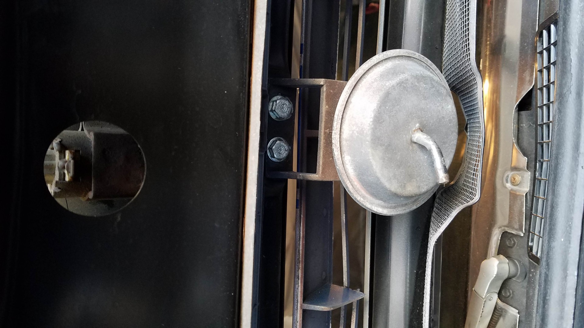

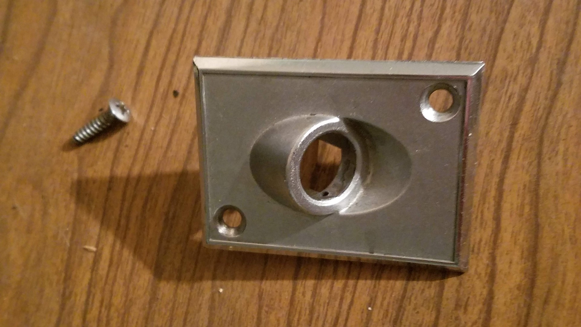

Below are images of the hardware/trim pieces I need. I realize some of these are available in an entire kit, but I only need one/few pieces of each so hopefully someone has a spare. I also looked at AMKproducts and could not located the hardware for the body trim.
Driver side mirror (two interior screws for mirror position bracket) - I have one, but need one more. I'll post images in the next day or so. Mounting hardware for the chrome strip on the lower body below the passenger and driver doors I need a single piece of chrome stripping over the driver door

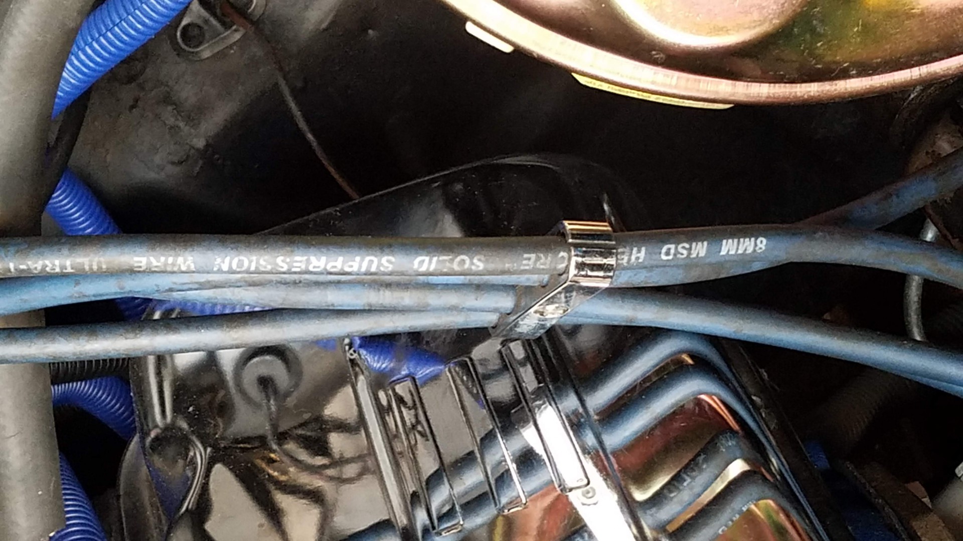

Yesterday I realized the ignitor system states to not use solid core spark plug wires. I'm wondering if that is part of my issue. I'll look further into my MSD wires and call Pertronix if needed.

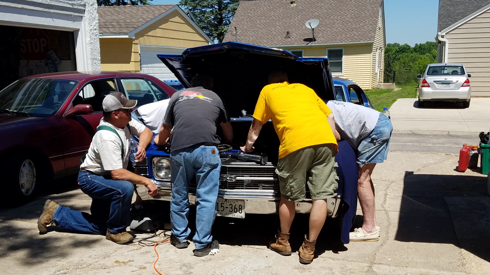

A big thanks to everyone that came over yesterday to help me diagnose the timing issue with my car.
A special thanks to those of you that brought the timing gun, air compressor, a 90-degree drill along with all of your other tools and especially your knowledge. Appreciate your patience with my battery issue.
It's amazing to see the progress on this car over the last year and a half. I learn so much at every tech session and at every Club event. Without this club I would be in the same position as I was a year-and-a-half ago.

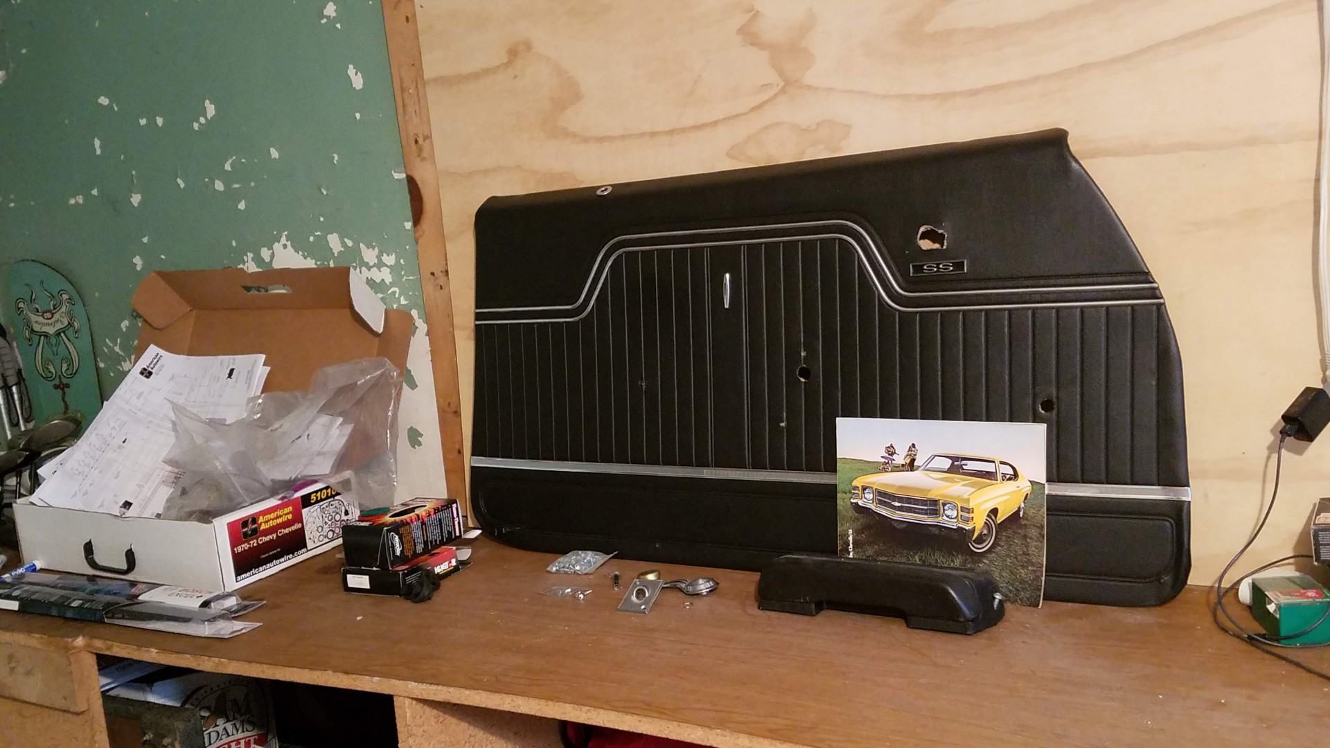

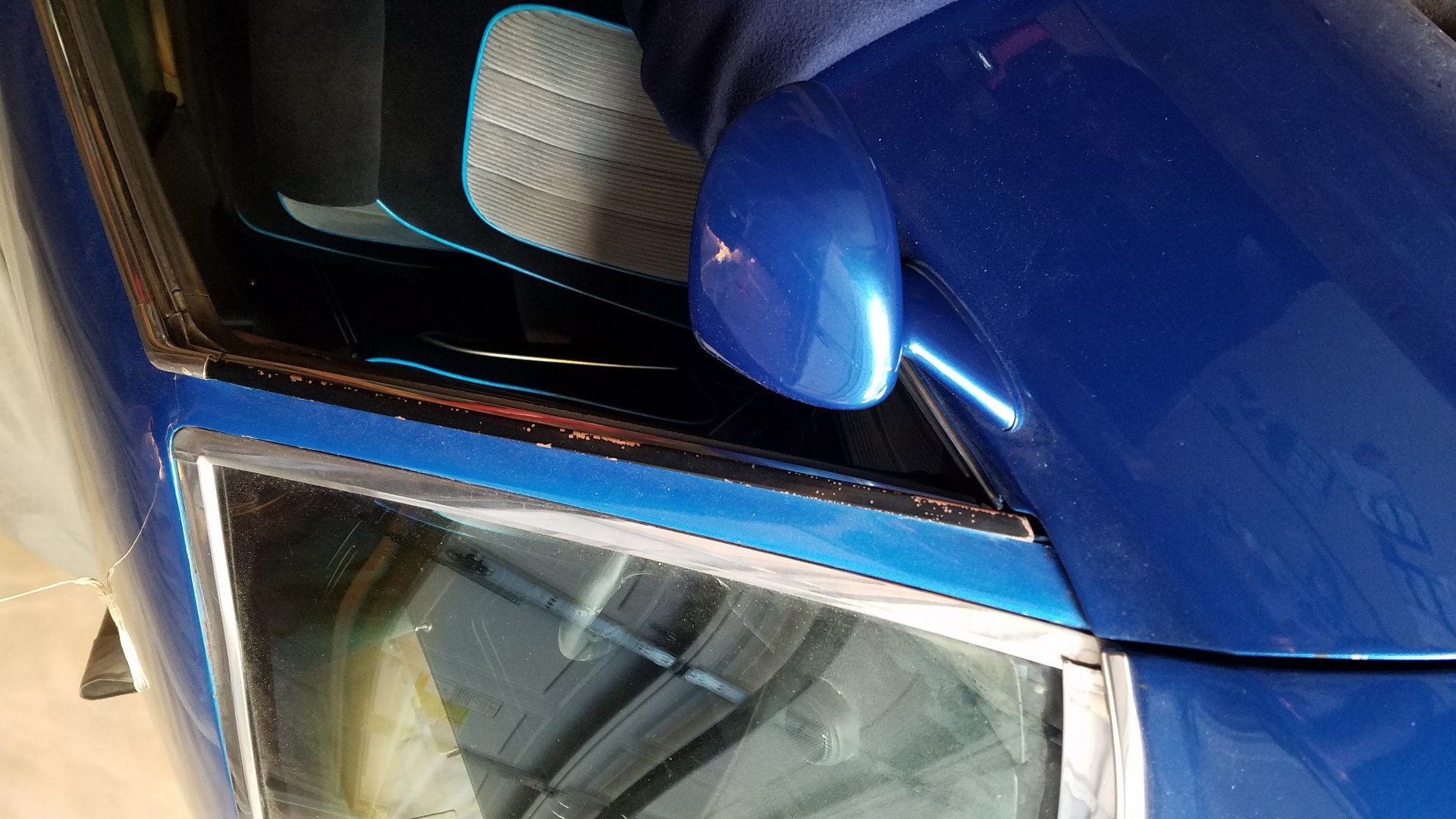

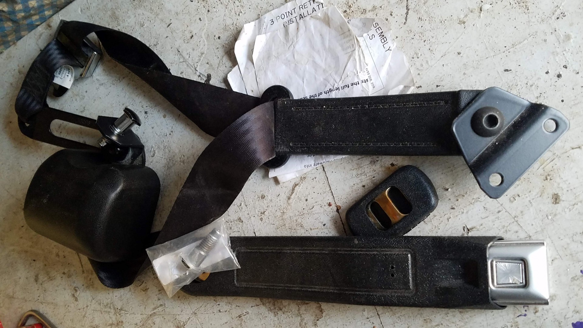

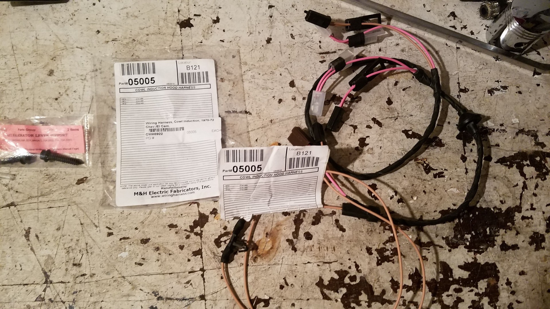

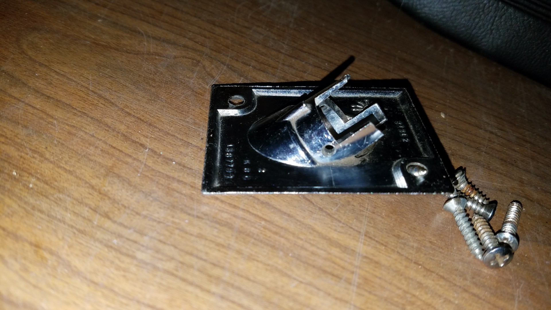

-- Edited by AK on Thursday 6th of June 2019 06:33:24 AM

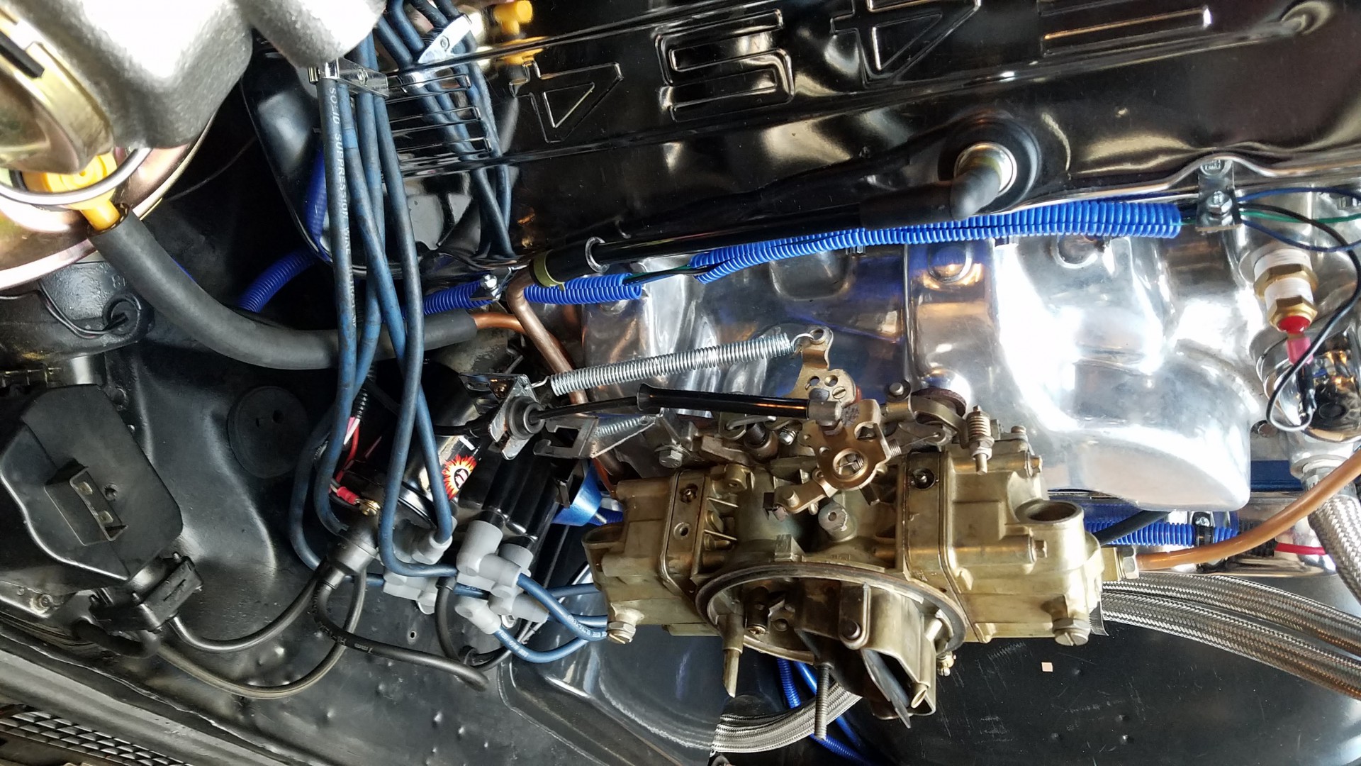

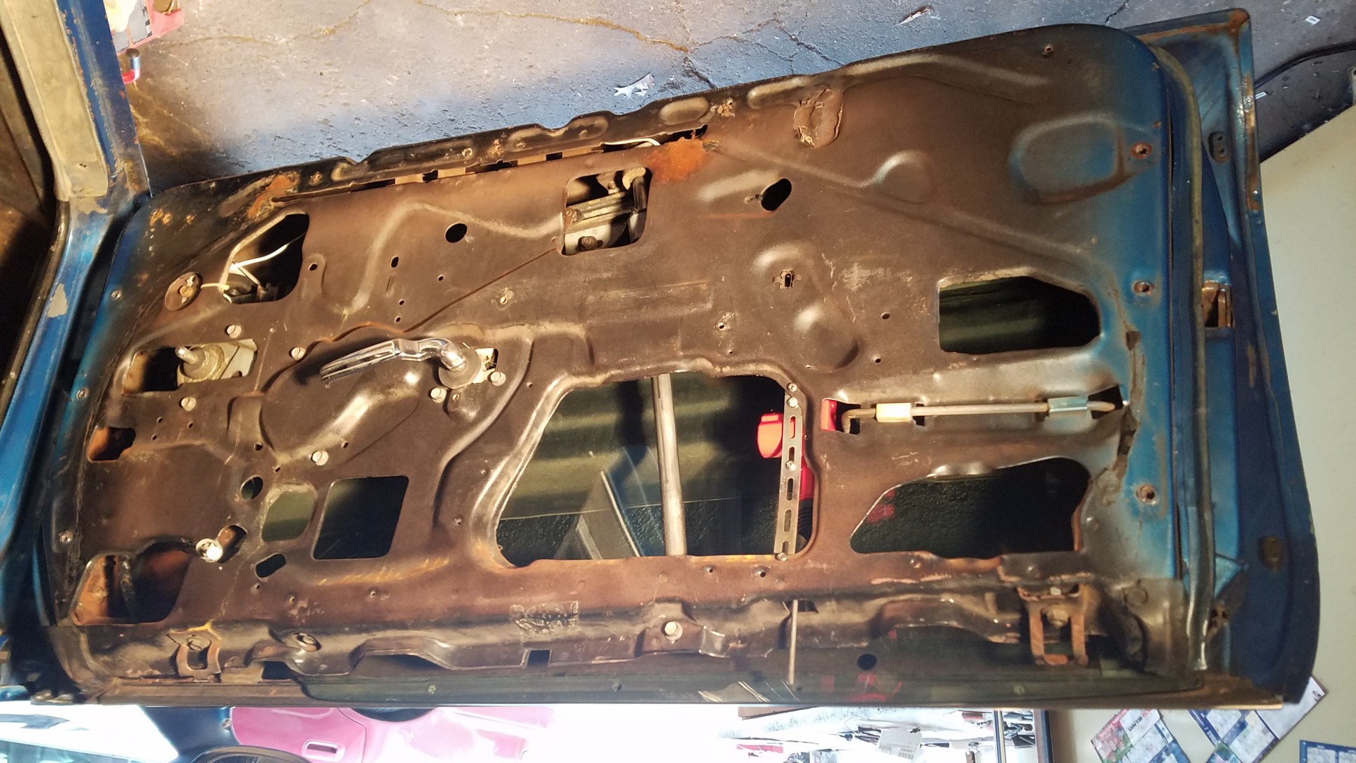

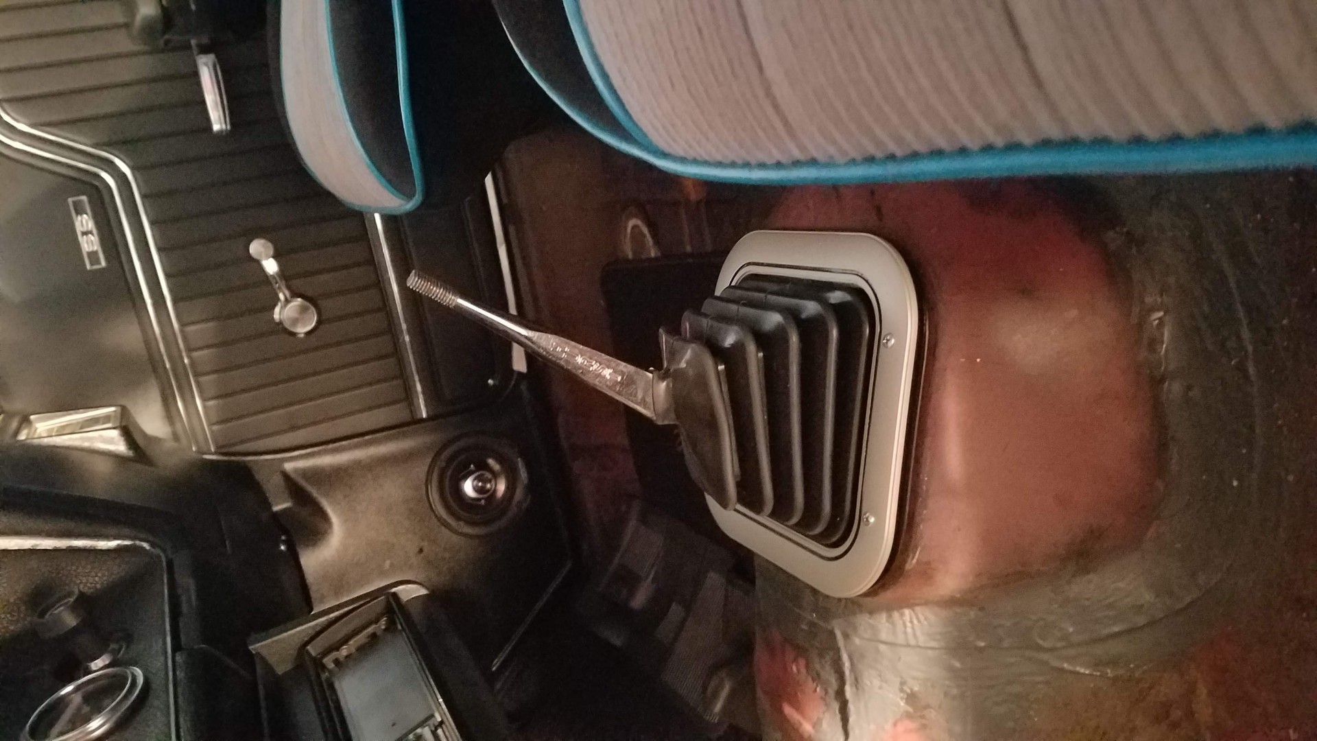

Before images of door panel and interior.

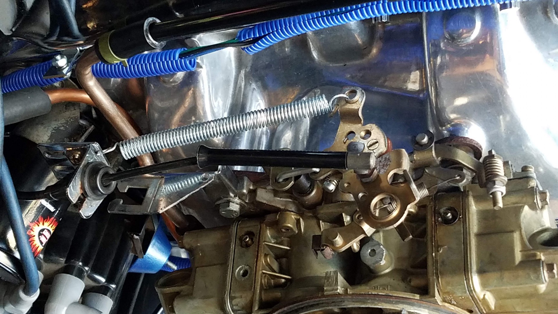

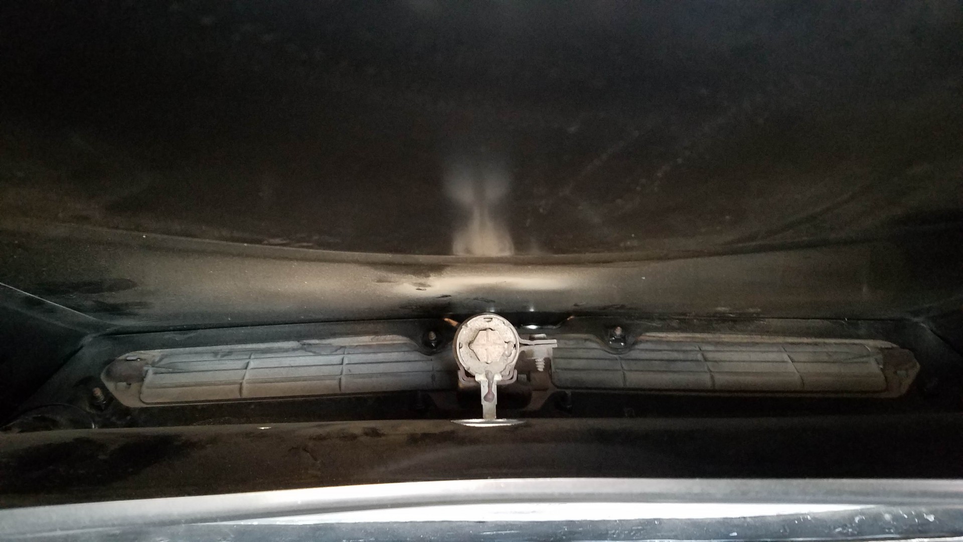

Before images of throttle linkage and cowl induction.
More than likely I'm missing a few parts for the cowl induction.

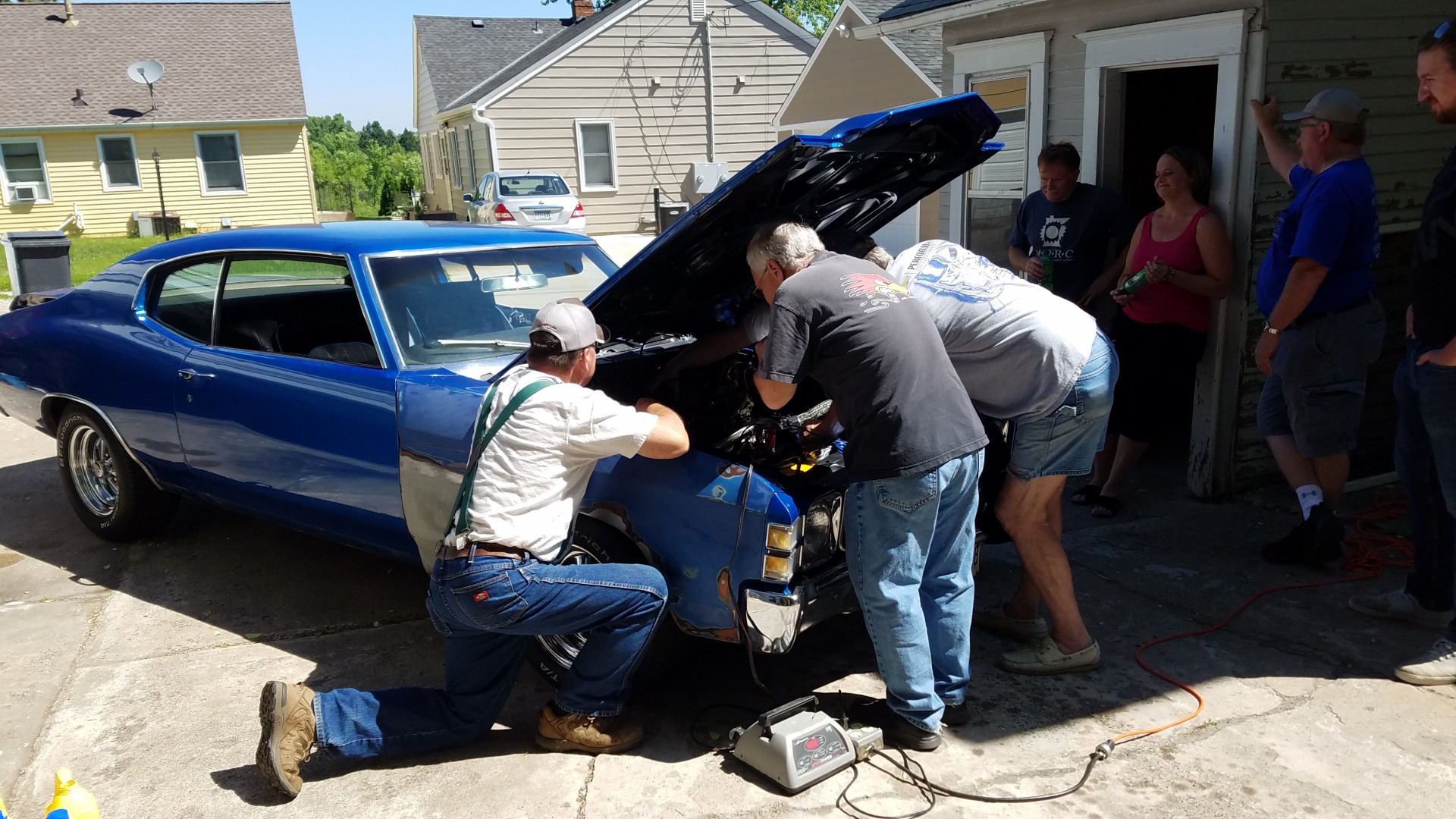

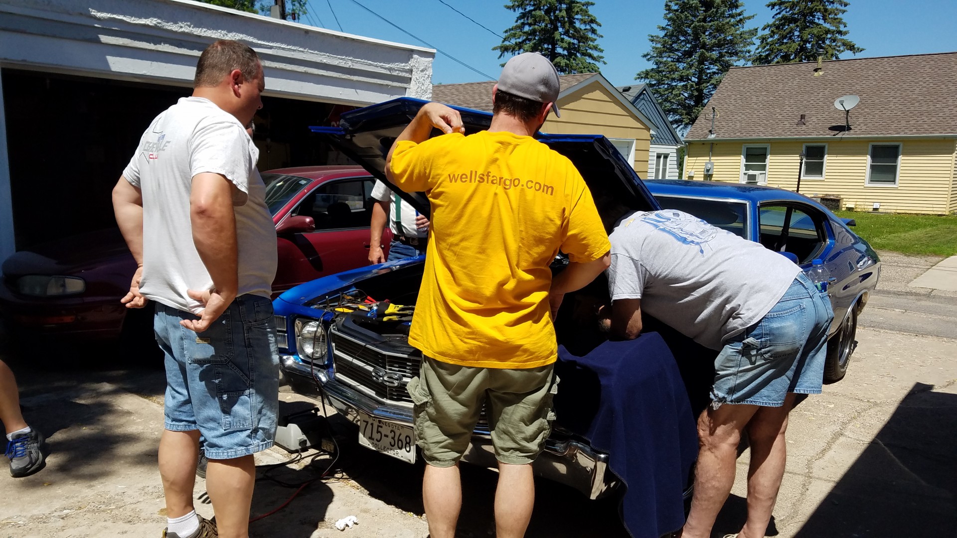

I took the car out last night twice and again twice today with the family. It fires up right away and drives well. It's nice to have a seat belt for the wife! I'll have to diagnose that annoying little squeak 🐁.
I look forward to seeing you all the next event.
A few pics from the work day and after cruise.
