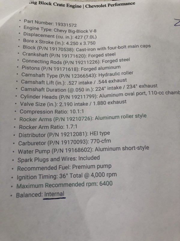

Mitch shamed me into checking out Manual trans.
Wanted something stronger behind the ZZ 427- 480hp-490ft. lbs. of torque crate motor I have in stock.
Internally balanced.
I have NO clutch, flywheel, bell housing or scatter shield parts.
The 454 in Biskwik is externally balanced, I sold everything internally balanced I had to a Club Member, no regrets.
New motor deserves new everything else.
Communicating with Autogear, they have been very responsive, thanks for the referral Mitch, I think!
Lots of horsepower, torque, don't want to blow up clutch and lose my toes.
What is the ideal approach?
Hoping the Chris's and others will chime in.
It may still get down to total cost, and if I really want to shift.
This is a Street build, I am way to old to start going to the strip, never did when I was younger, except to tow friends broken cars home.
