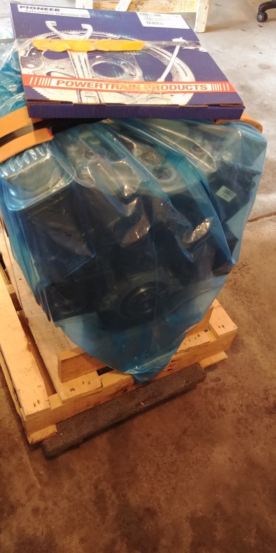

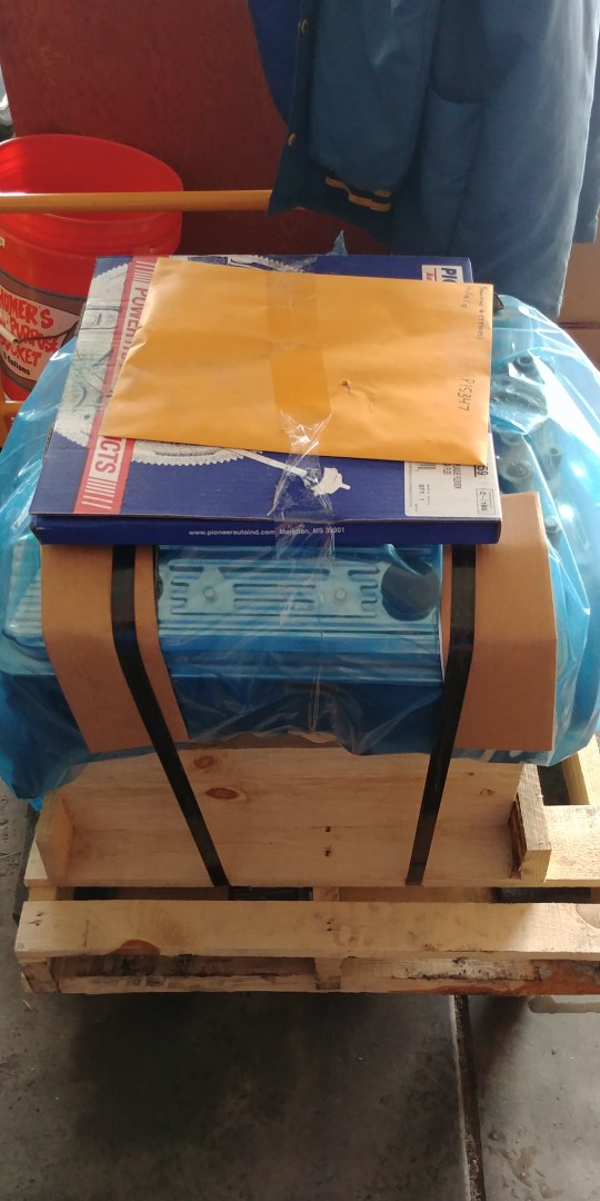

The new heartbeat has arrived! The truck showed up over lunch, and while the driver wasn't happy helping me pull it up the driveway on the pallet jack (supposed to be 'end of driveway' drop off, so I get it that he probably wasn't supposed to help me), it's in the garage now.
Everything looks o.k. so far from the shipping, and the included dyno sheet shows Peak Torque at 432 ft. lbs and Peak HP at 402. The good news on the torque is that at 3000 RPM it's almost 400 ft. lbs. and peaks at 4300 rpm, so a nice flat torque band in the mid RPM range. Should be a well behaved street engine with plenty of torque.
They did share the roller cam specs on the sheet included with the engine as follows; 220/224 @50 .528in/.536ex on 112LSA. So Chris P., you were pretty darn close.
Makes as much torque as the 383 did. Can't wait to here it run.

Um, you paid $65 for lift gate door delivery and the driver wasn't happy he had to help drag it up the driveway ? He should have backed up and dropped it in your door.
Good to see it got there all safe and sound.

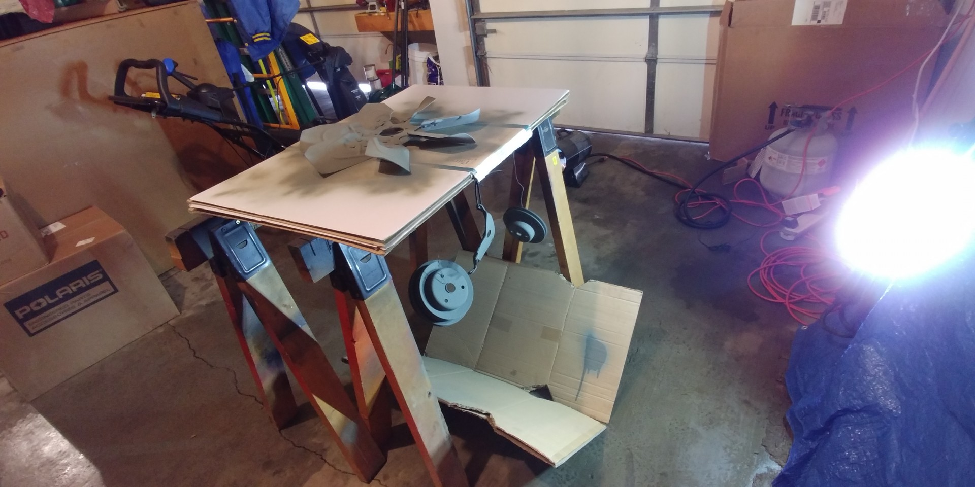

More progress today thanks to some warm weather around 50 degrees and 'working from home'.
Ran the garden hose upstairs from the hot water heater so that the water was good and hot, mixed in some soap, and I had pre-soaked things with Purple Power degreaser, and things came off pretty well. I've got a little degreasing by hand to do, and some wire brushing, but shouldn't be too big of a job.

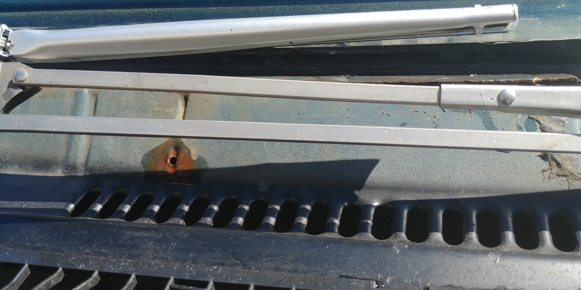

The thing I was VERY happy about is i took the stainless strip at the bottom of the windshield by the wipers off with a large fear of finding big rust holes, but it was 99% solid! What rust was there was very minimal, and surface only. I'll throw some rusty metal primer there when I'm painting the engine bay and will hit it with the Eastwood Extreme Chassis Black paint I'm using. Also looks like someone made a swan out of the seam sealer. Must have been a Friday afternoon assembly. lol
Hope to get it completely prepped tomorrow and at least the large areas painted.

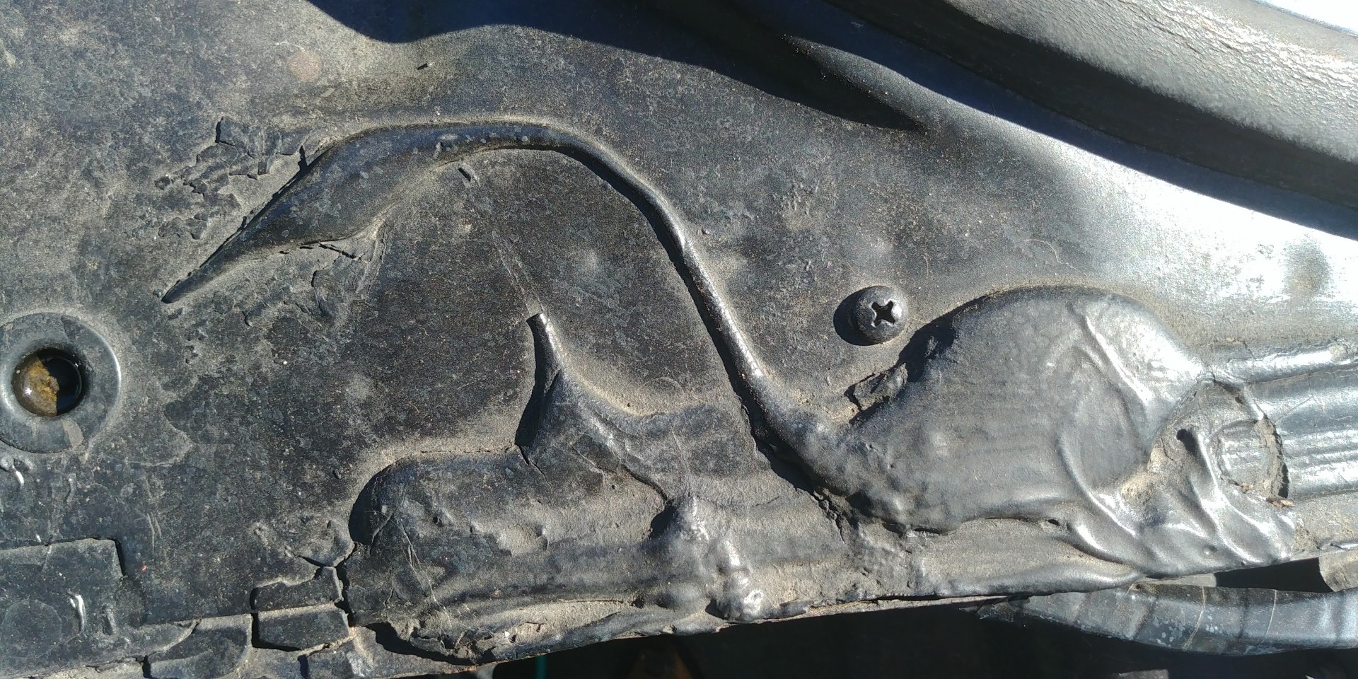

Spent some quality time with the Malibu this weekend huffing paint fumes while getting the engine bay ready to hopefully drop in the engine later this week.
I'm not sure which makes more sense whether to take everything apart to clean/paint or do it in place that required a ton of masking and crawling in and out of the engine bay.
I decided to install the rain/dust shields on the inner fenders, and while pleased with the outcome, man that was a pain drilling the holes and bending the staples underneath! This is the first Chevelle I've had in a long time with the shields in place, but I do like how it cleans up the engine compartment.
On my 66 in addition to the shields for the control arms they also had shields for between the inner fenders and the frame. Years can be different. Does yours also have those shields?
No shields between the inner fender and frame. There's a gap there of up to 1/4", so not very well sealed.

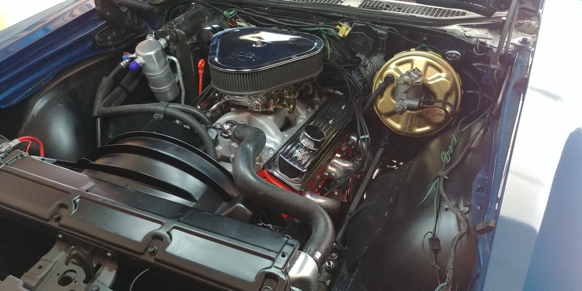

She's running on ship's power now! Took an extra day off this week and got it up and running Friday afternoon. Had some help from the northside Chris team, so appreciate that guys.
I've got about 35 miles on the break in so far, and really like how it's running. The little bit I got on it felt even stronger than the 383, so happy about that too. Now that I have good vacuum for brakes, I found the next weakest link as now one of the drums is pulling to the right. Need to get the front disk conversion done next.
Now it's time to get the rest of the break in miles on it for the next oil change.
Looks great sounds great! Thirty-five miles, looks like you’re the first out this spring.
