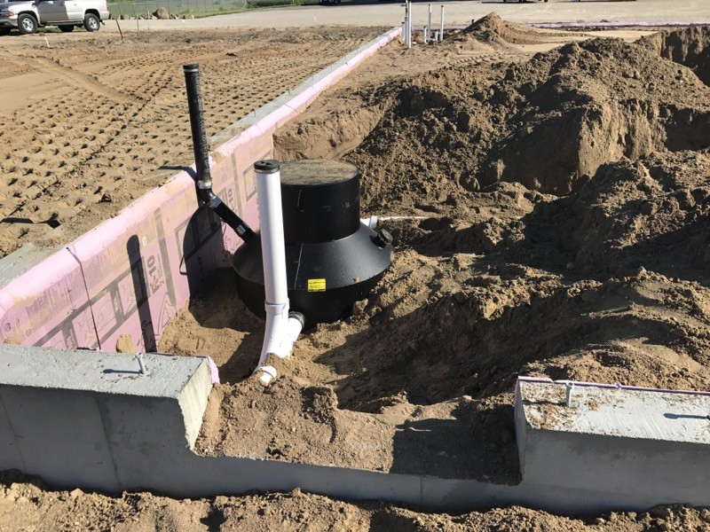

Building permit is approved and the contractor was hoping to prep the site and pour the pad this week, but way too wet. Maybe next week if it dries out.
The contractor still wants to confirm where the septic field is, even though they plan to stay well clear of it on the far side of the lot. So, he has a septic buddy that is going to stop over and see if he can determine exactly where the field is and where the lift line is. Turns out the plan approved by the city isn't even close to what was installed. Go figure... I'd like to know for sure as well for future reference if needed. The only indicator we can find is one of the access line PVC caps that we think is on one of the sides.
Otherwise, the plan is to start the framing the first part of Nov., so hopefully close it up before too much snow flies. It will be 'cold storage' only for the Camaro this season until I can get electrical, insulation, and heat in it next year.
Septic systems can be a pain when planning additional buildings/trees/landscaping. Strange the "inspector" allowed it to differ from the plan ??
Club functions next year, with backhoes and pvc..
