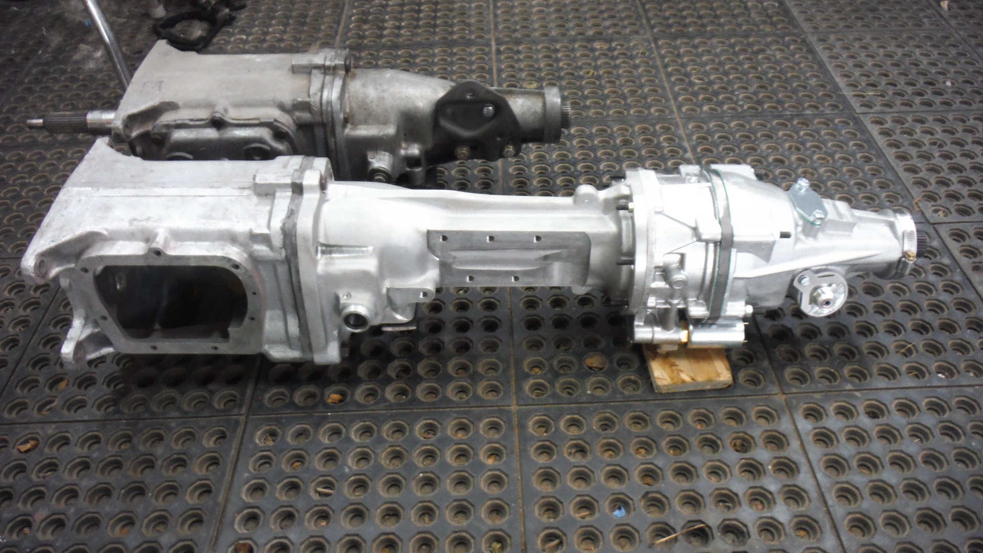

I acquired an old Muncie case years ago that I'll use to help with fitting the OD in the car as I will have to do some mods to the tunnel in the original Ujoint area. Not happy with that but the floor was already chopped up by a previous owner which I repaired during the restoration.
I'll have to modify the exhaust, X pipe will have to go than probably do a H pipe. The drive shaft will be shortened. Both of these changes would have been required for ether the LGT or the GVO.
Started the install about a two weeks ago, tunnel mods are going good. So into the CAC for hopefully not to long.

I used the empty Muncie case along with the GVO extension housing to help fit the overdrive unit into it's proper location. Had to notch the floor support back of the O.D. unit but no cutting/welding on the tunnel, just reshape for clearance. Was then able to figure driveline angles and shaft length. I'll have to raise the rear of the car about 1.5in. to the increase the driveshaft angle and reduce the working angle between the trans and D shaft. The car has settled over time so that puts the ride height in the rear back up to where I like it, I'll deal with the front later.
The drive shaft will have to be shortened just over 15 in. to about 39 1/2 in. I didn't like the slip yoke from GVO as it seemed short, after adding in the 3/4 in for movement the yoke would not fully engage the support bushing. I decided to shorten my original yoke to a more acceptable length.
I pulled the tail housing and side cover from the trans, flushed in clean solvent, inspected and reassembled with the GVO housing, than adjusted shift linkage.

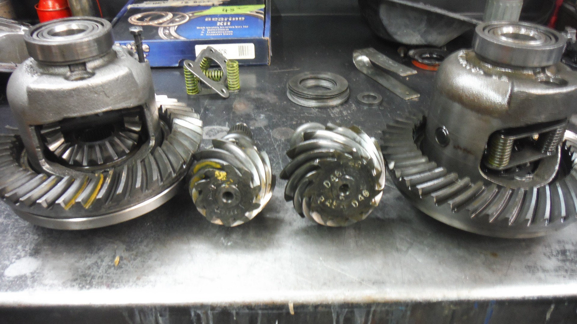

As part of installing the overdrive I need to change the gear ratio. The 3.31 was great on the highway in OD but first gear is just to tall, have to slip the clutch to much from a stop and the clutch gets jumpy after driving for a bit. I decided to install the 4.11 from my other housing, OD will be about 2-3 mph faster than the 3.31 in 4th. Eventually I will go to a gear somewhere between the 3.31 and the 4.11 but wanted to try the 4.11 to help me decide.
I checked the backlash and pattern before removing the 4.11 gear, the BL was high and the pattern was not very acceptable. Than pulled the diff assembly from the housing. Rather than pounding on the pinion to remove it, I decided to build a fixture to push the pinion and save the bearings from getting a beating. The fixture worked great.
Had to order shim kits to properly setup the diff gears. Will also have to replace an axle seal again on the right side, I'll try to locate the seal inward if I can to hopefully get away from the worn surface on the axle.
I found some shims (from a another project) that were good enough to use temporarily to set pinion depth. The gears showed a better pattern by adding more shim until I was up to about .010. I that point the pattern started showing that pinion was to deep, so I pulled .004 back out. I'll measure and replace this shim pack with the correct shim when they get here.

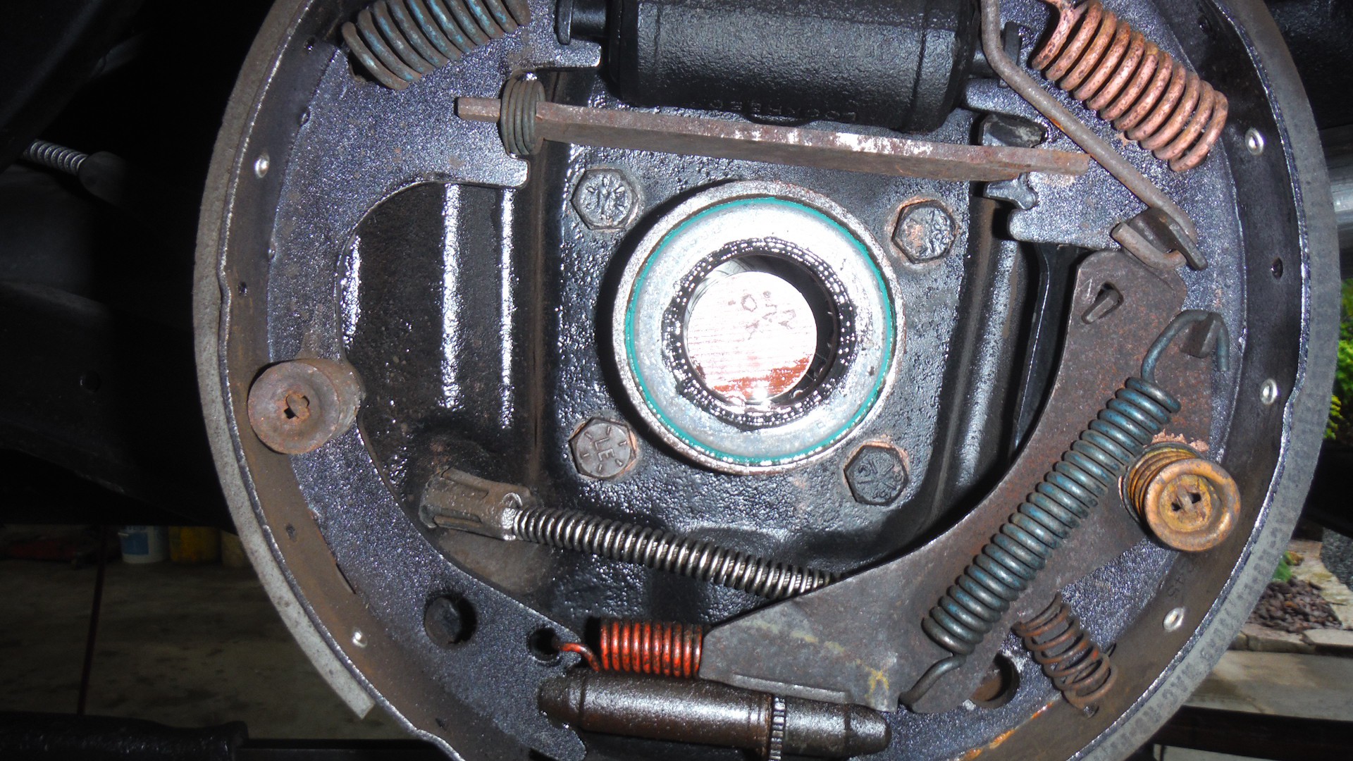

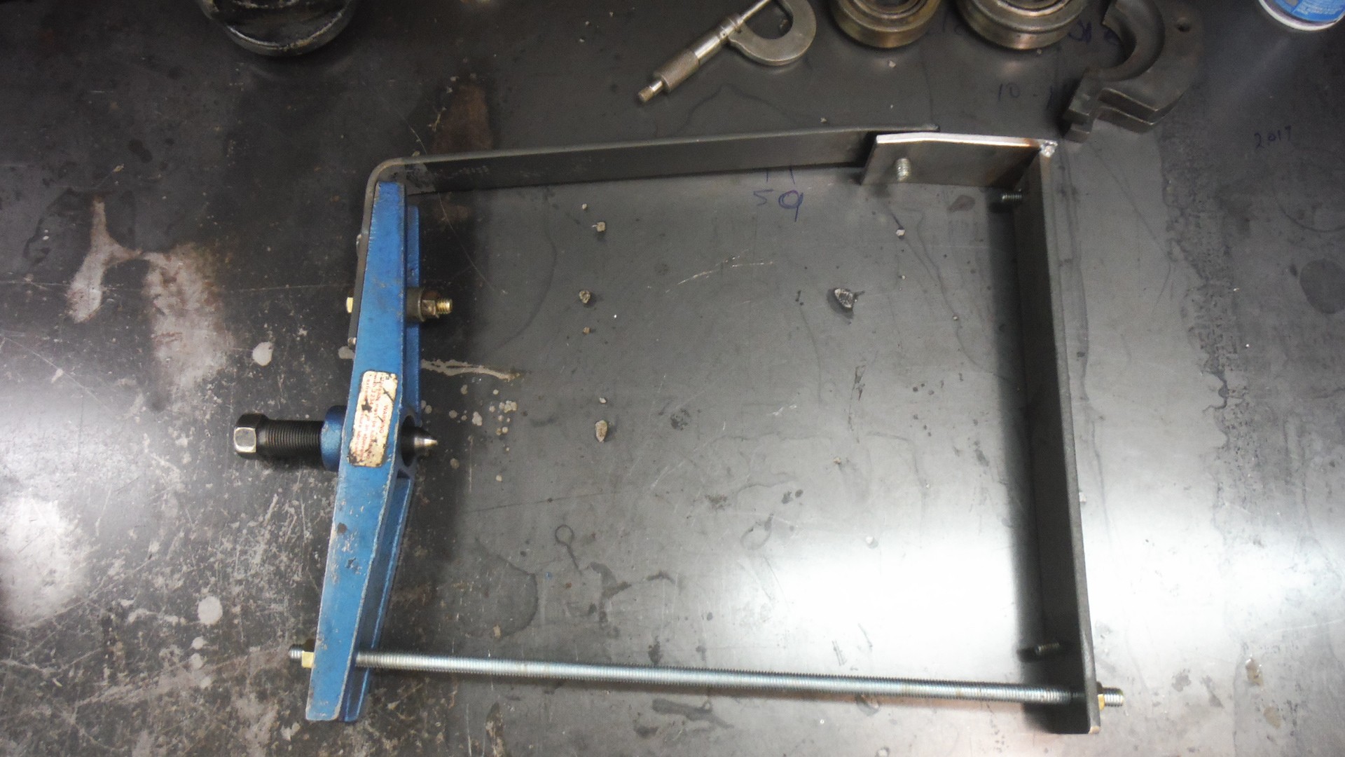

I then shimmed the clutch packs for the posy, cleaned up the right side brakes and diff housing to get ready for final assembly.
I also check the ends on both housings with the alignment bare, only one end showed very good. I don't see any spline ware on the axles so I don't think the misalignment is a problem. Future plans are to install Impala housing ends for 11in brakes and eliminate the "C" clips.
After the shims arrived I installed a .032 shim pack and bearing on to the pinion, assembled into the housing, than installed the diff case, set the back lash (.004-.005) and bearing preload. Painted the gears, pattern cam out good.
