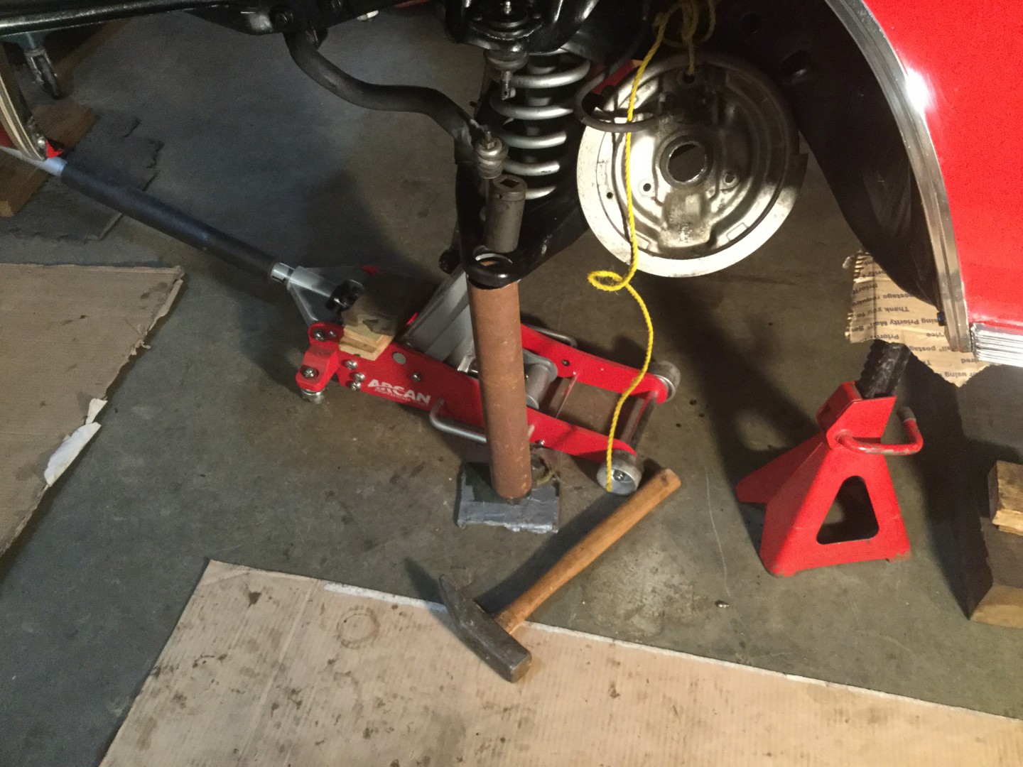

I have a set of 1" drive sockets, 1 on the bottom to support the arm and 1 on top just smaller than the ball joint body and smack it a few times. It really shouldn't take a lot of force to remove it. A section of exhaust pipe underneath should work too. In fact with the spindle out of the way and the dust boot removed, you should be able to tap around the top of the joint body with a drift or punch and get it out, with the support underneath...you need the arm held solidly from below.

I think I have a section of pipe I can cut to fit between the floor or I will barrow some 1” sockets to put on. The bottom with support, then another socket on top. How big a hammer, 3 lb.
A 3 lb should drive it out in about 3 seconds. I use a standard ball peen.
Supported the bottom with a piece of pipe, put a socket over the top, smacled top twice and it fell out. The China tool worked fine for the install.
