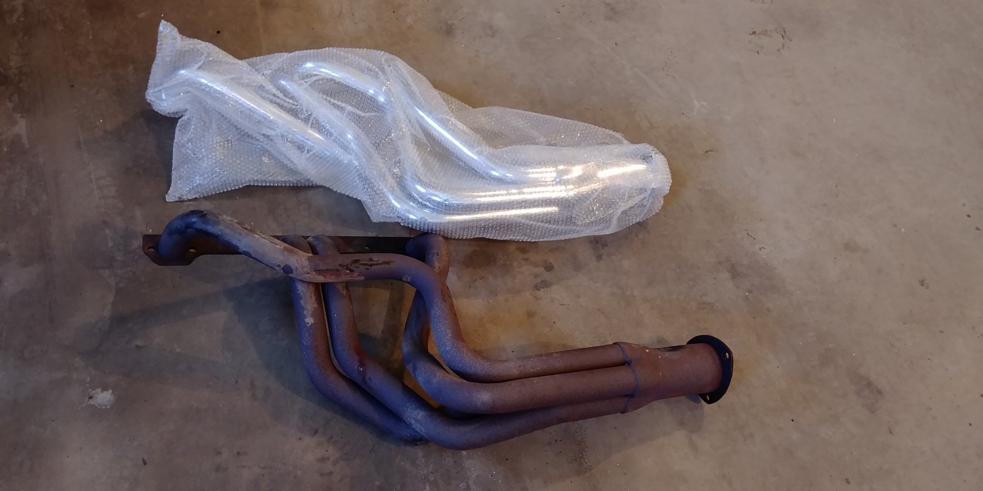

Another step forward today thanks to the help of Chris S.! The old 350 is out and on the cherry picker for the new owner to pick up tomorrow.
It came out without any issues, and thanks to Chris' packing skills, I discovered an engine on a cradle, 2 sandbags, and an engine hoist can all fit in the back of a Chevy Colorado.
We were also able to confirm the shiny new headers are the same length as the old nasty ones. Now we'll see if there's any issues once they're on the engine in the car.

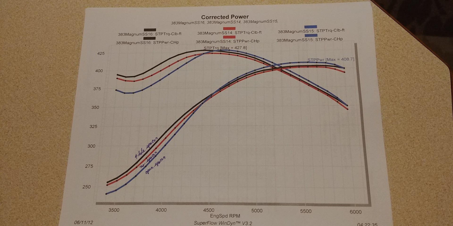

Peak HP at 409 and Peak Torque at 428. Torque band is very flat and kicks in under 3500 rpm, so should be fun on the street. The dyno sheet I attached doesn't show the best low end torque, just the max.
Interesting that it gained about 16 ft. lbs. of torque with a 1" 4 hole spacer. It leaned it out and really liked it.

Chris P. is the winner!
