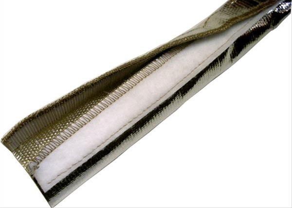

There was about zero clearance with the new stainless brake line on the right, so I had to reform it enough to get some space.
Heat shield that brake line with something like this:
I'll have to try that. My trans lines are only about 1/4" away from the passenger side header.

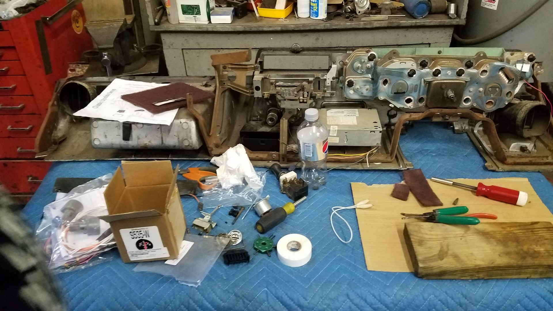

I was talking to the President this afternoon and he reminded me that I hadn't posted any pics of the completed floor work, so here ya go...
I made a new cage for the body nut where it has a dummy mount now. Might want that in a future restoration...
Most of the floor patch welded down.
Bolted the seat mounts on the seat and marked where they needed to be, then welded them down.

I could post this picture of what my shop looks like
-- Edited by hkgmillette on Monday 14th of May 2018 09:46:23 PM
That's a good look Hank, I think you need another project car for your shop.
